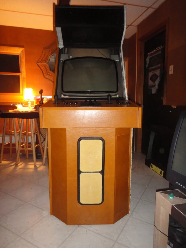

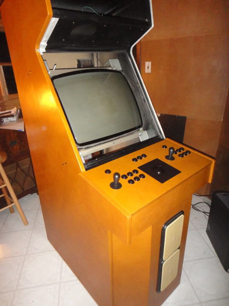

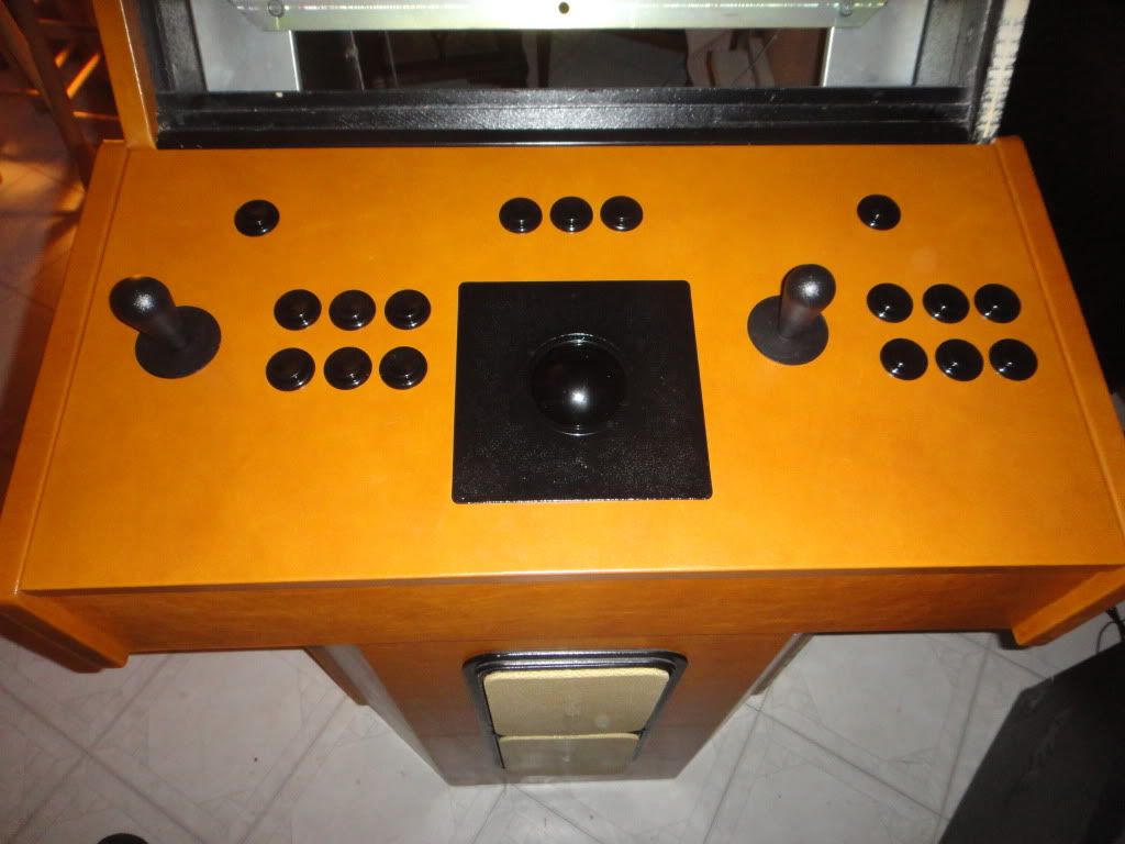

Ok - Got the control panel cut and leathered.
Got the Shagreen mounted on the coin doors.
Got the controls and micro switches in the control control panel and mounted.
And got leather on one of the sides.  Took forever and got too dark to do the other side.
Tired - Gonna order Chinese...  More to come.

Nice work there skinz, but would it not look even better with the trackball mounting plate, mounted below the cp?  :applaud:
skinz
  • Posts: 81
  • Last login:February 24, 2013, 10:46:10 am
Re: Leather covered Cab
« Reply #94 on: November 27, 2010, 06:18:17 pm »
We tried it both ways and thought it looked better like this and would help protect the leather from everyones little greasy fingers.  I like it a lot. LOL  :afro:

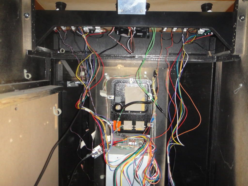

Stayed up late last night and replaced all the original wiring - New Jamma harness, crimped a new daisy chain ground and bastardized the old CP to get the bits we needed.  Scored 100 packs of the quick disconnects for $2.99 per 100 on SleezeBay.  I got 2 packs (200) and used 2 quick disconnects  :laugh2:.  Props to my buddy Miggitymac for help wiring up the monitor,etc.  Some basic solders this morning an it should be all hooked up - Got the CP all wire an working - all buttons and joysticks working (already not sure I like the 8 ways - they feel weird).  Now we just need to find the damn zip ties and make it look pretty inside - We couln't find them last night so we used some masking tape to separate everything.  I bought a huge pile of ties - Can't find them>>>>>YET. LOL
Again, we got soft 15k working and still everything is way too big - Can't figure out what I'm supposed to do - Do I Install all the stuff on Soft 15K like 31 etc.  Hating this part - Still.
I'll try and take a video after work today of the monitor issue - I really need help on this.
BurgerKingDiamond
  • Posts: 690
« Reply #96 on: November 28, 2010, 09:55:02 am »
Wow, that cab looks luxurious! Sorry, I don't have a clue about the monitor deal. I think you should post it up in Monitor/Video.
About the LED's, are you going to wire them up in series or parallel? I've never had to wire up more than one at a time.

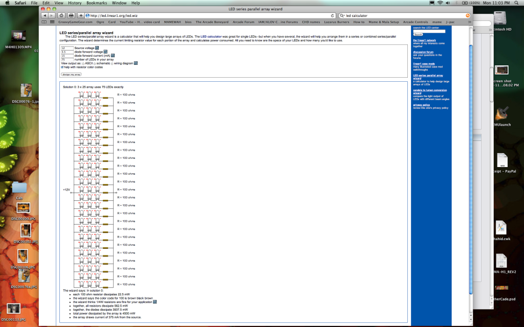

Watched a million Youtube videos on wiring LED's.  Pretty interesting stuff out there.  I'm want use a breadboard setup like this and put the LED's in the back of the holes and see how it looks.  This kid is where i started.  A lot of info in a short video.
I got a gift card for Radio Shack so....  ...I need approx 75 LED's (on a 12v)????
Does this look right?

miggitymac
  • Posts: 14
  • Last login:February 26, 2013, 10:10:44 pm
« Reply #99 on: November 30, 2010, 10:18:00 am »
Sweet!  I think we can handle wireing up the LEDs like that no problem.
