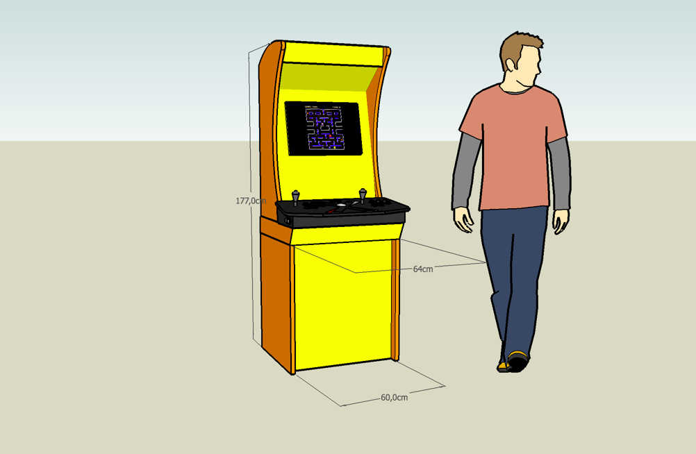

Hi Guys,
Lets start this topic off with a brief introduction. Im 27 years old, live in the Netherlands and always have been a big (arcade) gaming fan. Until stumbling on to this forum I never toughed I would ever own a cab myself, let alone build one.
After reading and following a lot of threads on BYOAC I finally decided to really join the club and start building my very first Mame Cab. I started off with the control panel. Unfortunately I lost the pictures of building the CP but then again, you all have seen the "making of" pictures a thousand times before so you pretty much know how it's done.
this is the control panel overlay im going to use (the final version has a little more detail to it, but i cant find the psd file right now.)
I know it's some sort of sin not to use a real arcade theme for the cab, but i'm going with a Disney/Mickey themed arcade cab.
I started off with google sketch up and made a few designs based of "Martijn's SF cab" because i really love the rounded shapes on that one. Also made a little cardboard mockup.
I first wanted to use a X-arcade to keep things more simple but the more topics I read, the more I wanted to build everything from scratch.
For the control panel I am using 2x u360's (hard springs), a Utrak trackball and standard concave pushbuttons (8 buttons per player). For player 1 i'm using red buttons and blue buttons for player 2. The control panel is made from mdf with plexi on top. Im using red and blue t-molding.

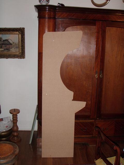

It's the first time i ever used a router so there was a small learning curve to get things clean.
Today i finally started building the actual cab. and when i started drawing the lines on to the wood i noticed that i dident like the way it was turning out. So then i changed the design towards the slimline Terminus. (almost exact copy, if it ain't broken, don't fix it).
The cab is gonna be fitted with a 26 inch LG widescreen tv (want to keep it slimline).
That's it for update number one!

Spend quite some time cleaning up some edges. Sanding MDF still take's a pretty long time  ::)
I also started building the bottom panel yesterday but still haven't decided if i'm going to place some wheels underneath.
I'm gonna put the cab on a tile floor so I want to know for sure it's stable and not riding around while playing it.
