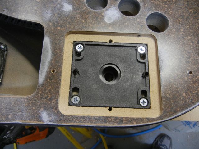

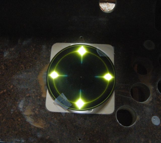

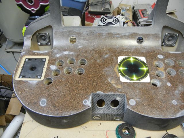

Ok so not much of an update again but it's something at least. I'm seriously considering going with the paint that Bender suggested:
http://alsacorp.com/products/softtouch/softtouch.htm
It's pricey but I haven't found anything else that I like better, and it would go perfect with the look I'm going for, a rubberlike, flat black finish. I went ahead and applied fiberglass resin on the areas around the screen and marquee to seal and smooth out the mdf edges. Next I began to work on the bottom of the cab. After bondo-ing the edges of the plywood to get rid of the fuzz and shooting some primer and paint on them, I came out with something like this:
I just laid the screens in there to show how the thing would look. Next I found a piece of scrap laminate that looked nice (burl wood grain) rough cut it, and placed it on top the bottom with the screens...it's all still loose at this point.
Next my attention was focused on getting juice to the motherboard, so I rigged up something to hold my extension cable to the aluminum back I had made. It is simply a piece of ply that I cut out and epoxied the cable onto. Then I countersunk some screws and attached it with lock nuts on the back.
That's pretty much it for now. The next few updates will probably be small but at least the ball is rolling again. Attaching all the fans and creating the screens for them will be my next step. I'll try to get a little done this weekend and update it.

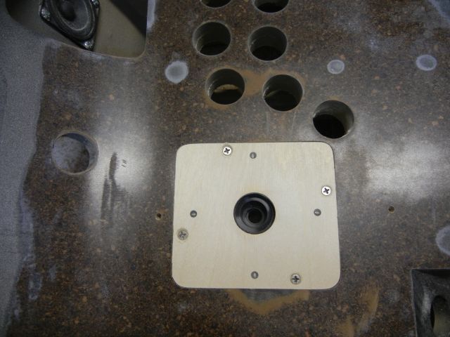

« Reply #129 on: December 04, 2010, 09:59:57 pm »
Finally had a couple minutes to work on the beast. Sorry I haven't been more involved lately but still crunching those 7 days a week at work and after family time the glass is empty for hobbies  :cry:
Ok so directly in line with OND's amazing finish work on the Astro, I too am in the painting process. Since the last update I've placed a piece of laminate on the bottom of the bartop, bondoed the seam between the laminate and side, sanded and primed, which left me with:
Don't mind the last pic it shows after painting.
After sanding, and sanding, and some more sanding...and after going through a couple cans of primer I was left with a decent surface to paint on.
A while back I bought a SATA minijet HVLP gun which came in handy during the next process of painting. A quick trip to the local NAPA store to buy some black paint, sandpaper, lacquer thinner, and scotch bright pads. This is the gun and paint I'm using:
So after applying either the first or second coat, can't remember they all blend together, and sanding down with 400 grit I was left with a couple imperfections.  These only showed up after the shiny paint was applied...yay me!
So sanded back down to get rid of most.
After applying another coat, I wet sanded with 600 grit paper, cleaned off and shot I think the 3rd coat. And this is where I am at right now, after 3 coats and alot of patience.
This was immediately after shooting the bartop so it looks a little orange peeled. It has since flattened out quite a bit and doesn't look too bad. I'll probably put one more coat of paint on and then get onto the good stuff...in case I haven't said anything about it yet, I bit the bullet and bought the soft feel clear coat from Alsa corp that I was mentioning earlier in my posts. I'm pretty excited to see what this stuff looks and feels like. I should get a chance to shoot the clear withing the next couple of days. So for now that's it, gotta get ready for work...boy it always gets in the way of our fun doesn't it?!?!  :)

Good and bad news...I was able to decide on how to bake the rubber cleat coat on. I grabbed some 3/4" insulating foam from the local hardware store, lined it with aluminum foil, and seamed it with aluminum tape. When trying to decide on the heat source, I happened to think of how I heat my actual garage. So I turned my ready heater toward the rigged oven and took a feel at how hot it could get inside:
The next step in the painting process was to shoot two coats of the clear on bartop and place it into the oven to dry:
Ok so here is where it gets rough...in the beginning of the 'baking' I had the heater a good distance away and all was going well. After moving the heater back and forth to circulate the heat around the arcade, I was running out of time and had to go to work soon, so...I moved it a little closer to quicken the process. This stuff takes a long time to flash off and dry to the touch. That's when the bad news hit, of course, anytime you get in a hurry! The back right hand corner of the bartop, the area where the curve was made with expanding foam, fiberglass, and bondo, pushed out and expanded, from the added heat:
The rest of the finish looks pretty good:
The finish itself is really nice! It gives a matte finish and does feel rubber like their website said. I think I'm going to scuff it and give it one more coat, given the fact that once I saw the mistake, I touched the area near it and smudged the heated paint  :banghead:
As far as the puckering is concerned, I might come up with an external solution, something to place on both sides to camouflage the spot. Suggestions are welcome  ;D More on that to come. Next step is to work on the back panel again!

« Reply #138 on: December 15, 2010, 02:06:48 pm »
Man that looks awesome!
What do the directions say about the baking process?
I have a project down the line I'd like to use this on, I think mine is small enough to fit my oven
ninjasquirrel
  • Posts: 159
  • Last login:April 14, 2020, 10:54:21 pm
Re: Bartop build...let the story continue
« Reply #139 on: December 16, 2010, 09:08:40 pm »
opt2not- I wish I did have proper space  ;D I'm in a one car garage with a table saw (with extensions of course), a jointer/planer, dust collector, air compressor, shop vac, router table, tools, my old dining room table (used as a work top), misc holiday decor, scrap wood...well you get the picture  :dizzy: In the picture you can see the small isle I made through the mess to dry the bartop. I actually shot finish on the piece on top of the table saw! I guess like everyone else I want 'more'
javeryh-thnx! As with most flat paints, because of no reflection and shine, it shows every little thing. That finish is far from perfect, especially with the expanded area where it is puckering now, but it's good enough for the abuse this thing will get from friends and family  ;D
As far as sanding the curve, I started out with an electric random orbital sander to get the rough sanding done. Next I simply hand sanded with rough grit and worked my way down to about 120 grit. It is all accomplished by eye and feel. When using a sander on a curve, the main key is to keep the thing moving. 'Never' stop moving it or a flat spot will be created...also don't push on the sander much. Let it do all of the work, you are simply steering the sander.
Bender-I called alsa corp to ask about the whole baking process and if it was needed. The tech guy said I could get away without baking it, but it would probably take up to 10 days to be dry to the touch. Since I'm working in an unheated garage I had to flash it off quick so dust etc would not land in the finish. I think the recommended drying temp is 150 degrees for about 40 min. Take a look near the bottom at the specs on the resin
Is your oven the same you use for food? If it is I would think twice about that...this stuff is super strong smelling when curing like most catalyzed finishes! Might not be too healthy for the house if ya know what I mean  >:D
I did give it another two light coats of finish to get rid of the finger smears, and I'm happy with it for now. That finish is strange stuff. Almost impossible to scuff sand because it balls up like sanding a rubber band!  The next hard part of the work is attaching the exhaust fans to the back panel. I've come up with an idea to use 3.5" pvs pipe to make the transition but more on that later ;D

As far as construction, I made a jig for my router and recessed a 1/4" section around the joysticks to make a top plate. This top plate also houses a few LEDs that will mark the standard up-down-left-right positions and will light up the joystick surrounds which have graphics that correspond to these positions. So without further adieu...pic time.
This pic shows the routed recess around the sunken joystick housing that will accept the top plate:

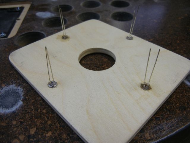

Next is what the top plates look like from the bottom, where the LEDs are glued and press fit into the plywood. I soldiered extensions wires to the LED leads to give me more room to play with underneath the cab during wiring up:

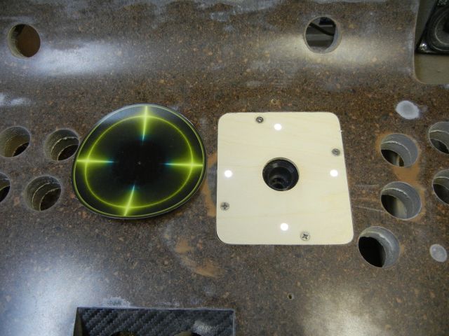

This is a pic of the top plate screwed down to the CP and sanded flush with the surrounding area. I still need to bondo the countersinks etc and give it a once over sanding:
A shot from below the CP and a quick hookup to see if everything still works...it did thankfully. The LEDs are rated at about 3v each, are wired in series with a small resistor and give off about a 1.5v output. I didn't want to push them, I needed to keep the heat down (if any) and didn't need the brightness they gave off at 3v. The power source will be a 12v line:
Image of the LEDs on and the graphic surround next to it:
Picture of CP as of now with the surround taped down and lit up with the LEDs:
Surround being lit up in the dark showing how the graphic matches the light sources coming from the LEDs:
