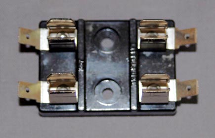

I would not recommend using them. Normally aparatus with IEC inlets need to be tested. The back of the plug has open AC current clamps that can be easily touched. It can even void your home insurance in case of fire caused by the cab. I would recommend leaving all components as they are build and use regular power bricks to connect the stuff. How often do you plan to detach cords anyway?
You can find open AC current all through a typical arcade machine; open fuse holders for example, like these - link. Either way, you could use heat shrink tubing or whatever over the open terminals on the back of an IEC power connector if it is a concern.
