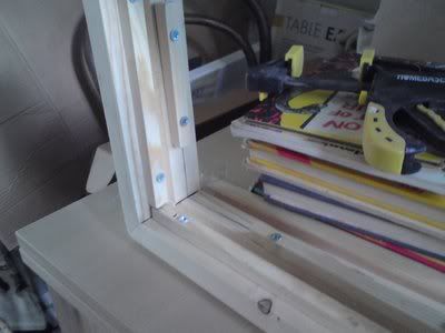

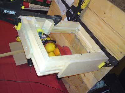

Now for the most time consuming part "The Rotating Monitor"
I started with a 21" viewsonic G810 monitor and 4 X 8 sheet of particle board someone gave me. Then after many measurements I decided to go with the two disc method. I then uncased the monitor and after many more measurements cut out the two disc and rotating base for the monitor to spin on inside the cabinet. I then put the monitor in the two disc using short 2X4s to space the disc apart and added four 1" casters to the bottom of the inside disc to facilitate the rotation of the disc.
Now for putting all this in the cabinet and getting it to spin smooth with a motor.
The motor I decided on using is a winshield wiper motor from the junk yard. I mounted the motor under the base and bolted a 2 1/2 "caster wheell onto the shaft which goes through a hole in the base to the top where the monitor is. I bolted the base inside the cab and made a 2X4 frame to hold 2 1/2" casters to support the monitor assembley on the edge of the disc so it would rotate with the motor.
The rotating assembly moves nice when the motor is powered up!
