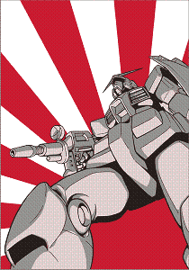

I'm basing my sticks around the artwork for them. I buy quite alot of tee's from www.terratag.com. I have this image on a tee and they also sell artwork prints of the image:
I'm going to edit the image so its suitable for a CP to something like this:
I don't know anything about art programs (execpt paint  :D) and ive been meaning to learn so I figured this is as good a time as any. I imagine this should be a good image to use with vector magic.

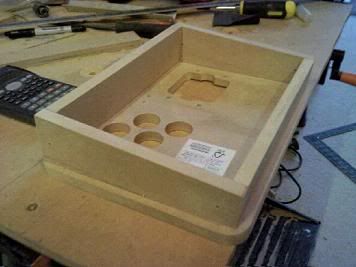

I'm going to start with a basic sloped rectangular box. I'm going to use 12mm MDF and then case it with 3mm acrylic sheet. This adds up to 15mm so I can use white 5/8" t-moulding (with a ~0.4mm hangover eitherside).
I'm planning on using red and white acrylic round the edges and I'm going to cut it so that the suns rays extend onto the sides of the controller.

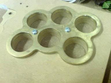

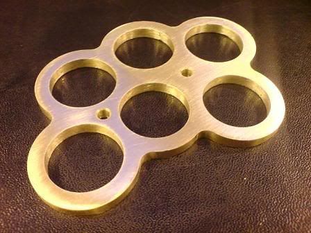

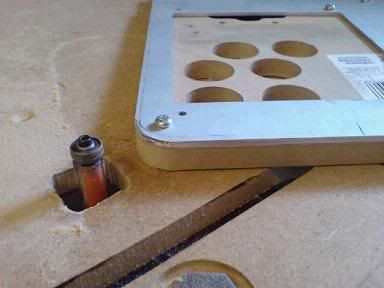

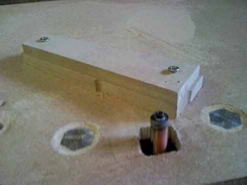

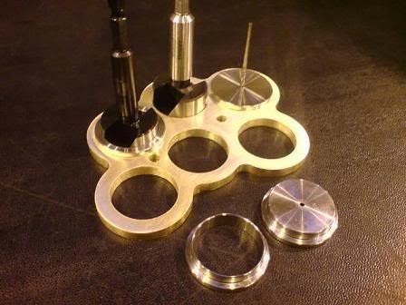

I have made the brass template to template route the acrylic button bezels. I've been waiting ages to get this on the machine but I have finally got it done. Ignore the smaller holes for now:
The hole positions are an exact replica of the 'standard' Jap layout. (8th one down on the slagcoin layouts page IIRC). The diameter of the circles that make up the outer profile is 43mm which will leave a 5mm band between the buttons actual bezel and the acrylic button bezel.

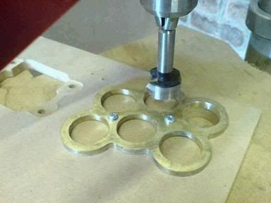

I can use the template to template route the bezels before putting a slight bevel on the outer edge before polishing with novus.
The template will also act as a drilling jig to accurately drill the hole positions. This is important as the holes in the MDF etc need to line up perfectly with the holes in the button bezel so that the buttons go through.
I made the holes 30.1mm so that they will guide a 30mm forstner bit (for jap buttons). I may need to make some panels with Happ etc buttons that require a 1 1/4" (28mm) hole so I made some sleeves that reduce the diameter down to 28.1mm. I also made some sleeves with a 2mm hole for finding the exact center of the holes for other processes.
Pic of the template with 28mm forstner bit in 28.1mm sleeve, 30mm forstner bit in template and 2mm drill in 2mm sleeve:

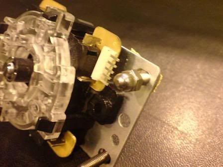

The two smaller holes are for clamping the template to the MDF. When using the Jap snap in buttons there will be nothing to clamp the 3mm acrylic to the CP so I'm going to bond some flat M5 machine screws (see further down) to the back of the button bezels which will then hold the acrylic to the CP.

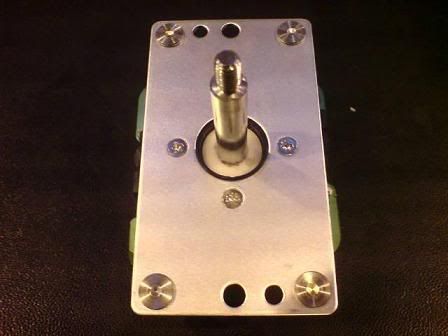

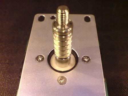

I'm also going to use the flat machine screws to bolt the JLF sticks to the CP. The JLF will be top mounted and the mounting plate needs to be as close to the top of the CP to maintain the joystick shaft length. I couldn't find and flat head screws with a thin enough head so I bought some M5x16 hexed dome head machine screws and faced them to leave a 1mm thick head. Here is a pic of the faced screws next to a stock one:
You can also see the M5 dome headed nut I'm using to bolt the JLFs to the CPs. They are about 5 times  more expensive than standard M5 nuts but they will look pretty :)
This is a pic of the faced M5 screws in position:

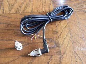

One problem I have found is that mounting the joys like this will mean that the JST connector will foul on the nuts as can be seen below:
To resolve this I'm sourcing some vertical JST pins which I'm going to solder in the place of the stock ones.

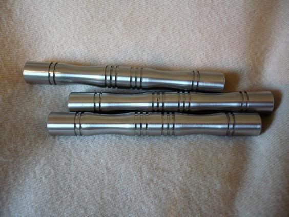

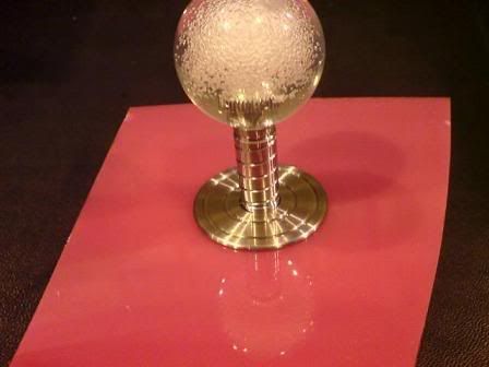

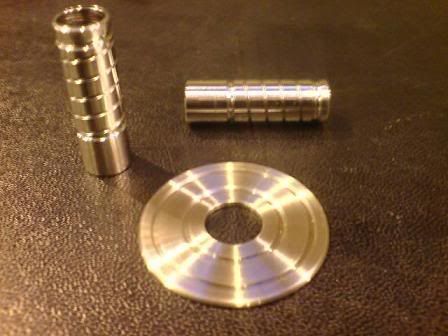

Ive also made some 11mm stainless 'candy cane' sleeves for the JLFs and matching washers. The washers have a bore of 11.5mm which allows the shaft to move freely but so that there isn't a huge gap between the two:
You can see that the scroll is offest from the middle of the stick. This is because the sleeve fits right down to the nylon elbow of the joystick:
If the scroll was central the lower part would be hidden by the 3mm acrylic CP top so I offset it so that when the acrylic is applied the scroll will be central which should look something like this:

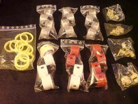

Ive also received my buttons from arcadeshop.de. I bought six red PS-14-GN-CP's, six white PS-14-GN-CP's and twelve translucent snap in PS-14-K's as I haven't decided which colour combo's to use yet. I also picked up some PCB feet whilst I was at it. It turned out to be pretty damn expensive (~£80) for the whole lot due to the crap £>Euro rate but I didn't want to risk import taxes by going though lizard lick.
They also included a nice suprise in the package, a DK lighter which I think is the coolest thing ever  ;D (yes I'm easily pleased!):

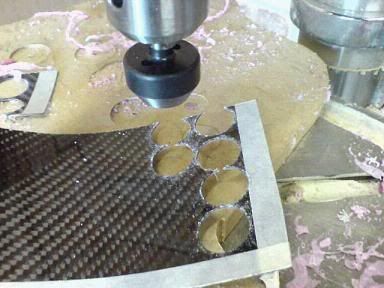

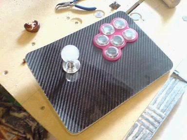

I've started on the carbon fibre stick first. I top mounted my JLW in some 12mm MDF. I did a little guide [here].
I've made the CP as small as compact as possible while still retaining a decent area to rest my palm etc. I think the panel is approx 8"x11".
I used the brass template I made as a jig to drill the hole positions. They're is only about 0.002" clearance between the template and the forsnter bits so the holes should be well within 0.004" of the dimensions on slagcoin:
I used the back door template from pinky to route the radius on the corners:
Ive made the four sides out of 12mm MDF too. I was going to have a 10 degree slant but it looked too steep so I went with 5 degrees in the end.
I used the age old trick of using one side of the CP base identical to the other one by template routing them:
I'm using some 0.012" thick genuine carbon fibre with a 3M adhesive backing to face the CP top and the sides. I was a bit worried about how well it would cut but it routed and drilled fairly easily. I was also worried about the edges fraying but it has held up pretty well.
It would be too expensive to cover the inside of the stick with real CF but I have some CF effect vinyl which I'll use just to keep everything pretty.
I made some hardened steel punches to punch out inserts for the buttons but I found it actually works better as a hole saw:
I made a bezel out of 3mm pink acrylic to frame the buttons. I'll be using 3mm thick mirrored acrylic but I used a spare bit of pink I had laying around to practise on:

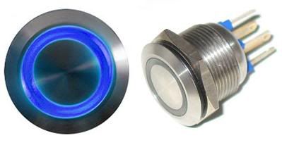

For the two 'admin' buttons I'm going to be using two Bulgin blue LED illuminated 'vandal' buttons which will be located on the front panel:
The ball top will be blue LED lit and I'm going to try to get some JLF shafts made but with an extension on the bottom to hold a plug and 3.5mm jack so that the joystick can spin freely.
I think that's about it for now. I've bought some 360 wireless pads and I'm going to have a go at hacking them tonight, wish me luck!  :)

  Hi Franco. You can count on adding 35-40mm to the needed mounting depth if you use an extension to mount the 3.5mm audio jack. An upside to this is soldering the wires will be a little easier. I will warn you, keep the wires as short as possible before stuffing them inside the shaft. There isn't alot of room in there! Try 30 AWG " wrapping type" wire for the best results.
 I posted some pictures of this mod. Note in picture #2 the two 3mm set screws orientated 180 degrees apart that hold the extension on. I added matching center drill dimples to the lower end of the shaft below the cir clip (only around 5mm extra material below the cir clip is needed). Also note the material I used for the extension is called Black Delrin. I used this material as is not electrically conductive and works great with steel line jacks. I doubt this will be a problem for you as I see that your female jack is plastic.
 Cheers.. :cheers:

Where is that cable / connector from? is it a 4-core circular one as it looks?
Looks perfect for my evil RGB magstick plus plans
Cornchip
  • Posts: 228
  • Thinking up more crap....
Re: Franco's Custom Sticks (Update: Carbon Fibre Fun!)
« Reply #25 on: March 16, 2009, 05:23:33 pm »
  That one there is a two pole. Both ends are available in 4 pole as well. I can imagine how much fun you'll have stuffing 4 wires into the shaft.   :P

   Ok..must similar to his U360 concept shaft with the cir clip above the ball pivot. That would save an easy 20mm and be quite a bit simpler over all to make.  ;)

That mod has nothing to do with low profile CPs such as these as the extension makes it far too long. That was just a quick and dirty mod for Haruman's cab and one of my Naomis.
A couple of months back I came up with a similar solution but the end of the plug is flush with the end of the end of the stock shaft. That was no mean feat as I had to redeisgn the whole shaft and plastic shaft components for it to work. I could have used that version for Haruman but it would have taken much longer to get all the parts together.
Edit: I forgot to add, the mod for Haruman was to get a 5mm RGB LED in the shaft.

  Yes..your previous U360 concept  shaft (or this JLF)  was a better solution than this multi-piece mod. That's why I'm surprised you used it.  Call it quick and dirty as you will, but it is much easier to assemble when it comes to wiring the RGB and stuffing the wires back inside.
  Also don't forget to add a piece of tin foil between the plug and jack to assure a solid contact on that pole. The end pole has no spring contact inside the female socket, relying on the male end to be pulled inward by the spring contact of the first pole and others (contact is made face-to-face rather than on the diameter). The very act of moving the stick around can cause a very brief 'blink' caused by the momentary loss of contact. There is a better 4 pole socket available made completely from metal that has stronger contact force than the plastic socket. Also, there is a way to modify the metal socket so that the male end goes in with a strong 'click'. So many of these line jacks are poorly made as far as contact force is concerned for what you pay.I'll keep that to myself for now.  ;)
