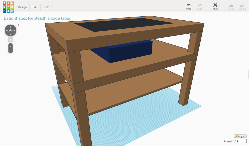

The current plan is this:
To buy two LACK coffee tables from IKEA and convert them into a single table with a solid section for all the arcade parts, with the hope that when it's not running it simply looks like a coffee table with a TV mounted in the top.
For those who don't know the LACK table, here's a link to the website:
LACK Table
Here's a basic 3D rendering I threw together in Tinkercad with 3 of the sides left off of the upper section as I don't know the final design yet:
The blue box in the photo is the footprint of the PC in it's case, but this will probably be stripped out of the case to make more room.
(Oh, tinkerbox is a pain to use for doing the 3d rendering, it's not made for items this big.  If anyone knows of a good package that is easy, free, and can handle designing something large, please point me at it. :) )

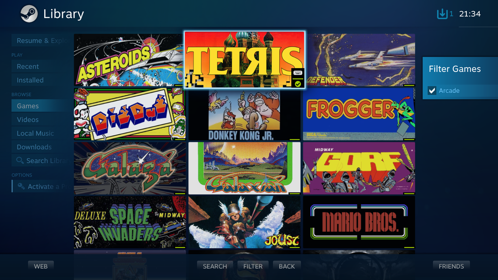

The Frontend will be Steam Big Picture.  This makes it easy to run Steam\PC games as well as the older stuff and ICE handles multiple emulators and adds them to Steam as links, see below:
(For anyone interested I've written a little batch file that shuts down steam, runs ice, shuts down ice and restarts steam.  Makes it a little more convenient to use.)

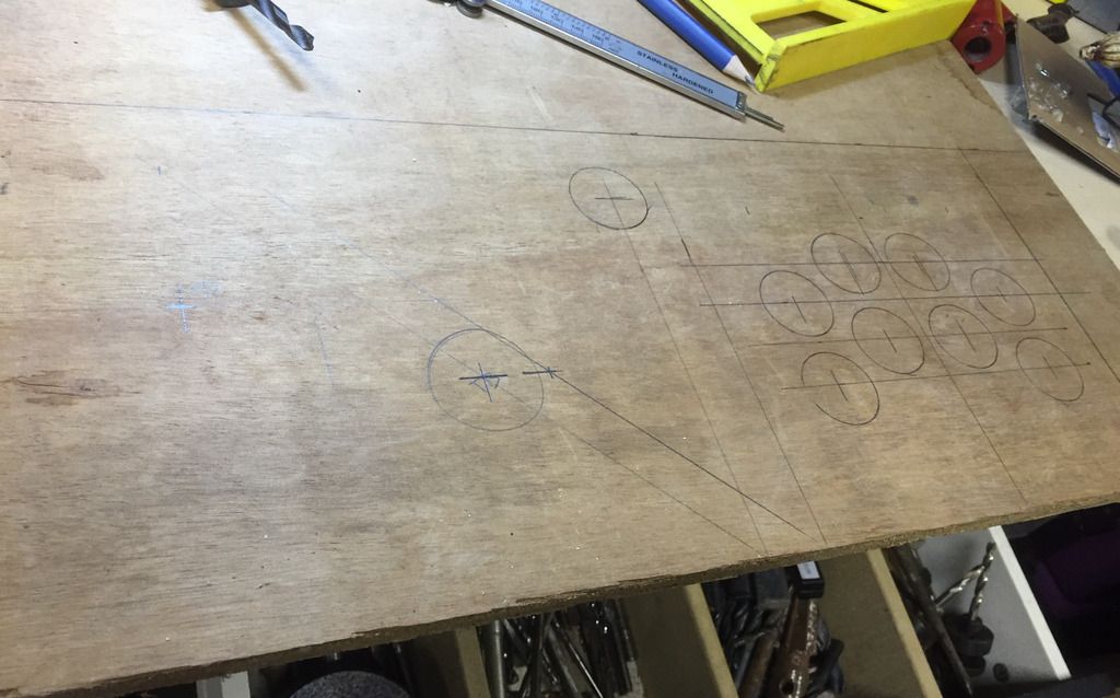

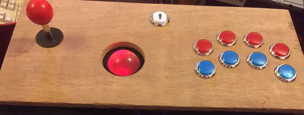

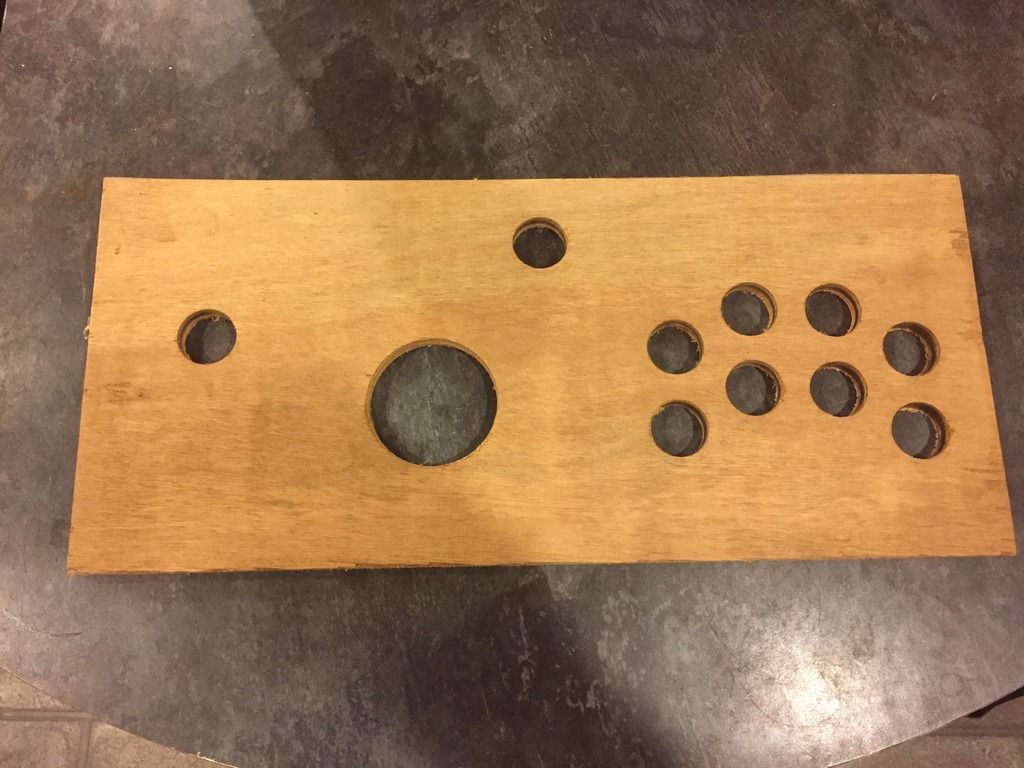

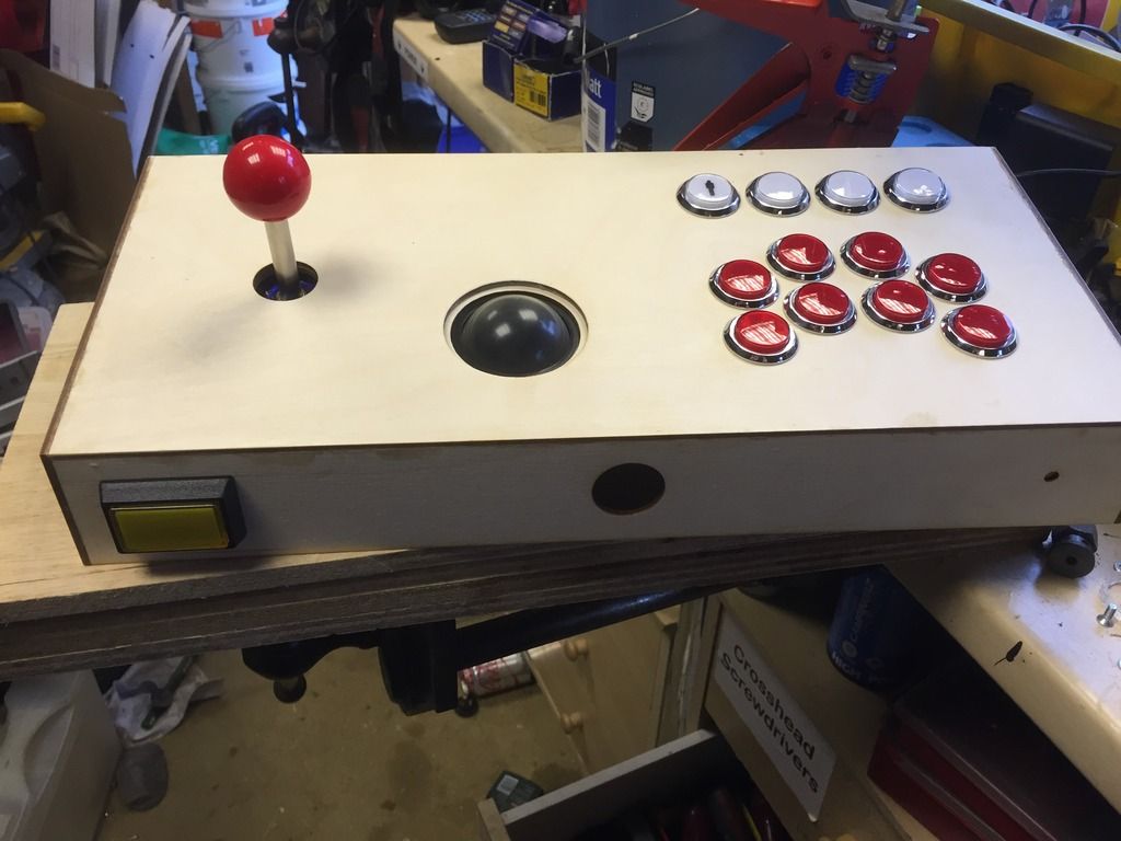

Ok, so I've mocked up the controls in a bit of ply I had lying around...
It's a little tighter than I'd like but that's the maximum space I have.
Plans are to add an exit, pause and screen rotate button to the top, an add credit and plunger (going to try and emulate a real pinball plunger, but may go with a launch ball button) to the front, and paddle buttons to the side.
As yet I'm not sure how to handle 'nudge' buttons.

« Reply #6 on: October 16, 2015, 08:41:22 am »
Those buttons look fairly far apart, unless you have huge hands it may become very uncomfortable.
DisFanJen
  • Posts: 35
  • Last login:December 29, 2015, 05:59:58 pm
Re: Stealth cocktail style cabinet - A Noobs first build
« Reply #7 on: October 16, 2015, 11:45:41 am »
Yeah, on this version they were placed based on the way it looked rather playability.  The dangers of eyeballing it I guess.
I'm getting help fleshing out the final design in the main forum and that was one of the first things pointed out.  They'll be closer in mk2.  :)

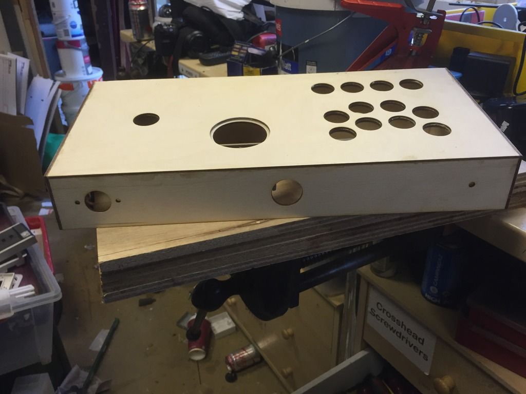

Update:

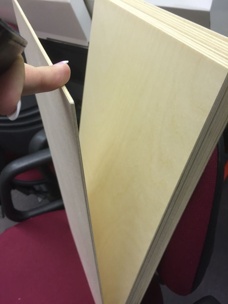

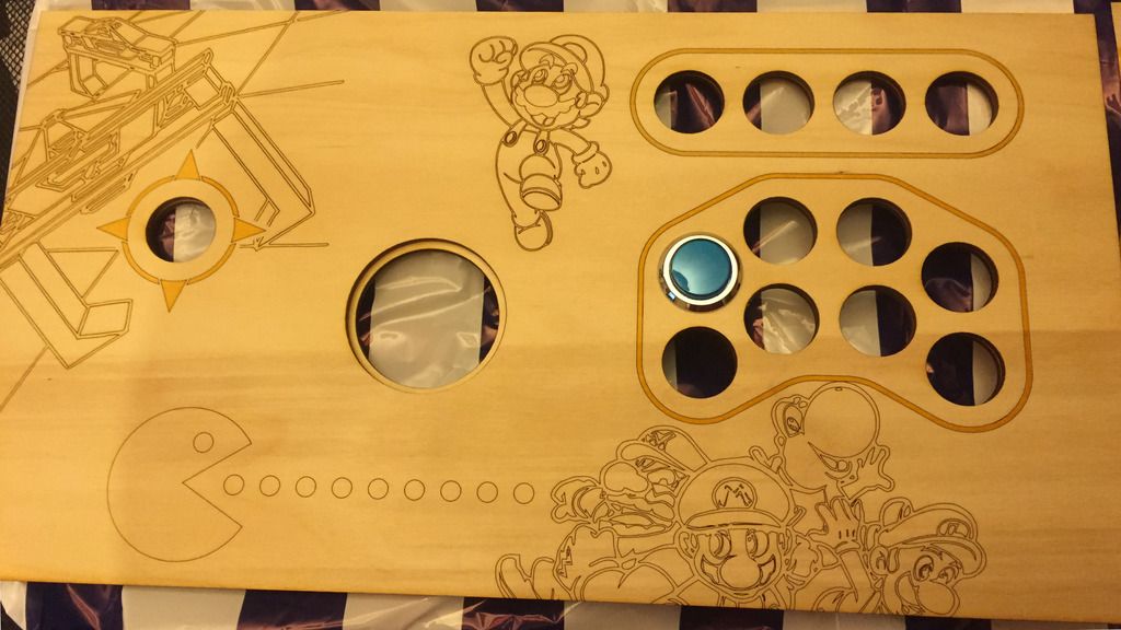

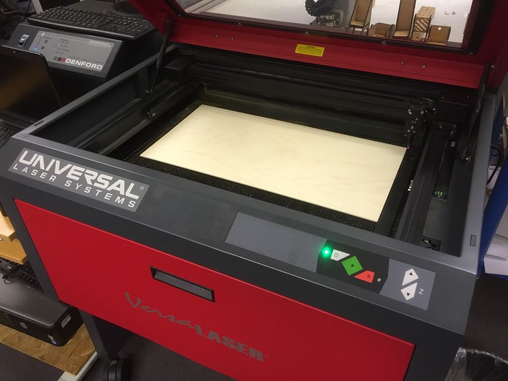

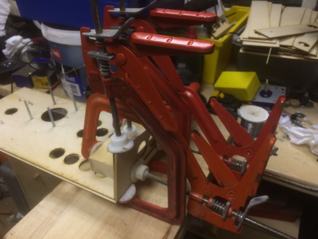

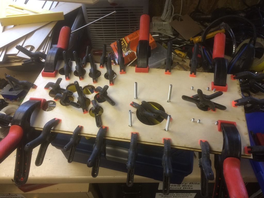

So, after getting prototype 1 out of the way we played with a few ideas then decided to up the anti for mk2...
Did I mention that my partner works in a school with a D+T speciality?  Laser CNC machine for the win! :)
This is what I used for mk2.
It looks a bit thin but it's special laser quality hardwood ply and it's tough stuff.  Even so in some areas we are doubling up the thickness.
We made 2 layers for the top and sandwiched mounting bolts in it turning them into captive bolts.
You can never have too many clamps! :)
Then the first side went on, which will actually be three layers by the time we're finished, but more for the looks than for the strength.
Well, the glue takes a while to dry so this is as much as I have to show right now but you can probably see that the buttons are a lot closer and the admin buttons are above the gaming ones rather than in the center.  I'll post more pics when it's together enough to get a better picture.

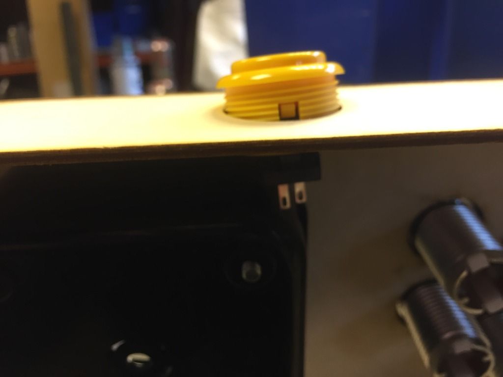

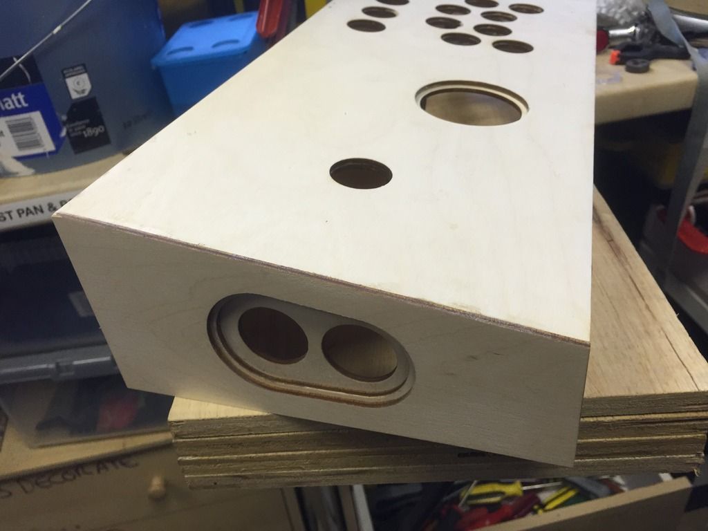

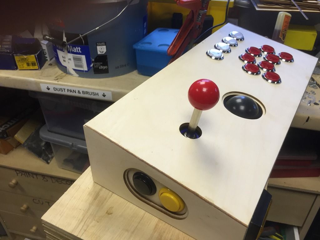

Well, I said part of this is so people learn from my mistakes, and here's the first one!   :lol
Mk2 of the design is pretty much glued together, and here it is:
Looks pretty good right?
Well, till you hit this photo...
Doh!
Well, to paraphrase an old woodworking saying: measure twice, laser once...
We allowed the room for the flipper and nudge buttons on the sides, but not the front, even taking into consideration the fact that we bought lower profile buttons for the nudge and flippers (Seimitsu PS-14-GN 30mm Screw In Arcade Buttons for those interested).
Rookie mistake.  Luckily we have more laser wood, it just means another week or two to build Mk3.
Hmmmmm..  What is the ply?  Birch? Poplar?
DisFanJen
  • Posts: 35
« Reply #15 on: October 26, 2015, 12:43:58 pm »
3mm Laser grade Birch Plywood from Hobarts, a laser material specialist.

Few things...
Kudos on the lasering, i've just started CNC, so great work.
 :whap
Buttons are spaced too far apart from the jstick, you jstick is higher than your buttons.  I would stick to the slag coin spacing.
The admin buttons are above your action buttons, watch how many times you slip up and press one of the admin buttons and screw up a game.
The PS/2 mount, what are you gonna do with that extras space around the tball? And that should of been placed to the far right.  I have some refurbed happs tballs and mounting plates, but top mouting will be difficult due to your material thickness.
I thought the plunger was always on the right side of the table?
Other wise, very cool interested to see where you take this.
« Last Edit: October 26, 2015, 02:49:14 pm by rablack97 »
DisFanJen
  • Posts: 35
« Reply #17 on: October 26, 2015, 04:23:57 pm »
Few things...
Yeah, it's very handy having everything mm perfect.  So much easier to assemble.
That's deliberate.  See below...
I thought that too initially, but it's the best placement as I think putting them over the tball will be more problematic and it just looks lousy over the j-stick.
The PS/2 mount, what are you gonna do with that extras space around the tball? And that should of been placed to the far right.  I have some refurbed happs tballs and mounting plates, but top mounting will be difficult due to your material thickness.
And here's why it's in that configuration.  I'm left handed and the only one interested in t-ball games.  The t-ball to the right would be useless to me and after some experimentation and talking to people on the main forum this is pretty much the best configuration for me.
As I see it I'll be using the j-stick or the tball, not both simultaneously, and I'd like to operate both with the same hand so I'm always working the buttons with my right hand.
Though if I went the whole hog I'd reverse everything and put the buttons on the left so my dominant hand was doing the button pushing (as I'm faster with that hand), but that'd be unfair on other people who come and play on it.  So the only concession to my left handedness is the t-ball placement. :)
The plunger is going to be on the right.  See the small hole?  That's for a fake plunger system.  With any luck I'll actually be able to pull & release. :)
The button on the left is an 'add credit' button.  I put it on the front for nostalga sake I suppose.  I cant have a front facing coin draw but at least the button can be there. :)
Thanks.
I admit it's getting a little daunting with adding the pinball functionality, having the orientation change (which it looks like none of the current crop of front-ends handle well, so I'm now writing my own), etc.  But So far I'm happy with the progress. :)
« Last Edit: October 26, 2015, 04:48:12 pm by DisFanJen »
rablack97
  • Posts: 2215
« Reply #18 on: October 26, 2015, 06:13:13 pm »
I guess my thinking is you have maybe 5-10 classis t-ball games that you will play, and the rest will utilize jstik and buttons.
I'm a lefty as well but yet as you see the actual Centipede T-ball is on the right.
So regardless if you were left or right handed, you were going to learn to fire with you left hand and control with right.
This is my setup on a mini.
The buttons don't look bad above the stick, and because your grabbing the controls your not gonna slip and press the buttons above.
Also, what are the 4 admin buttons, start credit and pause is all you need, Exit, mame dont need to go directly on the CP.  None of the other 3 will screw up your game while playing, and i thought you could set the rotate function by game in mame config files, so why would you need a button for that?
However it is preference, so if your comfortable playing with your buttons that far from the jstick, then by all means.
« Last Edit: October 26, 2015, 06:18:16 pm by rablack97 »
DisFanJen
  • Posts: 35
« Reply #19 on: October 26, 2015, 09:48:46 pm »
I tried working the tball with my right hand and I honestly hated it.  It's much more natural in my left hand.
Again, I tried mocking it up and hated the way that looked, and putting them over the tball as I orginally planned got a much bigger "don't do that" vibe from people.
Ok, I have:
Add credit (on the front)
Player 1 Start
Pause
Exit
Screen Rotate
As I'm using multiple emulators a dedicated exit that joytokey can remap to what is needed for the specific emulator running seems the best.
I understand that some people say that I should just rotate mame and not the whole screen but like I said I'm intending to use multiple emulators and I want the front end to display in the correct orientation for the games I'm playing and only offer the games that work in that orientation.  I'm sorting out the software as we speak and the easiest way to handle the transition is to use the video cards inbuilt rotation system.
So far it seems to work for me, but if it turns out to be a problem I can just re-build the control box. :)

After a bit of break due to having to do actual paying work for people, I'm back to the project.
Here's the top of the Mk3 version of the control unit:
We've made some more room at the bottom of the buttons and the t-ball (still a bit of a compromise but the best we could do) and as we are keeping the main part of the unit just looking like a coffee table we decided to leave the control unit in wood, so used the laser to etch some artwork onto it.
Some of the designs aren't prefect due to converting a raster image to a vector one for the laser but I actually like some of the imperfections, don't know why, I just do. :)
With any luck, unless we hit an major problems with this build up  this is going to be the last iteration of the design for the control unit.  I'll post more photos once it is together.
