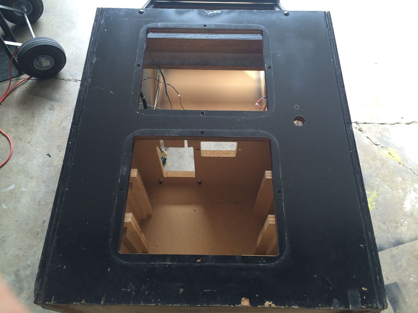

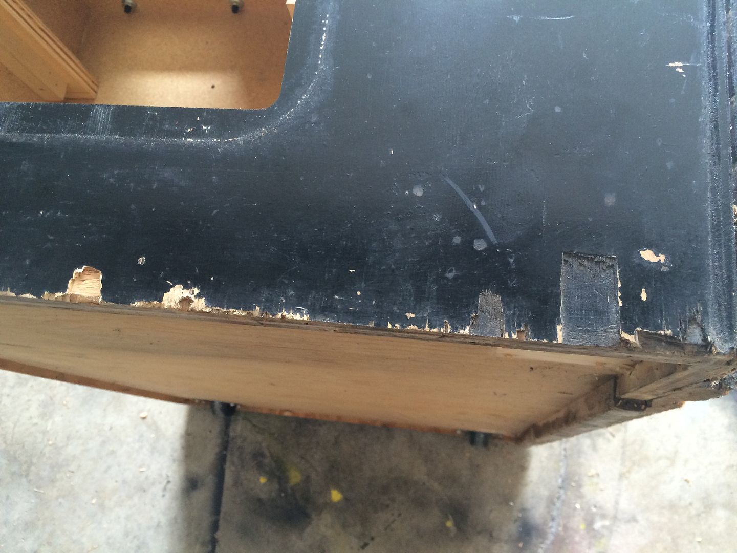

Recieved most of the parts and art that I ordered.  I have to say both mikesarcade and arcadeshop.com were extremely quick in shipping my orders out!  I have been stripping down the cabinet and trying to get a paint match.  I grabbed some of the codes from another thread but that was lighter than my cabinet so I have 2 more samples ordered.  Amusingly the 8oz behr sample paints cost me $4 in store and $2 online, with free shipping to my home...so strange!

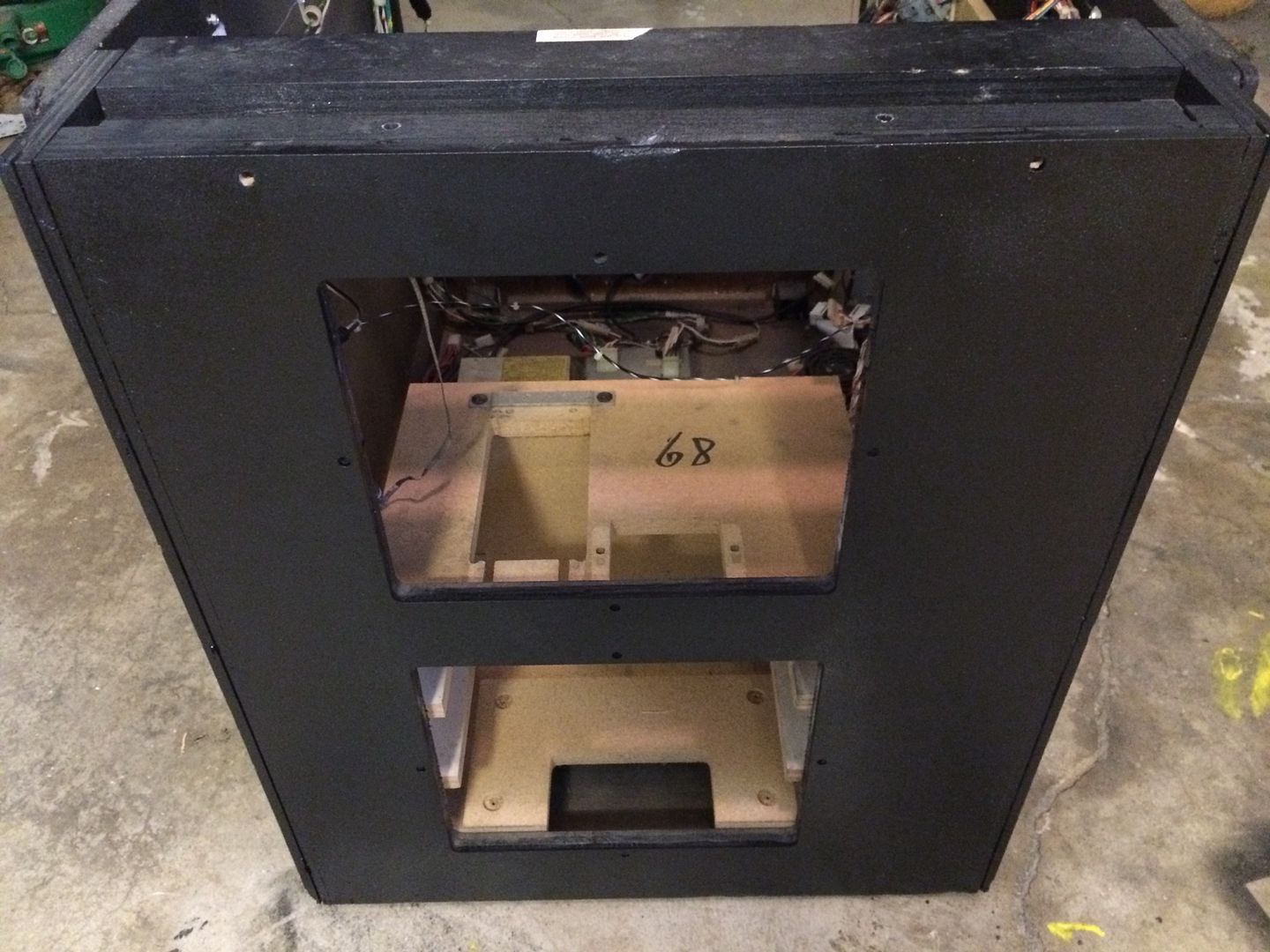

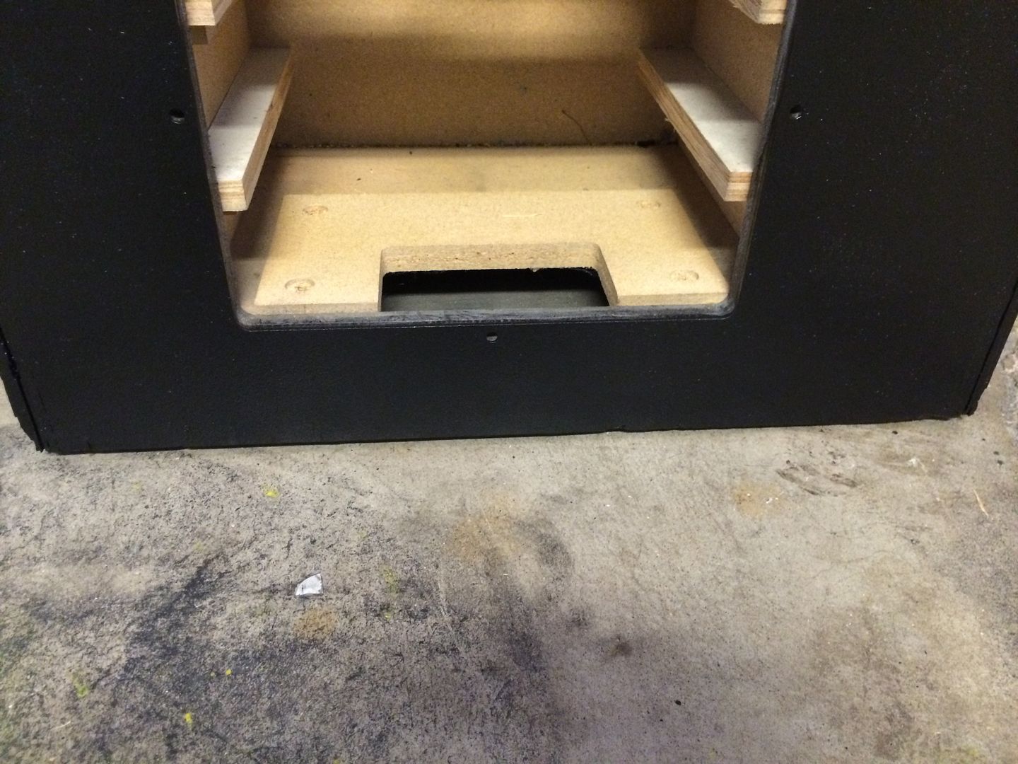

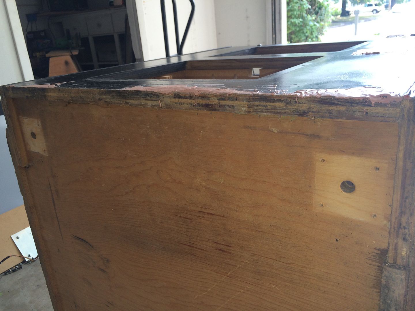

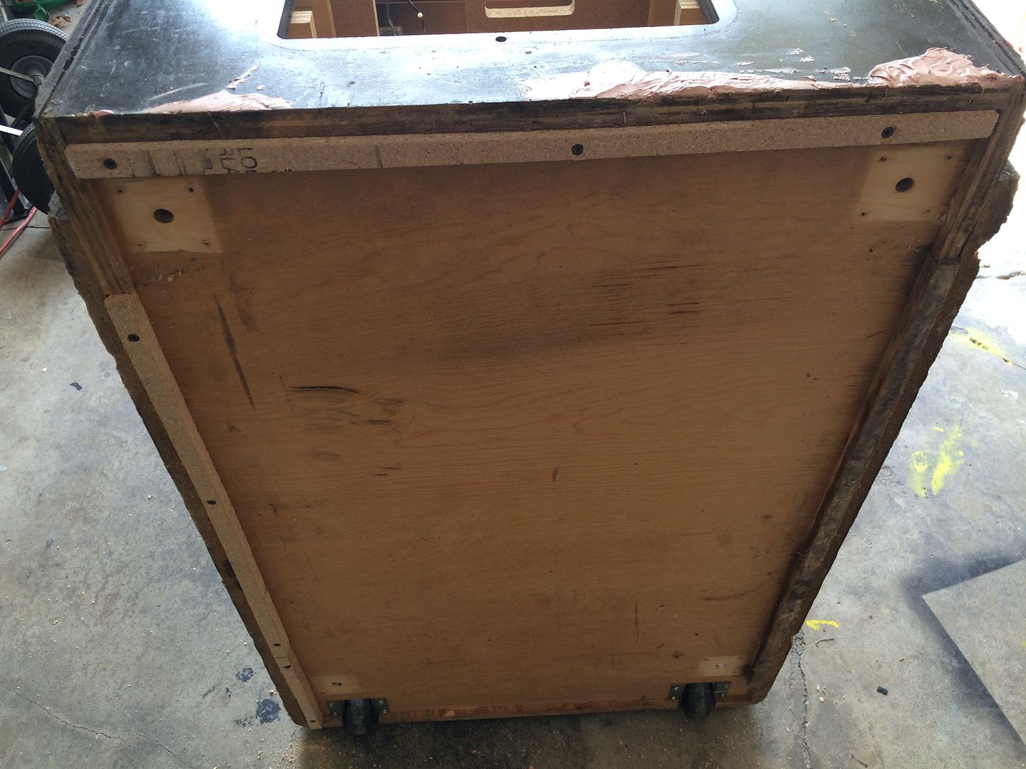

Anyways, I have the base glued up for repair.  One corner has some wood splintered off so I may bondo that before sanding and repainting the entire base of the cab.

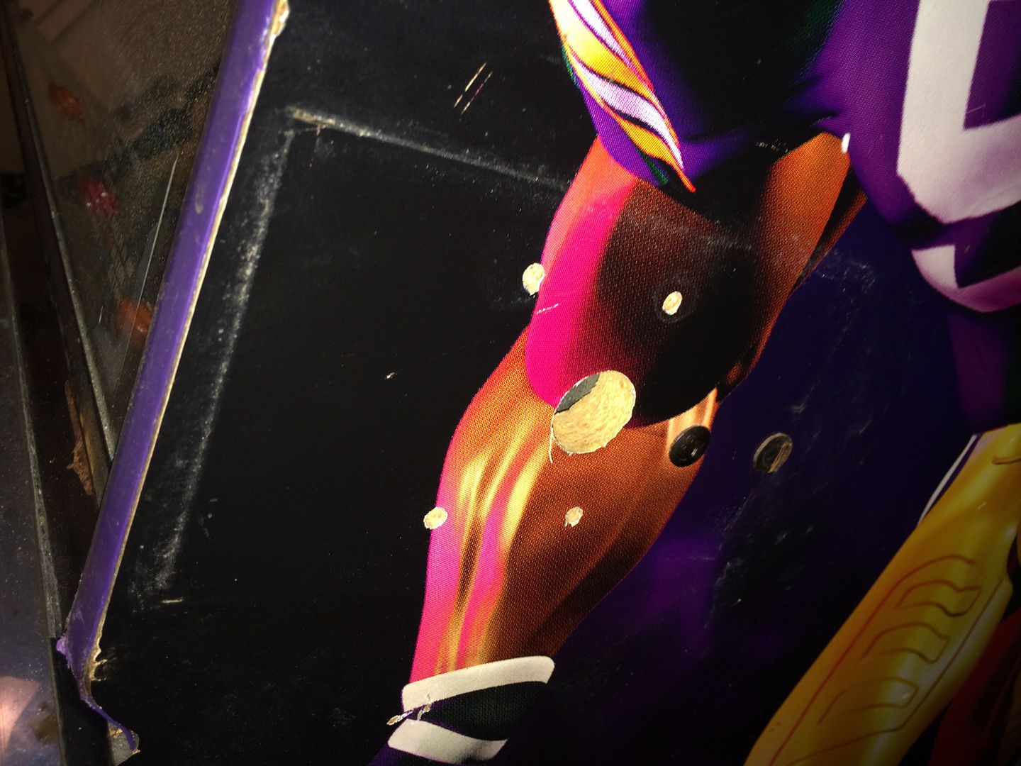

Stripping off the damaged artwork:

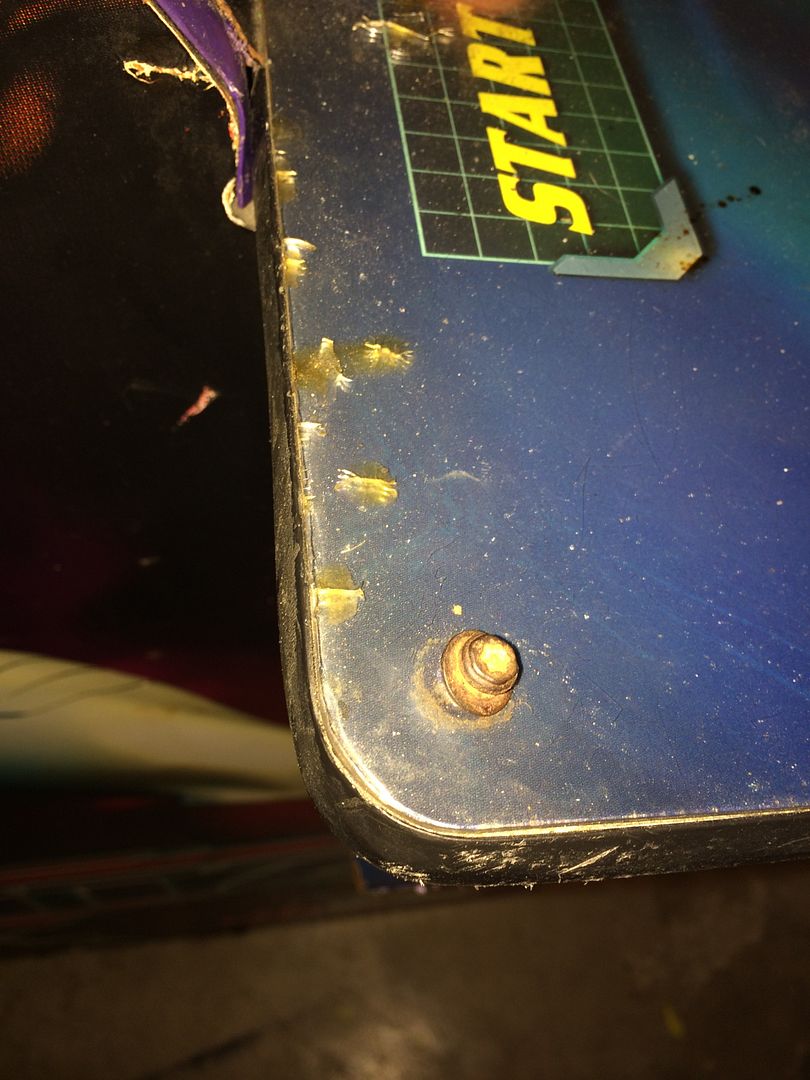

I took apart the cp and joystick completely.  I am in the process of cleaning out and polishing all the metal parts of the stick (kind of a crappy picture, I should have taken some before pics of the parts of the joystick oh well!:
Up next is finish polishing up the stick, re-lubricate and re-assemble it.  Then put the whole CP back together with the new artwork.  In a week when my paint samples come in keep trying to find a good match for the DK blue.  I really want to just touch up the vinyl rather than re-paint the whole thing!

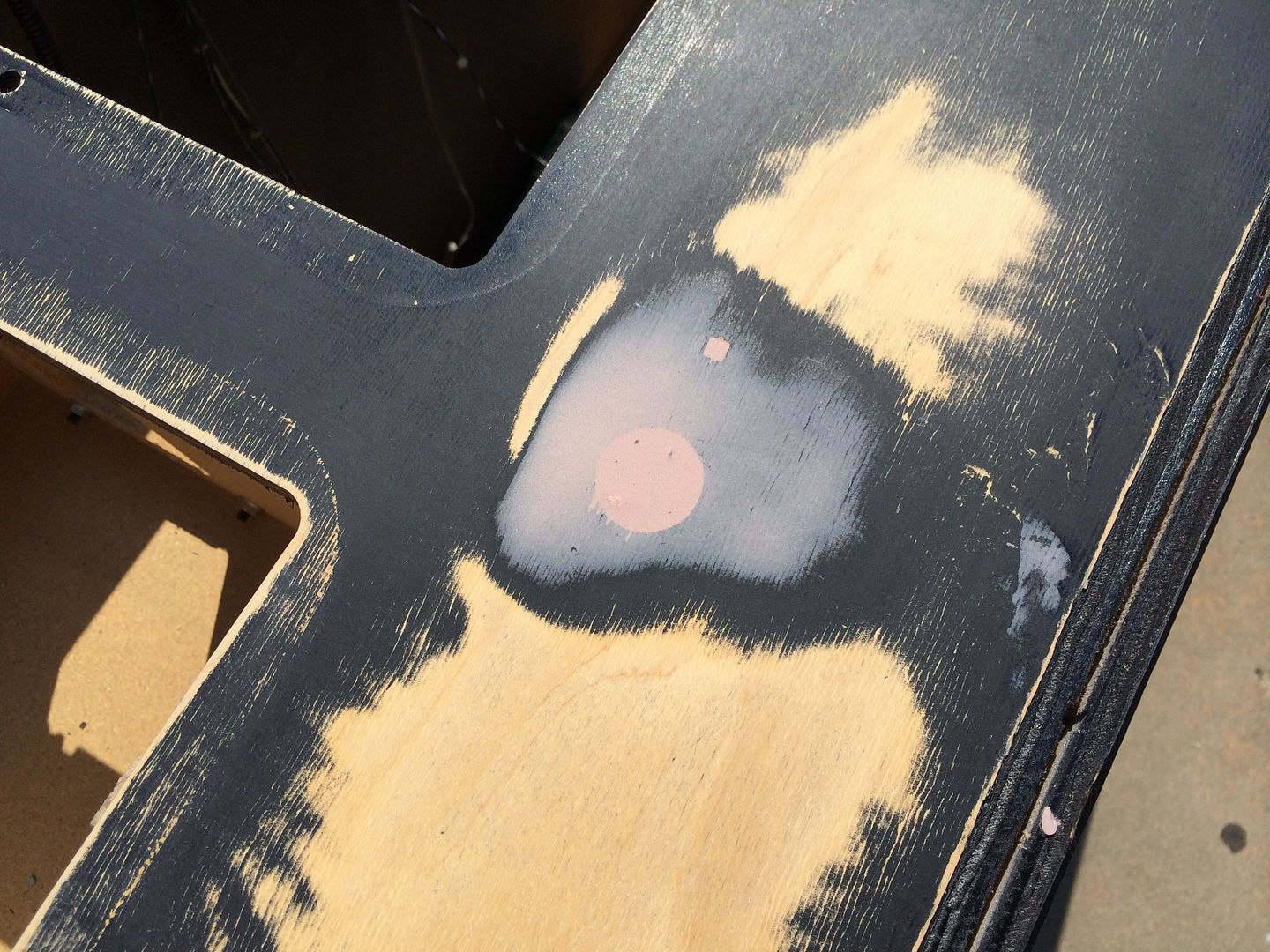

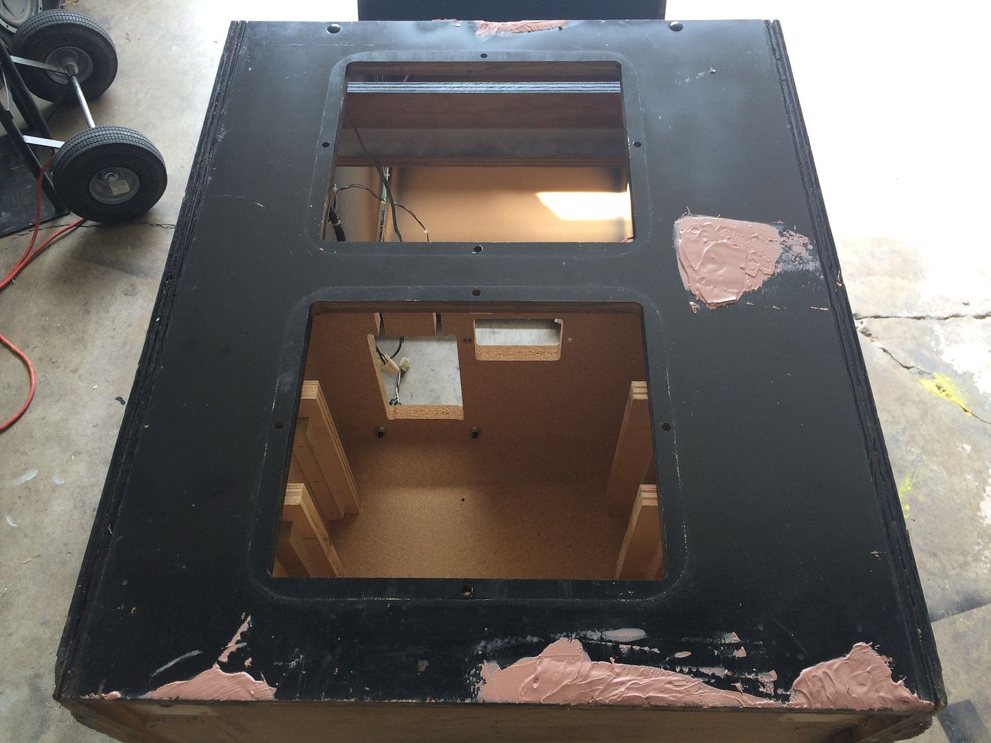

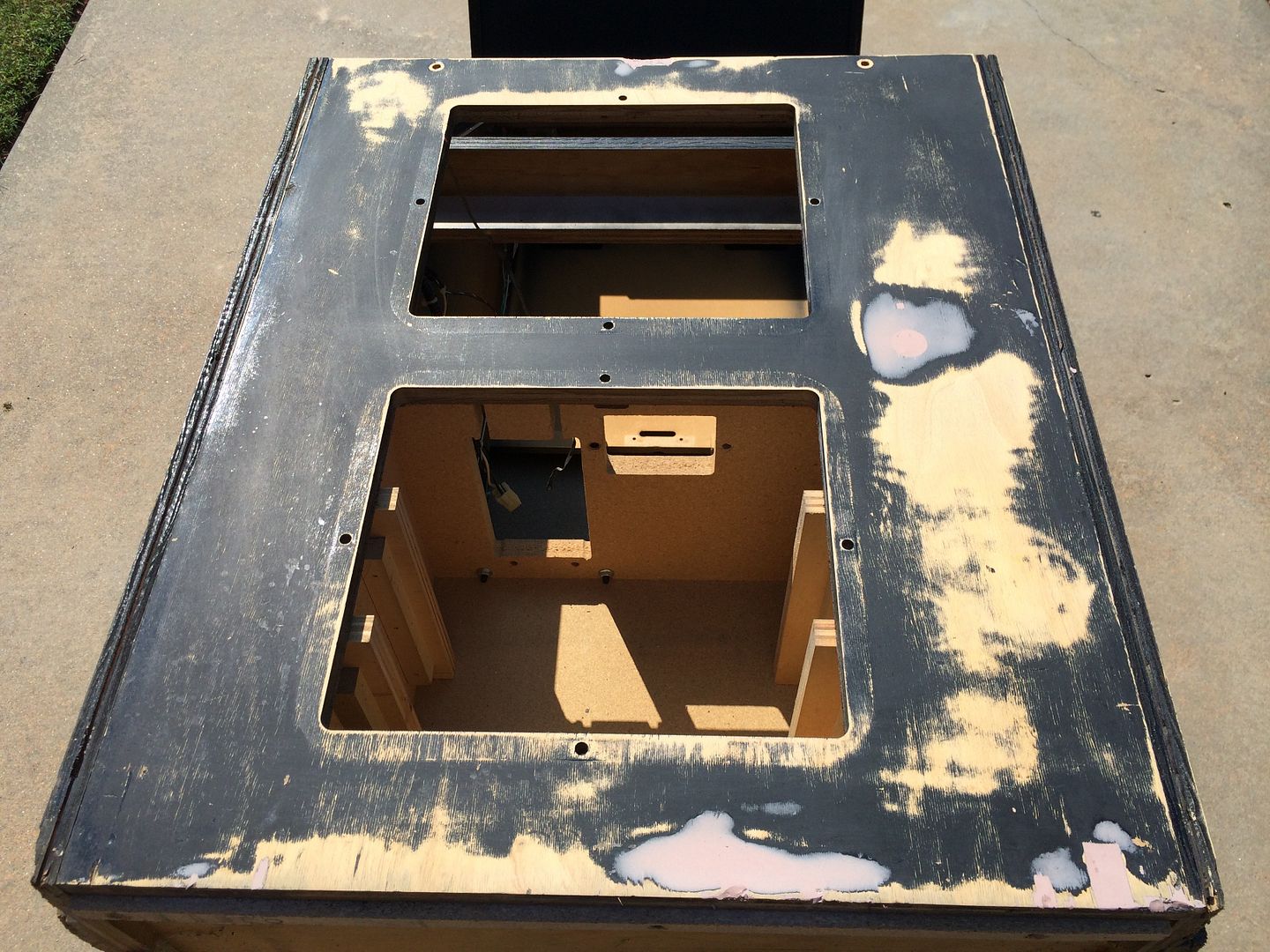

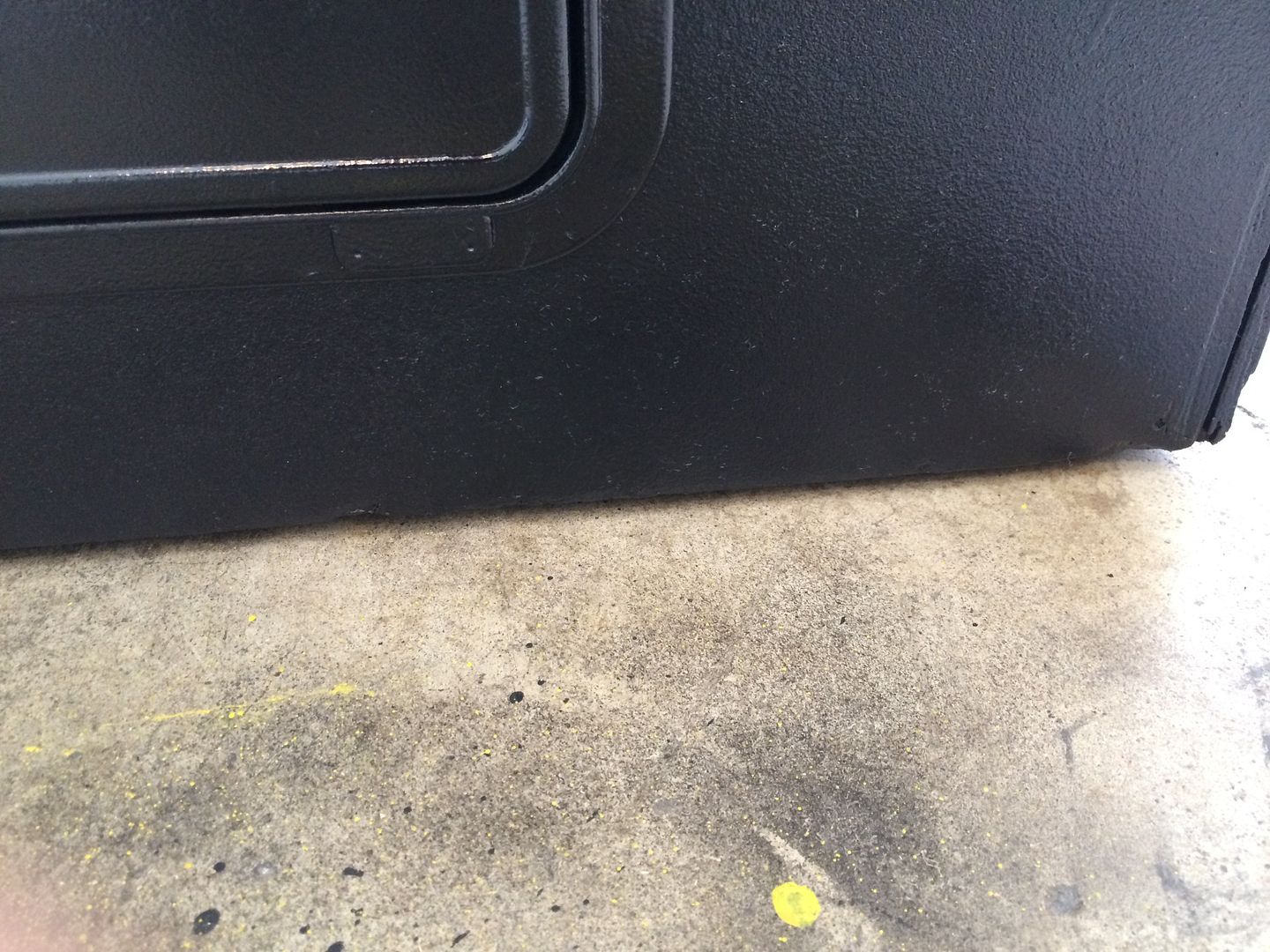

I have cleaned off all the old damaged artwork.  Goo gone and a plastic scraper (for removing car panels undamaged) are a great combination for sticky residue!  I patched the few areas where there was damage with bondo.  I also filled in the unused 6 monitor bolt holes.  As far as I can determine next is to do the touch up paint and the black paint on the back of the cab.  I want to do the paint before artwork just in case I hate how it looks and decide to sand and paint the whole cab exterior.

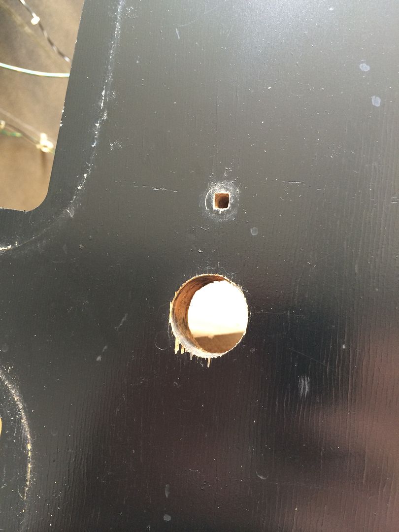

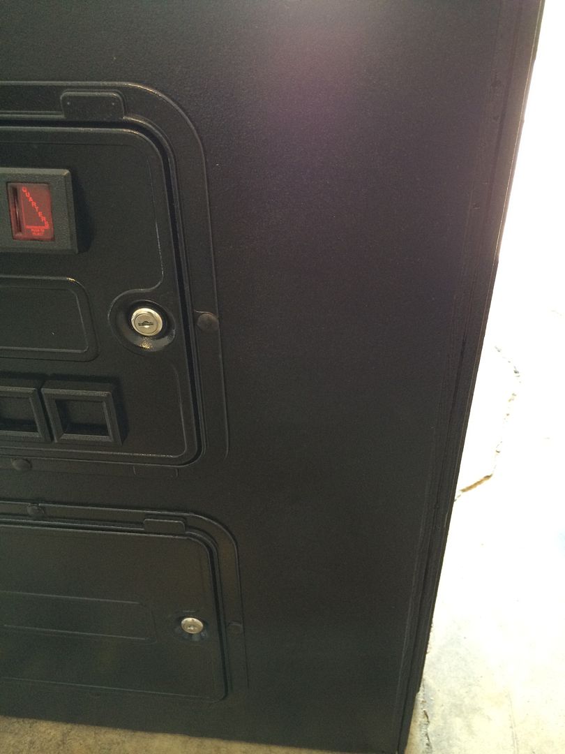

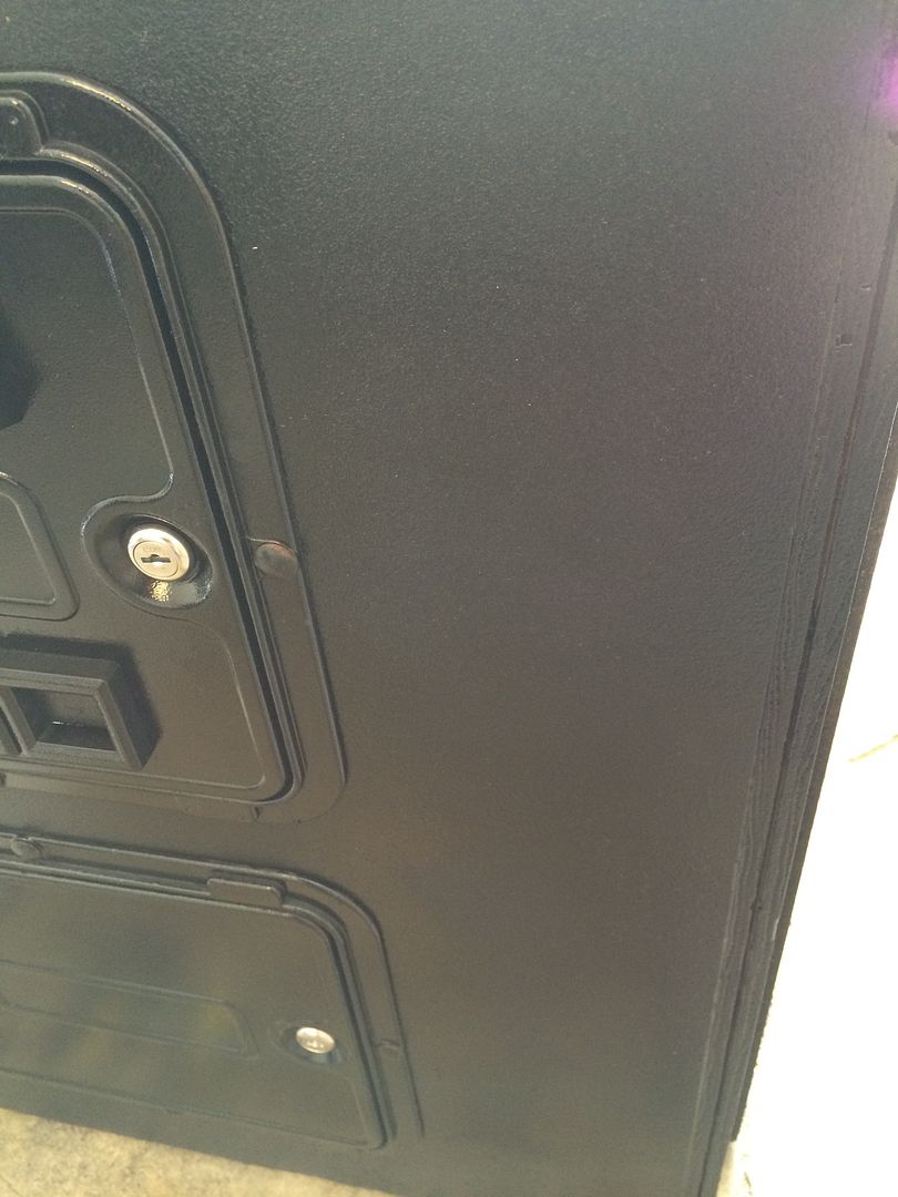

Finished the restore!  I touched up the paint where it was damaged.  Replaced the artwork and T-Molding.  I have to say the new T-Molding is probably the biggest change visually to my eye.
Also I added some switches to the coin mechs.  Both mechs are still fully functional but you can now press the coin return for credits as well.  I used existing holes in the mechs and used added wiring without damaging the existing wiring at all.  The entire change is removable.
