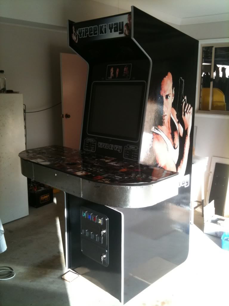

With these things in mind, I set to work. This project essentially began on Jan 1st 2011.

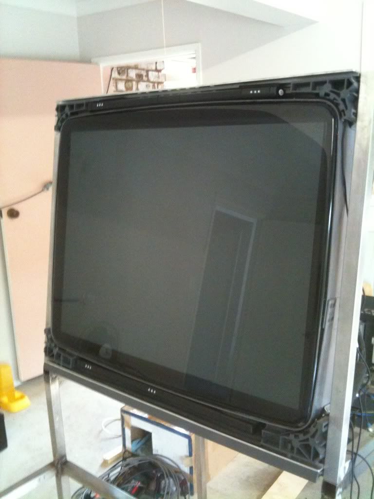

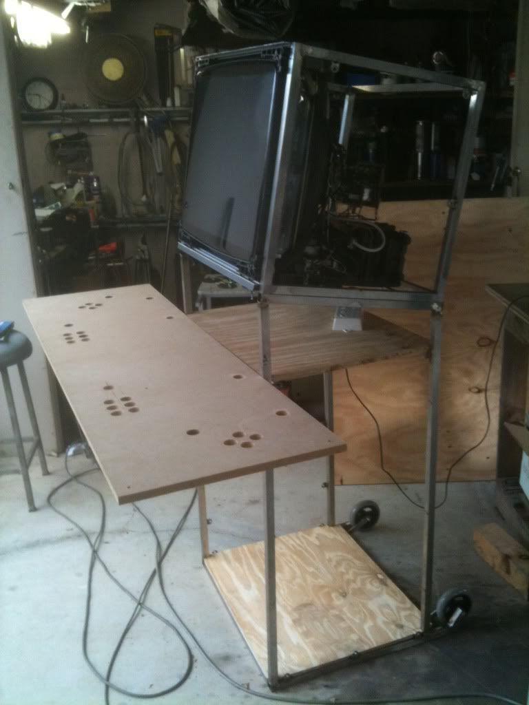

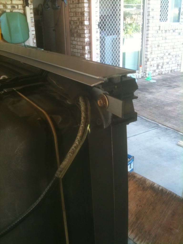

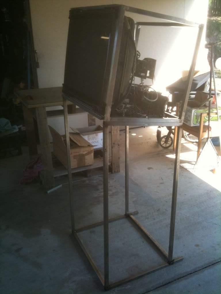

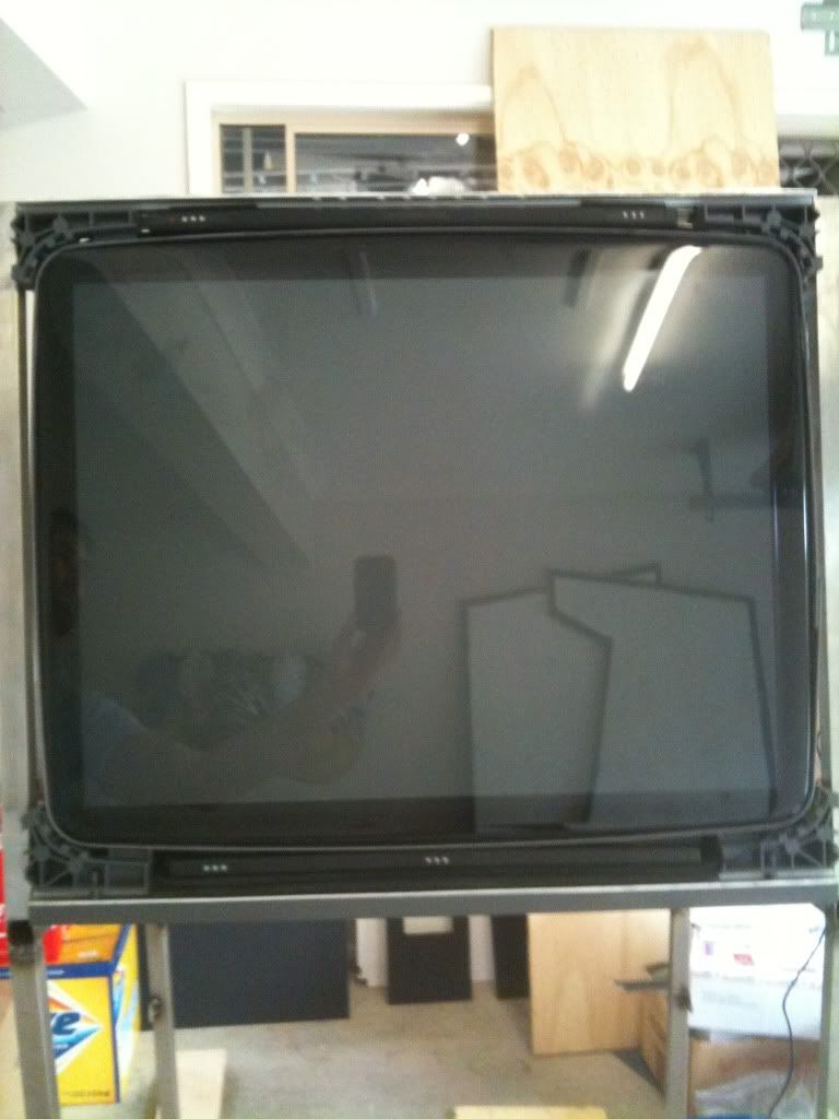

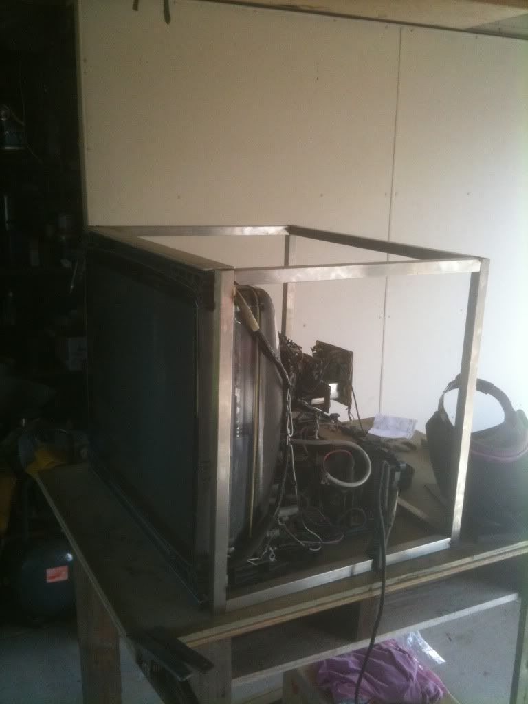

MONITOR

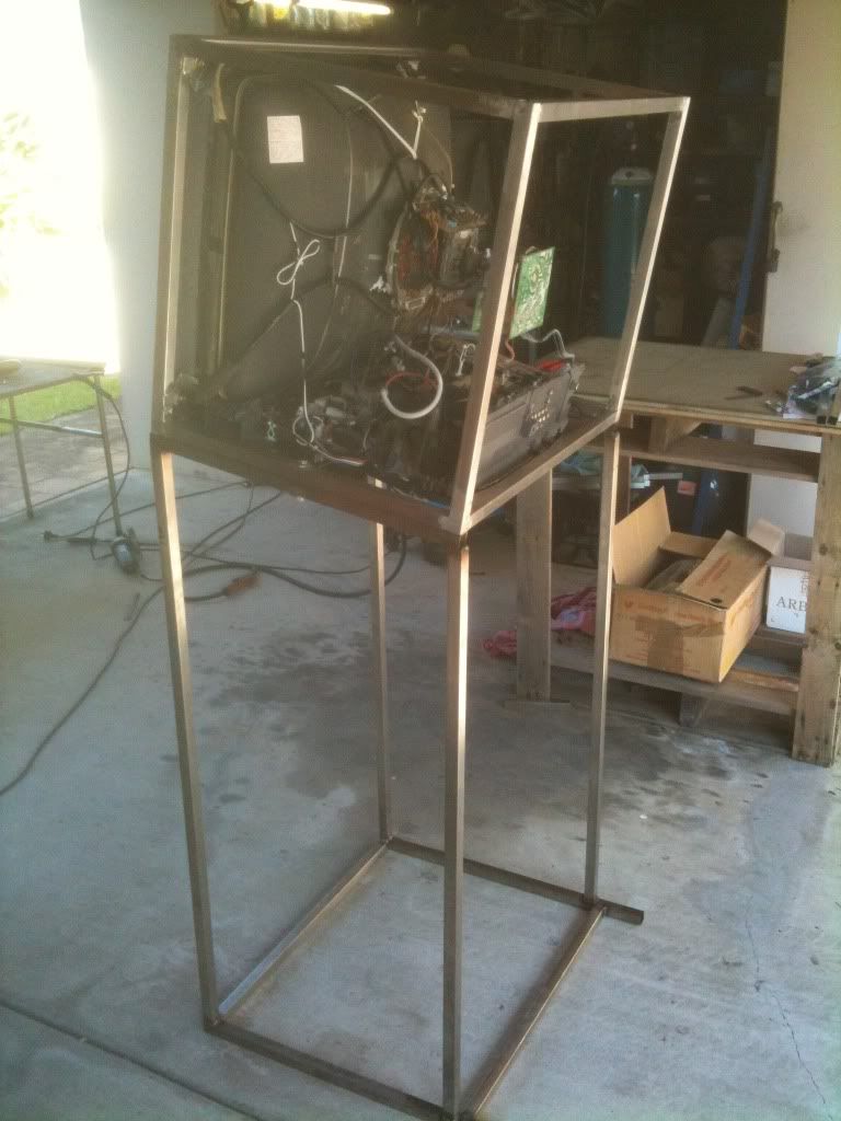

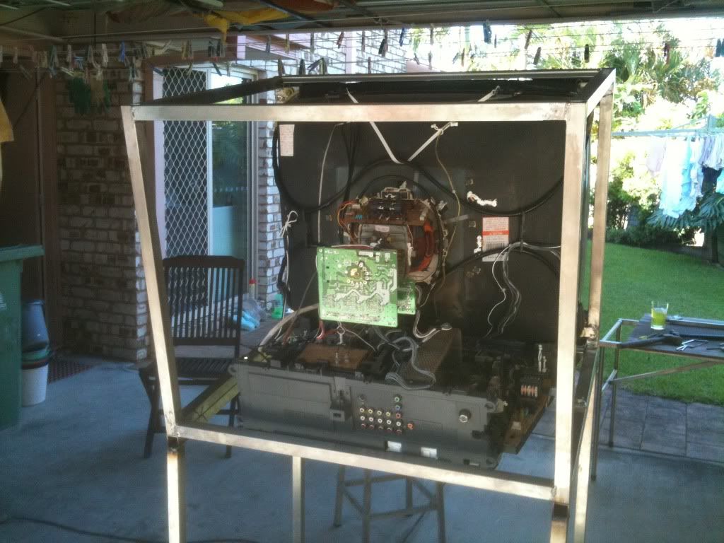

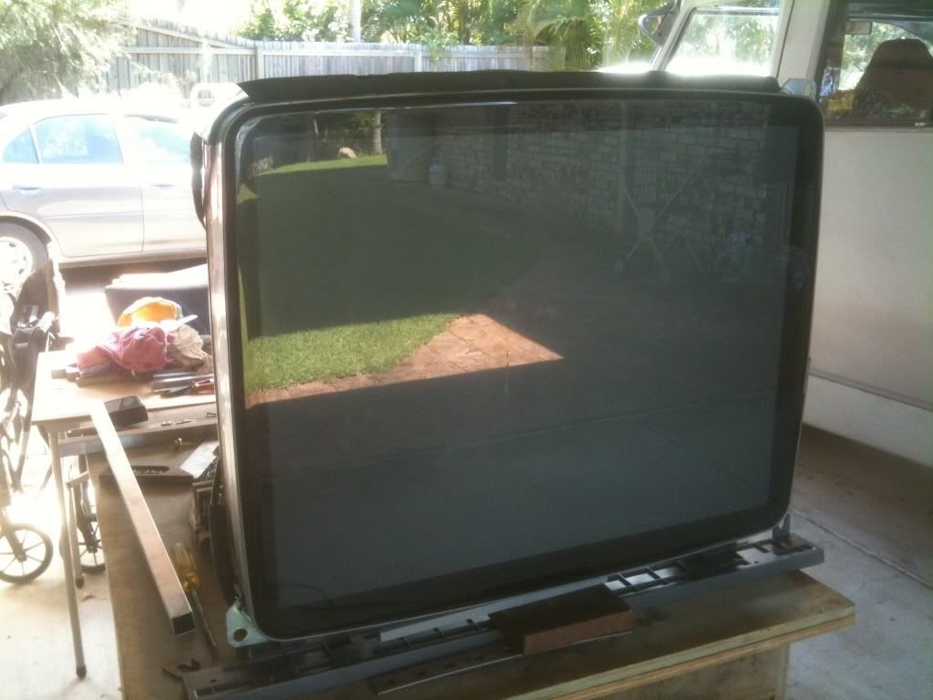

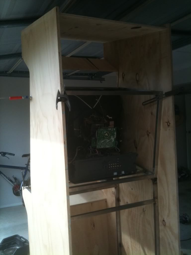

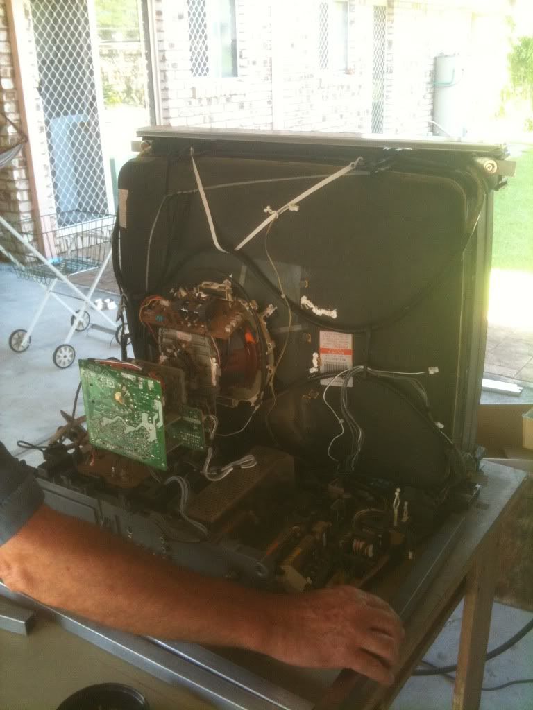

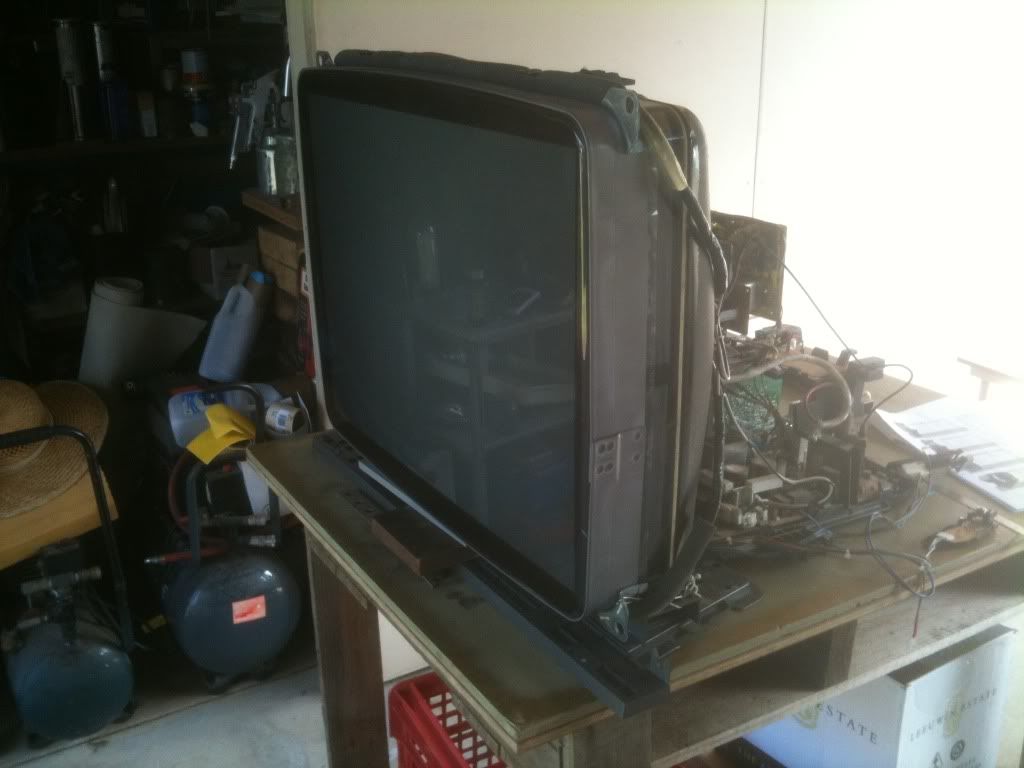

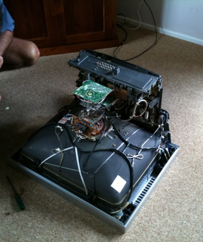

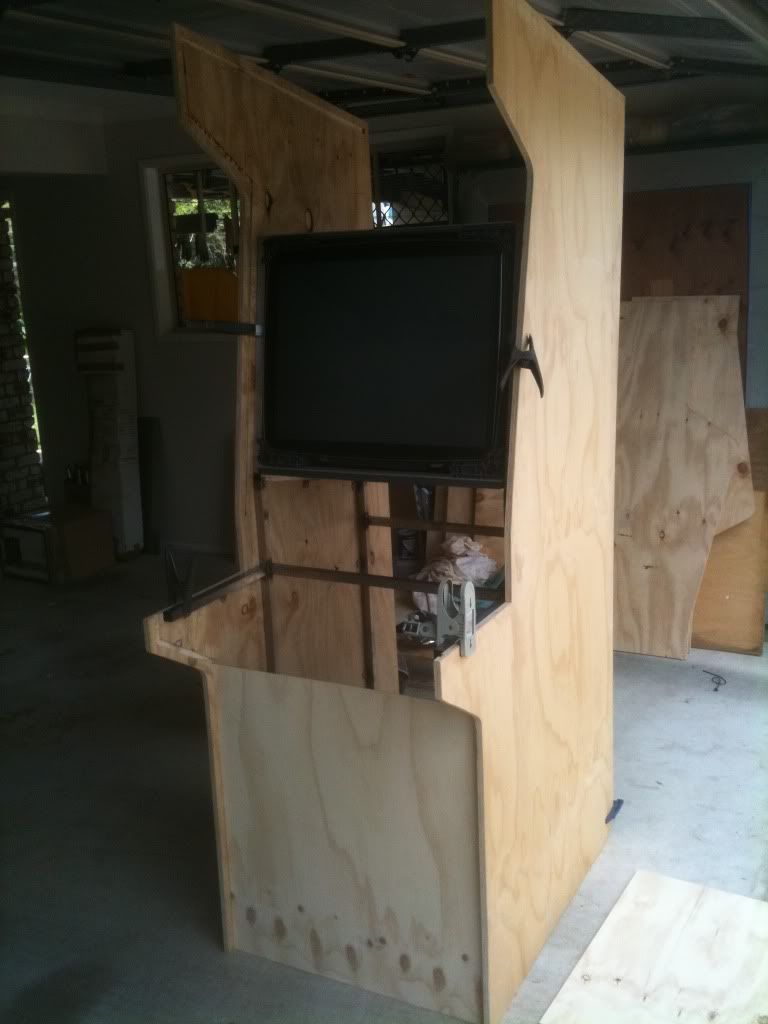

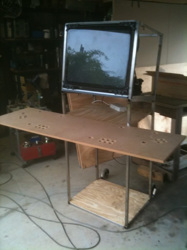

The first purchase I made was the monitor, as the width of it would help determine the dimensions for the rest of the unit. I went with a CRT television because I wanted a cheaper screen that I wouldn’t be afraid to pull apart. Additionally, I wanted some old school authenticity and at the time I was also determined to use a pair of light guns. I managed to find a Sony Trinitron 68cm on eBay for $41. I picked it up on 1/1/11 and promptly began to gut it and discard unwanted parts, including the speakers.

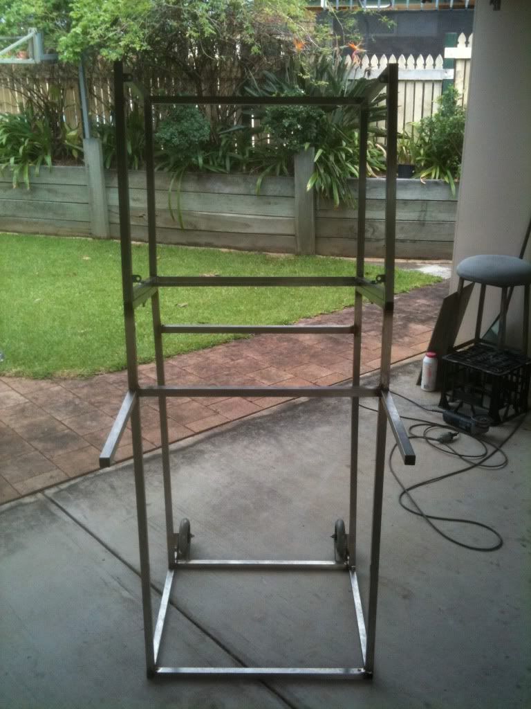

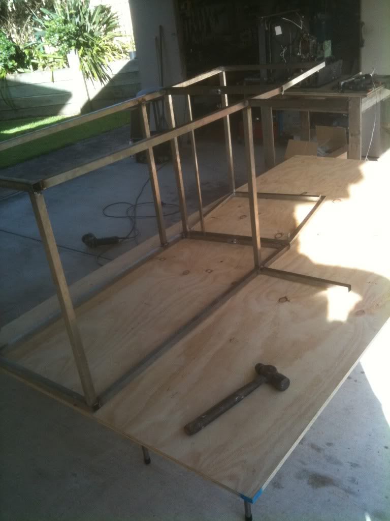

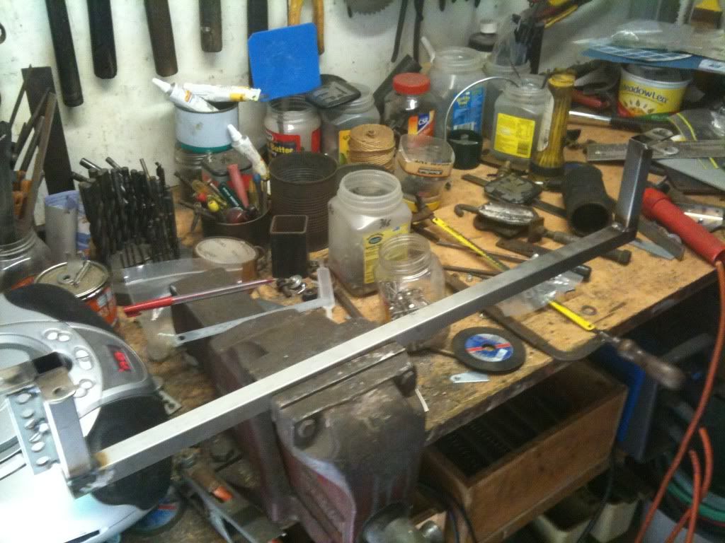

Once I had broken it down, it was time to box it. We had chopped up the load-bearing frame that held the screen itself, so that we could fuse it directly with a stainless steel box that would then become continuous with the rest of the stainless frame.
After recycling some screws and welding on some stainless tabs, we were able to weld some stainless steel tubing into the existing screen frame.
It was then just a matter of welding more tube on to “cube” the monitor, essentially to replace the discarded original plastic exterior. This gave it rigidity and would make it easier to combine with the cabinet.

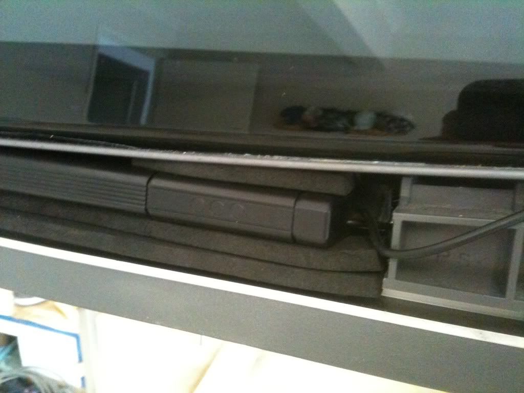

Later on in the project I decided to go with EMS Topgun II’s. I loved the look of these guns and, combined with the recoil function it was an easy choice to buy two. But it then became a problem to decide on where to put the LED bars, since I had intended to hide all possible fixtures. Luckily by this stage I had not completed the bezel artwork and the solution presented itself – hide the bars behind the artwork! Luckily the LED bars fit nicely above/below the screen within the confines on the stainless frame. So I simply adjusted the artwork to accomodate the sensors (by placing void areas on the bezel) so that they would be able to work from behind it. They were fixed tightly in place with some foam. More on the bezel later.

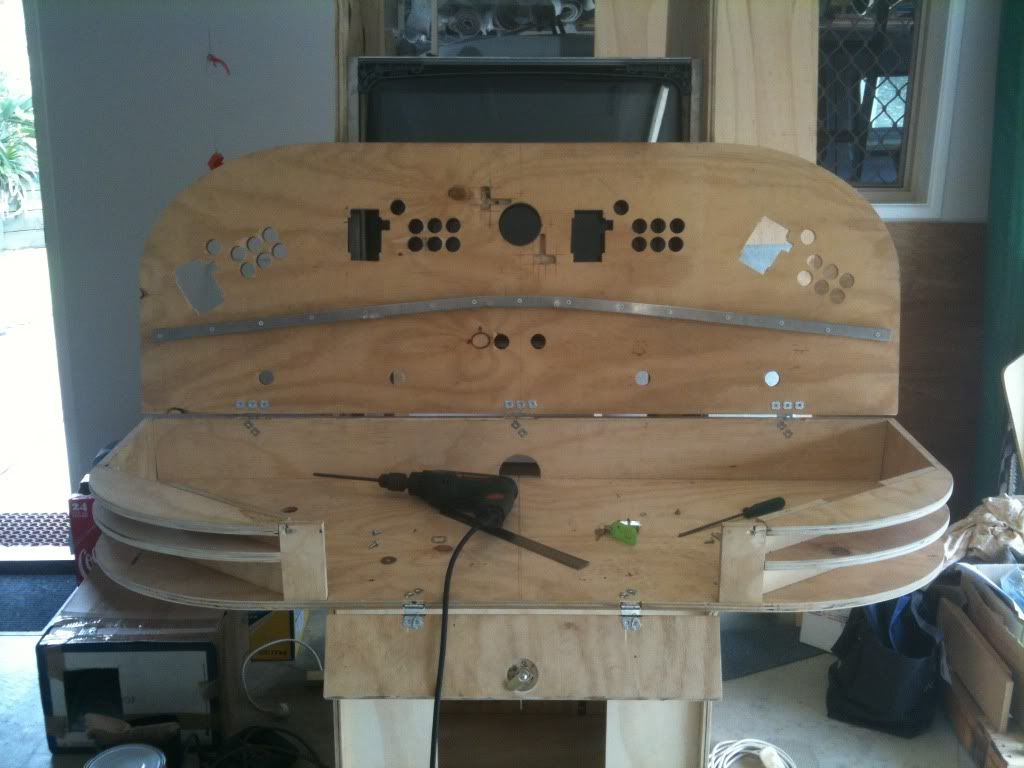

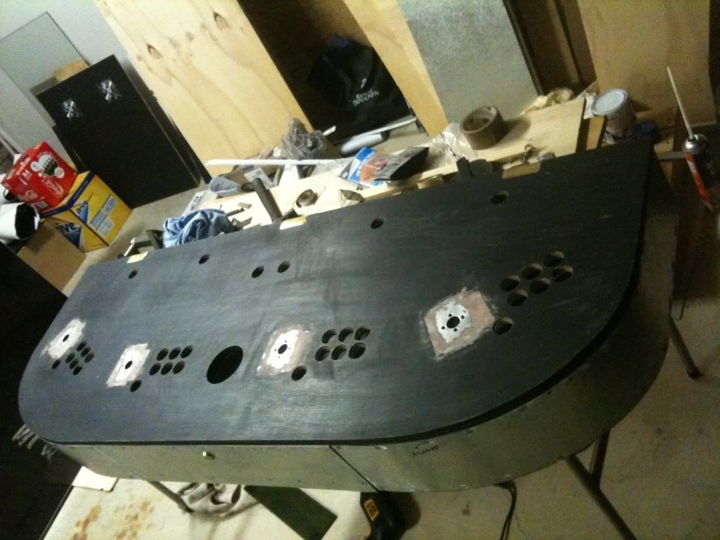

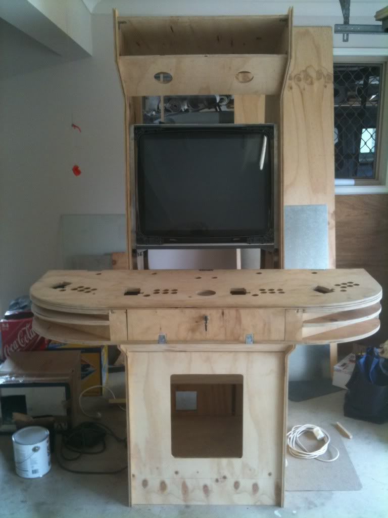

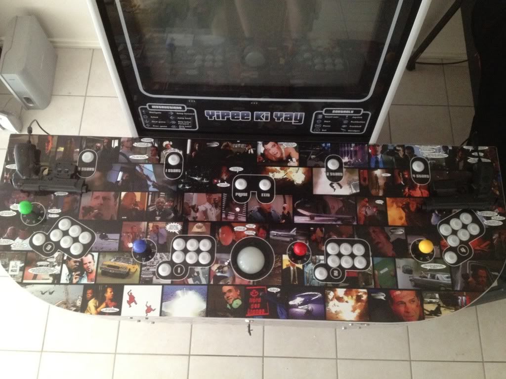

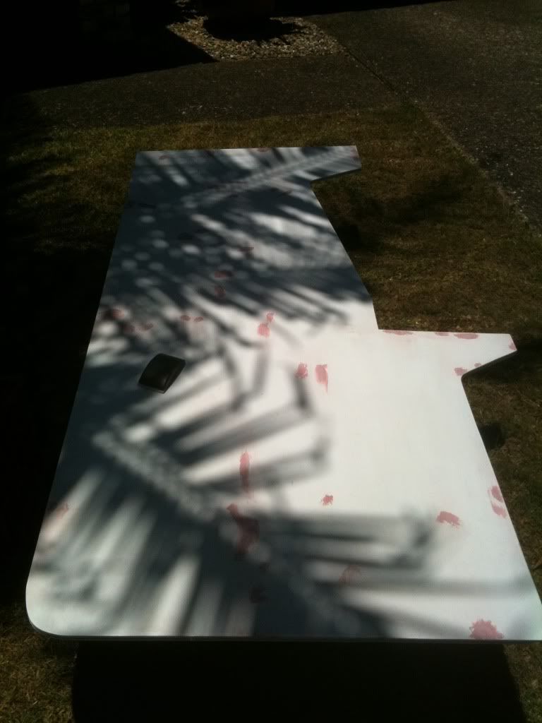

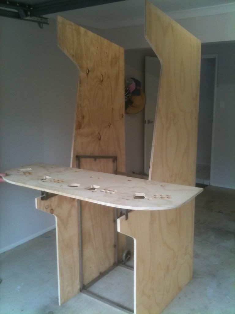

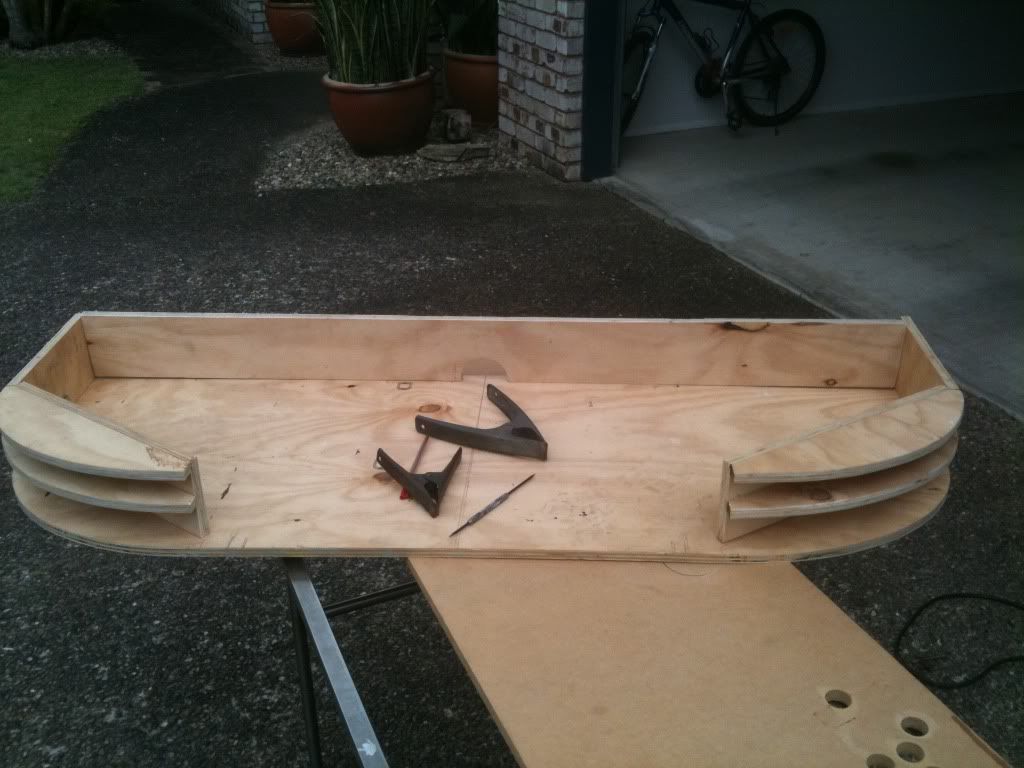

CONTROL PANEL

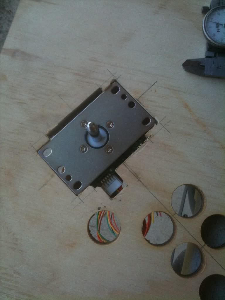

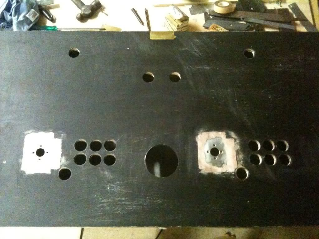

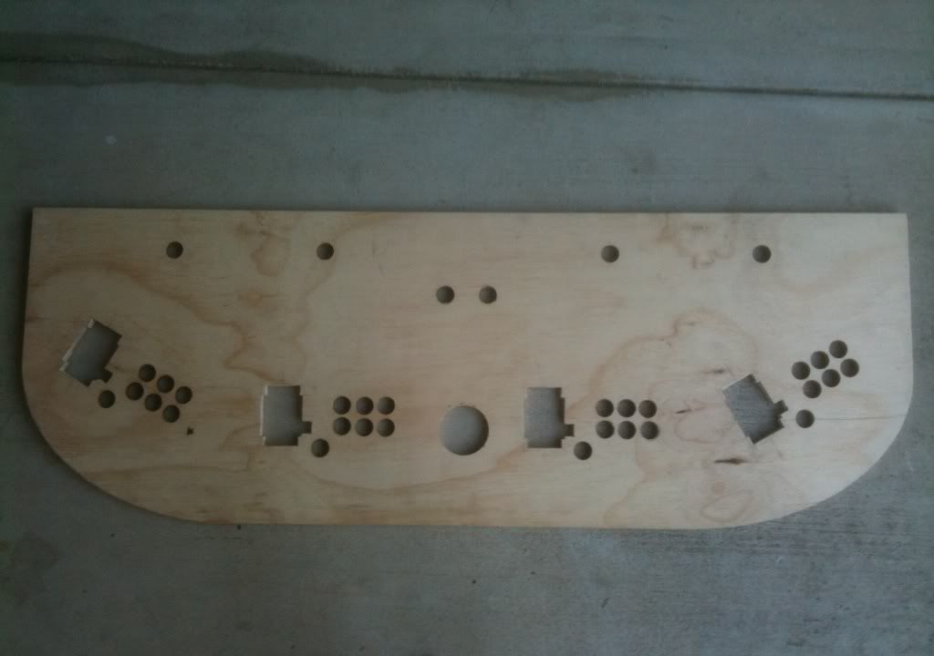

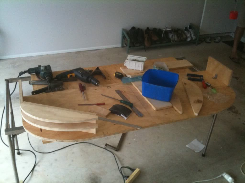

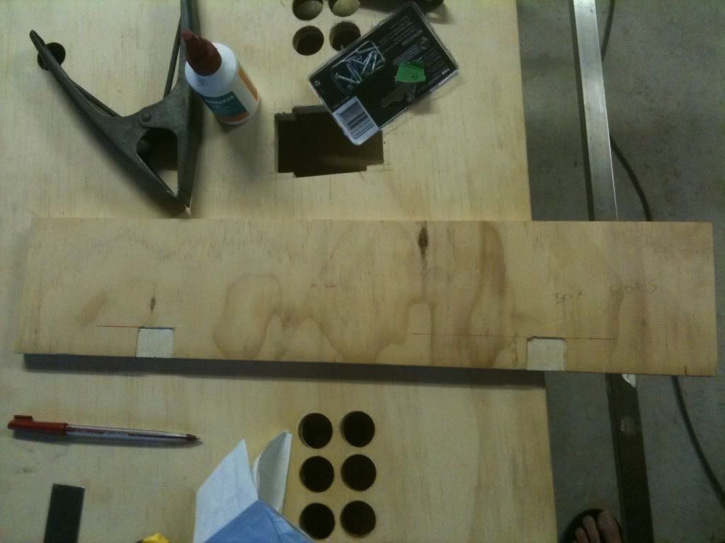

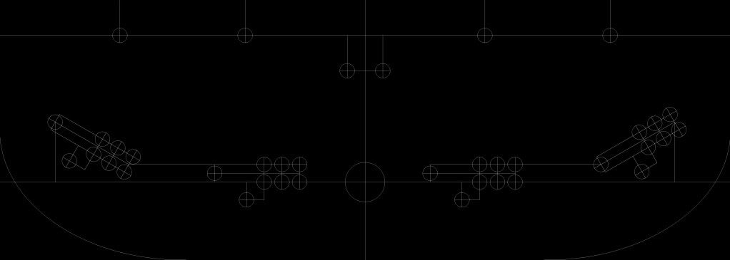

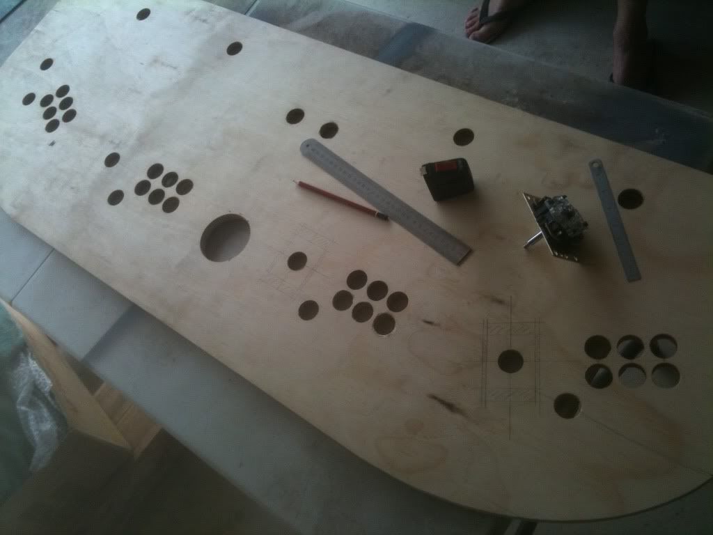

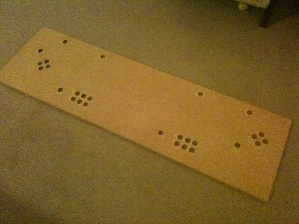

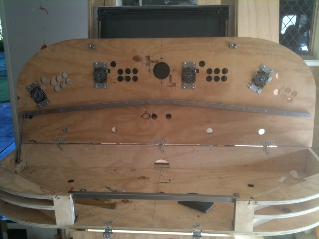

On to the control panel. I bought a cheap piece of MDF to use for practice. I designed a layout and drilled all holes out. I wasnt too concerned about flush mounting a joystick in a practice piece so I just drilled a hole.
By this time my pushbuttons and joysticks had arrived so I set up one player and tried my hand at wiring. After a few games and trials with the LED software I was satisfied that I would be able to put this together.
I used the practice control panel to help me decide on the proper layout of my buttons. I decided that placing the outside players (3 and 4) at 45 degrees close to the screen was sub-optimal. The screen needed to be as close to perpendicular to the ground as possible so as to accomodate gun games, and putting those outside players close in there at 45 degrees was no good. I concluded that 10 degrees tilt on the screen would do it. Since I didnt really care about space considerations, I decided I would bring those outside players back away from the screen more level with 1 and 2, and orientate them at a similar angle. I also would space them sufficiently far apart so there would be no elbow-bashing. I found that 30 degrees was a fair balance between distance from screen and angle looking across it. I made up the control panel dimensions in photoshop with actual measurements and printed it out. Then I simply laid it over the appropriate piece of ply and transcribed. I would later use those actual dimensions in photoshop to create my control panel artwork. The plywood I used was 16mm (same as the cabinet sides) since I wanted to use the same t-molding on each.

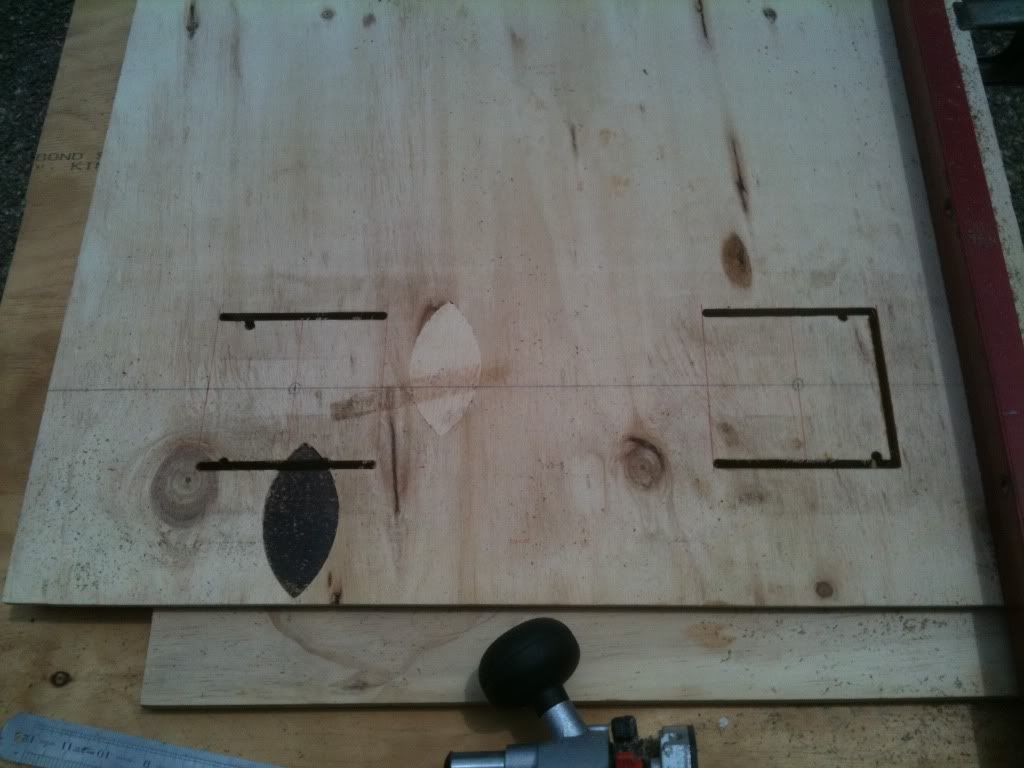

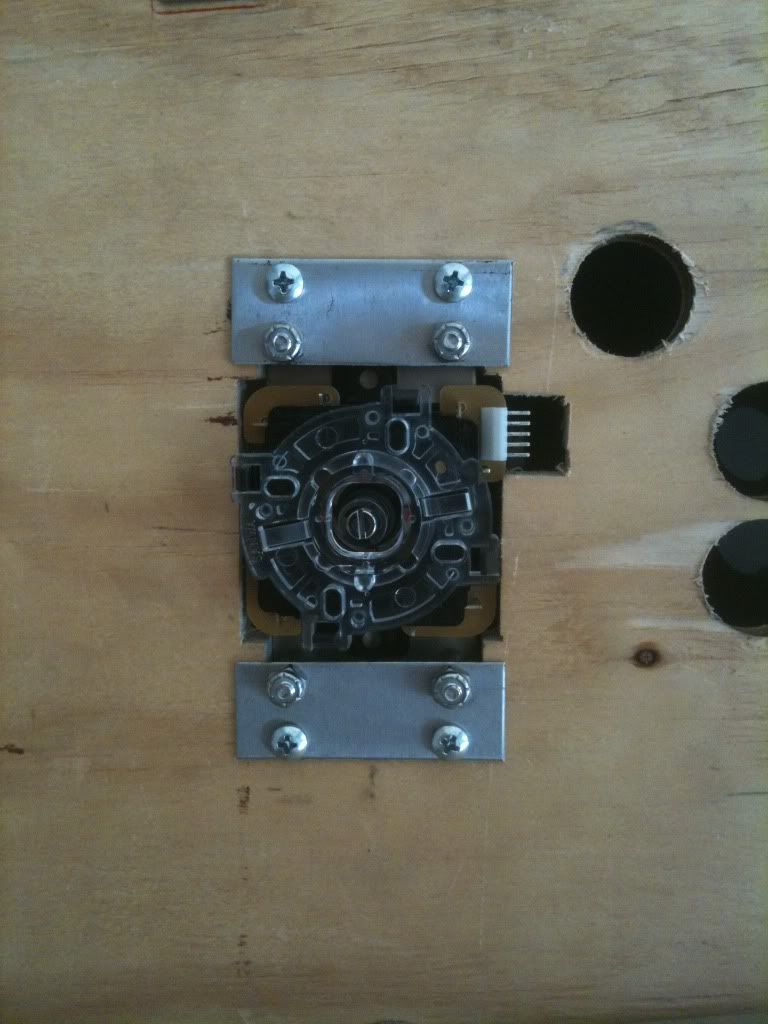

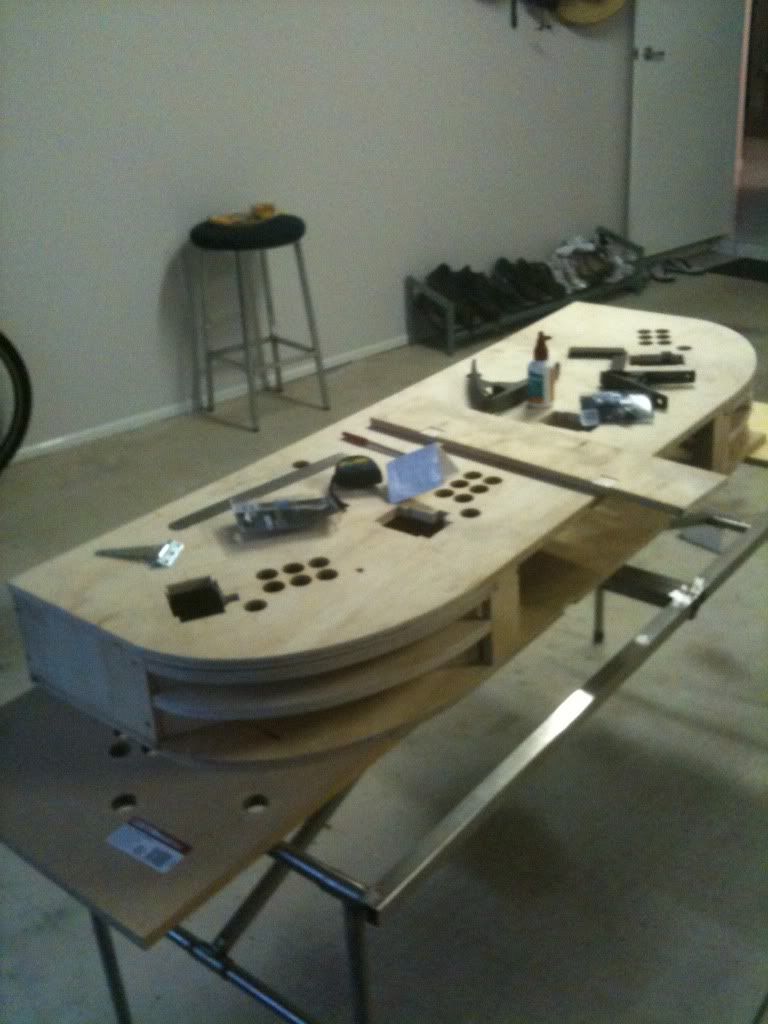

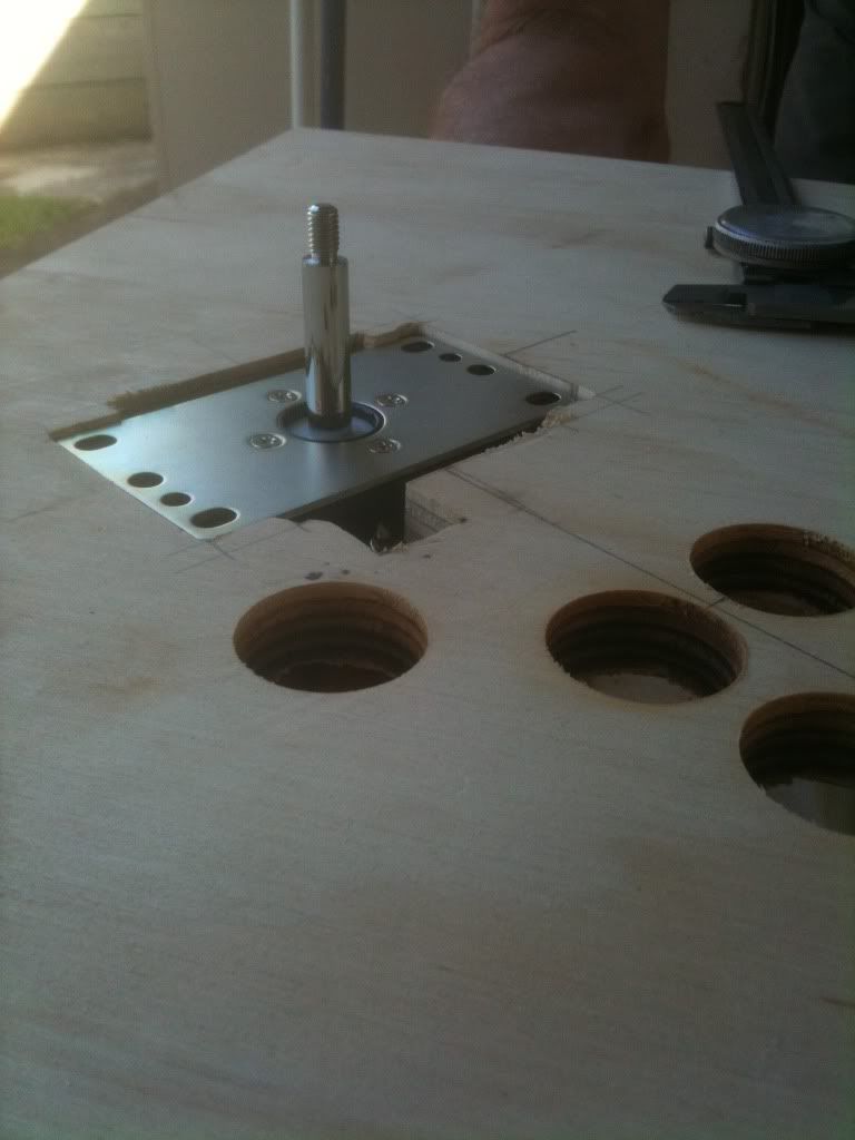

I used a hole-saw to cut out the player buttons. I then used a jigsaw to cut out the joystick mounts and curved edges on the panel. I was going to flush mount the joysticks, so I allowed for the plate to sit flush, and also for the square-shaped components below. In retrospect, another way I could have done this would have been to just jig the plate and then router from underneath to allow for the components. I’m not a fan of complicated/unnessecary buttons, so I limited the board to player pushbuttons only, 4 start buttons, and 2 admin buttons – pause and exit. Credit buttons would be incorporated later into the coin door. Finally I used a hole-saw to cut the trackball hole.

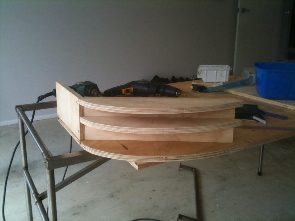

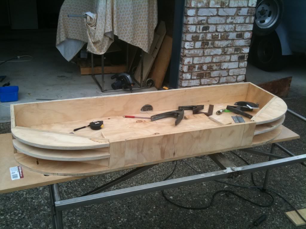

Construction of the box for the control panel involved making a plywood copy of the control panel top for the base. The design called for an “en-bloc” approach to the box. This meant that I didn’t want overhanging wood, sharp edges or unnessecary angles. The solution was to keep the sides continuous with the top/bottom. This was achieved easily with the straight edges, but the curves would prove to be a little more tricky. It was decided to bridge the curve with more 16mm ply and add curved ribs, then cover with some sheet metal. The base provided one “rib” with its natural curve, so I added one at the top to support the control panel, and one in the middle to support the sheetmetal and prevent stray knees/overexcited players from putting dents in it. All were fixed with internal right-angle brackets, with longer wood screws used to join the side pieces directly to each other. The ribs needed multiple sandings to make them flush with each other once sheetmetal was laid over.
The back part of the box had a semicircular hole put in it with a hole-saw to accomdate cords. I went for the arch rather than a full hole to maintain structural support, as the control panel was going to have some weight to it and a hinge would be overlying the cord hole. Five more holes were drilled into the base of the control panel box – two in-line with the stainless arms below the box to allow bolts to be passed through so that the whole control panel could be removable; two to accomodate the Top Gun cords to pass through to the underside of the box; and one with a routered underside to position the on/off switch for the whole unit. I added some plywood struts at the front to ensure a flat finish which would then accomodate a hinge-mounted drop door to give access to a draw with keyboard/mouse.

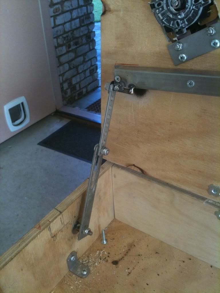

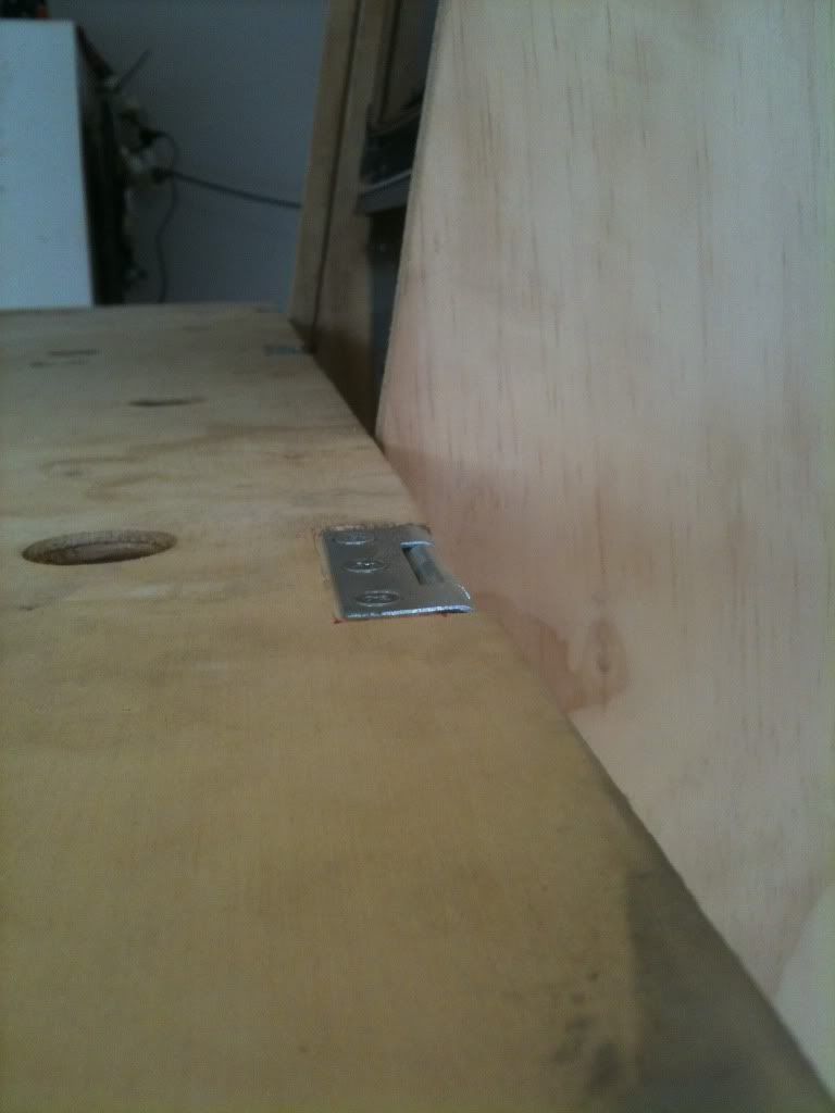

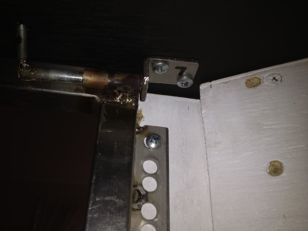

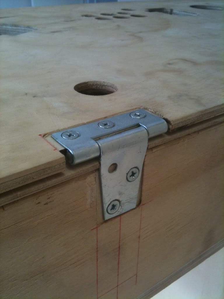

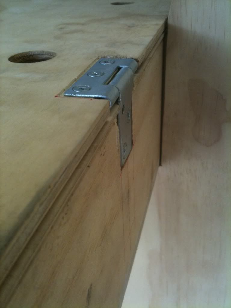

For the hinges, I trimmed them to as small as possible and routered troughs for them to sit in, to hide them below the cp overlay and sheetmetal front. There are two hinges for the front door, and three for the control panel top.

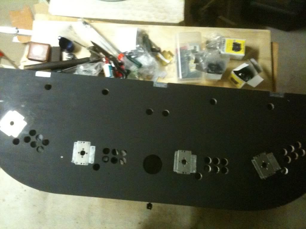

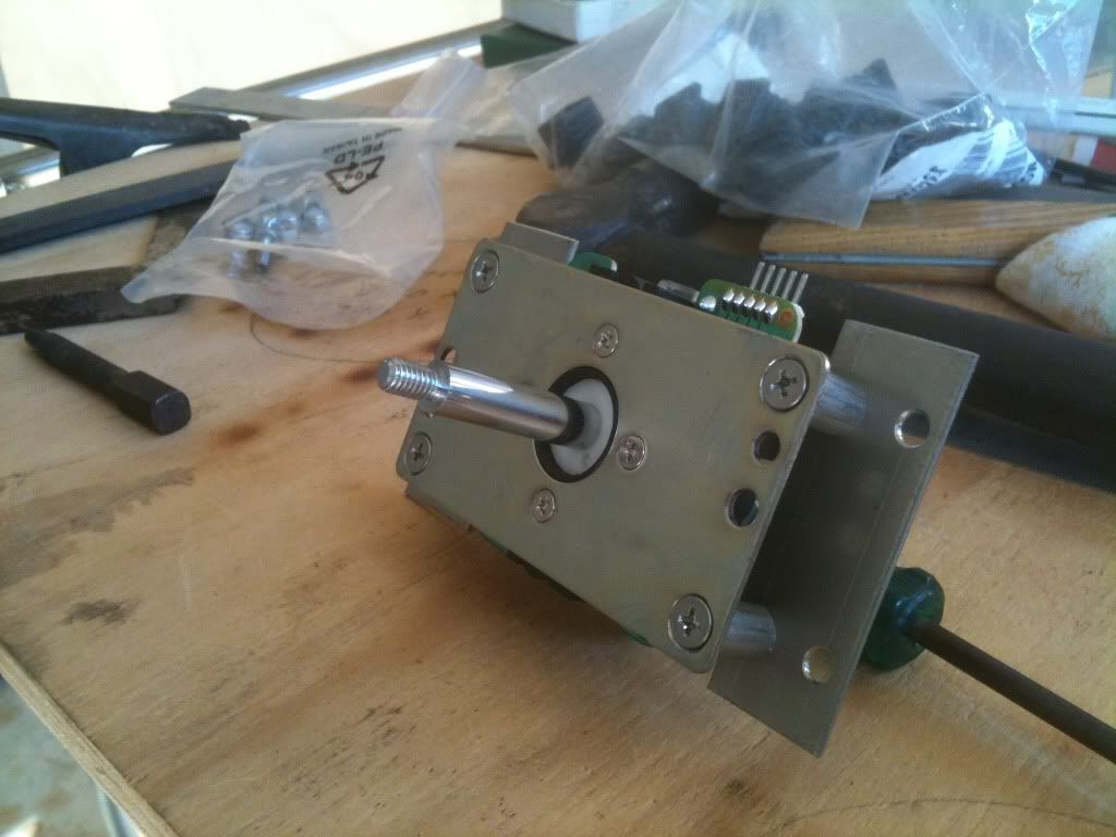

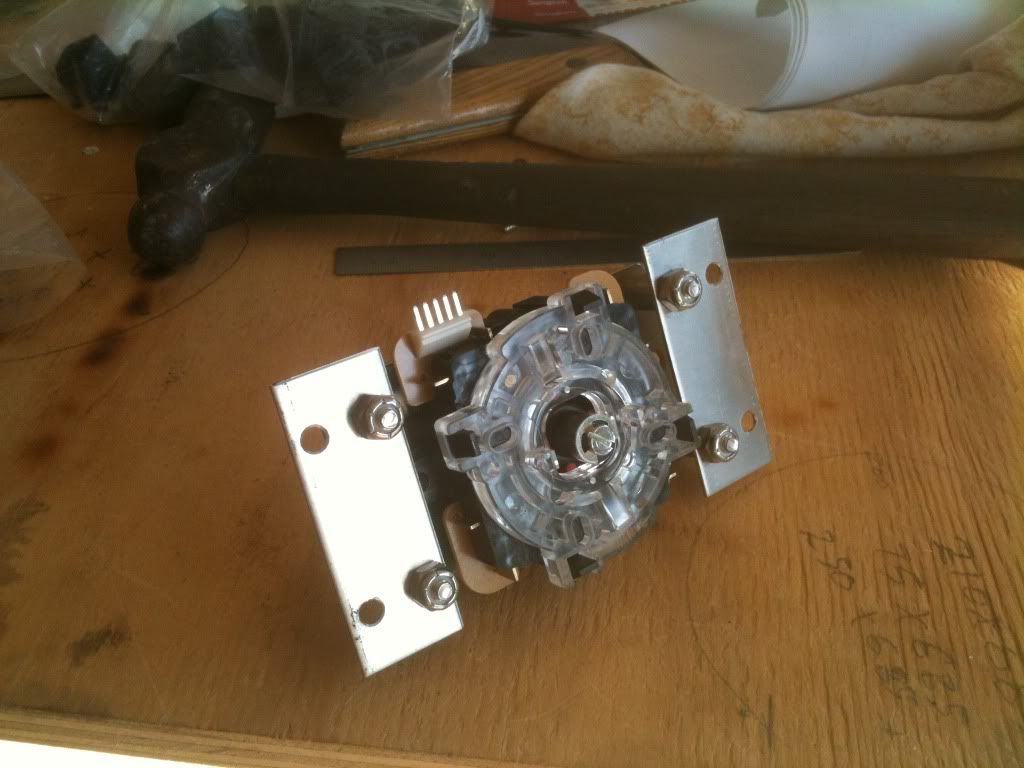

I used metal tubing spacers for the joystick mounts. I countersunk the joystick baseplate screws, bridged the depth of the 16mm ply with the spacers and secured them to stainless plates with nyloc nuts. The stainless plates then screwed directly into the underside of the control panel.
After many months of building and temperamental/humid Australian weather, the control panel top had bowed, as it was commonly free-standing up against a wall. This became evident when it was sat on top of the control panel box – the lateral sides would not sit flush down against the edges. I had also toyed with the idea of ribbing the underside or placing columns between the top and the cp box base to give rigidity and support. A solution was eventually found for both - a stainless tube was screwed to the underside of the top. Two bends were placed into it for two reasons – one to maximise the length/effect of the tubing, and two to allow for pushbutton/joystick/led-wiz wiring to have room on the underside. This tubing provided the rigid backbone. A process of trial and error of inserting washers between the tubing and the top (only at points where screws passed through so they wouldnt fall out) eventually got the bow straightened out. Fortunately it was a symmetrical number of washers along the length. You can also see that I used T-nuts to secure the hinges, and made a hole and routed the back of the drawer-door to allow for a camlock. There was one last piece to add before the box was a solid unit – bridging the drawer-door at the front...

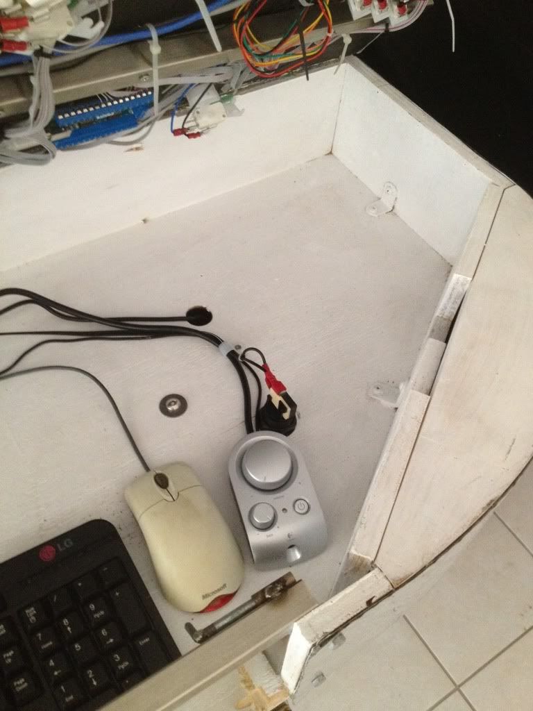

Since the drawer door could  not be used to support the weight of the control panel above it AND function as an access, a bridge was needed. Again, stainless tubing was used. It was simply a “doorframe” which took the weight of the control panel above and provided a nice flush recess for the drawer door. The ply struts at the front were simply screwed onto it from within, and tabs were welded to the bottom of it to screw it to the base. This now completed the “boxing” of the control panel interior. We used a grinder to cut a trench into the tubing to allow for the locking arm of the camlock.
One last practical addition was to add a locking arm to the control panel top so that it wouldnt have to be held open.

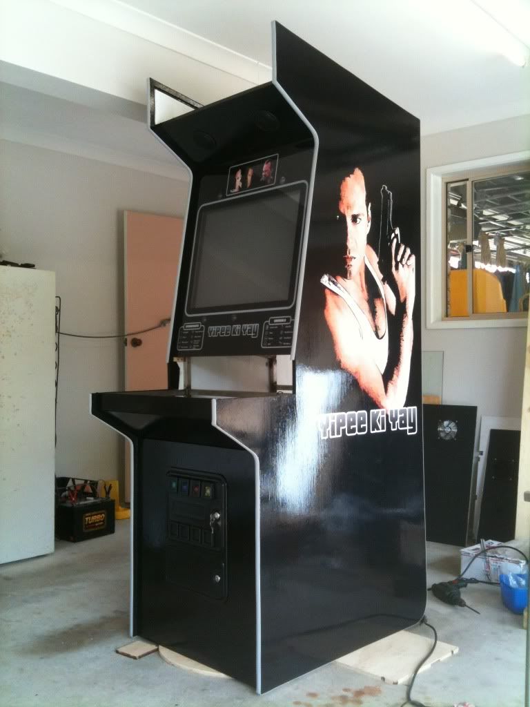

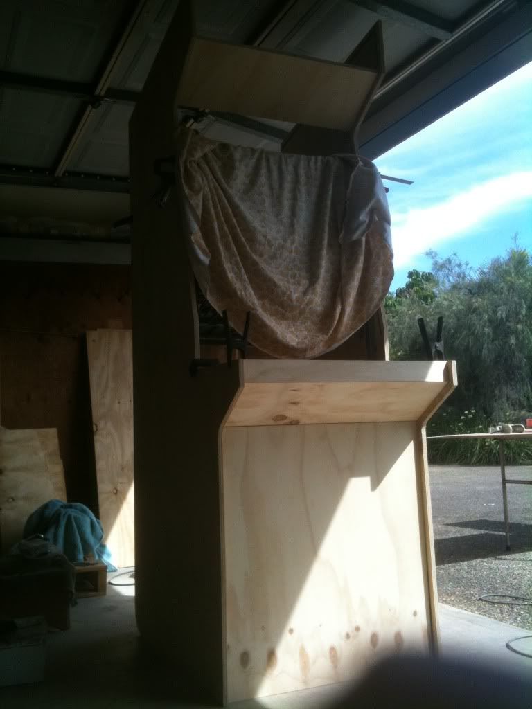

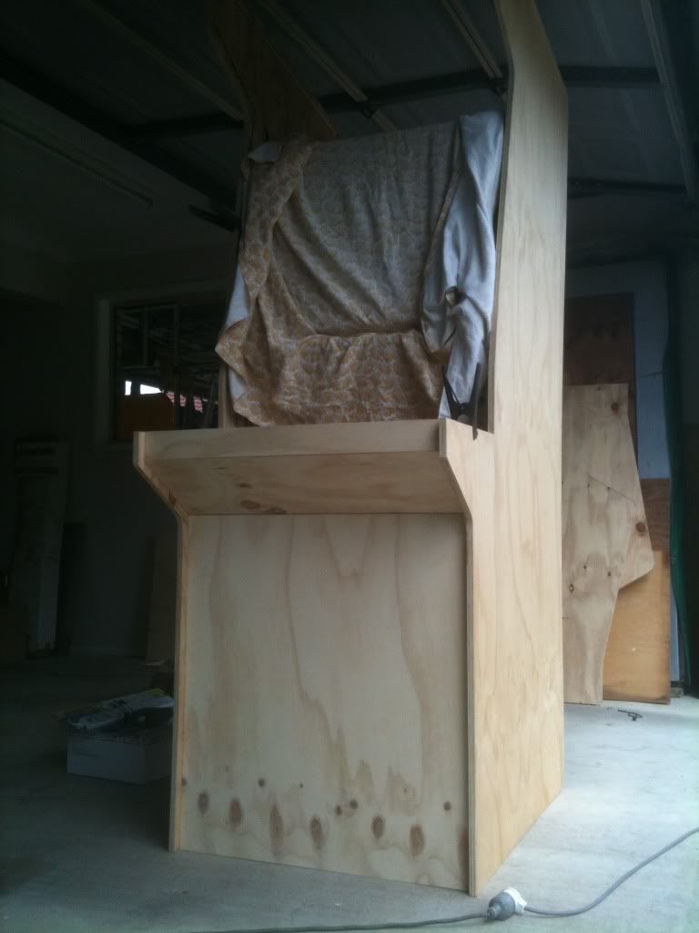

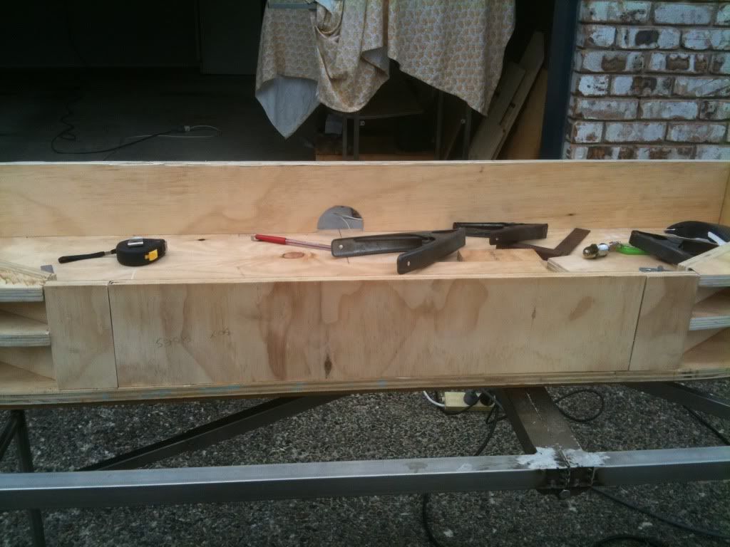

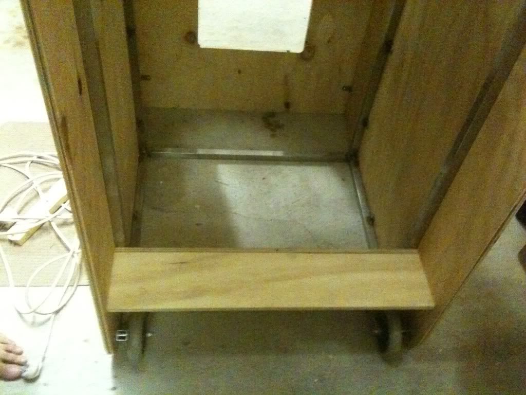

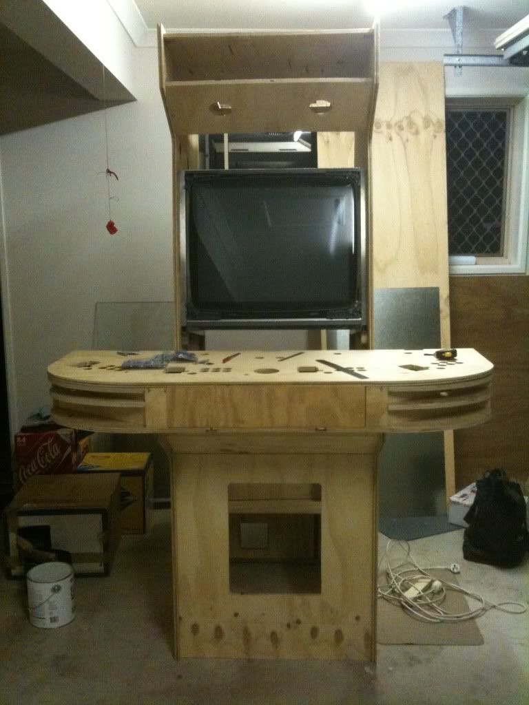

CABINET

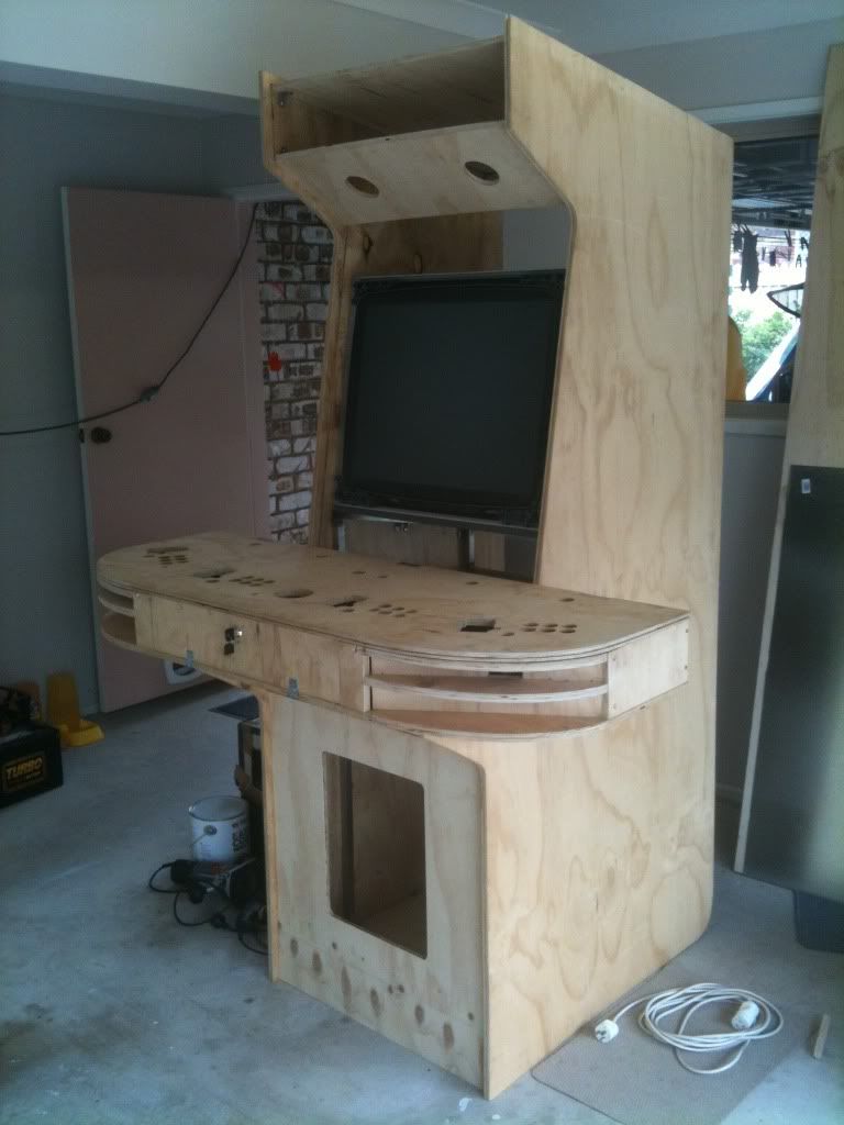

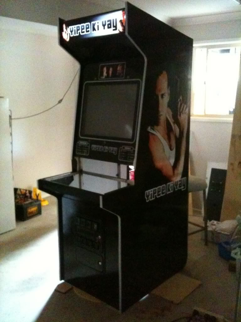

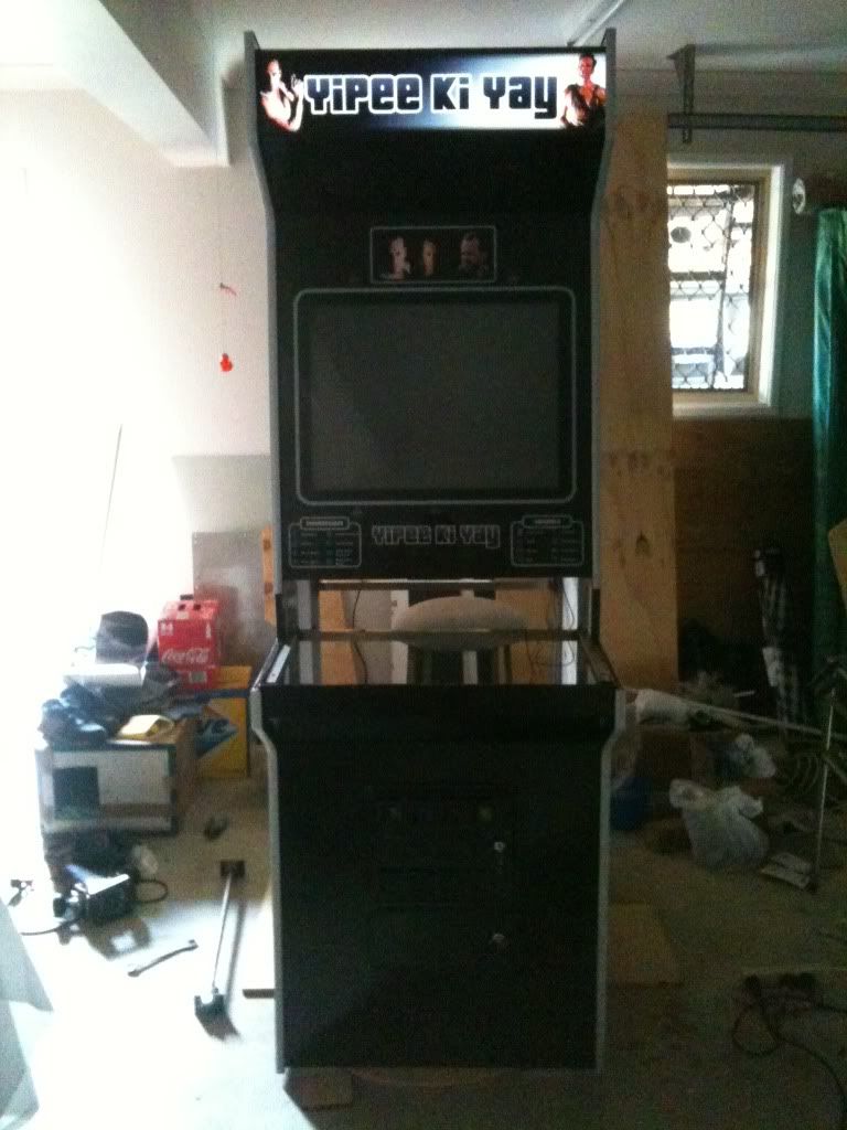

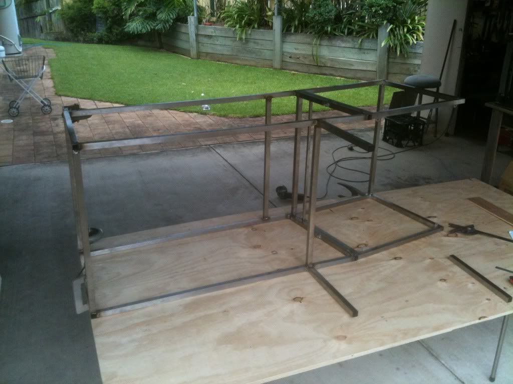

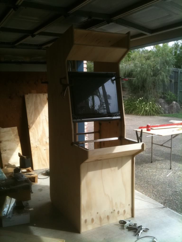

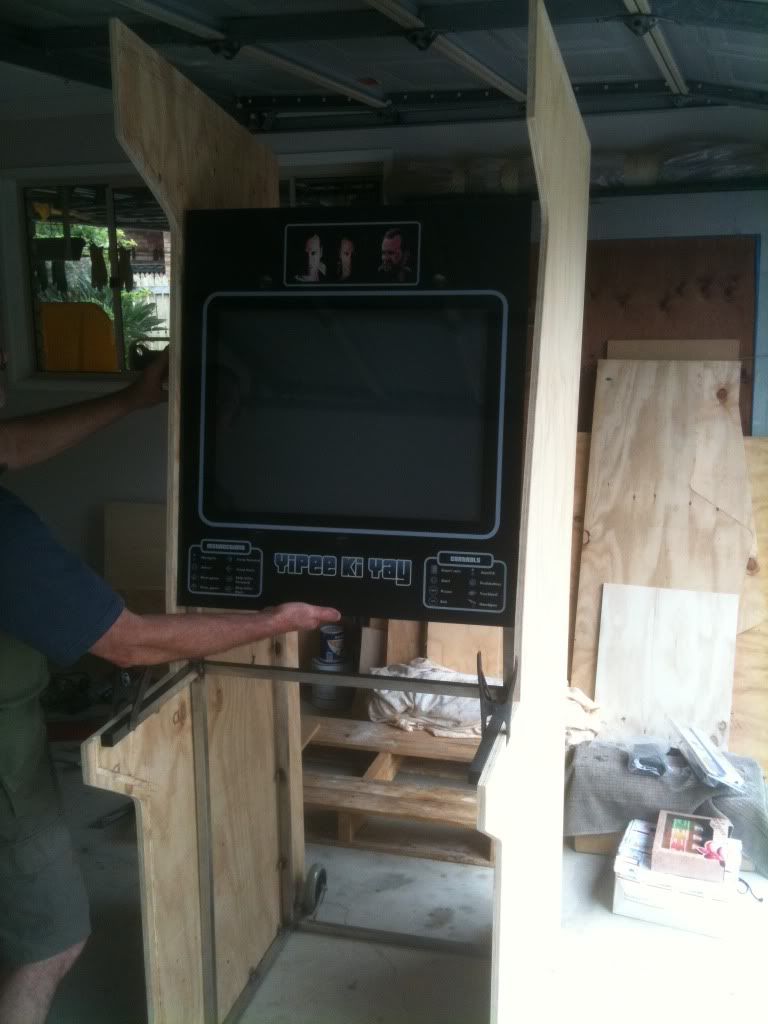

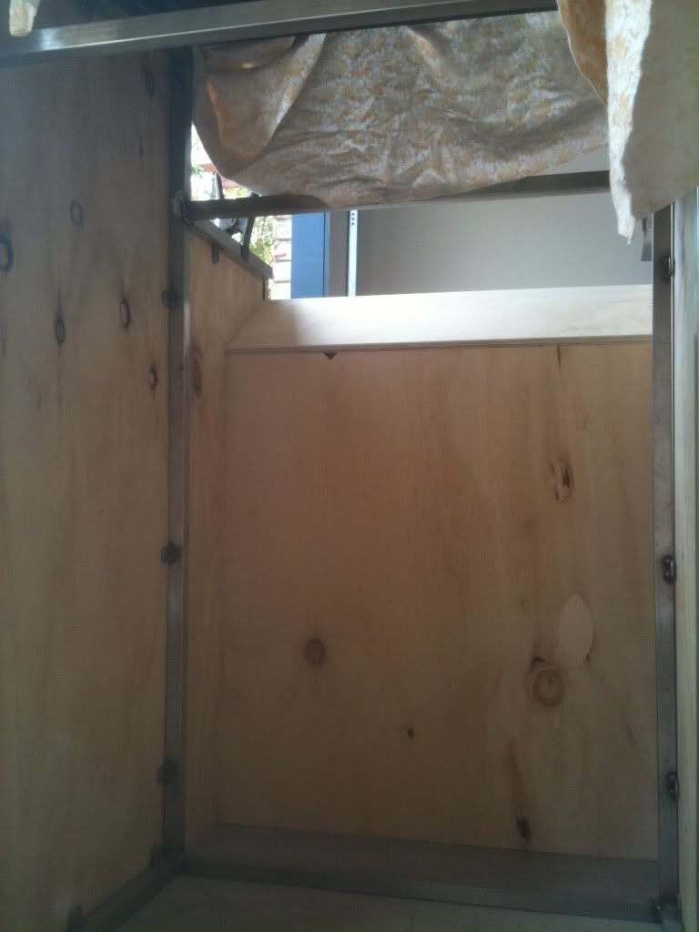

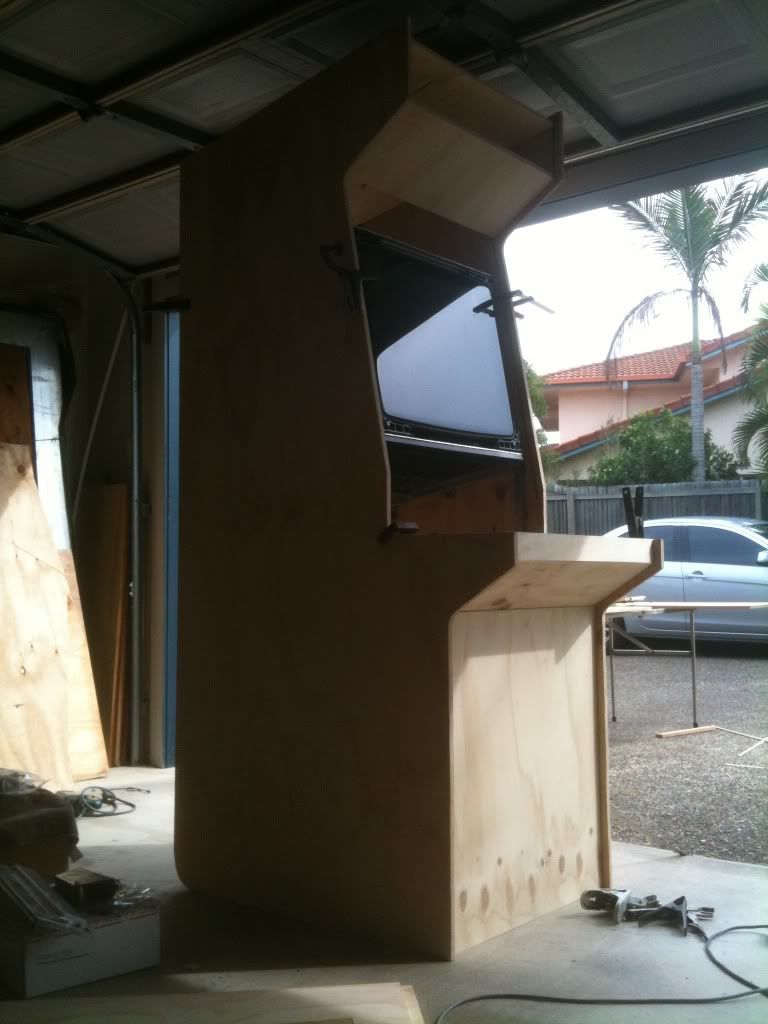

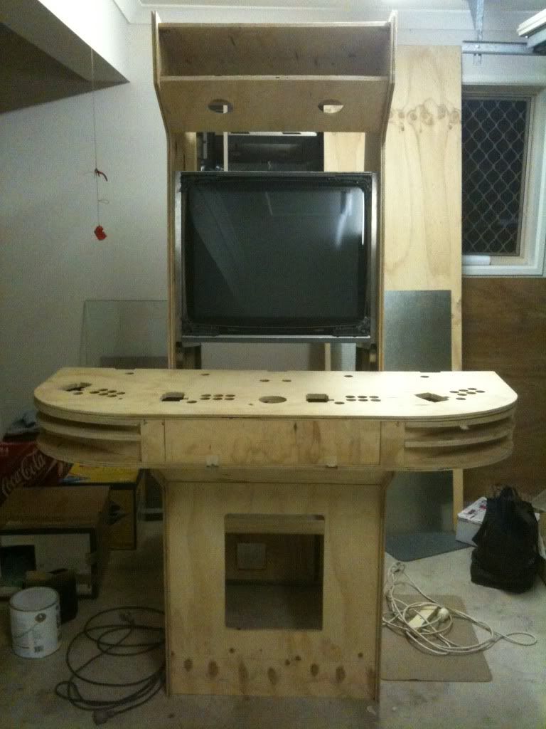

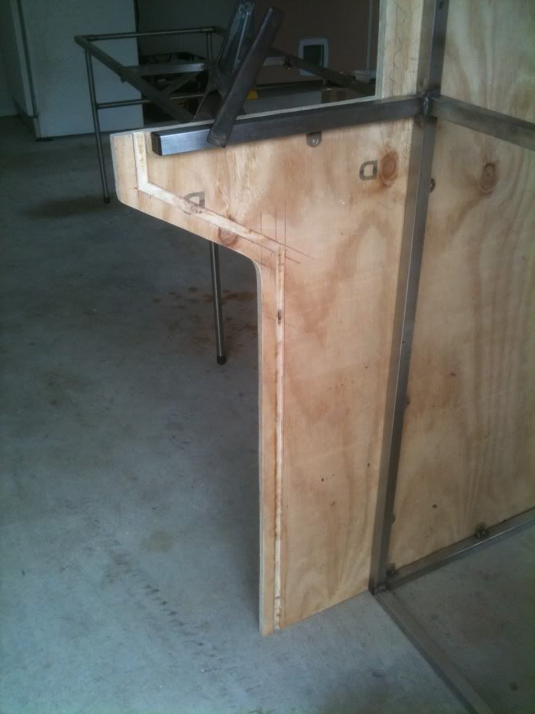

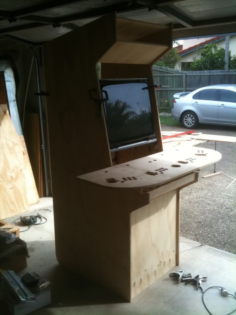

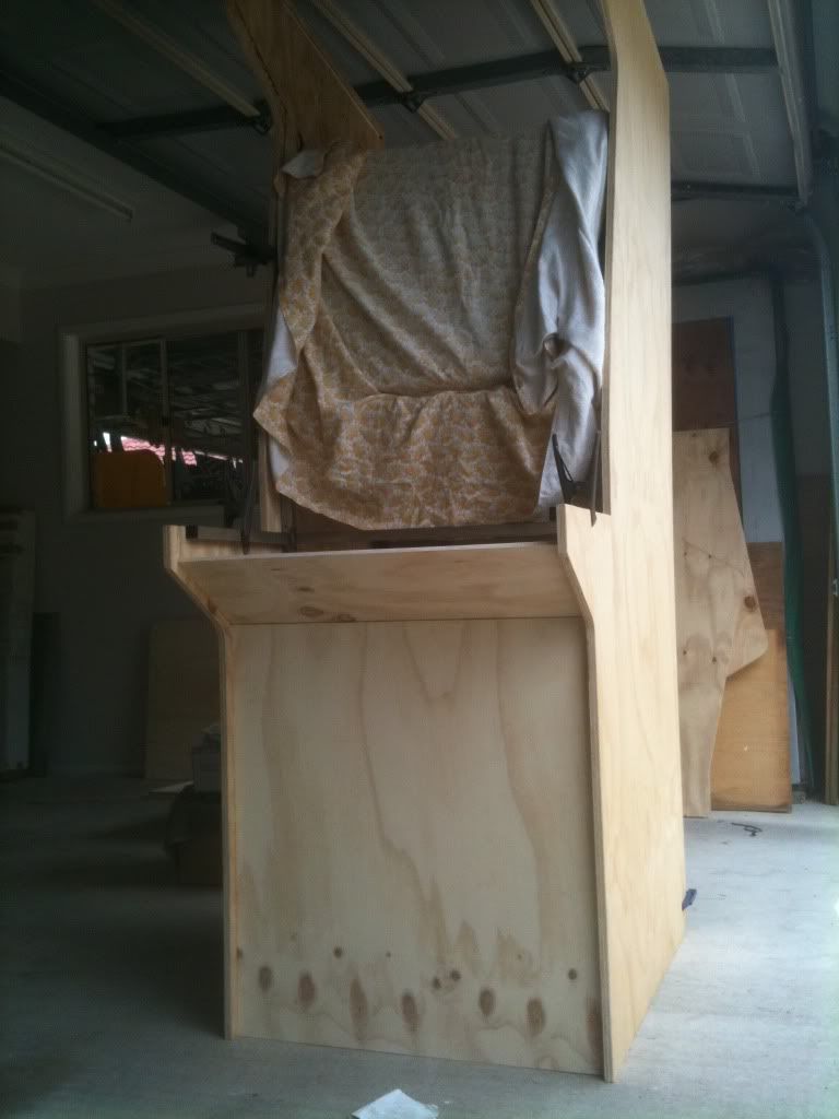

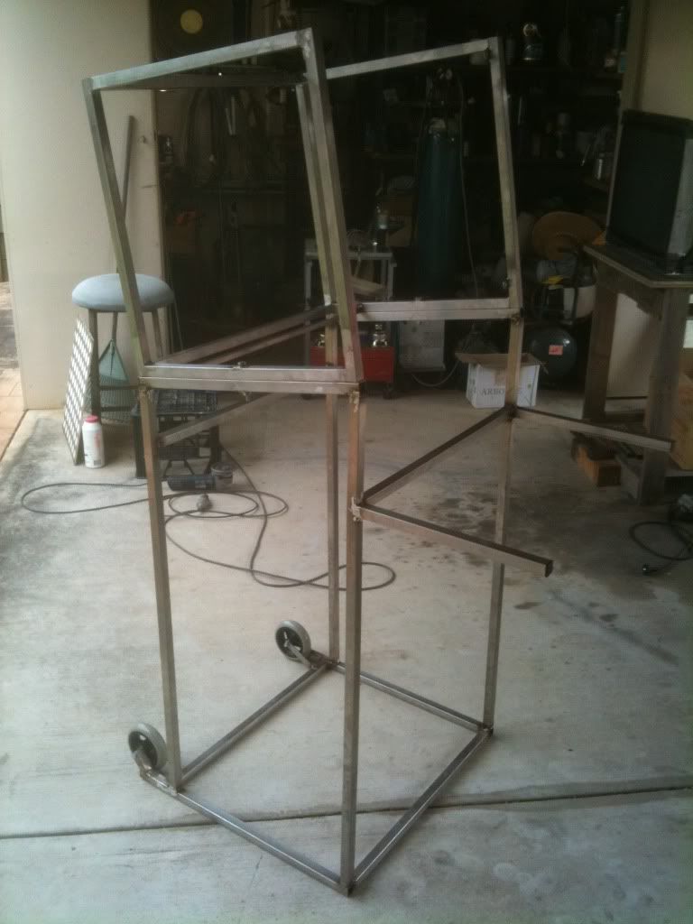

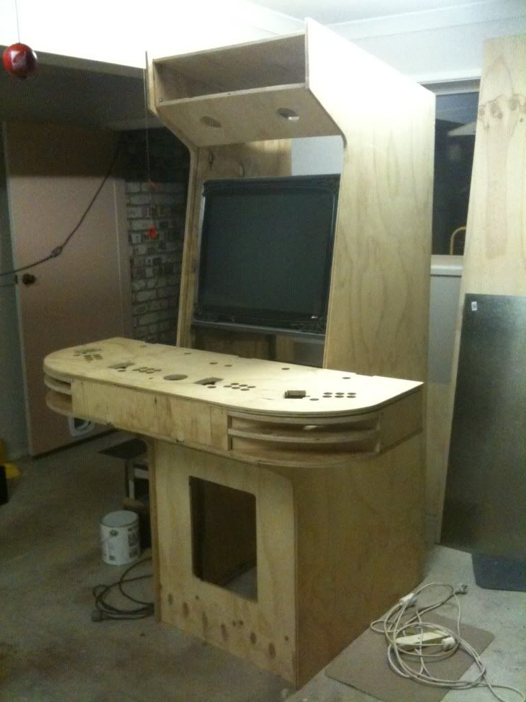

The cabinet itself, as described earlier, would see the boxed monitor sitting atop a stainless steel tube frame, which would then have the exterior simply added to it. The internal frame would provide weight-bearing duties for the whole cabinet, especially that very, very heavy monitor. The monitor was already boxed so the frame would have to provide the 10 degrees of tilt for the screen. The monitor box is actually removable - there are 4 pins at each corner of the steel frame (lower section) which fit into 4 holes drilled into the underside of the monitor box tubing. This ensures proper alignment. There are then two bolts that secure the union between lower section and monitor box, one on each side.

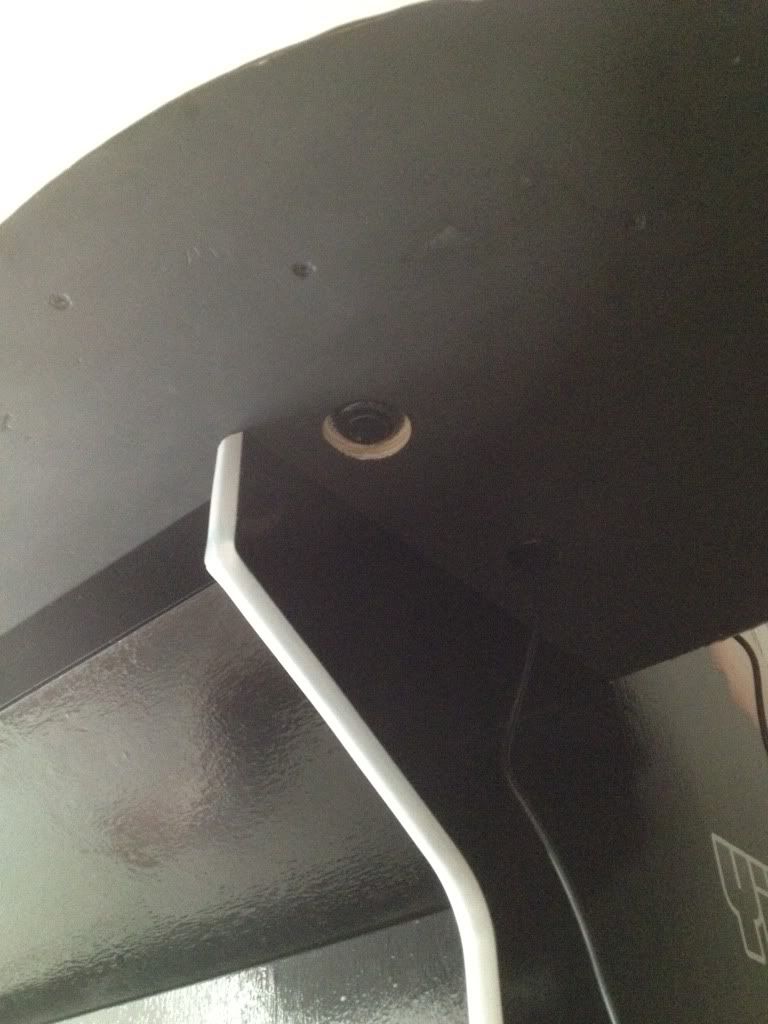

Feet were added to the rear of the frame so that wheels could be fixed and also to support the rear from tipping. Some arms were welded to the front at the pre-determined height of the bottom of the control panel. Even though the cabinet sides would be there, the control panel would be removable and bolt directly onto these arms.
Stainless tabs with screwholes were welded along both lateral sides of the frame so that the plywood side panels could be screwed directly onto it. The side panels sit level on the ground with the frame, but serve no weight-bearing function at all. Early in the build I used the practice control panel to determine optimal dimensions and heights.

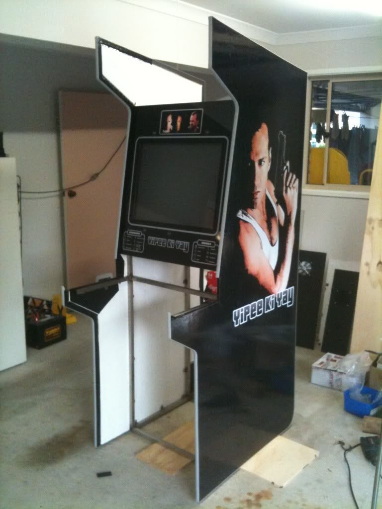

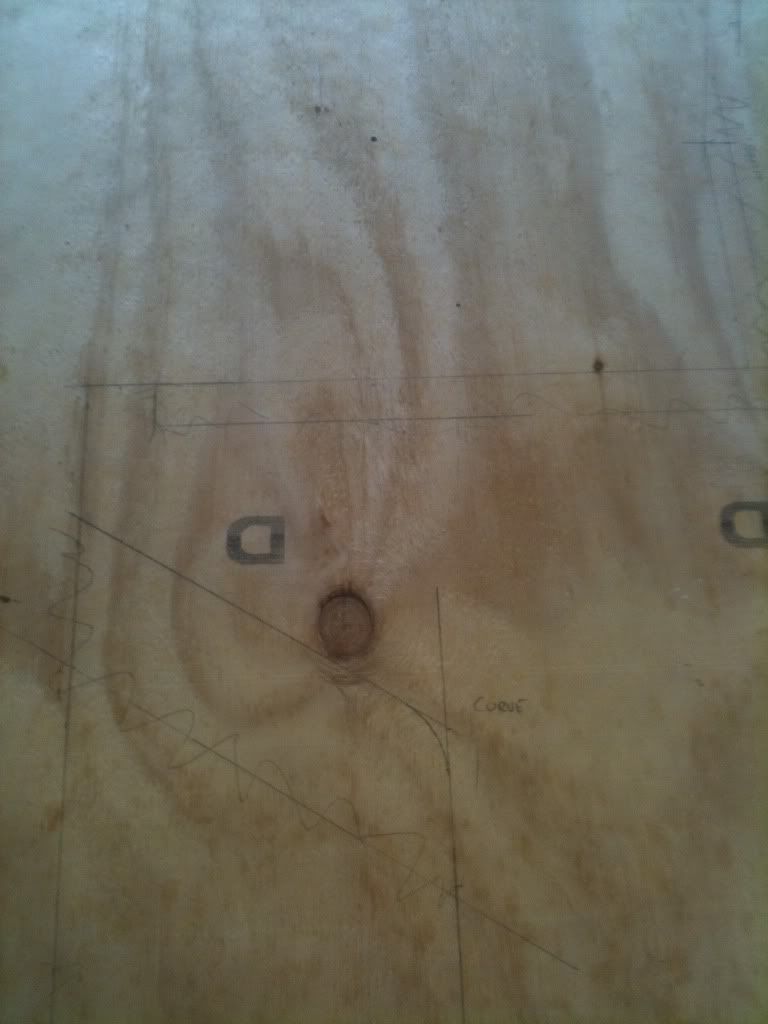

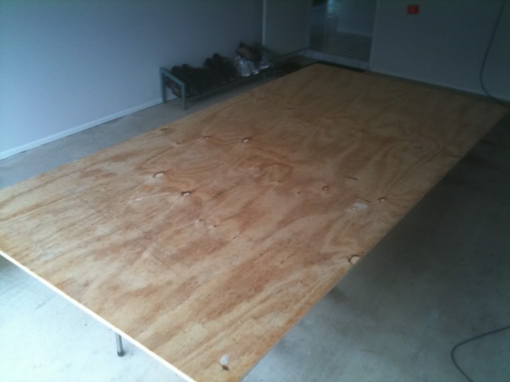

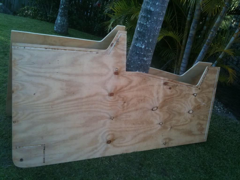

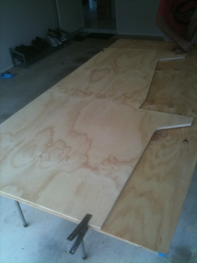

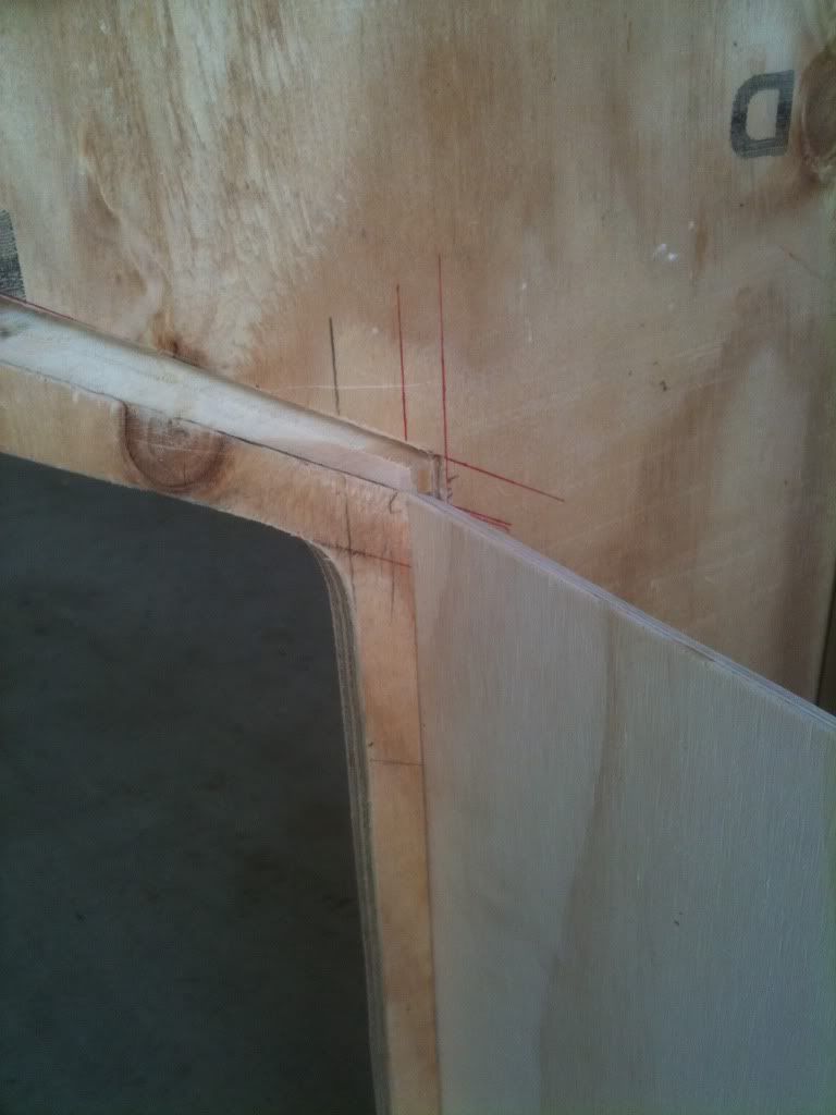

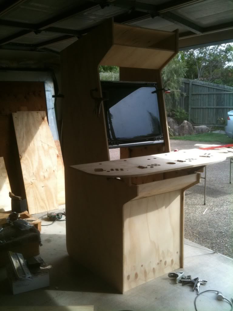

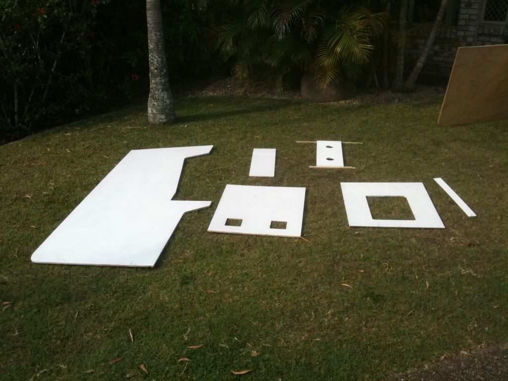

The frame dimesions were measured up alongside large sheets of 16mm of ply so that dimensions for the side panels could be thought up and drawn up.

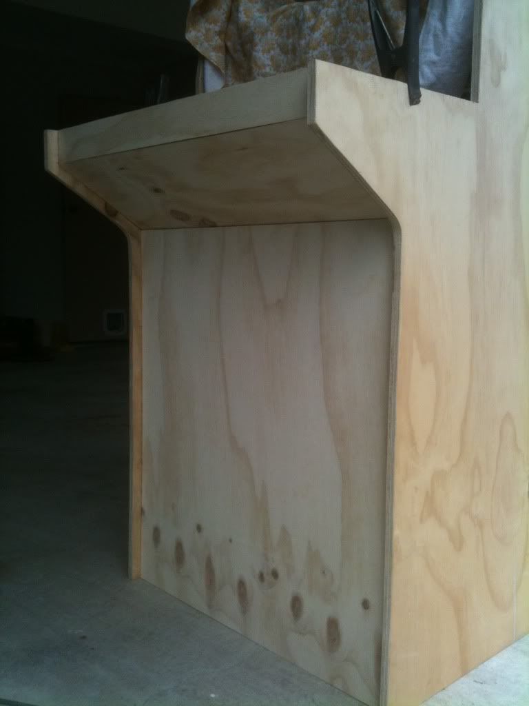

Generally, the side panels are similar in profile to a UAII cabinet if the sides were a single piece. The top of the side panels were loosely based on the Midway cabinets used for Mortal Kombat, NBA Jam etc. It was decided to follow the lead of the UAII design for the front, and recess the bottom of the cabinet and have angled bracing extend forward to assist with supporting the control panel. The angle of this cp support and the the ceiling of the cabinet to the ground are the same (parallel), and the screen was positioned at an equal distance from the top of the control panel to the start of the speaker panel above.  The sides were marked and jigsawed out. Curves were made at the bottom rear to allow for the wheels to function.
It was decided that all visible panels adjacent to the side panels would be recessed into a slot. This was for a few reasons. One, it maintained the minimalistic approach to visible fixation of the cabinet, as it could be hidden internally. Two, I didn’t want to simply butt-join the panels as I thought it would leave them prone to gaps and exaggerate inconsistencies with cutting. Three, the panels would have self-adhesive vinyl coverings and these would look seemless if the front panels were slotted into a trench. Four, it kept all panels consistent with the intention of slotting the bezel and marquee. Essentially, and I think this was the best way to approach the design and building of the cabinet, any imperfections in the cabinet would end up being hidden. So slots were created with a router to accomodate 12mm plywood (cheaper [free], lighter and actually a nicer quality finish than the 16mm ply used for the sides and control panel) at a depth of 20mm from the leading edges of the side panels.

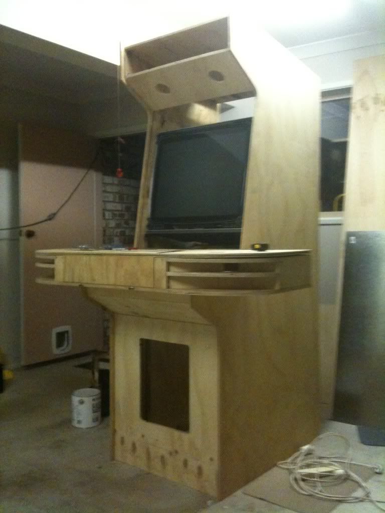

Recessed panels would include kickplate, two pieces for the control panel support, bezel, speaker panel, marquee, ceiling, and bottom-rear pieces of the cabinet. I also used the router to make circular impressions at the rear to acommodate the boltheads of the wheels. It was now a matter of beginning to assemble the cabinet.
I had deliberately not measured and cut the other panel pieces yet as I would wait and see what the measurements required would be once it was starting to be assembled. This allowed me room for error, adjustments to design (many intentions for design and changes were made along the way with this project) and angled cuts needed to help slot pieces together.

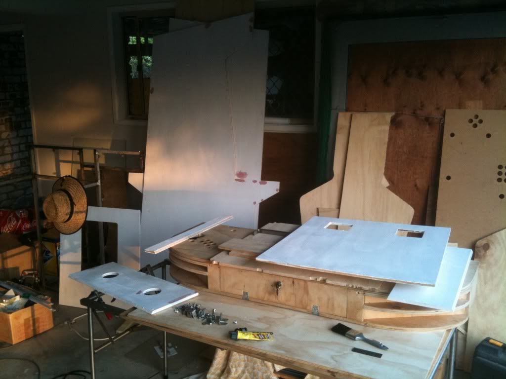

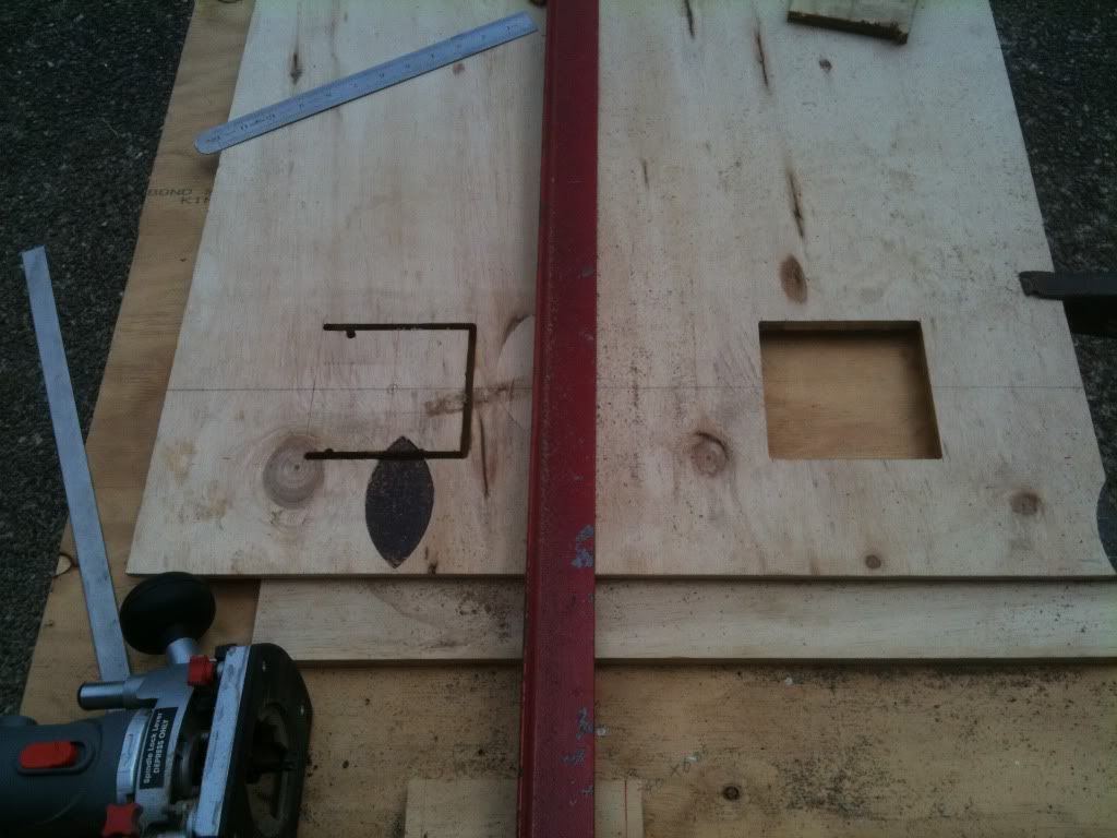

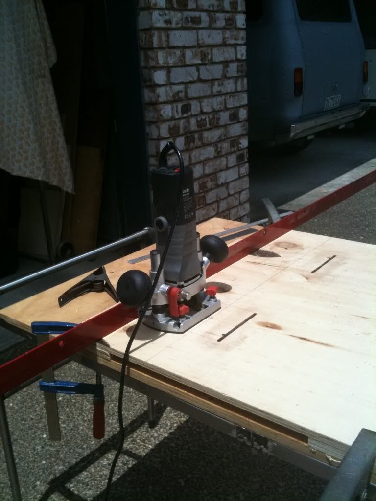

Now each panel just had to be measured, cut and put into place. I used a circular saw with a clamped guiderail to cut these pieces as their straight-lines were a little more important than the t-molded  hidden edges of the side-panels.

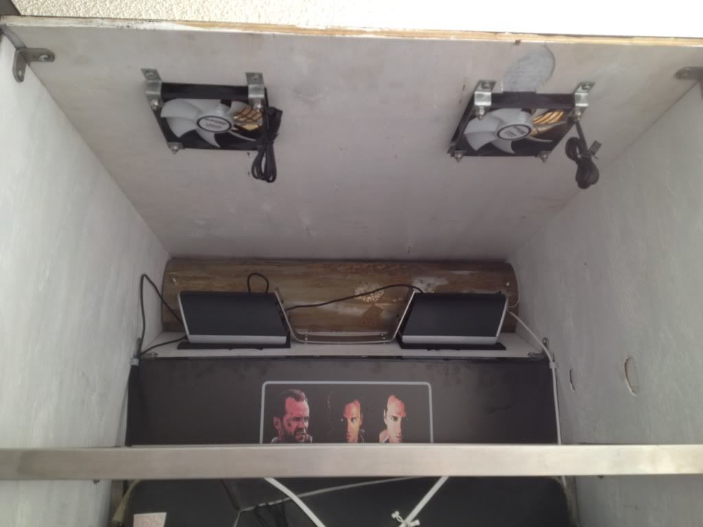

The ceiling panel had two square holes cut into it to allow for cooling fans. I used the router to do this as the curve on the router tip nicely accomodated the curved corners of the fans. To ensure straight cuts/routing, I again used a guide rail clamped into position.
As this was a very dynamic process, I was continuously adding and removing pieces and panels to envision how things would look and what my next step would be. Here I added the control panel top (at approximate height) to see how it was a looking as a whole. Note that at this stage I had not actually started construction of the control panel box.
Clamps were used to hold it together prior to pre-assembly. Fixing with screws would come once all pieces were made. The hole-saw I used to cut the trackball was actually the same size I needed for the speaker panel. You find co-incidences like this along the way, and in this instance it was another simple solution. The speaker panel allows directly for the Logitec speaker cone sitting behind it. This panel is very unassuming, there is a LOT of power behind it. I also jigsawed out the hole for the coin door. I actually didnt have the coin door with me at this stage (it was still on-route) but I found dimensions for it online and took the plunge of cutting without having it with me. Fortunately this was a gamble that worked out alright (I cut inside the lines and ended up having to sand it out to make it bigger later on). I only did this because I was desperate to begin painting and didnt want to move onto that step until I had all parts/panels ready to go. Note that the actual viewing area of the screen is equal distance from the control panel below and speaker panel above – symmetry!
A hole was placed at the rear of the cabinet to accomodate another fan. There would be three fans in total – one at the bottom with a filter drawing air into the cabinet, and two in the ceiling exhausting air out of the cabinet. As hot air rises, this ensures that cool air enters the bottom of the cabinet and is drawn upwards past the computer and monitor and exits through the top.
As different aspects of the build were occuring simultaneously, it is possible to see here that the drawer-door camlock, hinges and presumably internal structure of the control panel was constructed only after much of the cabinet itself was already complete.

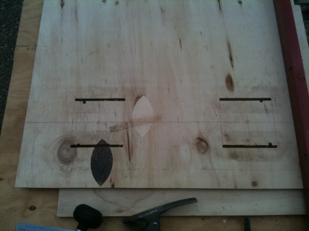

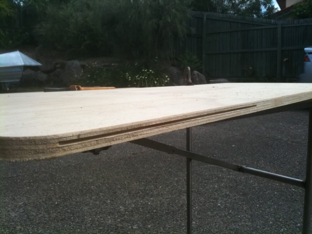

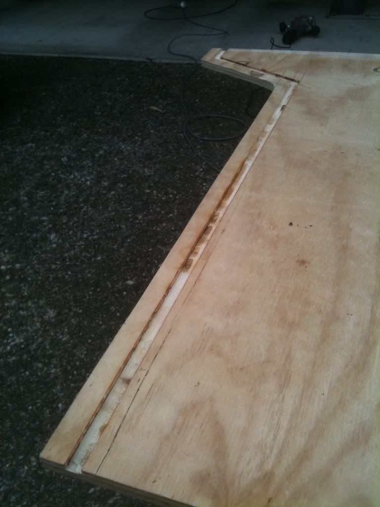

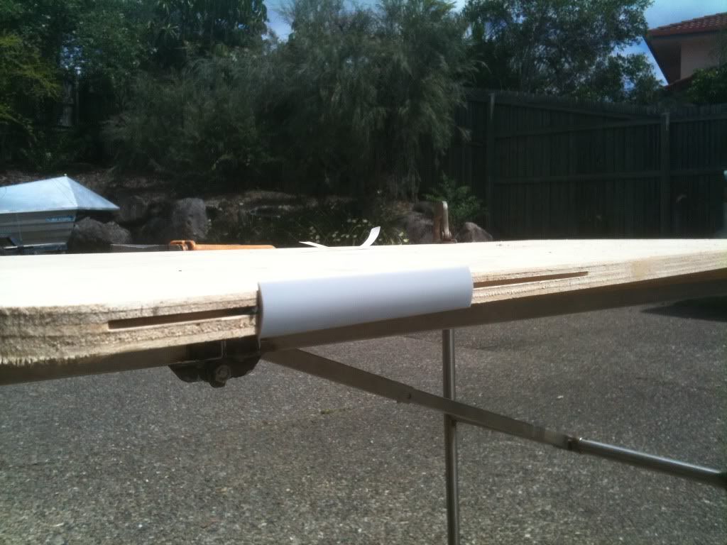

I was unable to find an appropriate sized t-molding slot cutter at the hardware store (Bunnings). The smallest they had was a 3mm cutter. I was too impatient to wait for the right sized cutter to come from elsewhere so I decided to use the 3mm cutter and offset it from center. The spine of the t-molding sat towards the middle of the edge of the ply, and the other part of the slot was wedged with a thin strip of plastic and woodglue. Thankfully measurements were correct, and a nice t-mold edge was produced with equal overhang on each side.

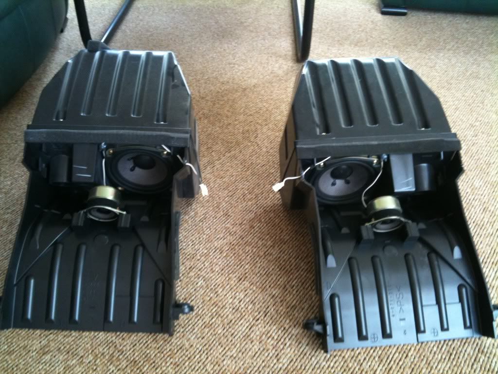

A testing session with the speakers attached to the speaker panel was necessary to observe for vibration/unwanted sound. A small amount of foam lining was placed between the speaker casing and the speaker panel to avoid this. A rear image of the speaker panel is shown later.

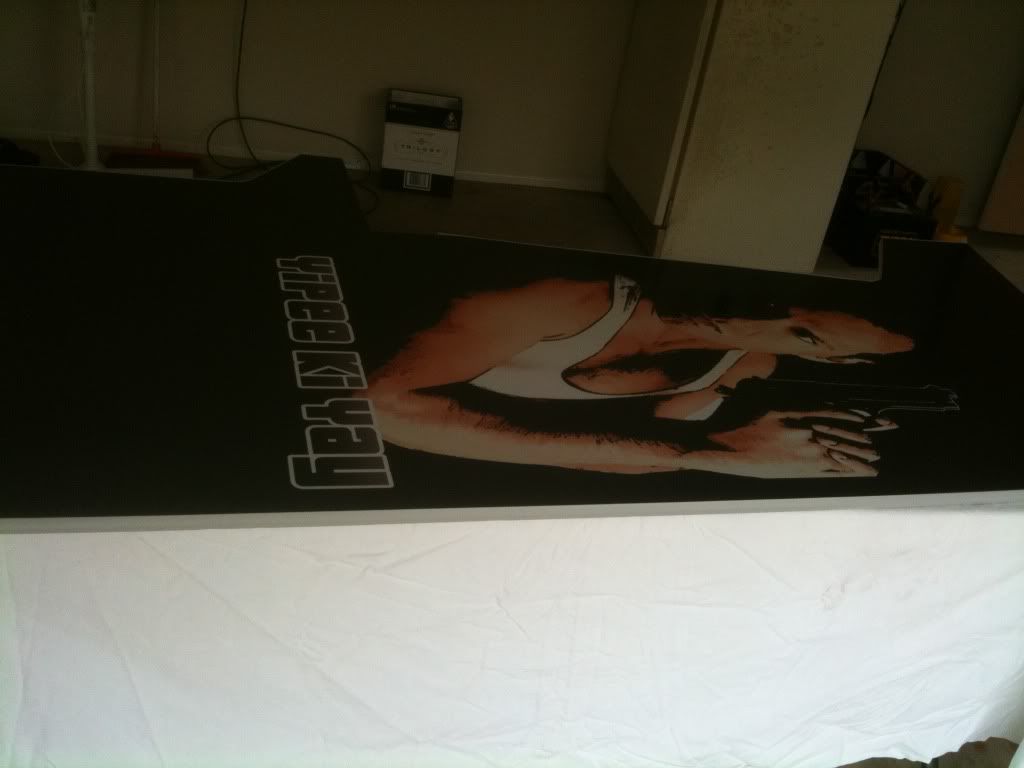

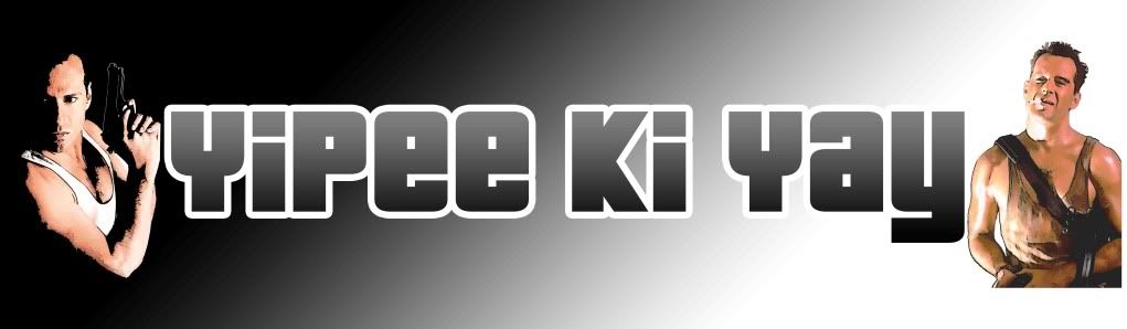

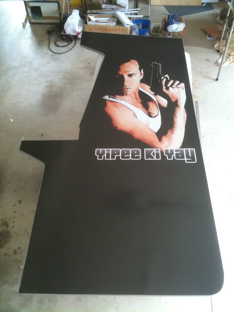

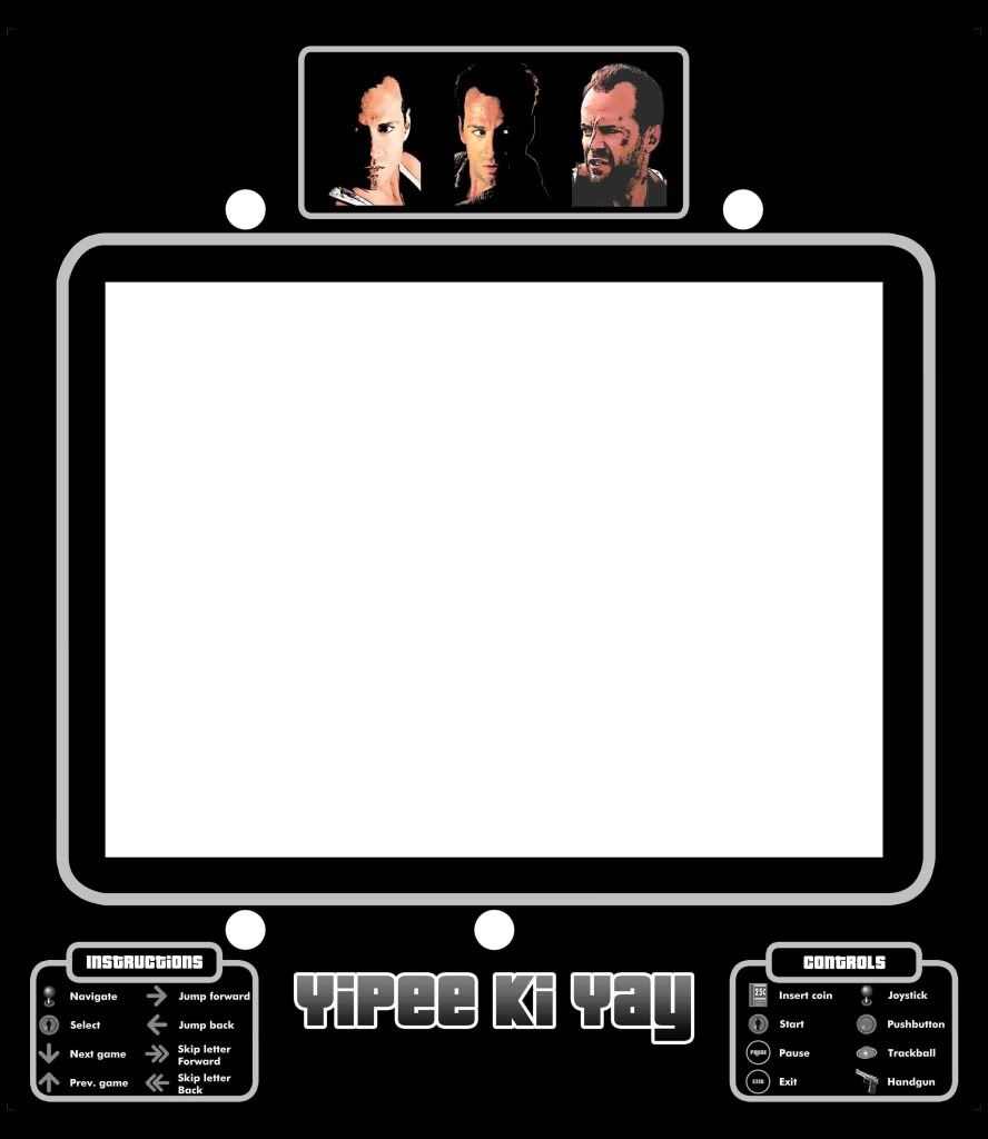

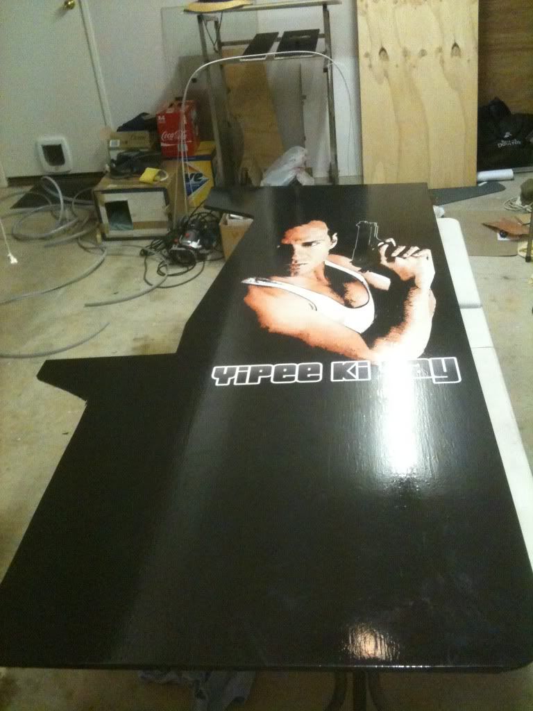

The artwork took a long time to develop and complete. I knew that I wanted a themed cabinet, but couldn’t decide on what that theme would be. I initially thought of a collection of game-related characters and titles, but decided that would be too busy. Plus, I didnt like the idea of combining cartoons with life-like characters, robots with people and animals, and different texts/fonts. I then considered movie-related characters (from 80’s and 90’s action movies primarily) who may have had tie-ins with games, but again I ran into the same problems of combining cartoon/comic type images with photographs. Additionally, I found there was a lot of variation between the availability of high-resolution images of said characters. Furthermore, there would always be a character omitted or included that might not have quite fit in with the others. This led me to decide that I would try and focus on a single character or game, and use imagery that was all the same resolution and picture type. Since this was a custom build and I didnt want to emulate a pre-existing themed cabinet (ala street fighter/terminator 2/rambo/mortal kombat) I decided that I would have to produce the artwork myself and create a totally new theme. After much deliberation, I decided that I would make a John McClane themed cab (Bruce Willis in Die Hard). He had the movies and arcade game association, and the internet actually yielded a good supply of high-res photos. Plus, I thought his general propensity to have fun whilst blowing sh!t up and doing whatever the f*ck he wants was a quality that resounded nicely with the experience I wanted to induce with this cabinet.
Now, I know that there are (currently) four Die Hard movies. But to me, the fourth movie doesn’t count since it wasn’t made in the 80’s/90’s (when my attraction to arcade games and love for those movies was at it’s greatest) and since it was made well after the first three, Mr McClane was now sporting a shaved head which didn’t really fit in with the other pictures I obtained. I used a couple of promotional shots for the main graphics, and then took screenshots from the movies to use as a type of comic strip on the control panel. Since I didnt want to just reproduce live-action stills, I converted the images to cartoon using a plugin in photoshop called Toon-It. Some manipulation, cutting & pasting, and brightness adustments later, I had created a sort of comic strip for the control panel overlay which represented the trilogy. Starting with the control panel dimensions, I filled in the control panel overlay with these pictures.
Since I loved the dialogue from the movies, and some of the quotes are fantastic, I added these as speech bubbles to further the comic feel.
I then used the control panel dimensions as a layer and created borders and shading to demarcate the actual player controls. I then re-adjusted some of the speech bubbles so that they weren’d hidden below the control borders, and removed the dimensions layer to reveal a completed overlay.

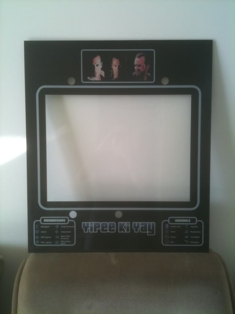

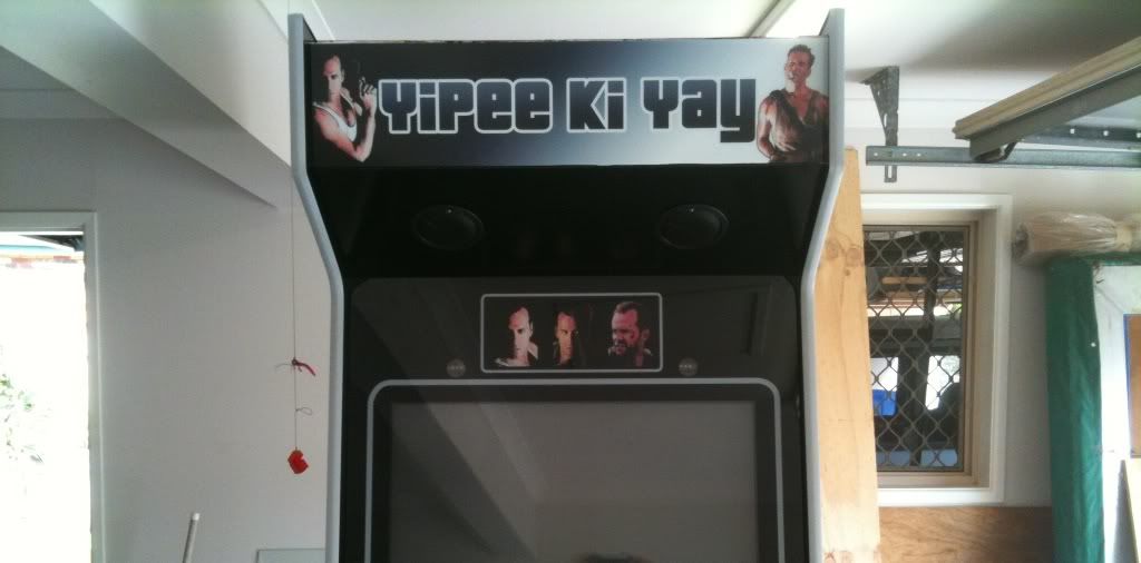

The bezel was created much the same way, by taking measurements from the assembled cabinet and creating a photoshop dimensions layer. I used this to determine where the artwork went, and then removed  the dimensions at the end. As noted earlier, I left circular areas as a void to allow for the Top Gun LED sensors to see through unimpeded.

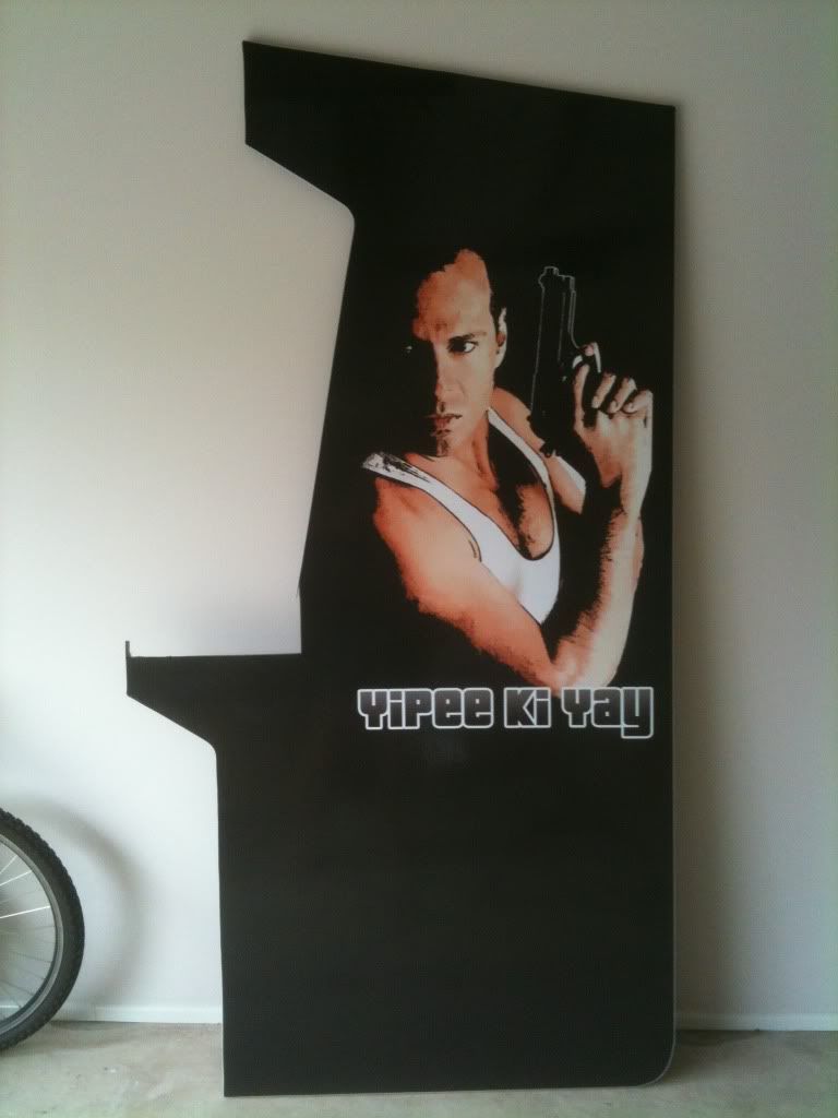

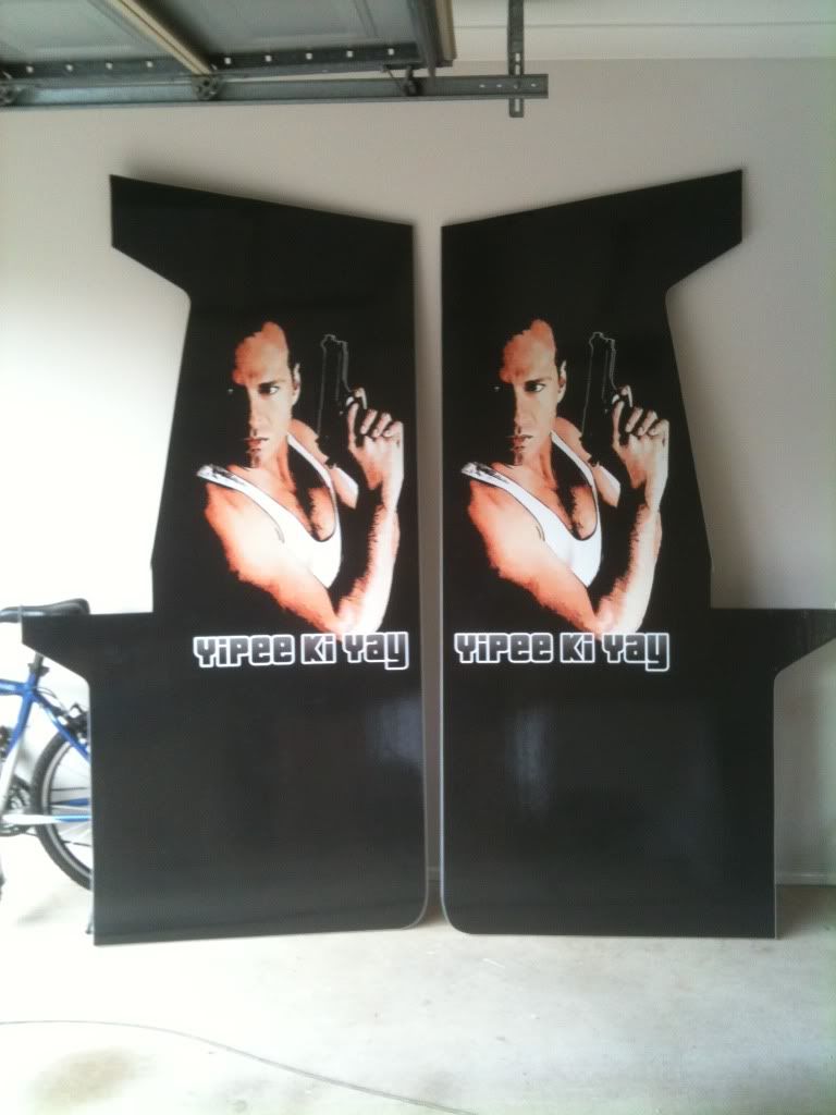

The side panels were also the same: create the dimensions in photoshop based on the cut pieces and add artwork. I deliberately left some very small light grey markings in a couple of corners on the print to highlight where it should sit on the plywood.
The marquee was deliberately created with excess on top and bottom because at this stage I still hadn’t finalised a retainer. Making it large allowed me to trim to size once I had it sorted. I knew that the retainer would cover a certain amount at top and bottom so that’s why the image was created with somewhat of a void there.
All artwork was deliberately printed with expanded borders to allow for error. The control panel overlay and side pieces were printed onto self-adhesive vinyl. I obtained plain black self-adhesive vinyl to cover the other panels. The bezel was reverse printed onto 6mm clear acrylic. Note that the reverse printing is simply absent where the LED sensors look through. The marquee was printed onto 3mm opal acrylic for maximum light diffusion.

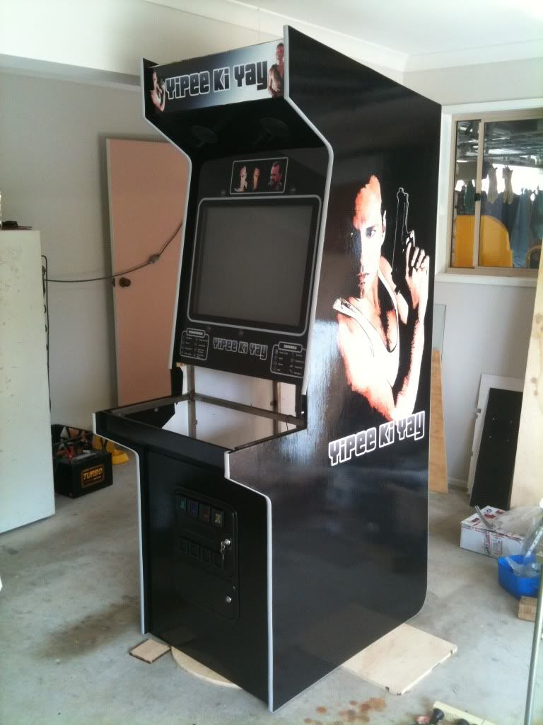

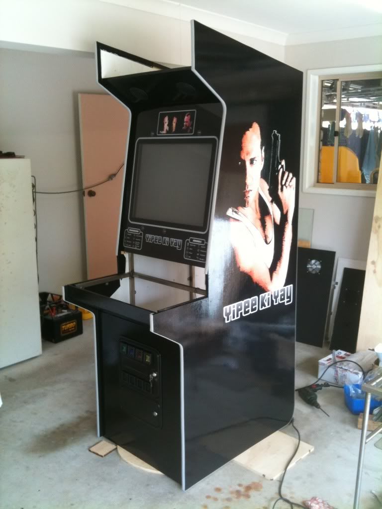

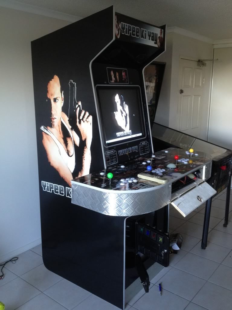

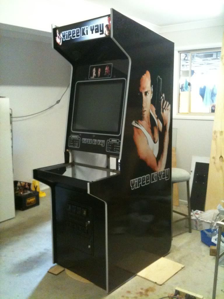

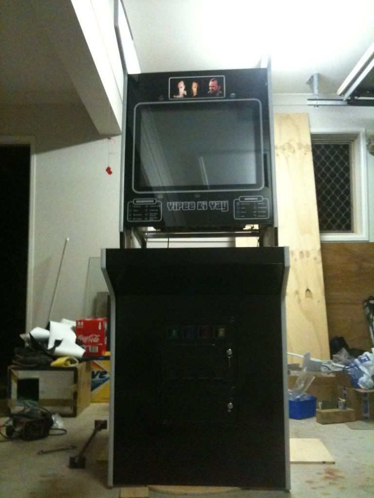

ASSEMBLY 1 – SEALING & CABINET

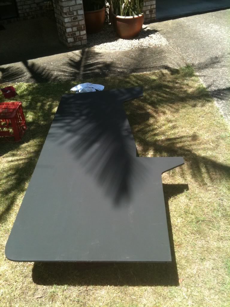

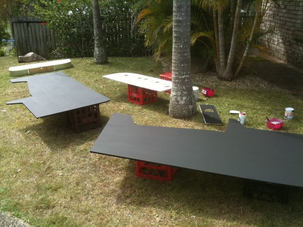

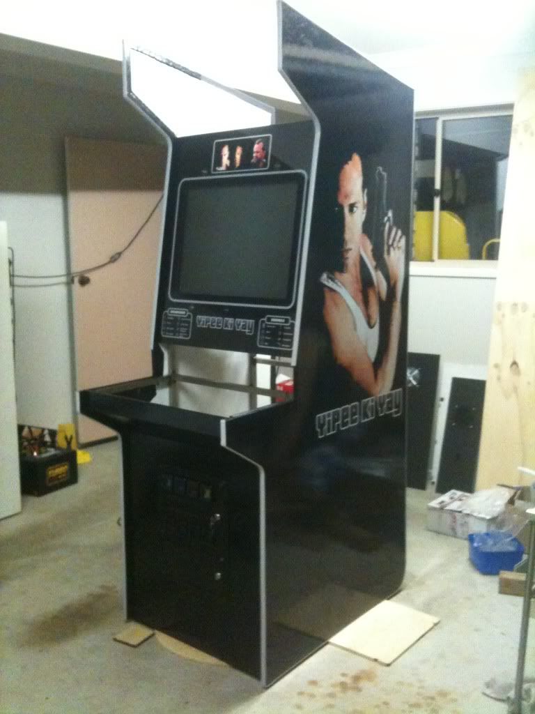

The cabinet was disassembled with all right-angle brackets and screws removed. All panels received an undercoat and then top coat with plain black paint. Note in the second picture here - in the background on the left is the stainless frame without the monitor box sitting on it.
The side panels had lots of clamp indentations and some large scratches so these were filled with some bog, dried and sanded prior to top coat. Especially for those large side pieces, you want to ensure that there is a nice smooth finish on any panel receiving adhesive vinyl to ensure it stays stuck. Plus, any indentations would show up under the glossy vinyl/artwork and could become eyesores or an irritation to you.

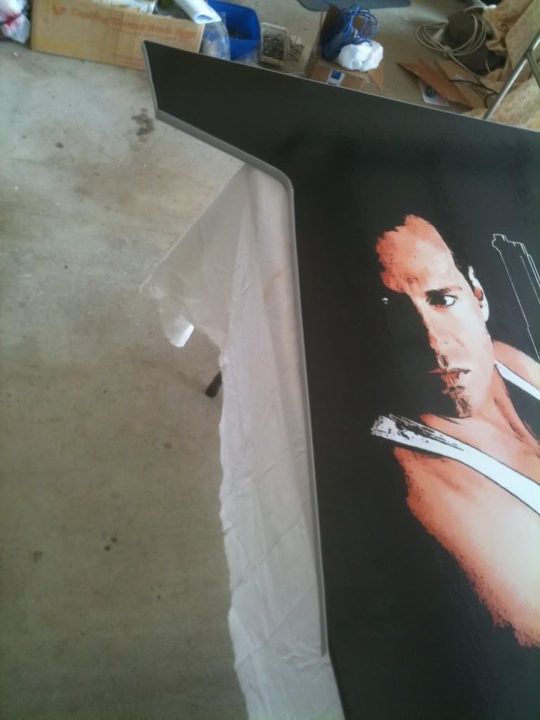

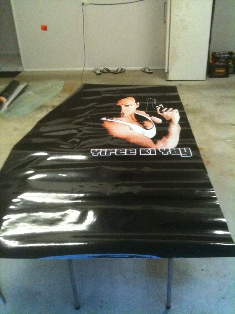

The vinyl was laid out over the side panels in a slow and tedious process. The small light grey markings were just outside the margin of the plywood and so were removed when excess was trimmed. A 5mm edge of vinyl was kept so that it would be sandwiched between the ply edge and the t-molding edge to give it a crisp tidy finish.
The t-molding on the side panels is one continuous piece that wraps around the entire edge. It is only broken to allow for the control panel box. I decided not to trim this flush with the panel as I didnt want to damage the artwork vinyl and the finish actually looked great. The overhanging self-adhesive vinyl was sandwiched below the t-molding and partially into the slot, so it gave a nice tight finish where the interface between vinyl and t-mold is.

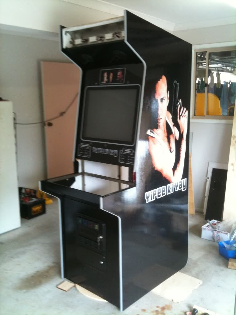

It was now simply a matter of re-assembling the cabinet and replacing all brackets and screws. In some places the brackets had to be re-done because the vinyl, although very thin, was sufficient in thickness to offset some of the pre-drilled holes for screws made at pre-assembly. I used more of the plain black adhesive vinyl for the recessed sides at the front of the side panels. This 20mm space between t-molded edges and slotted front panels now looked continuous with the rest of the exterior. It is possible to see the black strips of vinyl along the edge in contrast to the white undercoat which remained on the inside of the cabinet. These strips were also timmed with 5mm overhang to be sandwiched into the t-molding slot.

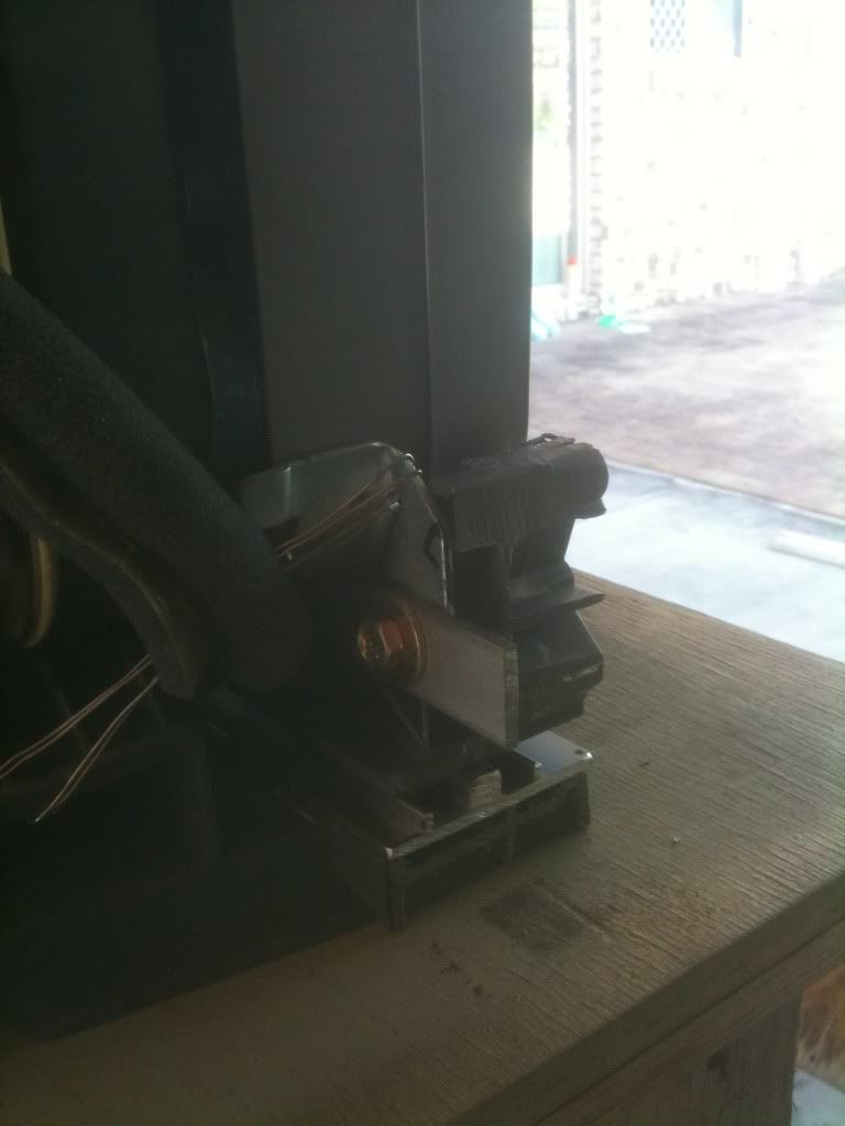

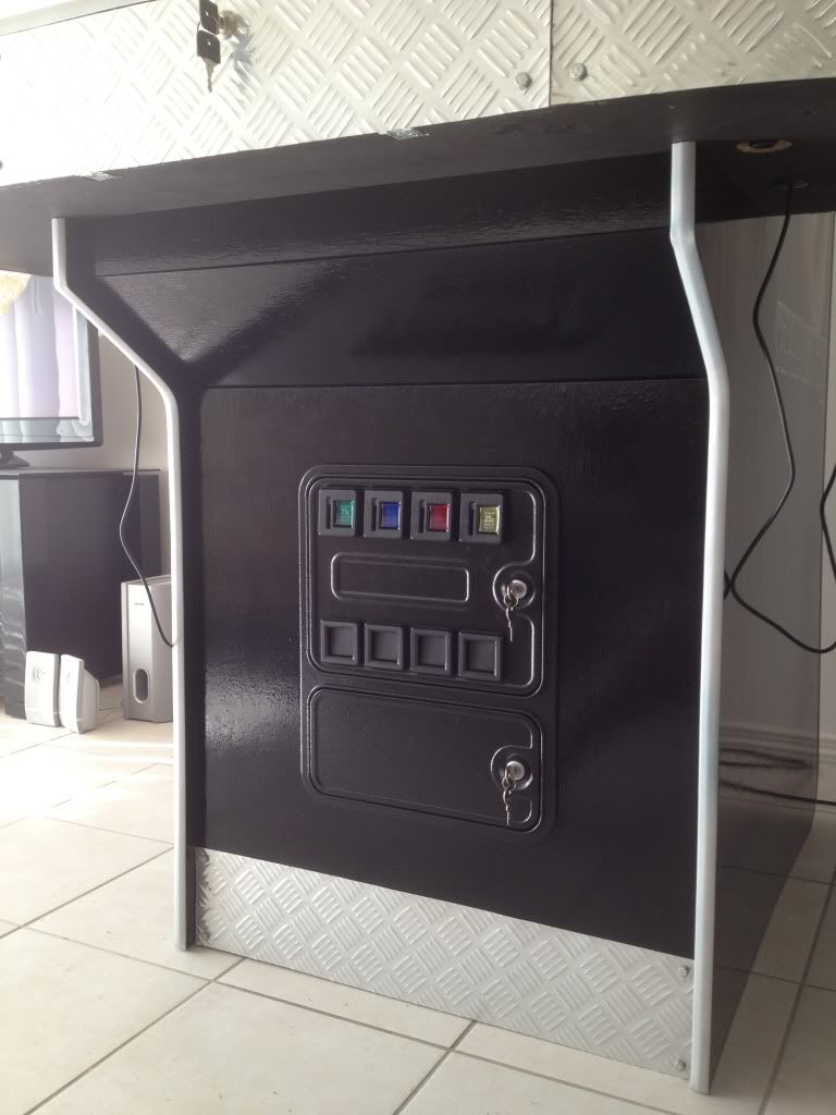

The coin door had arrived by now and was dropped into place. The coin reject buttons were colour-coded to correspond to the player buttons above on the control panel.
In keeping with the stainless interior theme, it became apparent that it would be a good medium to use for light management behind the marquee. An old piece of sheet stainless was recovered, cut to size and bent in a vice to provide a concavity behind the light source. It was polished up and set in place, after the lynx marquee LED’s were riveted on. A small hole at one end allowed the cords to exit further back into the cabinet. Note the LED sensors for the Top Gun bars sitting behind the bezel. The same type of foam that helped secure the Top Gun bars in place was used to form a buffered ring around the viewing area of the monitor, wedged between the monitor screen and the bezel (the grey ring around the viewing area on the bezel is roughly where it lies behind). This helps maintain distance between the two and also protects the viewing area from wandering bits of dust within the cabinet.

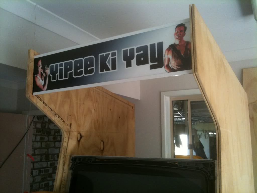

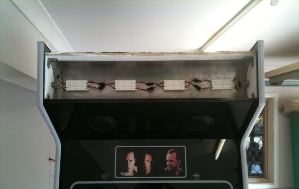

The marquee was set in place (also slotted into the side panels) and held in place with plastic retainers. These retainers were wrapped in more of the black self-adhesive vinyl – giving them the same finish as the rest of the cabinet. These retainers were then stapled into place on the edges of the corresponding panels behind them (the speaker and ceiling panels).
For a test, I hooked up a 9v battery to the marquee lighting. It actually runs on 12v but the 9v nicely demonstrates the power & efficiency of the LEDs.
ASSEMBLY 2 – CONTROL PANEL

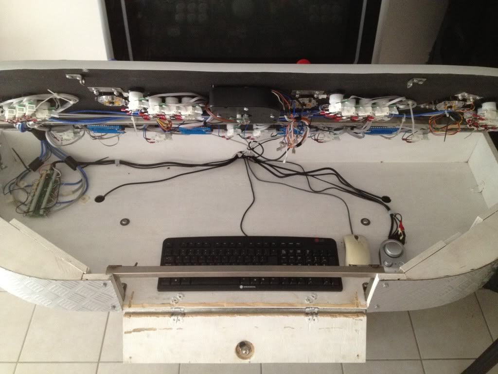

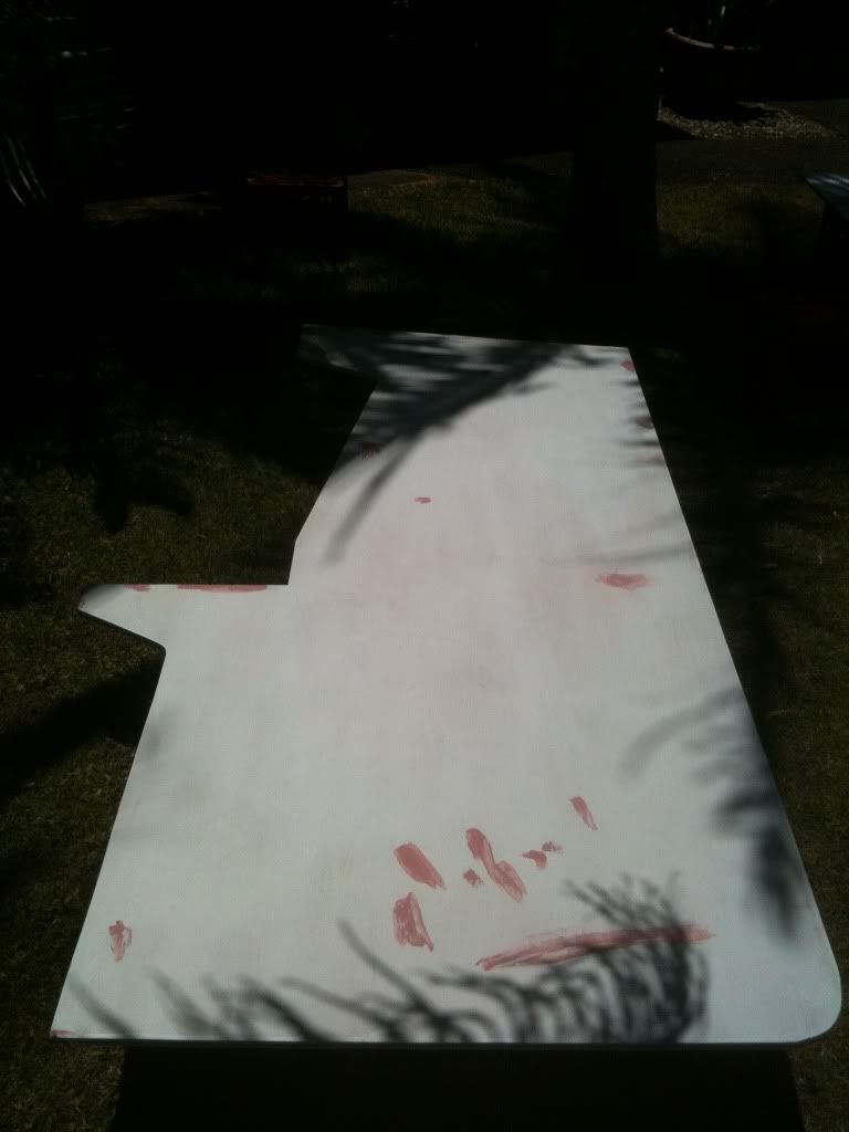

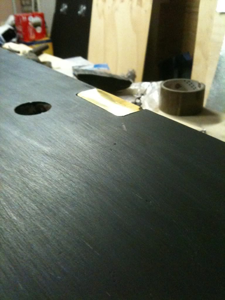

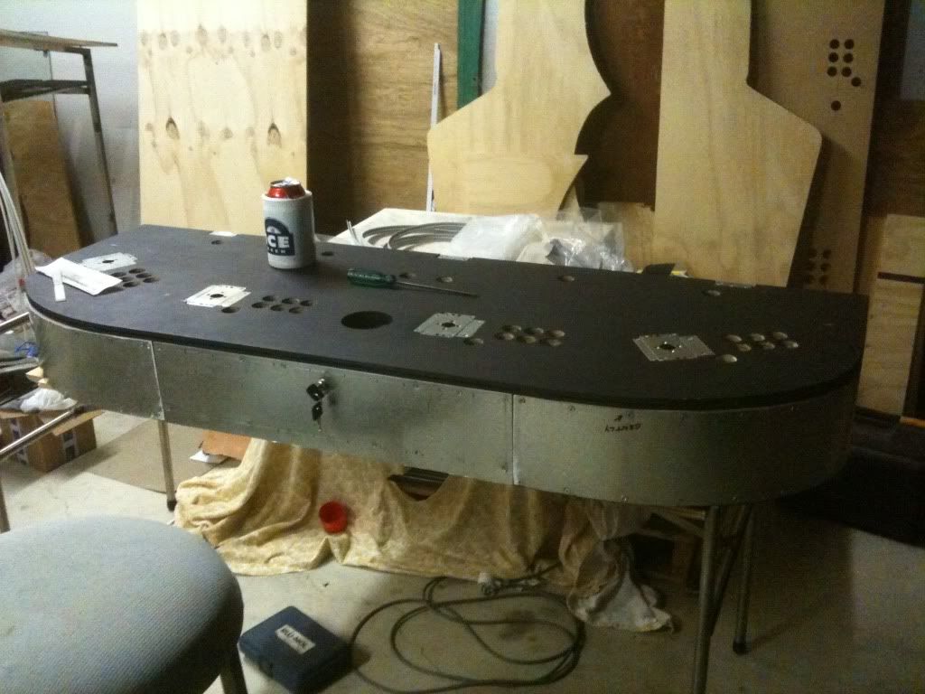

The control panel, once painted and reassembled was nearly ready to be decorated. The joystick plates were re-installed with the microswitch bundle removed. The plate was set flush with the top of the control panel by using brass shim on the underside. The shim was placed between the stainless plates and the control panel plywood. This brought the joystick plate down to flush with the top 1/1000in at a time. There were residual gaps between the ply and each side of the plate where the jigsaw was used to make room for the microswitch bundle. Using expanding foam to fill the gap was considered but it failed terribly on a trial. Instead, the router was used to create a small rectangular depression beside and including those gaps so that some steel sheet could be laid in and screwed down with countersunk screws. Again, brass shim was used to get them sitting flush with the top.
The bog filler came in useful again to fill in any residual gaps/lines that would persist and be noticeable under the self-adhesive vinyl. After applying and sanding, the whole top panel was now flush.

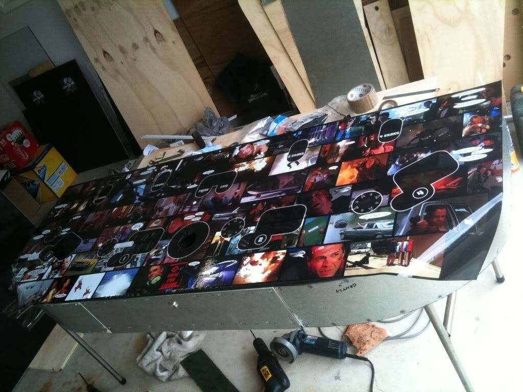

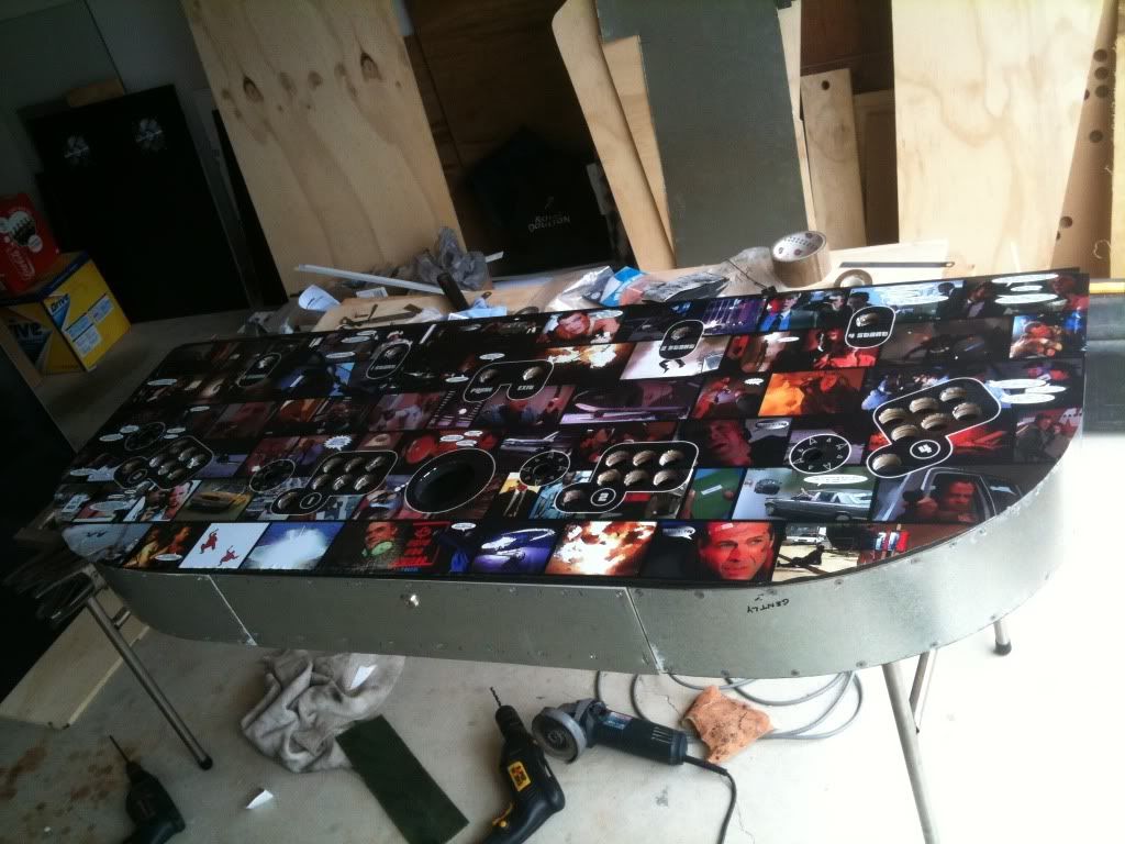

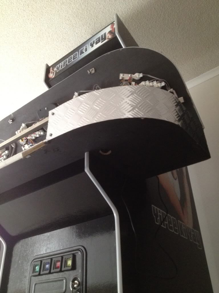

Galvanised steel sheetmetal was wrapped around the curves and sides of the control panel box. It was fixed in place with countersunk (very carefully with sheetmetal!) screws. The gap between the drawer-door and the sides was made as small as possible (~2mm). A grinder was then used to grind down flush the screw heads that were countersunk since some of them sat a little proud. It is possible to see the grinding marks on the adjacent galvanised steel.
Finally, brass shim was laid over the hinges to cover up the impressions that would be made by their shape and the phillips head screws under the vinyl.

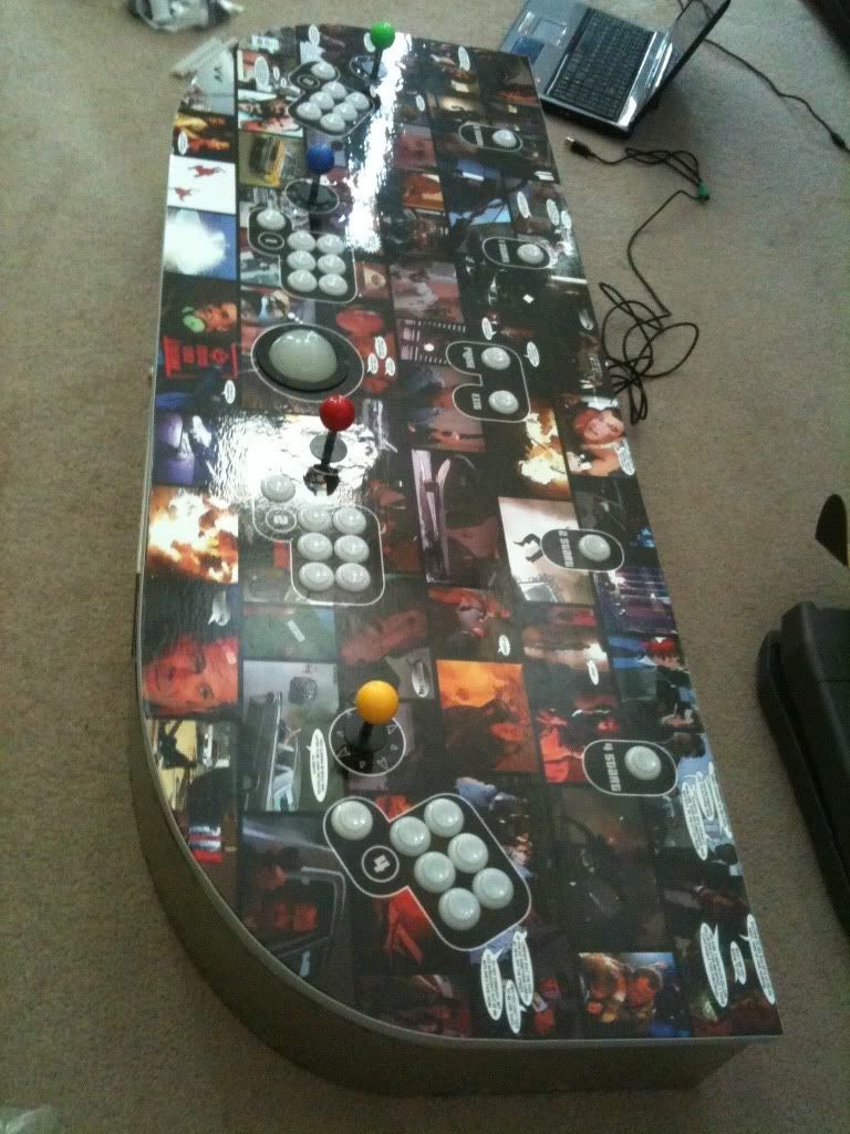

The control panel overlay was applied meticulously. There was some inevitable stretch in different directions with the vinyl so the controls borders didn’t line up precisely in line with the pre-drilled pushbutton holes but to be honest I didnt expect that they would. As near enough as possible was sufficient. A scalpel blade was then used to cut out the holes and trim the edges. Again, an approximate 5mm overlang was left so that the vinyl could be wedged into the slot on the edge with the t-molding.
It was preferable to get the t-molding around the control panel sit flush with the top surface, since having the t-molding sitting proud was not desireable because forearms and hands would always be sweeping over the edges of the control panel. Remembering that the slot in the 16mm plywood edge had been offset from center and the t-molding spine was wedged in with a thin strip of plastic and wood glue, I found that reversing the side the thin plastic strip sat on actually made the t-molding sit perfectly flush with the surface, and overhang a fair amount on the underside. This was a massive stroke of luck. I only had to trim the t-molding on the underside, rather than have to trim both edges equally. It gave a great finish on the top.

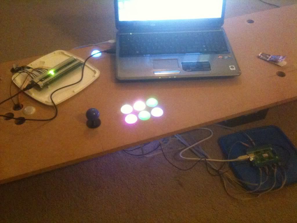

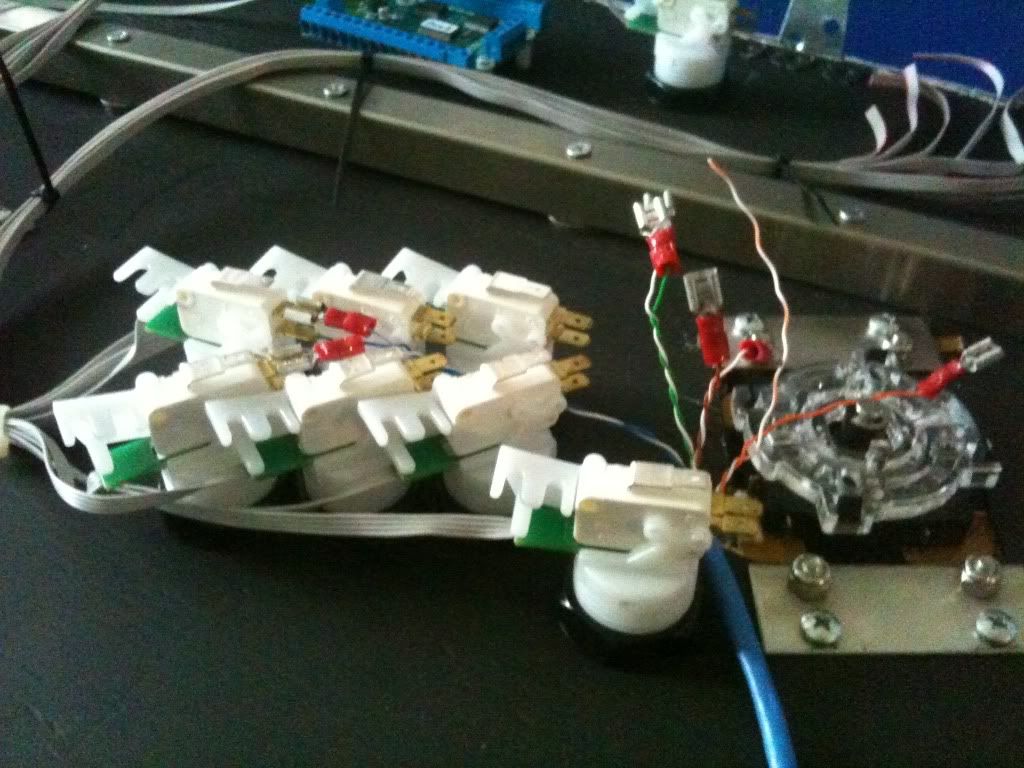

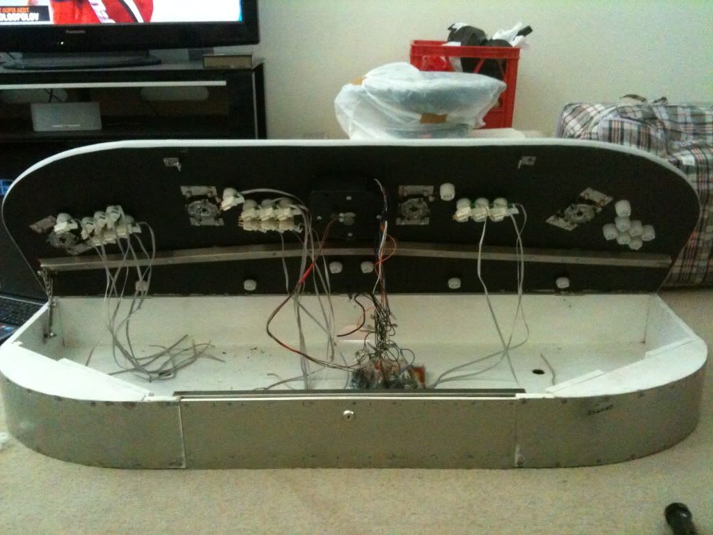

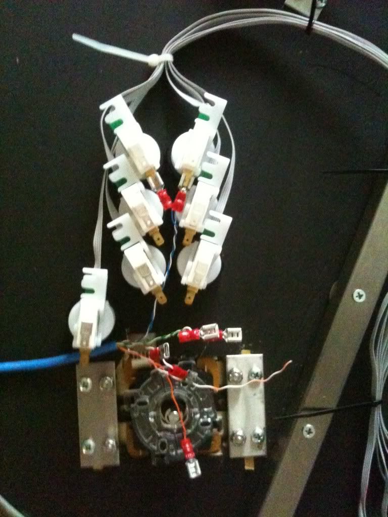

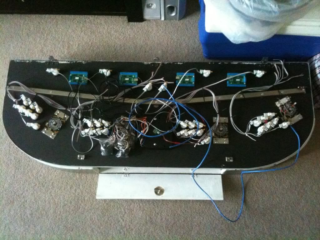

Colour-coded Sanwa JLF joysticks were set in place, along with GGG electric ice pushbuttons and an X-arcade 3-inch trackball with GGG electric ice ball. A super-high trackball kit from GGG was also used.
Wiring proceeded, which is a time-consuming task indeed. The four LED-wiz drives required to run all the LED’s were fixed to the underside of the control panel. The Ipac-4 controller was instead fixed inside the control panel box on the base.
The GGG RGB-drive wiring was collected together and directed towards their corresponding LED-wiz. Multi-core data cables were used to take pushbutton switches to the Ipac-4. The Sanwa joystick harnesses were managed next to the joystick and fed into multi-core cables to run parallel with the pushbutton cables. The stainless tube which was put in place for support and to take-away the bow of the plywood provided an ideal corridor for all the cables to run alongside.

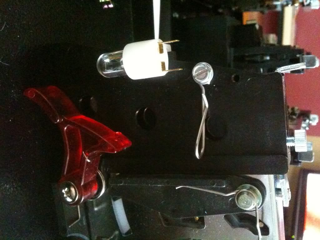

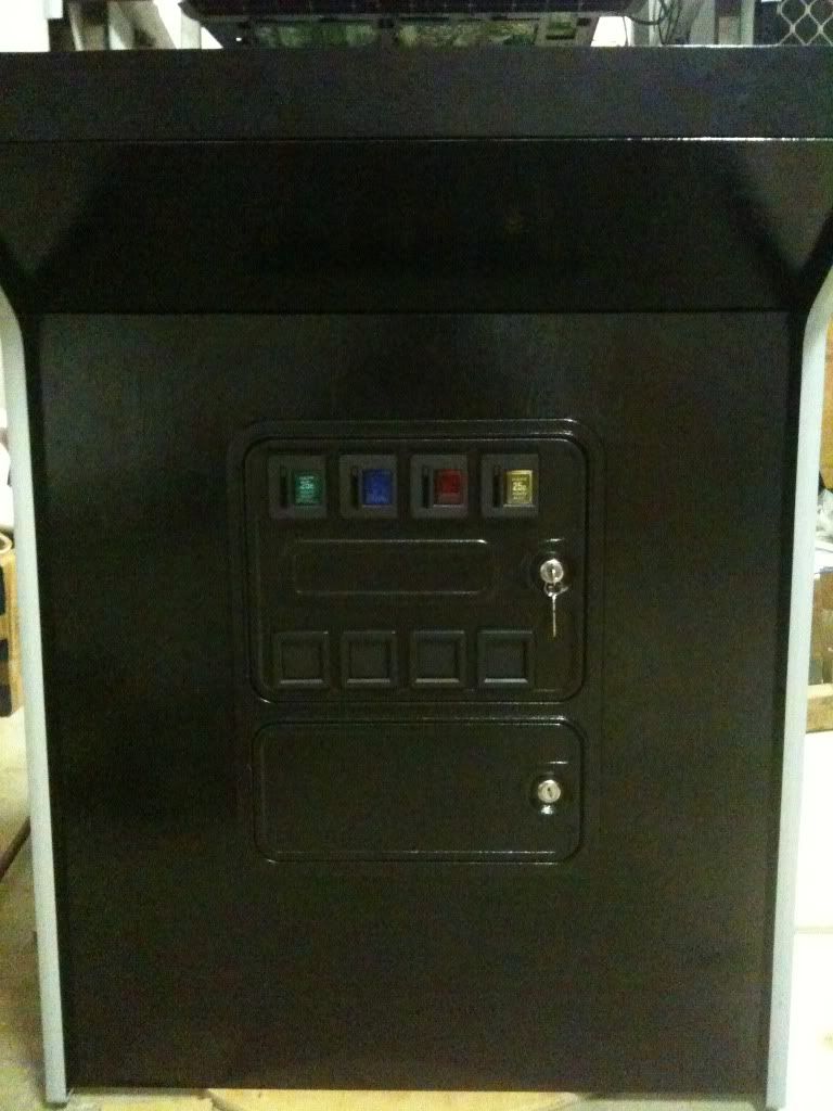

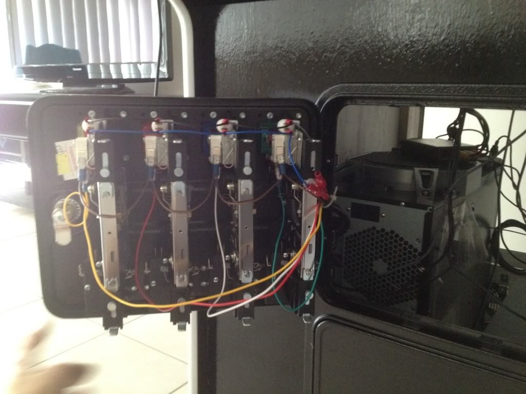

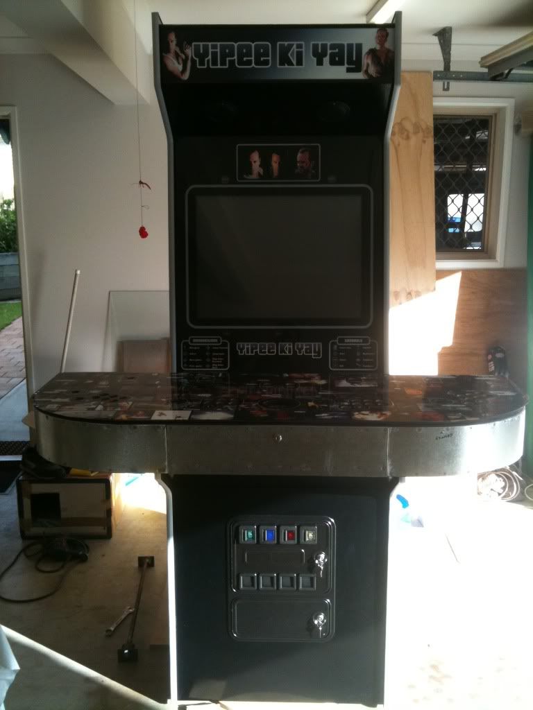

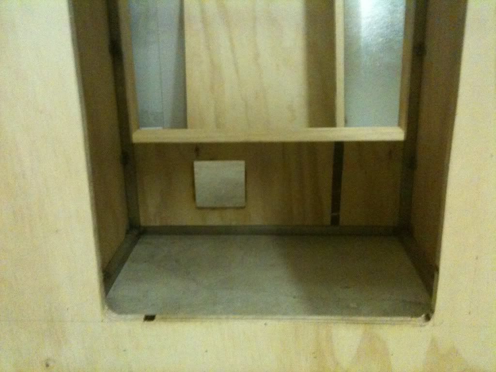

I knew I was going to incorporate a coin-door for two reasons, one aesthetics/authenticity and two, functionality. By having a functional coin door you are able to take buttons away from the control panel. It adds fun to the experience and helps to reduce clutter. The 4-player coin door I purchased came with four US-quarter coin mechanisms. I bought it along with blue/red/green/yellow reject buttons. I had to TEDIOUSLY remove the coin mechs and replace the original amber rejects with the colour-coded reject buttons. For future reference, a 4mm spanner will get to the hex nuts on these coin mechs but patience is required.

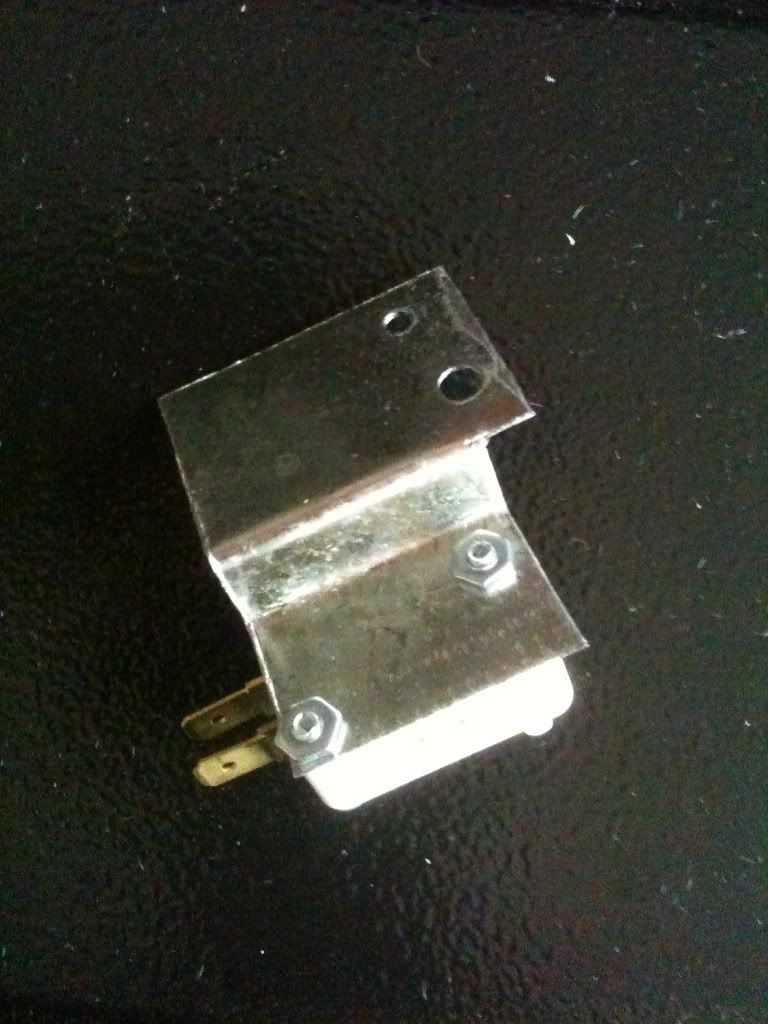

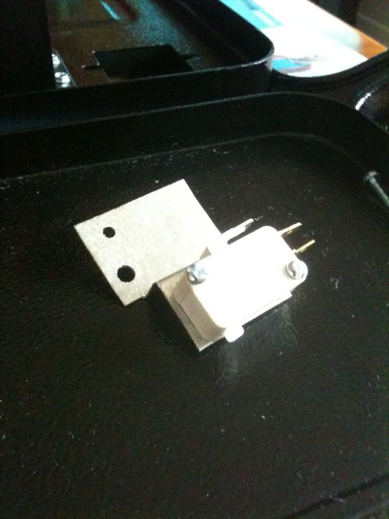

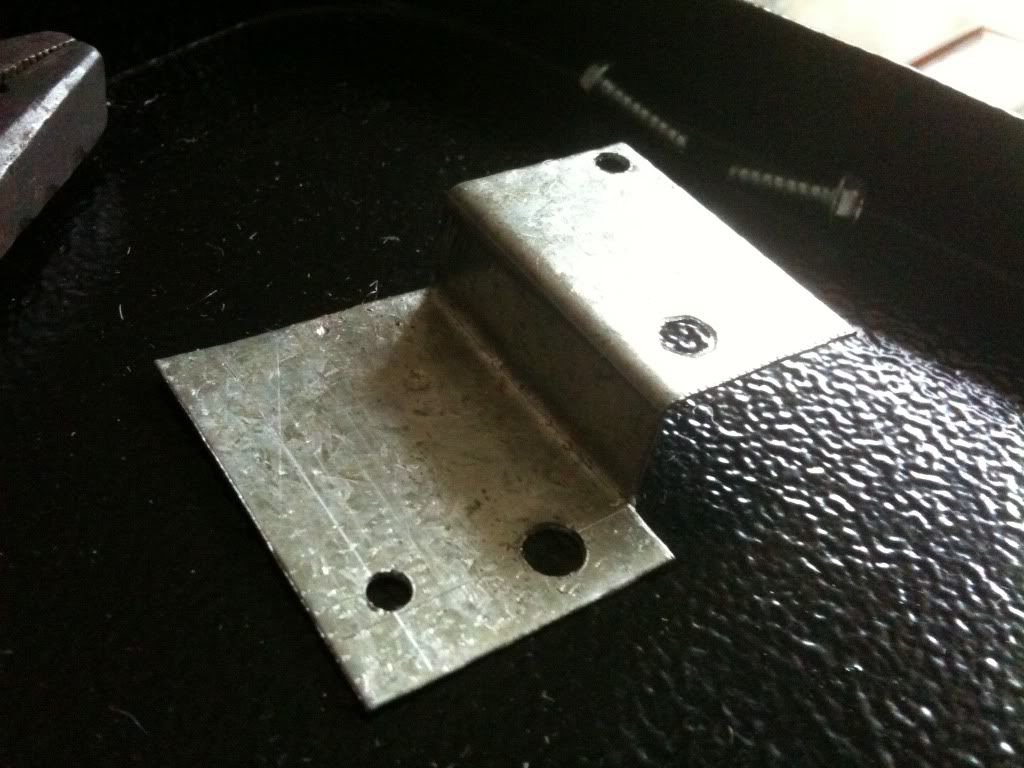

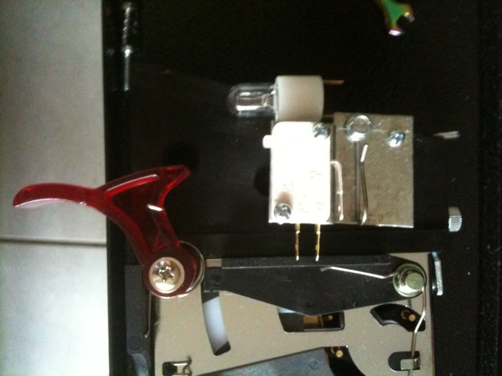

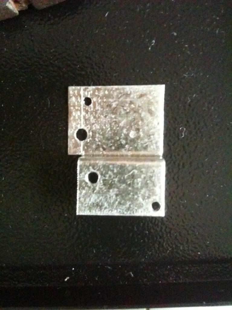

For the credit buttons on the cabinet, i decided to use the coin door rather than have buttons on the control panel. The coin door is setup to accept US quarters as a novelty but for simplicity I wanted the reject buttons to act as credits as well. To do this, a microswitch needs to be setup behind them. I had seen a couple of methods used to achieve this, including any combination of wood/glue/lever arms/cardboard. I decided that simplicity needed to prevail so I wanted to simply fix a microswitch behind the reject button at a set depth so that when the reject button arm swung back, it would trigger the switch. Fortunately there are existing screw holes sitting in the ideal position to achieve this. All that was neccesary was to use those existing holes as anchor points for a bridge to set the microswitch behind the reject arm.
The solution was some leftover galvanised sheetmetal cut to size with two simple bends. These were measured to place the microswitch at a depth near the end of the full depression of the reject button. This means that full depression of the button puts the lever arm flush with the body of the microswitch. So for a credit, one complete “stroke” of the reject button will provide one switch. Addendum – After I finished building the cabinet, I have since discovered that Martijn at BYOAC did much the same thing. http://forum.arcadecontrols.com/index.php?topic=112721.0

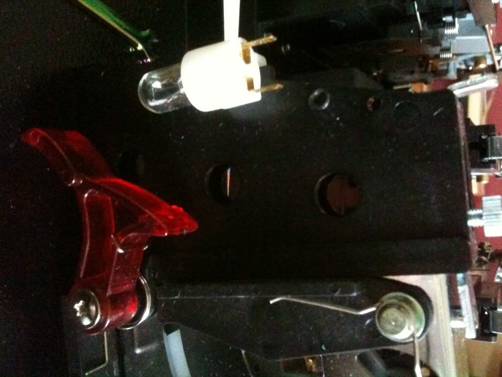

The reject button microswitches were wired together with their corresponding coin mech microswitch so that either or both could be used to provide a credit. The lamps for the coin door were wired together and powered by the PC power supply.

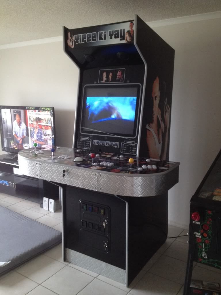

The checkplate sheet was cut to size and adhered to the sides of the control panel and along the bottom of the kickplate. To fasten it completely, and for added aesthetics, I secured the ends of each piece of checkplate with coachbolts, since they had the hexagonal heads. The height of the checkplate on both cp and kickplate is equal.
Sharp clean lines.

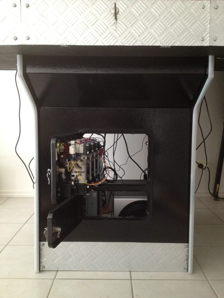

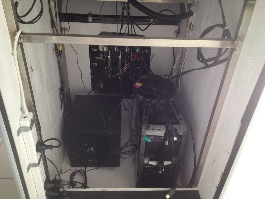

I deliberately bought a decent graphics card because I wanted to play newer games like SF4 on the cabinet. To run/look good, that requires a graphics card. However, the problem with available graphics cards is that RCA/analogue outputs are obsolete. A way had to be found to convert the digital signal on the newer graphics card to the RCA inputs on the monitor. I reluctantly purchased a hdmi-to-RCA converter, since I really would have liked to find an analogue output on a decent graphics card but it was just not possible. The RCA plugs at the rear of the monitor take the analogue signal from the hdmi converter. The converter rests on the PC tower fan inside the cabinet to maximise airflow around it as it can get quite warm.

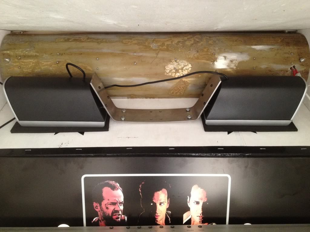

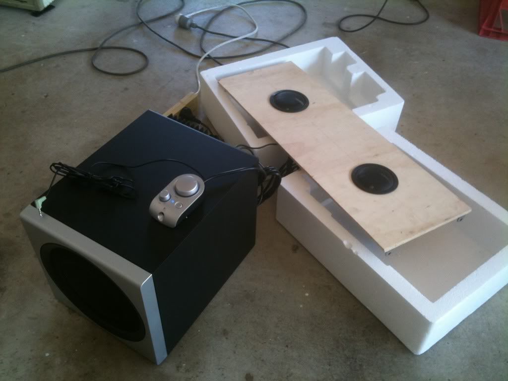

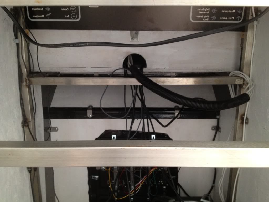

As described earlier, the speakers are mounted to the rear of the speaker panel with some foam padding in between. A single piece of bent-to-shape stainless provides a simple base for both Logitec speakers to simply screw on to. The speakers had their original fabric cover removed (simgle unit that pops off), which can easliy be replaced should the speakers ever be taken off the mount. The speaker base/feet can also be screwed back on. That's only old glue on the back of the concave stainless, not rust!

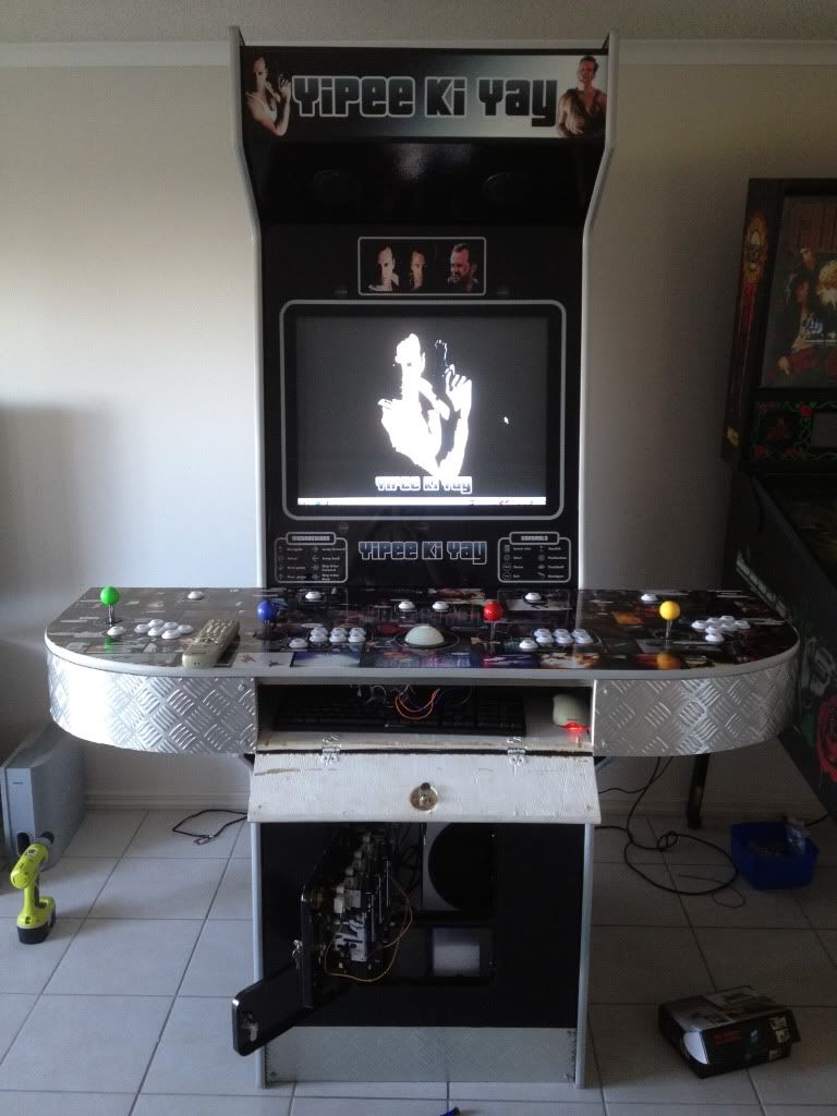

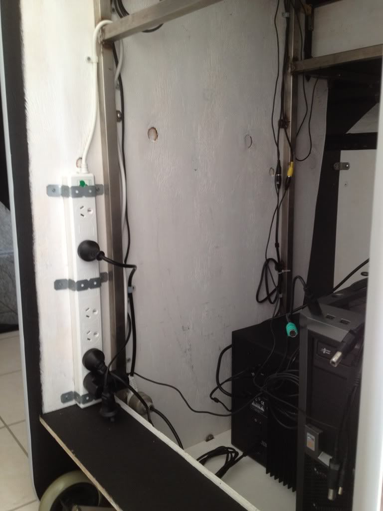

Some cable management comes in handy inside the cabinet. I used a combination of cable ties, anchors and ducting to help. The power board was also mounted to the side to keep it out of the way. The power cord plugs into the wall and enters the cabinet through a gland at the bottom rear. This “power cord” is simply an extension cord that the power board just plugs into, which then distributes the power.
The cab switches on from a single pushbutton located below the control panel. This pushbutton is wired directly to the PC motherboard in place of the PC tower on/off switch. The PC is the “master” device on a smart power board. Switching on the PC via the pushbutton also provides power to the monitor, speakers and hdmi-RCA converter. All auxillary units (marquee LEDs, coin door lamps, top/rear panel fans) are wired directly to the PC power supply. The monitor IR receiver was initially left intact at the rear of it to enable the remote control to be used to make adjustments. Then the main monitor on/off switch was bypassed (read: ripped out and rewired) so that power on at the wall automatically turns the monitor on to channel memory - AV!
An interesting and unexpected bonus of the pushbutton setup is that if it is pressed while the PC is on, it instructs windows to commence shutdown. It isnt necessary to hold it down for 5-seconds to induce a hard power-off like the on/off switch on the tower would. So it switches the PC off in a safe manner and then by virtue of the powerboard turns off all other components as well. Exiting from hyperspin of course has the same effect.
Two small pins (one on either side) are mounted to the stainless bridge on the inside of the control panel. A catch is screwed to the underside of each side of the top panel which, when closed down, lines up with the pins. Reaching in and engaging the pins locks the top panel down in place.
Looking down on the control panel.
Black bar filling the gap between the control panel and the bezel. It is fastened to the side panels and sits flush with the control panel.
The unit boots straight into Hyperspin. The opening flash video is the music video “Die Hard” by Guyz Nite, which delivers a wicked bassline courtesy of the woofer deep in the machine. Currently there are mame and model 2 games available. I intend to add home consoles and select PC games soon.
COMPLETION & ONGOING
The cabinet is now essentially in a state of completion. I have to add a simple slidedrawer to the inside of the control panel so the keyboard and mouse can be brought out. I also have to finish the gun holsters and hang them from the underside of the control panel. They will be a hybrid of stainless steel and purchased Happ gun holsters. I will be adding a rear panel, but for now the back is open for easy access. I am still in the process of tweaking all controls/leds/software and calibrating the guns. I work far too much and have had limited ability to do this – I have not switched it on in about a month. Currently all peripherals are working and I have hosted a couple of (boozy) nights playing this box. But when a friend came around and saw it for the first time and asked where I bought it, I was content.
All lights on:
Thanks to everyone on this board who describes their builds and provides pictures, it’s always great to see how something was done on so many great projects. I will provide updates/pictures in the near future. Enjoy.
« Last Edit: June 18, 2012, 11:25:33 pm by henbury »
