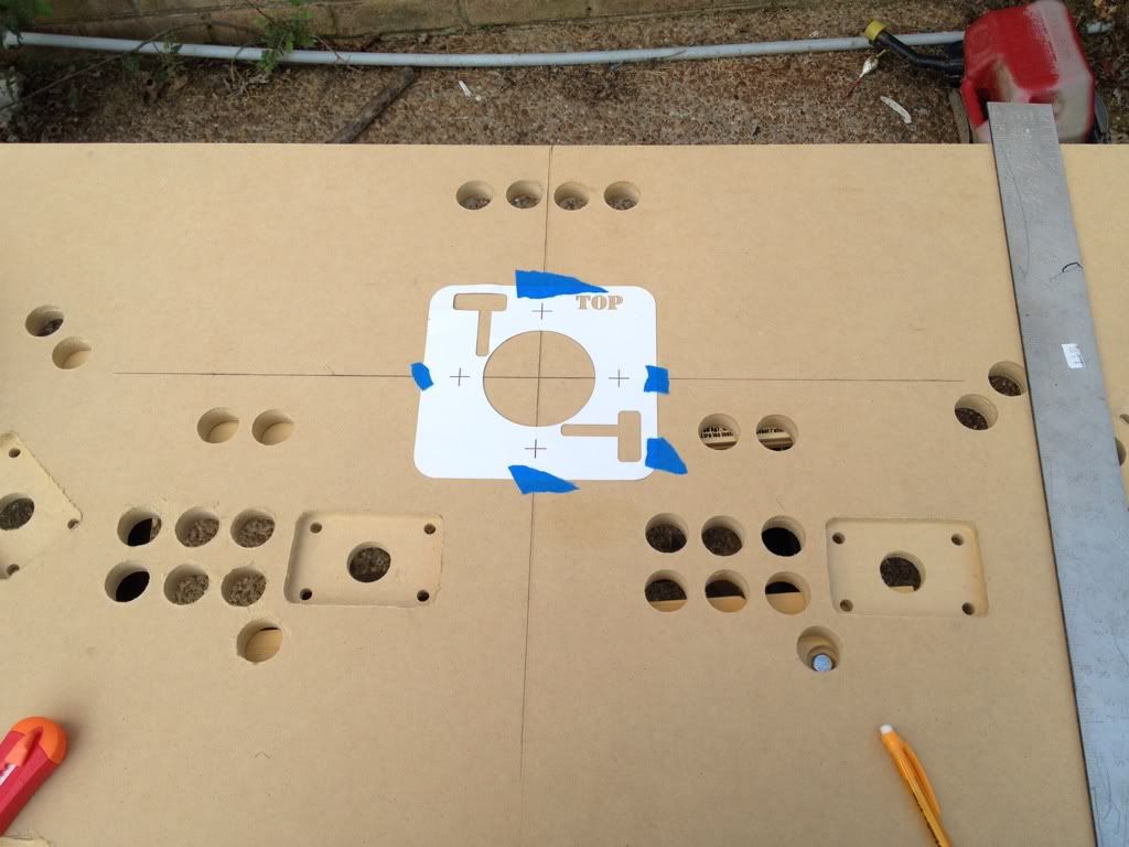

This CP was built about 3-4 years ago.  It's been hooked to the PC and monitor on my spare workbench for a few years.  It's a Happ 3" trackball on an optipac, 21 Happ buttons, 2 Happ Competitions for 8-way and 1 Super for the 4 way...all on an i-Pac4.  All parts are used except for the buttons and the art (mame marquees).Here it is in it's infancy:
Front flip design...using euro hinges.  Base is 1x4, top and base is 3/4 MDF.  T-molding by t-molding.com:

Say buhbye!   :applaud:  My initial control panel was too frickin' huge.  I'm going to rebuilt it smaller...probably about 36" x 15" (instead of the 48" x 19").

« Reply #5 on: February 21, 2012, 12:56:55 pm »
If you are rebuilding the panel then seriously consider not angling the joysticks and just installing them square towards the monitor. I promise you won't regret it.

I agree. Don't angle them. I started off as an advocate of angled joystcicks. Once put into practice, I quickly changed my mind about it.
It sucked and my kids thought it blew also.

Yeah, that's one of the key reasons...besides the size issue.  I'd like to do something along the lines of the infamous Knievel CPs.  Only, I can't seem to find reference measurements (If anyone knows a good source...LMK).

OK.  MAJOR update this weekend.  I've had the art since mid-week...I've had the printed template for weeks....I've had the materials for over a week.  What I didn't have was the stones to actually risk ruining all that stuff....until this weekend.
This is my first control panel done from artwork.  It's also my first time using Photochop, my first time working with plexi and really, my first time really, REALLY cutting from a measured template.  My last CP was a mess of whatever I built that day with little planning.  So, this weekend, I pulled up my courage and just got down to it.  >:D :angel:
OK...typical 3/4" MDF with 1/4" chamfer using a 45 degree laminating bit I found in my router case when I bought it (from a pawn shop...long story).  1/8" plexi from the HD...45 degree chamfer on trackball and all 3 joysticks (bottom mounting...so it needed it).
First thing I did was I built an ad-hoc plexi trimming station out of a scrap piece of MDF and a nice 1x2 nailing strip...score the plexi on the right side of the strip using it as a straight edge, then slide it through and snap it off:
I recessed the trackball so it sits under the plexi/art:
These are the marks I used to create my Happ template (available for download!!)
And, the template I created:
Closeup of the chamfered joy hole:
Chamfered trackball hole (I had to peel back the cellophane):
Bottom view with a couple of buttons screwed in to hold it together and bottom of trackball mount.  I free-hand routed the joy mounts, so don't laugh.  Joys are 2x Happ Competition 8ways and 1x Happ Super 4way.  They will eventually have GGG versaball 2s on them.
Here is the top.  The cellophane makes the thing look like I cut it with a lawnmower, but the edges are smooth and crisp...
And, I got to clean up my workbench...yeah, that's clean :D
Thanks for reading.  And, if you want to download the trackball mount, see this thread:
