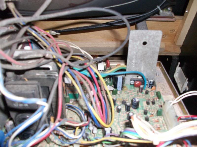

Here are a bunch of pics, including some when I first got it with just the SF2 board and the old power supply that I thought was the issue (oh the young and naive) . .
http://s105.photobucket.com/albums/m207/guywiththegun/Street%20Fighter%202%20CE/
Here are some of the more relevant ones I just took:
The JPac:
Back of monitor:

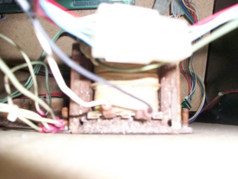

Had this cabinet been in a flood in the past?  I see a lot of rust on that ISO transformer....

My most important question is what did you do with this connector:
It's a fuzzy pic, but looks like a monitor power connection to me, complete with the little Wells Gardner warning tag requiring the use of an isolation transformer.

If you're referring to the cable with the tag attached to it, its plugged into wires that go down into here:

OK, so the monitor is connected to the isolation transformer.
There should be two wires coming "out" (which run to the monitor) and two wires going "in".
If I understand you correctly, the "in" wires were connected to the arcade power supply and are now disconnected.
If that is the case, what you need to understand is that those wires where not connected to the "output" of the PS (the PS puts out +5VDC, +12VDC, -5VDC, but no AC), but rather just tapped off on the input (which is AC coming from the wall and IN to the PS). While you don't need the PS anymore, you still need to provide AC power to anything that was connected to the AC poles on the PS.

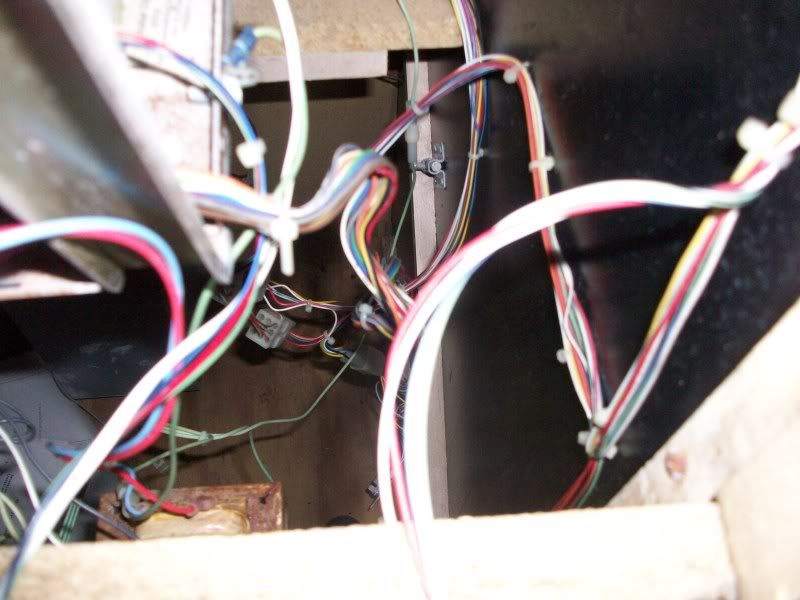

There was a power cord that plugged into the wall and ran into the cabinet. Do you have pictures of where that ran (typically, it would run to a switch on the back or top of the cabinet) ? What did you do with it ?
EDIT: having another look at the pictures, I'll bet that the power cord ran straight into the Peter Chou supply (missed that before -- it does make the wiring look different than a normal arcade PS) and that there is a switch on the PS that was exposed on the back of the cabinet. From there, I bet that there was a molex connector that ran 115V from the PS (a direct passthrough) to both the marquee lighting and the isolation transformer. Can you grab a picture of that connection (assuming that I am correct) ? We'll then figure out the cleanest way to get you 115V AC to those places.

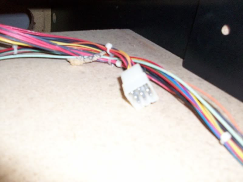

Yeah, the power cord went directly into the power supply, exactly like a computer power supply, with molex connectors coming out of the PS and plugging into other molex connectors. I was actually surprised how much it worked like the inside of a PC. I'll take pics of those connections.

Ok, the power supply connected to this molex connecter (took the pic from the front for a better view):
That would connect to all the wiring that would be fed to the JAMMA harness.
Here's some more pics of the wiring:
