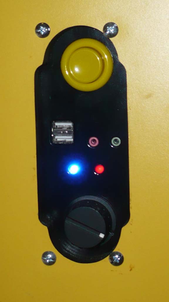

i took daoldman's advice and got another pot the same as the one attached to a board in my cab, and soldered it up, in-line. found a little knob for it too. while i was at it i picked up a splitter and a short headphone extension cable to make a headphone port (so speakers and headphones can be on at the same time... or just turn down the volume pot to make it headphones only).
i put the volume knob where the coin mech door lock was, and the headphone extension (as well as 2 USB extensions that i use for pads for 4 player games sometimes) are all sitting in the P1 coin return (only the second slot has an actual coin mech). as soon as i find a glue that will properly bind these things to my candy cab, i'll put up some shots (it's looking pretty crap right now). i like setting it up this way since when it comes to the control panel and up, there's nothing to distinguish it from a cab in an arcade..... and it keeps me from having to drill anything for a volume knob  ;D
