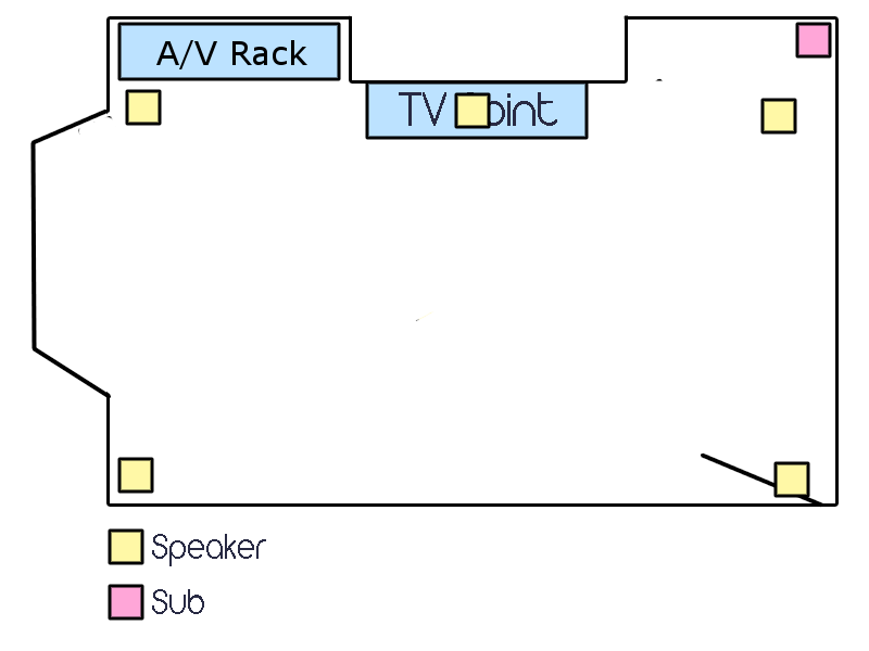

First of all is the living room, which is a part I need advice on.
I am planning on having 5.1 surround sound (Acoustic Energy Neo's) in there. The drawing below outlines where everything will go.
The TV point is the hub of the whole thing. It will house the amp, blu-ray, xbox, server and centre speaker.
I plan on running speaker cable under the floor boards and having wall plates at each speaker/sub point so that speakers can be connected to the wall plates. At the TV point there will be a 5.1 plate that will hook up to the amp.
Now, is it a good idea to use wall plates? I have heard mixed reviews. TBH I want the neatness. Which wall plate is better, banana plug or binding post?
I also plan on getting Virgin media. Ideally I would like to install a wall plate at the TV point for that also. Is this a good idea?
Sky+ was at the house before and as a result the wires are still there. I would like to keep them just in case and plan on using a wall plate for this too.
Ideally I would like to use one wall plate for Virgin, Sky and for the digital aerial. Is this possible? Effectively I want to have one TV point.
Any input would be greatly appreciated.

In relation to the speaker posts, you can use either. Just make sure that they're gold plated. More important is that you use decent speaker wire both in-wall and from posts to speaker. You'd be surprised at how many people use cheap wire in-wall and then buy a couple of meters of expensive cable from socket to speaker, which defeats the purpose.
I'm currently putting all of my cabling in-wall for my own home cinema, including hdmi and power cabling. Pain in the arse but will be well worth the effort.

There is nothing wrong with using wall plates, they make life easier when you can use them. Looking at your diagram though, I do have to say that the speaker placement in relation to the TV, doesn't look all that great. If I had to install a system in that room, I would recommend placing an LCD or plasma above the fireplace, and then using in ceiling speakers so you can place them more appropriately in relation to the position of the TV and the room layout. Of course I say this without an inkling as to what your budget is, or what challenges there are for you in that house for running cable.

I had the same concern. Either you won't be centered on your TV visually, or you won't be centered between your speakers audibly. I believe with a good receiver you can tweak it to adjust for the off-center placement, but I'm not an audiophile...

Actually, if possible I think that this would be a better layout for the room.

Umm, bit hard with a door in the way! ;) (bottom right)
And yes Saint, you can tweak it! ;D
Plus, my GF has bought a mirror for above the fireplace, she would kill me if I told her no. It was hard enough convicing her to OK all the equipment! :dizzy:

If you are able to put the TV into the bay, you will simplify the whole installation and get a better result.
You should also consider moving the sub to the front soundstage.
The neo's are good speakers.
For wall plates, look here http://www.letsautomate.com/index.cfm?&Nav=Walloutlets&

That's what the in ceiling speakers will allow, better placement in that room. I see you are trying to work with the GF with this, and hence your problem. Just remember it's easier to work with GF 1.0 then wife 2.0. As difficult as it might be, try to work with her now. You still might have a chance to turn her to your way of thinking, but if you ever get married I can almost guarantee you won't get any tech bliss as it will almost certainly conflict with her since of decor.

What cable should I use to connect the plates? Coax? And if so where can I buy some from? More importantly, how do I connect the cable to the phono connectors? If I solder, what part do I use?
Also, will I need to use a splitter to connect the wall plate to the sub? If so, what type? (you can see the back of the sub here: ACOUSTIC ENERGY AEGIS NEO 5.1 SPEAKER PACKAGE - available from Superfi UK Visit http://www.superfi.co.uk/index.cfm/page/moreinfo.cfm/product_id/3225 for details)
If you're using a standard sub out on your amp to the sub in on the subwoofer, you can strip a standard phono cable at either end and solder the wires to the back of the corresponding wall plate pins. For high level (not recommended) you should use speaker cable. Any OFC cable should give you a clean signal.
For my own setup I'm stripping a pair of 5 meter phono cables and soldering them to a dual phono wall plate. One phono will be the feed from the amp to the sub and the other will be a coaxial digital back to the amp for my squeezebox.
Oh, and you WON'T need  splitter. For your 5.1 setup the .1 is the amp channel i.e. single channel so you connect 1 phono cable to the "subwoofer line-in" on that sub. When soldering, solder the inner part of the cable to the centre pin on the connector and the outer part of the cable to the ring/sleeve part of the connector.

Cheers for that!  :cheers: I figured it out in the end. You are right about the inner/outer soldering.
One thing I wanted to ask is actually about aerials. I am having an aerial fitted and I have bought wall plates for the aerial points in the house (3 in total). How do i connect the aerial wires (coax again?) to the wall plates? HERE are the wall plates.

Should be the same. Solder the cable core to the tip, then shield/outer to the ring/sleeve.
