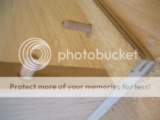

Here are some pics of something i've been working on for .. a little while !!

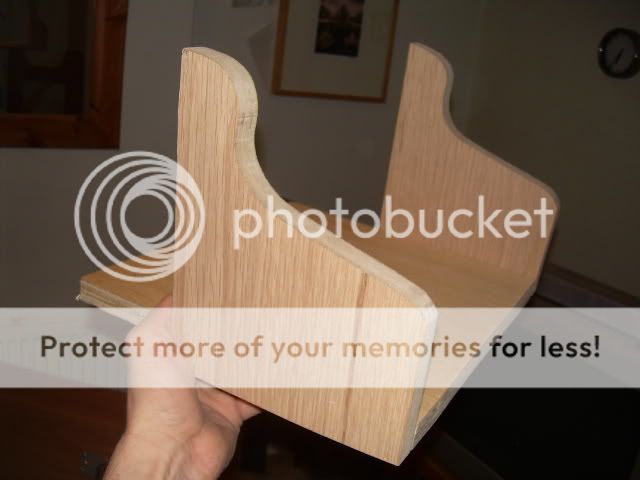

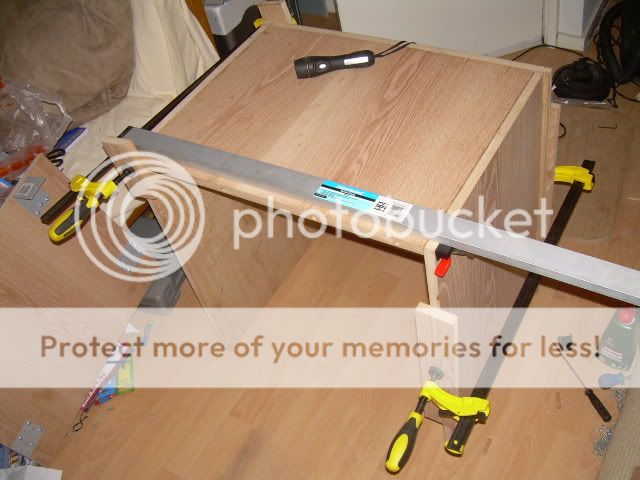

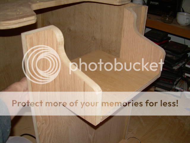

18mm mdf with oak venear doweled, glued and clamped
one of the joints before glueing.
after a bit more measuring and cutting ..

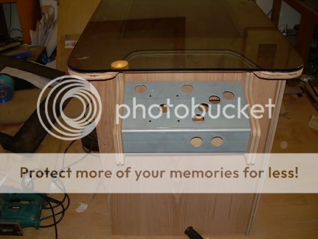

and what it will look like after a bit more doweling,glueing and screwing !

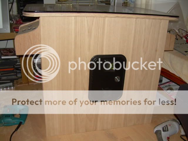

I'm starting to think i may be on my way to a game or two of pacman at this point ! (notice the edges on the top are not very smothly rounded ..this was a piece of plywood that i had cut as the top, later replaced with mdf as this is much easyer to shape with a jigsaw. )
add some spaghetti...
a coin door, for effect ..

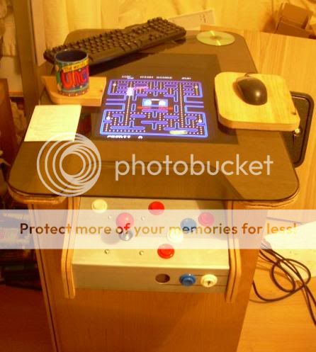

and now for that game of pacman !
..after some, ahem..  "testing"  (notice the control panel is ever so slightly worn now !)

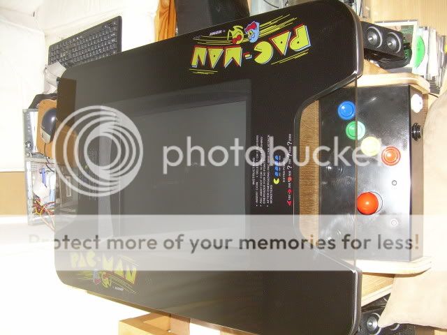

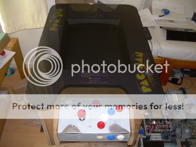

also showing the pacman artwork  print i had done on some "plastic" like paper for the underlay

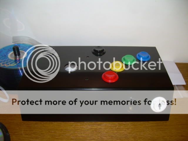

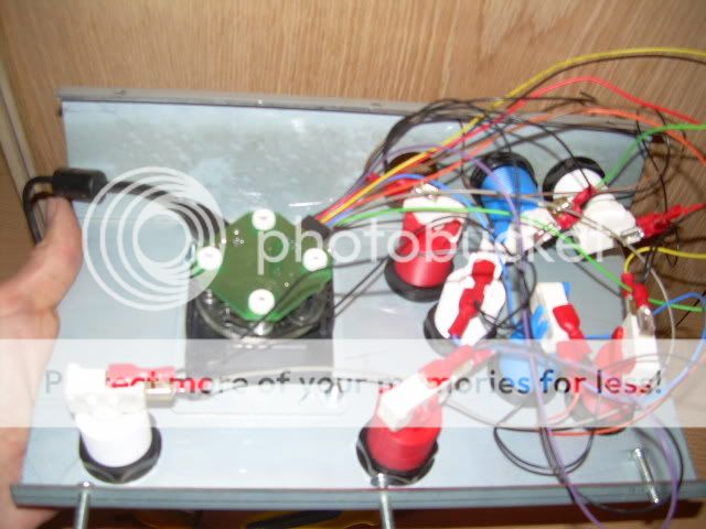

about time for an upgrade for the control panel..  powdercoated black (and have moved that hole along on the front ..this was an oversight on the first panel i had made as the one button on the front conflicted with th first button on the top of the panel ...

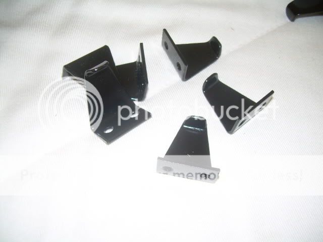

..had some glas clips made and put in the powder coating machine at the same time ! ..did try to buy some but  they were all made for thicker table tops.
Table with printed glass top and powder coated control panel...
The table runs Gameex frontend and has mame32, zinc, daphnee, Model2, mess AAE  project64 and o2em ! (love AAE cant wait for next update with anolog joystick input for playing starwars ! )
 oh  ..and DWjukebox is on there as well . ..going to have to get another/bigger hard drive for all the music that will go on it !
Here is a pic of a friend of mine trying to beat my high score on space invaders ...and failing misserably  ;) notice the look of determination, lol !

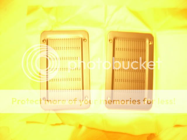

once i have fitted the speakers just below the control panel -to the left and right , they will be covered by a pair of metal midway covers . have set them there so that when you play games like outrun , you get the stereo effect -
you Hear the cars where they should be.    ...to your left and right , as they are on the screen !
Best speakers i have ever heard, for that price ..and better than some way more expensive ones as well. ..i did think about using seperate amp, car speakers ,seperate power supply etc.. but am glad i stuck with these. absolutly astounding sound especially with the Creative Sound Blaster X Fi Xtreme card i added ..well worth the purchase !

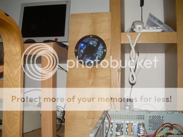

The side opposite the coin door will have an extraction fan about 7 inches down from the top. i brought a fan and then realised that the "ugly side " will have to face out if it is to extract air insted of sucking it in !
tryed taking it apart to change things round ...BAD IDEA

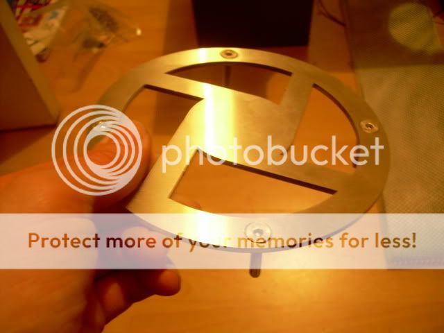

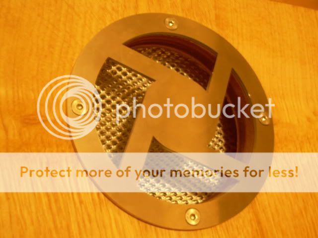

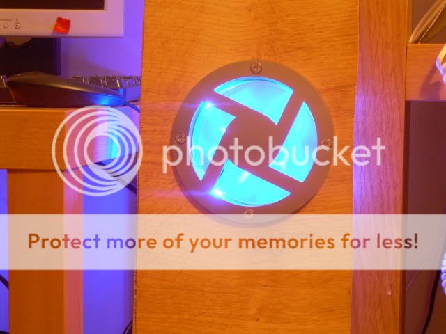

designed a cover for the fan and had it laser cut from 3mm stainless steel
heres what it looks like mounted on a test off cut of wood with a mesh behind it
..with out mesh...
let there be light !!

Real nice.  What kind of monitor are you running in there?  Do you plan on staining it or adding any art to the top? :cheers:

Hi, and Thanks,  i'm  am planning on a clear satin varnish for the finish have thought about a light stain but will have to try a few test samples first.. am uploading some more pics right now ..you will see i tried a under lay for the top but wasn't satisfied with it so i had a specialist printers print the artwork directly to the underside of the glass ...expensive but totaly worth it. ..see pics  in a mo.

ps the monitor is a 19" dell/sony  trinitron "flat" crt  it sits on a shelf under which will live the pc and sub.

Where did you get the laser cutting done?

I love the use of the veneered timber in this project and dowel joints too!  All up a great finish.

 - the laser cutting was done at a sheet metal works near where i lived in leyland, lancashire (England) . it was expensive to get  done as you have to pay for guy to set up the design, but what the hell, i think its finishing touches like this that make all the difference. ..after all the effort i put in,  setting up the emulators and frontend , it deserves a nice box !

The button layout looks a bit awkward.  Is it comfortable at that angle?
richyrich888
  • Posts: 21
  • Last login:May 10, 2013, 12:14:19 pm
Re: pacman cocktail ..nearly finished !!
« Reply #10 on: June 20, 2009, 01:00:32 pm »
Very nice build.
Thanks, found this layout allowing for 4 main play buttons + room on the panel to rest the base of your hand, to be the most effective and comfortable ..neogeo style .
Had considered a 6 button layout - the panel does allow room for this, but then you would have no where to rest your palm and given the number of games using 6 buttons this seemed to be a better option.
As for the slope , perfect ! ..but these things are 100 % personal preferance.
