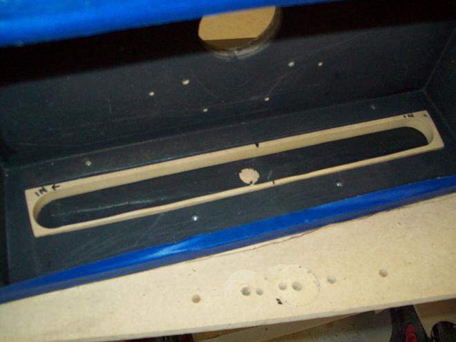

Ok, I got the L brackets laid out for the speaker bar.
I placed the speaker bar where it should reside and laid the L brackets where I think they should go.
I then marked the holes on the wood. Then I flipped the box over, and using a tape measure, duplicated the marks on the other side.
I then drilled the holes from the front side. I countersunk the 8/32" T-nuts so they would be below the surface of the wood. The L brackets will fasten with a screw into the T-nut.
I placed a small piece of aluminum tape over each T-nut, to keep the laminate glue out of the screw holes.

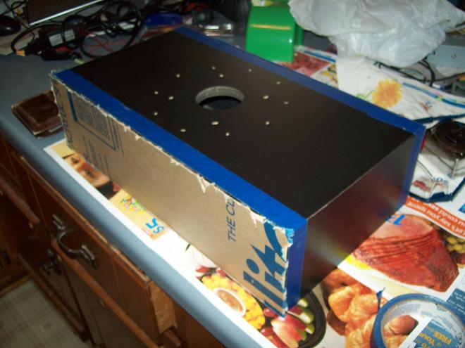

Ive only got a couple of hours until work today, so I am going to try to spray paint the inside of the speaker box. I think I will wait about the routering until tonight. (Sorry neighbors, but hey it's for a good cause.)

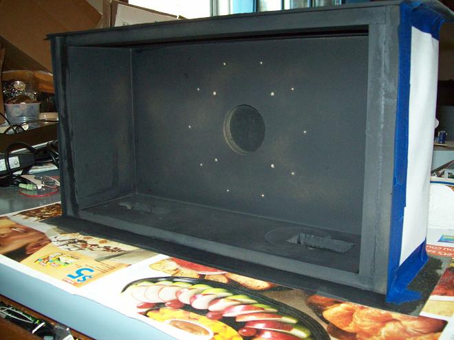

But first, a pic from yesterday showing the paint on the inside of the speaker box:

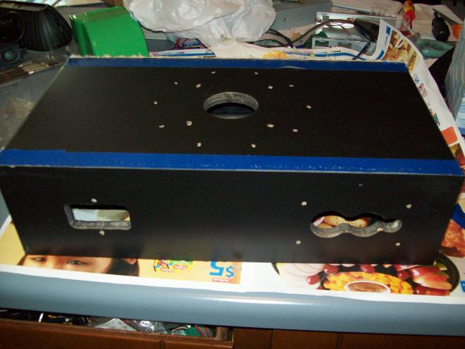

And here is the laminate trimmed and holes cut in the top:
Here is the back, holes cut. Hmmm, does that cutout on the right kinda look like a snowman?
May be a sign of things to come??

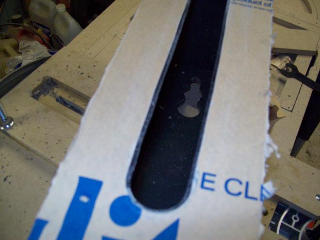

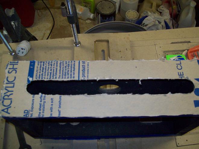

I turned my circle cutter upside down and used it like a router table.
I cut a hole in the center to allow the laminate cutter bit to stick through.
I then inserted my router guide:
Here is the bit, ready to cut:
I then just ran the bit's bearing around the router guide. I had to hold the guide in with my fingers while cutting, so I had to be extra careful.
Here is the result:
I then swapped out the laminate trim bit with the 45 degree chamfer bit and repeated the process:
It looks pretty rough. I dressed it up quite a bit with some 100 grit sandpaper. Ive got to go back and review how everyone else is polishing the edge.

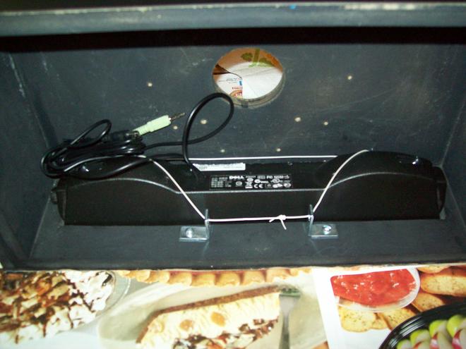

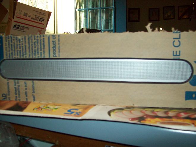

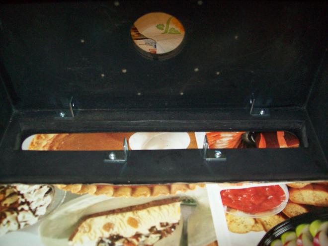

Next I installed the speaker bar L brackets:
Then I inserted the speaker bar and ran a wire around it and the L brackets. I need to pick up a proper sized spring, but this is just a test fitting.
And here is the truth or dare shot:
I am very tempted to remove the paper backing on the acrylic, but no, not now.

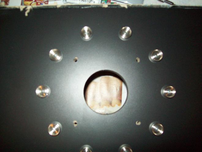

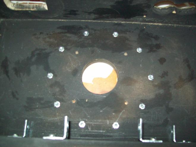

Ok, I then removed the speaker bar and inserted the 4-40 T-nuts for the magnet cups:
And here is the magnet cups installed:
I hit a bit of a snag with the magnet cups.
I ordered 4-40 flush allen bolts for the magnet cups.
This is about the only size bolt that will fit in the cup's hole. Also it has to be flush to fit low enough to clear the magnet, so the magnet doesnt "ride up".
The bolts I ordered was 1/2" long, which I figured would be long enough, since the T-nuts go into the wood a bit.
But I was wrong. The bolts wont reach the T-nut.
So, I got to see if my local hardware store has any 4-40 bolts 3/4" long.
Im using regular bolts in the picture, to get a feel for how the magnets and the plates are going to clear.
I had to counter-sink the cups a bit. I cut out the laminate on each hole with a forstner bit. Im hoping the thickness of the laminate will be enough to allow the cups and the plates to clear.

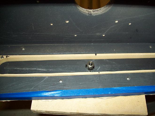

I temporarily installed the power entry module and the admin plate.
I took a picture, and then I noticed in the picture that I have scratched the laminate on the back.
It was probably when I had the back on the table, probably some shavings or drill chips got between it and the table. (Man I wish I had masked it all off with tape.)
Anyway, see the scratches under the admin plate?
There are more scratches around the upper edge.
Can someone please tell me how or if I even can, remove these scratches?

removing scratches. First thing I thought of was (boot) polish as they're on the back, then that car wax stuff with colour in it.
I googled it too and someone mentinos car wax for removing scratches from matt black laminate... Someone else mentioned toothpaste, but not the gel kind.
Cheers

Thanks drawful! I will try the toothpaste first since it is readily available.

Drawful, I tried the toothpaste, it didnt work. The scratches are not that noticeable, of course under a different light they may be.
They are really more like marks than scratches. I didnt notice them until I took that picture.
And they are on the back (Thank God), so I'm not going to let this slow me down.
But I may try some of your other suggestions before I get to the end.
I am considering it a lesson learned. Im taking the extra few minutes to mask off everything from now on.

I removed all the parts. (It dont take long at all). I now placed teh first skin in a test position.
Notice my high tech weights?
I had an idea about stretching the skin tight.
I stapled two blocks on each edge of the skin, one was to act as a catch to hold it against one side:
And the other end I installed some bolts that I could tighten against the bottom to stretch the skin nice and smooth.
I did a test run without any glue and it worked great.
But when I put the glue on and placed the skin back on, something didnt do right.
I dont know if I moved the skin a little (it slides easy on the wet wood glue), but I got a little pucker on one corner.
So I tightened the bolts to try to straighten it out.
I must have went too tight, cause the staples pulled out.
I was working like a mad man then.
I managed to get it all smoothed out with some C clamps and I put some serious weight on top. (An old computer and a monitor).
I just got home from work and removed the C Clamps and the weight.
It looks like it will be OK.

Applied the second layer of skin last night before work.
This morning I trimmed it up and here is the "size compare to a can of beverage" pic..
I used the same skin stretching method as before. Except this time I used screws in the blocks instead of staples. It worked out pretty good. I would have used the spring clamps like everyone else but I only have a couple. The old 10 ton computer and monitor came in handy again.
You know, I think one layer of skin would have been strong enough for this project, but I sized the speaker box for the two layers so i went ahead and put on the second one.

Here is the bottom laminate, trimmed and holes drilled:
side laminate applied:
back laminate laid out for fitting (not glued on yet):
Back laminate from inside. I inserted a brown paper sack piece to keep the gap for my perf metal in the air hole from closing shut:
Here is a shot of the air hole, with perf metal inserted for test view:
Here is DVD test fitted:
Here is the front acrylic applied.
Im jumping a few steps here cause I forget to take pics.
All holes are cut.
When I cut the 45 degree chamfer, something happened in that corner. I dont know if the bit pushed my cutting guide up or what, but I noticed that the corner was rounded out by the bit.
I was ready to cry.
I have since sanded it out a bit, I'm hoping it wont look too bad.
Here is a shot with the monitor test fitted. You can see in this pic that the right corner rounded a bit too. But it's not near as bad as the left corner. I think if I use a router guide system again, I will fasten it down before routing:
Here is a shot of the marquee area after polishing with the novus 3 step system.
Man this stuff does wonders. I may polish it again though, because I can still see some very tiny scratches.
In the last picture you can see where I tried spraying some Rustoleum Metallic Paint in the marquee area. I thought this would reflect the light from the led bar better.
It turned out more gray than shiny like the top on the can. I also spray painted the rest of the inside black before I cut out the front acrylic, but since it was spraying in a hole, most of the paint didnt stick, so it turned out very splotchy to say the least.
Well thats it for now.
Next I got to finish the acrylic polishing, cut the T-molding slot, and cut the rabbet cut on the back.
Then I got to construct the back panel.

« Reply #77 on: December 19, 2008, 12:04:07 pm »
Good progress. Have you noticed in the original Mountain's juke the cutout for the speakers and rear panel are black at the edge. I don't think this is laminated MDF, looks like a different material was used. Are you planning to paint the edge black, right now you could see MDF behind  the laminate. Do you know what I am referring to, or should I post a pic? This is one of the steps that I keep wondering about, not sure how this is done. Can't be just the laminate, don't think it is thick enough.
  • Posts: 5179
Re: Oops! There goes another Mountain Juke Box! (*12/19/08*) Laminate applied
« Reply #78 on: December 19, 2008, 06:08:52 pm »
Are you talking about the air hole? (sixth picture up from here.)
I hadnt noticed that you can see the MDF behind the grill, thanks for pointing that out.
I think I will paint the mdf around the hole black. That should fix it.
reko19
  • Posts: 218
  • Last login:July 16, 2025, 10:06:10 am
« Reply #79 on: December 19, 2008, 09:00:17 pm »
Yes, this is the one.  I was trying to figure out how it is done, don't mean to critique or anything. Hope it didn't come across this way. If you look at Mountain's pics, it almost looks like a different material was used all together for the speaker opening and rear panel.
