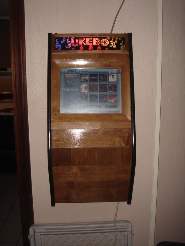

Well the jukebox was finished a while ago and I never posted any pics......here is a pic and a video...decided to go with album player........have a 7.1 sound card with an optical output going into my reciever....very happy with the way it turned out......thanks for all the help and suggestions.....
