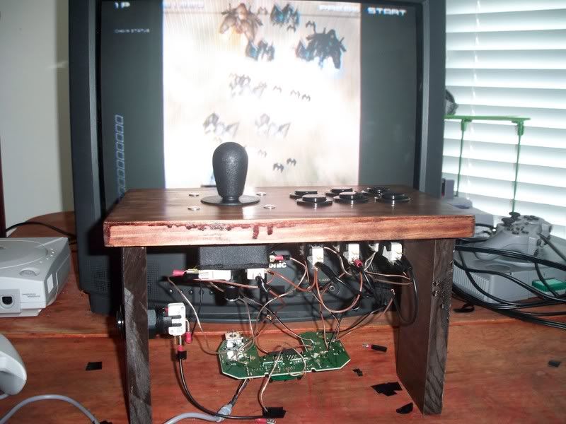

I am making arcade controls for the Dreamcast and have ran into a little hiccup. It seems that when I push the A button, it registers as multiple buttons at the same time including the joystick. I have fiddled around with the wires, but then different buttons are pushed. I still can't tell if it is the solely wiring or the Dreamcast controller (a Mad Catz Dream Pad).
If it could possibly be the wiring, what can be done about it?

You've probably created shorts somewhere, most likely on the controller pcb itself.

That's wiring. Can you post pics of your wiring?

The mess is kinda embarrassing, but I ran out of wire. I'm just hoping it isn't the controller.

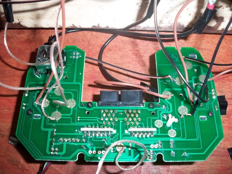

Hmm... your wiring appears to be ok... hard to tell.
However, your soldering on your controller PCB looks a bit messy, excess solder, and bare wires that could possible short circuit your buttons.  Do you get random button presses even if you don't do anything?
Can you get me a close pic of the a,b,x,y button area?

No random button presses, just that cheeky A button.
Excess solder is an understatement, by the way.

I'd make sure you don't have a splat of solder bridging a connection somewhere.

From the way that picture looks, I bet when you close the top of your controller the bare portion of your ground wire touches the bare portion of the A wire...  you may be getting more interactions elsewhere when the wires shift as the lid is closed.
Like Ginsu said, make sure you don't have any solder globs bridging contacts elsewhere.

Hmm, I did put electrical tape over it once but it was still registering different buttons... I'll have to take another detailed look, I guess.
Update: I messed around with the wiring a little more and got it to work... under one condition.
This calls for even more electrical tape than before.
Thank god it isn't the controller, eh?

I made a discovery last night. If I put in a normal controller before plugging in my arcade controls then everything works fine. However, if I turn the console on with the arcade controls plugged in, problems arise.
That's messed up.

Hmm... yeah, sounds like you have a short somewhere on your pcb.  Be careful with that...  shorts tend to cause the controller resistor in the DC to burn up (requiring replacement).  If all your controller ports end up dead one day, this is what happened.

I was going to say a very close visual inspection.  Use a bright light and a magnifying glass.  Clean up any shorts caused by excess solder, etc...
