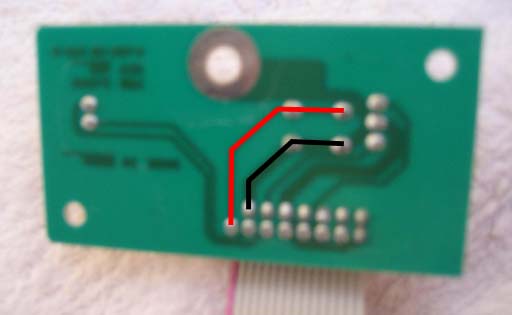

OK, this is how my board looks like. I know, the quality is poor, my camera is rubbish!
So you just wired it up to the microswitch on the pushbutton as normal. That I can do!
My only concern is just soldering the wires to the correct part of the PCB. Anyone reckon they could figure out where this is?
I reckon the power is the one circled in red below and the ground is the one circled in green.
   o o o o o o o
o o o o o o o o
This is my diagram (kinda) of the solder bits at the bottom of the PCB, the one where the ribbon cable connects to.

In an earlier message I did suggest soldering directly to the legs of the tiny pushbutton.  That would still be the most straightforward thing.
Not sure what else you need that hasn't been covered.

The only problem is what part of the legs? 2 wires (ground and the other one), 4 legs!
Excuse me if I sound like an idiot, my wiring is only as good as fitting plugs!
You do realize the little traces on the circuit board carry electricity, right?  :D
When the pushbutton on the PCB is pressed it makes a connection between those two traces.  You just need to connect your button so it does likewise.

Right, I see what you mean. So I just split the wire to connect to the two legs i.e. 2 wires split = 4 wires to connect to the legs.
Or just strip the wire to run and connect to both legs.
Am I right?

You're making it more complicated than it needs to be.  Just connect your wire A to one of the spots marked in red -- any of them, doesn't matter which one.  Then connect your wire B to one of the spots marked in black.  Then you're done.

Okey dokey! Thanks for the help! Much appreciated! :cheers:
