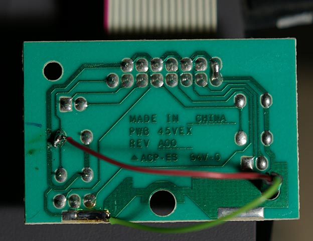

I have a Dell GX270 Small Frame Factor desktop.
I have opened her up to wire (splice) the power on button to a push button for my arcade machine to power the computer on.
Low and behold, the power on button on the desktop is wired using a ribbon cable to this mini control panel (which has front usb and sound on it) which is then fed into the motherboard using another ribbon cable. :banghead:
Does anybody have any suggestions how I can wire this thing up so that I can power it on with one button start?
The computer will be plugged into a smart strip which will kick start the monitor and marquee light.
Thanks.

Another option is to go into the bios and set it to Power On after power loss (if this is an option in the bios)
Then just use a switch or regular power strip to turn everything off and on.  When you turn on the power, your pc automatically boots.
This is the way I have mine.
Otherwise just cut and splice the appropriate wires for your power button.
I have a full-sized Dell with a similar design.  I checked eBay and found somebody was selling replacement power switches for it.  Basically the switch is on a tiny PCB, then there's a ribbon cable leading to the other small PCB that you referred to.  So. . .  I haven't hooked it up yet, but it should be easy to unplug the original ribbon and plug in the new one, and get access to the power signal through that.
I don't know if those power switches are still available, but it wouldn't hurt to do a search.

Just tap into the power on circuit where the wire ribbon goes to the actual switch.   Thus you know you have the right contacts and don't have to figure out the ribbon conductors and mini boards.   Shorting the 2 wires will cause the computer to turn on.
If his system is like my Dell, he has no way of knowing (except trial and error, I guess?) which wires carry the power-switch signal.  The actual switch on mine is buried deep in the front panel of the computer, and I couldn't find any way to dig it out without completely disassembling the computer and possibly inflicting major damage, so there's no way to trace the wires.
Since I got the replacement switch, now I can trace the wires and see which one does what.

Does anyone know if the Dell GX270 supports this Power On after power loss feature as I can't seem to find it?

Yes it does.  Look under Power Management, there should be AC Power Recovery Options...set to On — The computer starts when AC power is restored.

I finally got around to wiring mine up yesterday.  So here are some fresh observations. . .
The ribbon cable has a standard header at each end.  So, there are several ways you can skin this cat.  You could cut up the ribbon, I suppose.  My approach was to leave the ribbon cable intact, leave the header attached to the PCB, and solder a couple of leads to the PCB itself.  It had a couple of solder pads that are grounded, so attaching the ground lead to one of those was easy.  I soldered the signal lead to one of the legs of the switch.  This was tricky, because it's a very small spot.  I really wished for a third hand and more light.  Anyhow I got it done, even if looks a bit ugly.
I used a length of old phone cable (two wires) and threaded it through a hole in the PCB, so if it accidentally gets yanked then the insulated part of the cable will take the stress, it won't pull the leads loose from the PCB.  I still need to make a little cardboard box or something to surround the PCB and keep it from shorting against anything inside the PC case.
The original switch PCB and ribbon in the PC are left alone.  I just unplugged the old ribbon and plugged in the new one.  If the PC is ever used for anything else, it'll be easy to return it to normal operation.
It's working as intended.  I also have the Smart Strip working in the cabinet, though it took me a few tries to get the sensitivity adjusted right.

Zobeid
  • Posts: 238
Re: Power On issue - One button Start
« Reply #36 on: May 08, 2008, 07:57:24 pm »
My ugly gob of solder shames me. . .   I'm pretty rusty with a soldering iron.  But it does work:
You can see the main trace that runs all around the PCB is the ground.

Zobeid
  • Posts: 238
« Reply #38 on: May 09, 2008, 07:16:44 am »
How is it connected to your push button?  What parts did you actually apply solder to on the board?
The red and green wires, they lead to my pushbutton. . .   Short them together and it starts up -- or shuts down, as the case may be.  The green wire is soldered to the ground trace and the red is soldered to a leg of the tiny pushbutton.
Really, if you aren't sure then just look at the tiny pushbutton on the PCB.  You can solder both wires to its legs.  All you're doing is replacing its function with your own button.

OK, this is how my board looks like. I know, the quality is poor, my camera is rubbish!
So you just wired it up to the microswitch on the pushbutton as normal. That I can do!
My only concern is just soldering the wires to the correct part of the PCB. Anyone reckon they could figure out where this is?
I reckon the power is the one circled in red below and the ground is the one circled in green.

Zobeid
  • Posts: 238
« Reply #43 on: May 13, 2008, 01:24:27 pm »
Any takers?
You know I will get a reply when I say "well I did it, and it went wrong" lol.
In an earlier message I did suggest soldering directly to the legs of the tiny pushbutton.  That would still be the most straightforward thing.
Not sure what else you need that hasn't been covered.

Zobeid
  • Posts: 238
« Reply #45 on: May 14, 2008, 08:34:50 am »
The only problem is what part of the legs? 2 wires (ground and the other one), 4 legs!
You do realize the little traces on the circuit board carry electricity, right?  :D
When the pushbutton on the PCB is pressed it makes a connection between those two traces.  You just need to connect your button so it does likewise.

Zobeid
  • Posts: 238
« Reply #47 on: May 14, 2008, 10:16:30 am »
You're making it more complicated than it needs to be.  Just connect your wire A to one of the spots marked in red -- any of them, doesn't matter which one.  Then connect your wire B to one of the spots marked in black.  Then you're done.
