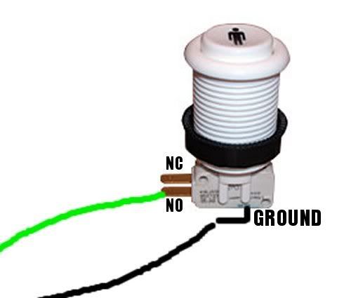

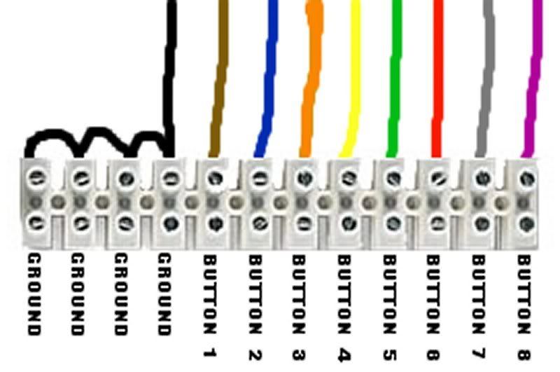

Stripping the wires and crimping on connectors is easy. I'll help you with whatever you need. (And I apologize in advance if it's the evening and I don't respond until the next day)
I ran all of my wires into a 12-Position European-Style Terminal Strip from Radio Shack. (I only use one controller's button hookups, so you'll need two if you go this way.)
This makes things easier (to me, at least)
I also recommend the stiffer springs and circular restrictors. If you're in the US, I can tell you that my order of 2 U360s, 1 encoder wire (you'll need two), 2 springs, and 2 restrictor sets ran me $177.00
Your total will be slightly more with the extra wires. You won't need the ground harness, because I'll show you how to wire up your own for less (it's easy).

Cool. I'm posting here instead of PMs as I feel this information may be useful to people other than me too.  The way I understand, encoder wire to button... joystick to USB, then no ground wire?  Will that work?  What is the terminal strip used for?
Thanks for the advice!  I am ordering all the pieces you suggested.  Now that your suggestion was made, it is starting to make sense.

There's a ground wire. That was the point of the ground wiring harness I mentioned earlier. (Which, as I said, won't be needed)
What I do is run my button wires to each terminal, then I loop the ground to the rest. I then run two grounds from each of the ground terminals, giving eight grounds for the eight buttons.
                                                  THESE WIRES ARE COMING FROM THE U360
Then you wire each button as follows:
I suggest looking up a simple guide on stripping and crimping wires. If you don't find anything, I'll help you with that as well.

ok I just bought all the stuff you recommended.  Now I'm a little confused.  So say the green wire from the wiring harness that plugs into the U360, does that go straight to the 12-Position European-Style Terminal Strip from Radio Shack if so, then what goes to the button?
Is the terminal strip like an extension chord for wires?
thanks!
thanks!
-Nick
Yep, it makes adding longer wires easier, plus you don't have to worry about pulling the original wires that are hooked into the U360 a bunch of different directions. It'll last longer.
So, U360 wiring harness ----> strip ----> buttons.

Actually, you can run two grounds from each connection, giving you ground for all eight.
And, yes, the ground comes from the button/encoder harness via the U360.
