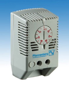

« Reply #8 on: April 07, 2008, 08:54:20 am »
Found a pic of the thermostat.

« Reply #9 on: April 08, 2008, 07:17:46 am »
Let's say the room temp is 20'c, i have the dial set at 60'c (max). At this point the fan is off, when I then turn the dial down, at about 10'c the fan starts. If I turn it back up again it will shut off. So obviously the dial reading 0'c to 60'c is not referring to the room temp?
Thats ok. For simplicity's sake, lets say the temp settings on the thermostat dial are between 1 and 10.
On a cooling system, lets say you want the temp to be 5, so you set the thermostat on 5.
If you turn the thermostat down to 2, then you are saying you want the temp now to be 2, so the fan comes on.
When the temp gets down to 2, the fan will cut off.
Now lets say the thermostat is placed on 5 again, and the temp is 6, so the fan is running because the temp is above the setting.
If you turn the thermostat up to 7, the thermostat now wants a temp of 7, so it turns the fan off.
The fan will stay off until the temp reaches 7. Above 7 the fan will come on again.
So you are correct about the dial reading. it is not referring to the actual temp, but what you want the temp to be.
You need a thermometer to tell you the actual temp. Also, the fan will turn on and off at around the setting, it will be a little above the set mark and a little below the set mark. This is where the hysteresis comes in, but I wouldnt worry about that.

Thanks DaOldMan, I got it! Well almost  ;D
Tried the hair dryer (laymans) method tonight, hairdryer blowing on it, it came on, 5 mins later it turned off. There is just one thing stopping me using this now, when it turns off my speakers make a grumbling noise for about 1 sec, like an interference. Unless there is a logical explanation for this then I am not sure I can trust it (as I don't know where it came from!).

Any thoughts on the speaker issue? Is this just some static thing or is the thermo shutting off not shutting off instantly, so there is some residual power while it is shutting off if you see what i mean?
To answer your question, the noise is most likely the electrical noise created when the thermostats switch opens. The arc sends out radio waves too, which could be why the speaker amps are picking it up.
You can try to move the thermostat to a different position. You can also try powering the fan from a different power outlet. Or you may have to install a capacitor/resistor across the thermostat to quench the noise.
