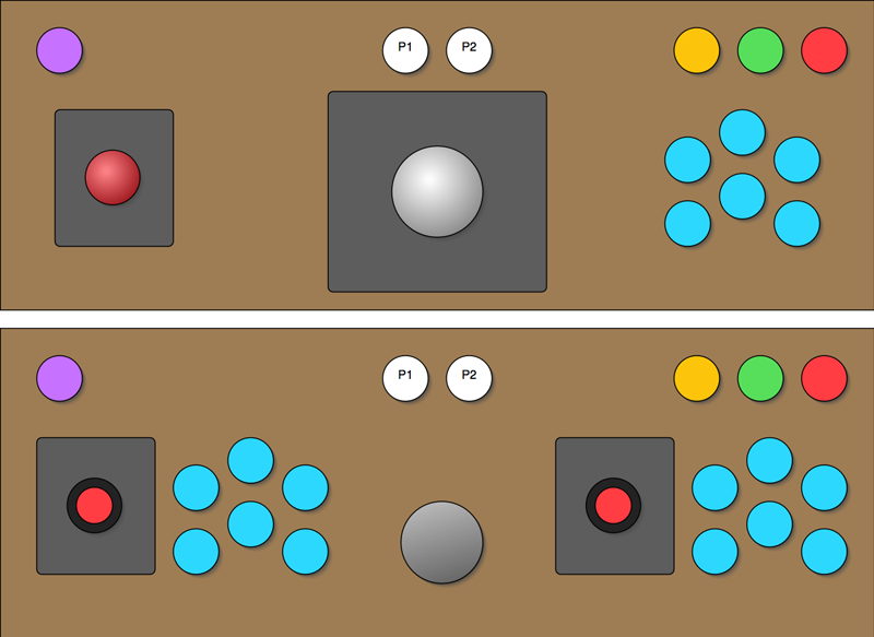

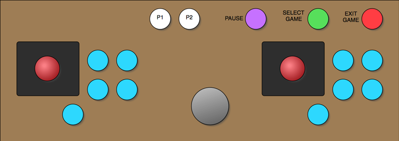

After thinking it over for a while, I've managed to make a few actual decisions. . .
I'm definite that I want the LCD monitor.  Hopefully I can get one with good black levels and a fast response time. . .   I have enough experience playing games on a LCD that I'm sure it's not going to bother me.
After waffling a lot on over joysticks, I've decided on the U360.  With all the praise heaped on it, who am I to buck the trend?  Should be great for Q*Bert and Sinistar.  I imagine probably not so great for Star Wars, but at least it should be possible to play it.
Control panel layout. . .   After much experimenting, here's my latest iteration:
No trackball.  I weighed the value of a trackball to me and decided I could live without it.  A spinner, on the other hand, is a necessity.
Cabinet styling. . . .   I'm thinking woodgrain here.  There were a few classic arcade games with wood grain cabinets: Zaxxon, Frogger, Phoenix.  I always thought they looked good.  Example:
Something I'm still figuring out. . . .  Quarters, tokens or NovaGem pushbuttons?
My head tells me the NovaGem would save money, save weight, and be less hassle all around.  My heart says a working coin door would be so much cooler.
Re: Howdy! Planning 1st cabinet. . .
« Reply #7 on: February 09, 2008, 06:23:06 pm »

Not trying to change your mind on the trackball, but don't forget they have another purpose, they can also act as a mouse within windows, which removes the need to have a mouse tucked in somewhere.  Pretty cool to be able to do light admin stuff using the control panel.

You can use the U360 as a mouse.  The driver has a mouse-mode you can download to the joystick.  I've played with it a little and it works quite well.
If you are going to have any friends over to play on your cab you might want to consider a trackball.  There is a  real WOW factor to be able to play Centipede, Marble Madness or Golden Tee with a trackball!

I'll admit that not being able to play Missile Command, Marble Madness or Centipede/Millipede is a negative.  But still. . .   Those are three-and-a-half games out of hundreds.  You have to draw the line somewhere, or else build a CP that looks like an aircraft carrier.

Against my better judgment. . .  I'm starting to get ambitious ideas.  I'm wondering if a swappable panel makes sense for me.  Something like. . .
Panel 1 = U360 & a trackball
Panel 2 = 8-way firetop sticks & a spinner
Panel 1 would cover all my trackball games, analog stick games, 4-way stick games (including Q*Bert).
Panel 2 would cover dual-stick games, tank games, spinner games, Tron, Frontline. . .
BUT the whole idea of a swappable panel sort of works against the simplicity I was striving for when I started my planning.
Instead of swappable panels, why not have a fold up piece that has the trackball(s) on it. Someone here made one a few years ago, looked like a simple idea, and looked clean.

I'm thinking when you set a game up and configure it, most of the time you'd typically duplicate the functions across the control panel.
I had thought about doing just that, then realised that it wasnt a very graceful way to set the controls up. Plus it wouldnt work for the neogeo games on my 7 button layout (nor would it make much sense)

I was thinking the same thing about the TurboTwist spinner, it looks good.  I don't know if you saw this thread yet, I'm sure I'll want one of these. . .   http://forum.arcadecontrols.com/index.php?topic=76931.0
Heheh, yeah I did see that thread. Looks quite slick. I'll have to see the final designs to see if I want them, but it definately looks promising :)
