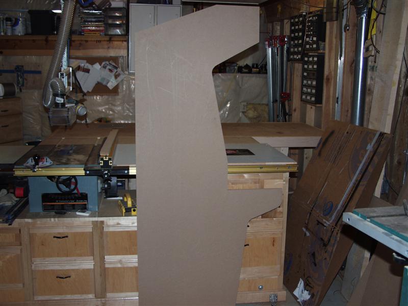

Finalized my dimensions and cut the cabinet sides :

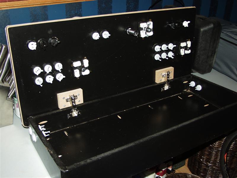

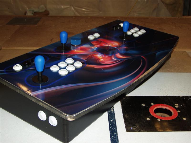

Got the control panel and plexi overlay done. Hinged the top for access, painted, and installed the controls. I printed a temporary graphic on multiple sheets to use for now. Once I get my trackball (see that lonely circle in the center?), I will get the final print and drop it on. My wife and I picked some cool 3-d abstract art we found on the web. I also ordered some chrome T-mold which will finish the cabinet and control panel nicely.

Spent lots of time this weekend working on the cabinet, and it's nearly complete. Everything is painted, trimmed, and installed. The computer is in, speakers and monitor are mounted and hooked up, door and keyboard drawer finished, and control panel is fastened down.
Last night I wired up the player 1 side of the control panel, fired it up and the KeyWiz worked great. Didn't have to re-map anything. Played a couple games and everything works!
Next up is to build some sort of marquee retainer and wire the other half of the panel. Then it's on to the fun stuff, Lighting up all those Electric Ice buttons and configuring MaLa.
These pics are a bit on the dark side, but here's what it looks like after this weekend:

First the control panel.  Found this image at deviantArt.com. I like the red/blue split, which looks good with the buttons lit to match.
