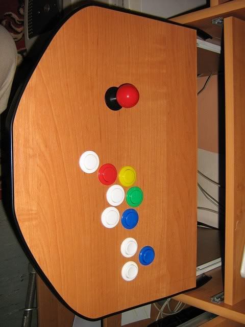

I think it's all down to personal preference and what type of games you enjoy most. I spent a while trying to get the button layout as best I could for myself. Purely for comfort and flexibility across as many games as possible.
Please forgive the crappyness of the pics.  :P  This is just a quick mockup I made in 15mm shelf board. Button one is a bit skewed to the right, but the idea of what I was aiming for should be clear.
In this pic I can easily rest my fingers on butoons 1, 2 and 3. My thumb falls perfectly on button 7 and can flick quickly to button 4 and 5. Only button 6 needs much more movement to be pressed. I was thinking that Defender could be played like this with the thumb being used for reverse on button 7. Not too sure I could get used to using my left thumb while moving up/down on the joystick. I will try but this configuration does allow me a getout.
And in this mode it replicates the 4-button Neo-Geo layout in as much comfortable position  as is possible for me.
I did actually consider 8 buttons on the panel just to cover non Mame games that would use a Playstation gamepad such as PES series. But I figured those games would be best with a joypad anyway and have decided to stick with 7 buttons.

« Reply #35 on: January 11, 2008, 04:16:24 pm »
Here was my first panel I built around 6 or 7 years ago with the SF2 layout + NeoGeo layout.
I never did like that pesky 7th button  :(  ... but that's just preference  ;D. Plus it's the Happ Ultimate Joystick and Ultimate buttons which have the accuracy and responsiveness of something between the likes of clay and peanut butter. I'm much happier with the Happ Competition buttons and stick that I have on the SF2 panel.
« Last Edit: January 11, 2008, 04:21:19 pm by Namco »
