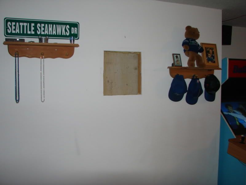

Zeosstud
  • Posts: 594
  • Last login:February 24, 2026, 05:32:44 pm
Hey Quarterback,
                               Whats wrong with having a screen mounted in the wall, sure you may never use it, but when your friends come over they might think its cool.  At least thats what I am banking on.
You gotta admit having a screen in the wall is alot cooler than just having a hole in the wall.
Zeosstud
quarterback
  • Posts: 3089
LOL  Yeah, unfortunately at the rate I move on any of these projects, there'd be a hole in my wall for a lonnnnngngggggg time.
I'd entertained the idea of picking up 5 or 6 of these screens and doing up the whole house, but then reality set in and I think it would cost me my sanity if not more than that.
Looking forward to seeing you fill that hole, Zeosstud! :)
