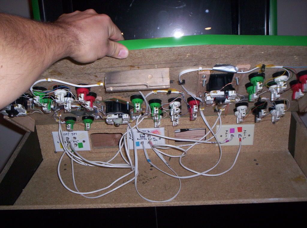

Akuma,
I was actually trying to let the bolts show on the CP. I don't think I quite got the look I was going for with them, but there was a method to the madness.
How it was supposed to work:  I can remove just 4 bolts and the top and sides of the CP slide right off. The CP uses  6 wire plugs to plug into front wall of the cabinet which then leads back to the KeyWiz.  My thoughts were I could swap CP's out with out too much trouble.  Sort of plug and play. Of course I have not built any another CP's yet :-)
It turned out that the CP top fit snuggly enough on that I could attach it to the rest of the Cp with just one hidden screw, so it the end, I probably would have just used formica right over where those bolts are now.
Oh, the pic of my kid sanding, mostly just for show, but it made him fell good  :D

« Reply #5 on: December 27, 2007, 10:07:26 am »
I see, I see. I am not quite finished with my project yet, but I am going for something similar (detachable CP). My experience is that I didn't have to use any fixation like screws - the CP rests perfectly on the CP housing. Anyway: It's you (and your kids) who have to like the outcome, not people like me as we all build our cabs for ourselves : ) :cheers: So if you like the bolts, all is fine : ) Oh, and your plugs look very user friendly, unlike mine :-\
