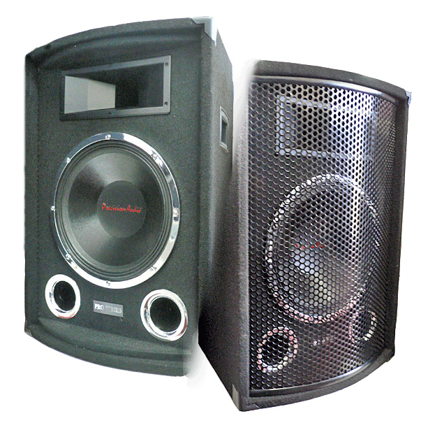

If you want awesome sound spend the time and do your homework and it will pay off.  Speakers built into the cabinet with the bass cab calculated for size and ported for the best lower volume bass is what I did. www.partsexpress.com is one of the best places to purchase speakers and they have a forum where those huys will help you calculate box size and port size for your bass speakers. Use good midrange and tweeters from them also with 3 way crossovers. Use a commercial amp and you want believe the sound quality.
my page [/url]www.freewebs.com/artdecojukebox[/url]

2 way speakers are usually to shallow for midrange.
