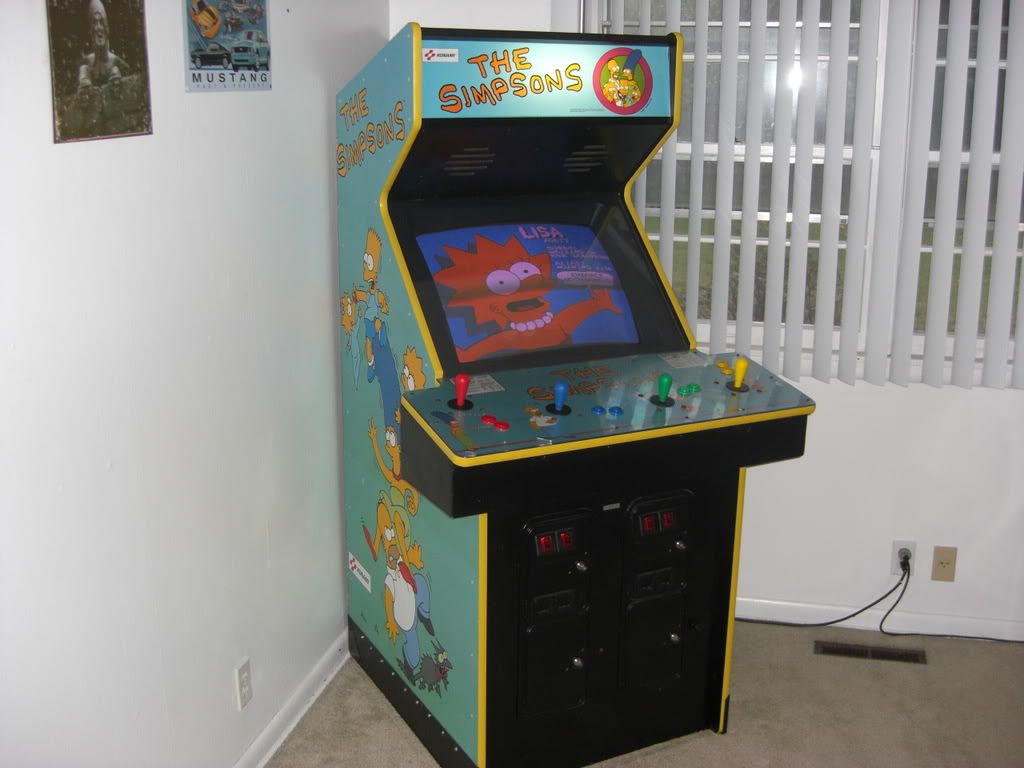

I should have documented this earlier while it was in it's earlier stage.  Oh well...
Here's a final pic of the completed cab:
Here's a video:
This was previously a cabinet that I bought for $25 which had the Wizard of Wor marquee on it.  I cleaned it up and sold the marquee on e-bay for $10, so I actually paid $15 for the cab!
I have painted the cab, but it got a little scratched up when placing the 27" monitor in it.  (I put it in last night).  I will have to touch it up, no biggie.  The cabinet was meant for a 25" monitor, but I removed the brackets and built a shelf to hold the arcade monitor's board and power supply.  It also cleared just enough to close the back of the cab!  NICE!
I also just mounted the LED light for the marquee (found at www.groovygamegear.com).  I simply put a piece of wood where the florescent bulb would have gone and then mounted the small LED strip to that.
My control panel is a huge 48" giant.  Made for 4 players.  Note the dual joystick design for players 1 and 2 for co-op games like Smash TV.  See a virtual mockup here (I will take pics once I have it assembled).  http://linkedmedia.tripod.com/delusionalarcade
You can also view the marquee design and the custom intro video made with Aftereffects.
I'm not sure about what color T-molding I should get yet.  It will either be dark blue to match the Blue Lightning theme or just plain old black.
Thoughts?
