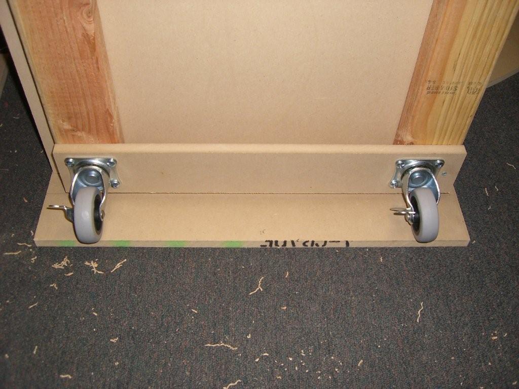

4.  Why no casters.  Take a look at most peopls arcade cabinets.  I have casters on mine, but the lip of the wood completely covers them up keeping it about an inch off the ground.  The back two casters can be locked in place so it is stable and won't move when I don't want it to.  You will thank yourself later for including them.  Just make sure they are the big heavy duty 3" ones from home depot.

4. I didn’t want casters because I didn’t want any rattling from them when I crank it up. I have a tile floor and I think that might become an issue. I was going to use some kind of rubber feet. I haven’t decided on what exactly. I have casters on my second arcade cabinet and I do hear a little rattling when playing MP3s. Here’s a shot of them:

4.   Its hard to see, but those look like kind of small casters.  On mine they are extremely heavy duty ones from home depot.  I think 3 or 4" diameter wheels, all rubber.  They have never made a rattling noise at all.  As you can see below, they have switches to lock them in place as well.  I think they were rated to hold several hundred pounds each giving them a real solid feel.  If this thing is made out of mdf, you will want an easy way to move it.

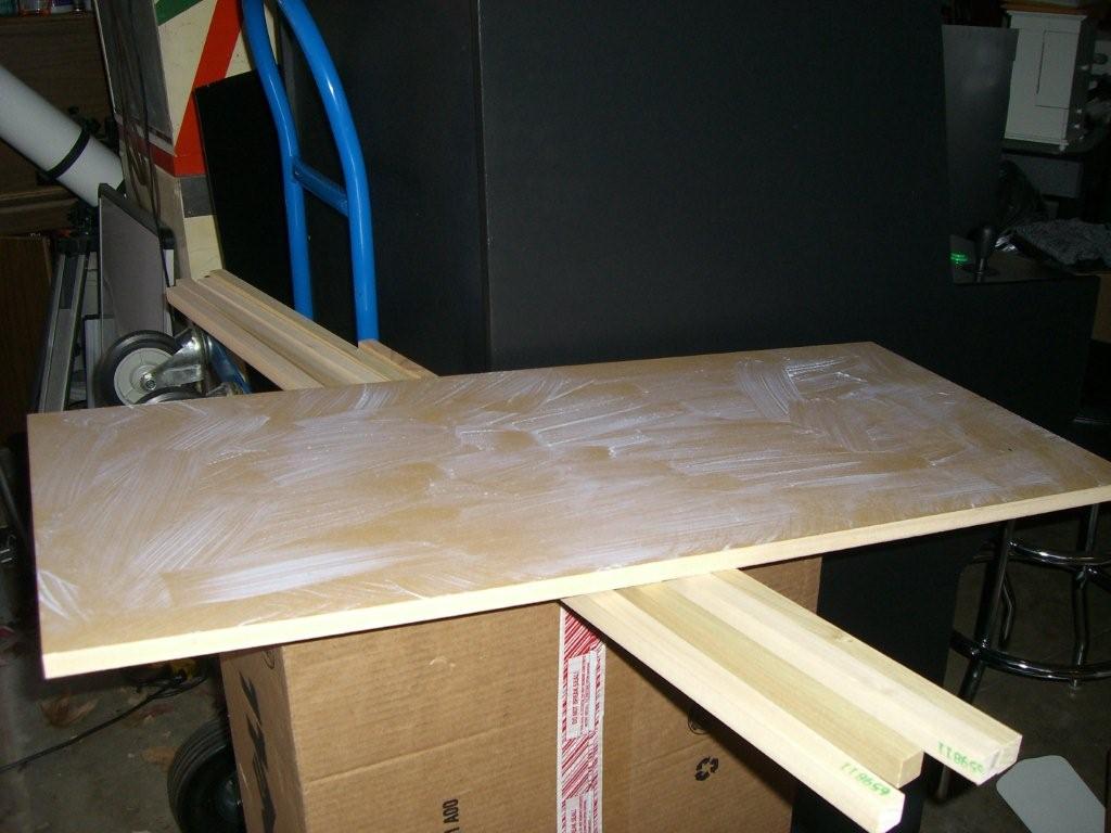

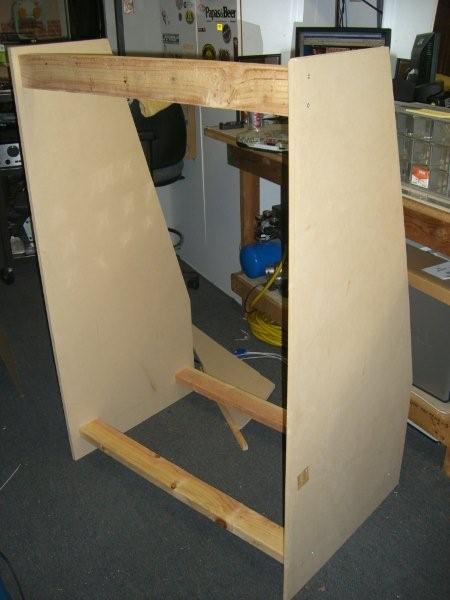

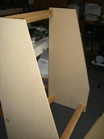

Ok. Finally an update. I started cutting my MFD this evening. I changed the design a bit as you can see.
My straight cuts are thanks to my sawboard I made after reading these forums. I wish I had made these before my last arcade project!!
even the sawboard can’t help me from being stupid. Look what I did to my table!
But all in all, it’s not bad for an hour worth of work.

Yeah, still have a Christmas deadline. We'll see. It's gonna be tight. I still have to fit in Christmas shopping and putting up the lights and stuff..
The design is a little bigger than I first thought. It's about 6" taller. So the dimensions are 36" by 24" and 54" tall.

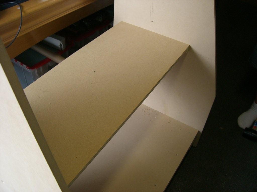

As promised, here are a few more pics from last night. I don't have the back done yet. I'm thinking of a transparent back to show off the equipment.
Here's a show of the lighting from the bottom I was talking about in an eariler post. It's just not bright enough!
Here is a shot of the crappiest cut so far. Look at the top of the top monitor. I just CAN'T cut straight with a jigsaw. The blade keeps flexing.
