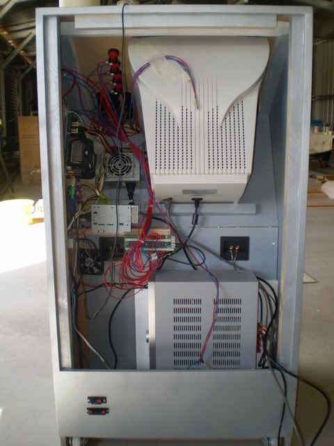

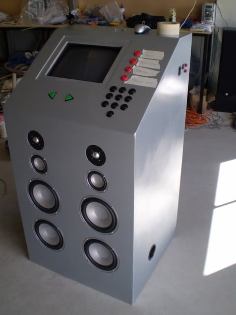

Hi all,
I have just built my first stand alone jukebox after getting inspired by this site.  I have a couple of questions though.
1. How can I get SKJukebox to automatically start up straight away when I turn on the computer so that I dont require a mouse or keyboard? (running Win XP)
2. Can I use the spare floppy/cd power connection to run the green illuminated triangle button LEDs (wires are standard red, yellow and two black wires)  If so which wires do I use?
Cheers,
Here is a couple of pics of the juke..

Just create a shortcut to the exe file and put that shortcut to the start up folder...

Not meaning to get off topic here, but I like your jukebox design, MadDougs.
But I do have an off topic question:
With the speakers mounted like that (and Ive seen others the same way), arent you afraid someone might put a foot through one?
Or maybe you are going to put metal grills on them?

It looks like you mounted the speakers manually on the front panel so I was wondering how  did you shield the speakers so the magnets did not interfere with your computer equipment?

It looks to me like there is a wood barrier in there behind the speakers.

Yeah I saw the wood panel as well but I was not sure that wood provided a good enough shield for magnets vs. computer parts so I was wondering whether there was some sort of shielding material behind that wood panel.
