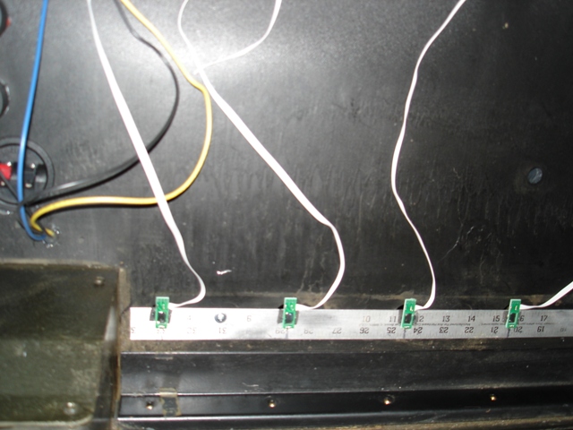

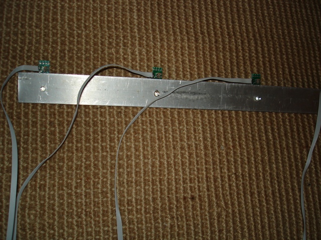

Okay, I got the bottom area with the 12" subs done today.  I also mounted the speaker hookups.  Here are some pics for your viewing pleasure. :)
I used a 2" hole saw to drill the holes where the speaker hookups were to go.  I used hot glue to seal the hole and hold it in place.  Check out the size of the plug that came out!  I thought it was gonna be about 1/2" deep.  I also drilled a small hole right next to it to bring the wires back up through for the other speakers.  I also used hot glue to seal the hole.  I figured this would give everything a nice clean look as I can tuck the wires into a sleeve.  I then put the 12" subs in.  I used 1/4" foam around the outside of the speakers to make up for any gaps between the speakers and the housing.  I forgot to take pictures of that, but it was pretty straight forward.  I used a marker to outline the speaker, cut it out, and held it in place as I drilled the holes for the speakers.
Here is what it looked like originally:

After getting the bottom done, I decided to do some more this evening since the newborn wasn't ready to clock out yet.  So, I was sitting around checking out BYOAC and nothing new was going on so my mind wondered to the rgb's and LEDWiz I picked up from Randy and how I was going to mount them on the bottom of the jukebox.  I thought and thought and nothing was really jumping out at me, because if you know what Randy's RGB setup looks like, and you knew I was dealing with 6 1" holes, it might cause some problems for you too.  Anyways, I was just getting ready to cut some wood to hold them and as I picked up the metal yard stick, the idea just jumped out at me.  So, without further ado, I introduce what may be the most unique mounting of Randy's RGB boards to date.  I cut the yard stick to length, used some 1/4" thick foam and the hot glue gun again and this is the final results.  Now I just have to figure out how I'm going to mount the same RGB setups in the 6 2" holes on the sides! :banghead:
Here is the six holes that are at the front top of the bottom speaker area.  There used to be just regular bulbs there that did nothing special.
I marked the center of the holes on the yard stick, drilled out the width of the RGB, and here is what resulted.
Here are the six RGB boards mounted with the foam and hot glue.
Here is the whole thing mounted with a couple self tapping screws.

Here are some pics of what I accomplished overnight.  The first pic is just a sample of the speaker wire all buttoned up.
Here is one of the six pieces of metal I used to hold the RGB board.  I told you it wasn't pretty:
Here is a pic of the whole getup installed from the back and then from the front.  The last two pics are of the cover that goes over them.
