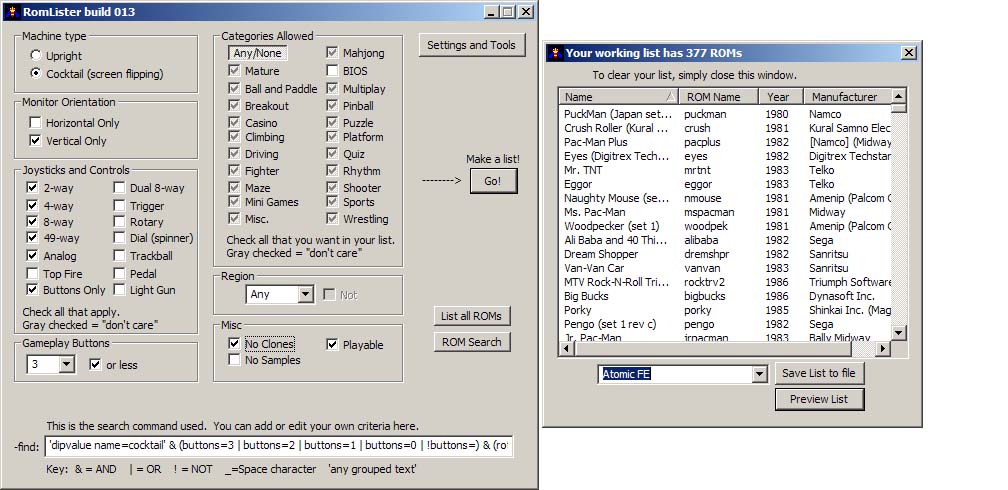

I guess now I'm going to spend 1/2 the night editing my gamelist (I only want vertical games) and tweaking the settings in MaLa.
Have you tried this tool?
http://forum.arcadecontrols.com/index.php?topic=67287.msg691288#msg691288
That program is fantastic.  Thanks!!
I'm still having trouble with #2 and #3 but fatfingers is walking me through #3 so it's really down to the display issue... maybe I need to buy some new computer parts like a video card, 1GB of RAM, etc.?
