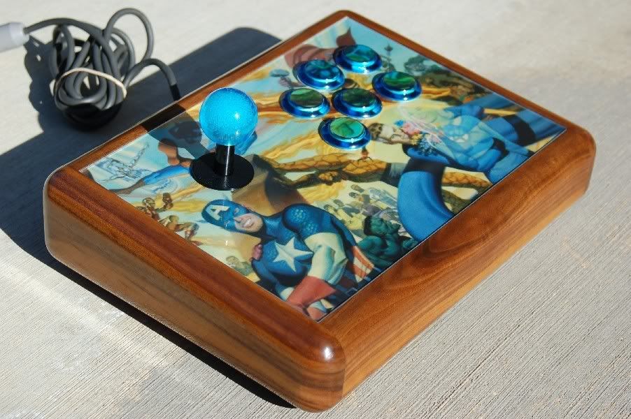

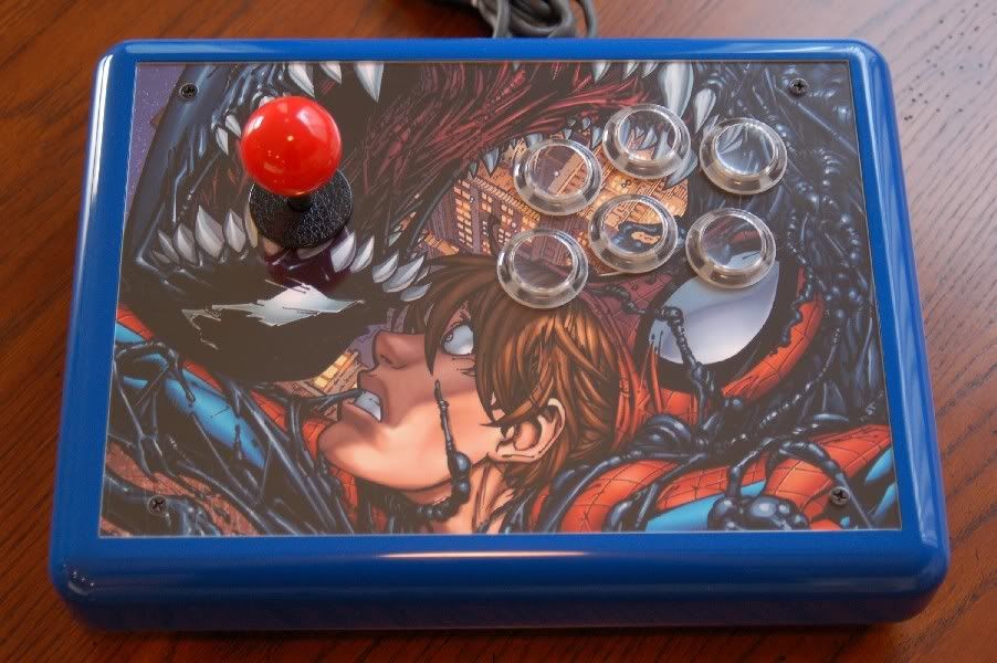

Here are some pics from our first happy customer.  (Wiring, art and part installation by Customer - Urth)

I love the clear buttons that really looks sharp Tim.

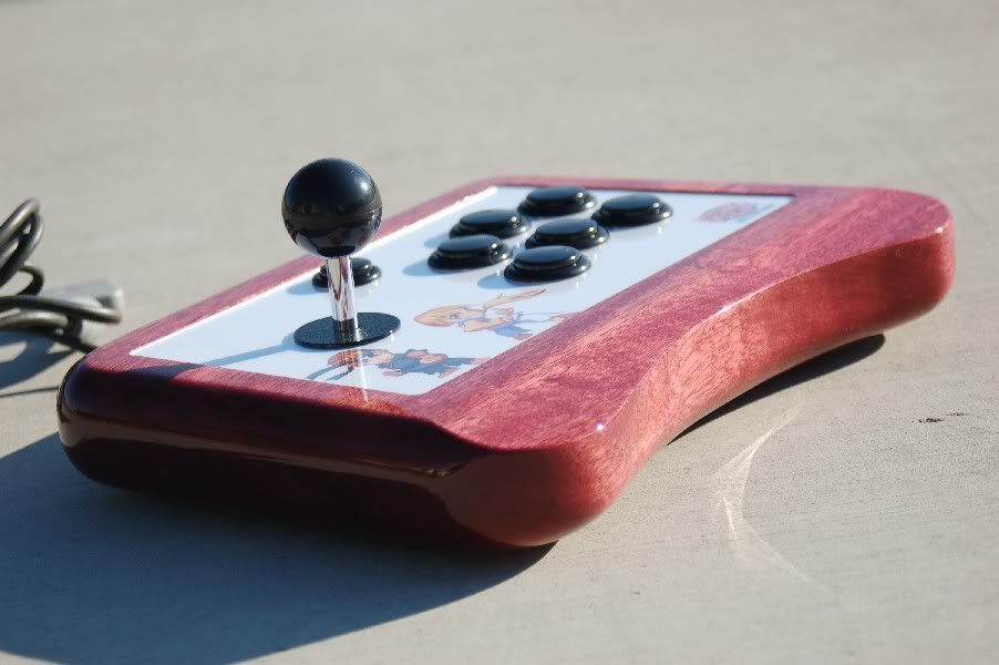

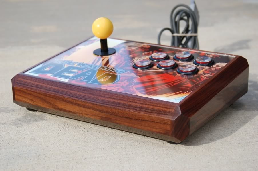

The June '07 Fleet has arrived. ....
Artwork and parts where installed by the customer, Urth, on this one.
Specifications:
-Sanwa JLF with Octagonal Gate
-Seimitsu buttons
-Wired for PS2
-Teak case
Timoe

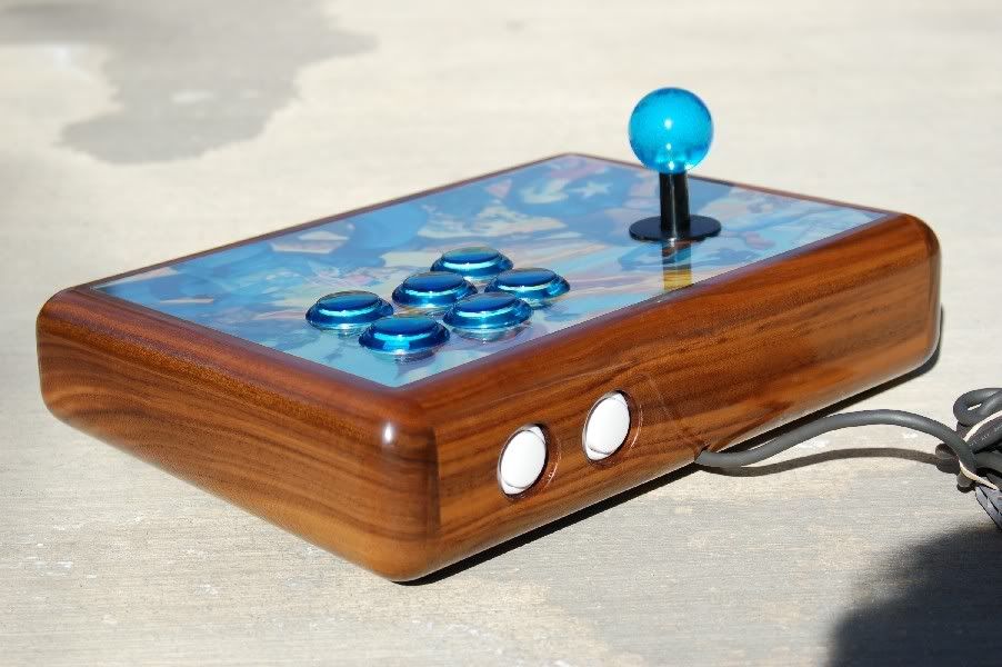

Stick for Kaden Dark-
Specifications:
-Sanwa JLF with Cherry microswitches
-Seimitsu buttons
-Wired for Xbox360
-Illuminated undercarriage

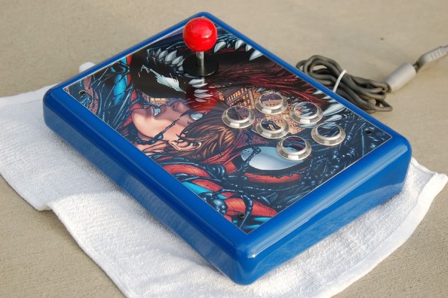

Stick for Mepaphoros-
Specifications:
-Happ P360
-Seimitsu buttons
-Wired for Xbox360

This one below was a ton of fun to make.  It was my wifes design:
  • Posts: 7931
Re: Timoe's Mini Sanwa Sticks
« Reply #159 on: September 12, 2007, 11:22:11 pm »
Thats quality! Nice work  :cheers:
arcadefever
  • Posts: 795
  • Miami Beach Florida
« Reply #160 on: September 12, 2007, 11:24:40 pm »
 :o
ART  :notworthy:
Kaytrim
  • I'm too nice a guy
  • Posts: 2095
« Reply #161 on: September 12, 2007, 11:49:11 pm »
Too bad this little lady sold in 3 hours flat over on the SRK forums.  You may have to make a few more of these Timoe. ;)

This hobby is becoming more and more fun all the time.
This stick is made from Teak and coated with polyurethane.
Kaytrim
  • Posts: 2095
« Reply #165 on: October 07, 2007, 11:08:51 pm »
Sweet stick there Tim. :cheers:  How long does it take you to build one of these 2-3 weeks?
TTFN
Kaytrim
patrickl
  • Posts: 4614
  • Yo momma llama
    • PocketGalaga
« Reply #166 on: October 08, 2007, 04:12:19 am »
That looks great.
Just cannot help feeling it would look even nicer with that dust washer below that tiny hole in the CP.

Exactly patrickl, thats why it was made so.  The hole leaves about a milimeter of extra space when the stick is thrown in any direction.  And you can't really feel it with your palm.  I will be doing them this way from now on so that the customer has the option of above or below the panel.
Here is a picture taken with a black dustwasher below the plexiglass.

That "polished walnut" looks stunning too. The dovetails are cute too and they look very precise. Amazing workmanship on all your "sticks".
bfauska
  • Posts: 1372
« Reply #173 on: October 08, 2007, 12:57:15 pm »
That walnut looks like a rendering, and the way I can usually tell if something is a rendering is that it looks too perfect.  :applaud:  Beautiful work, your craftsmanship is on a whole other level.

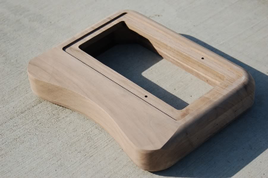

Here is a simple new one.  Routed from one solid piece of purpleheart.  No stain, no glue, no joinery.

Now this is a style you can call your own Timoe.  Though I bet that block of purpleheart set you back a bit.  What kind of wood was that Marvel stick?

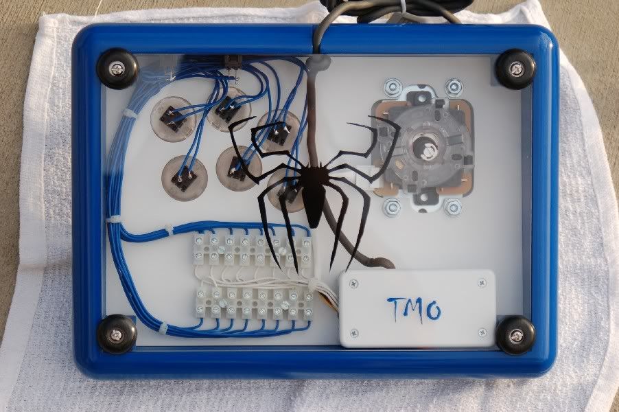

The marvel was black walnut and the spiderman stick was poplar.

I will build another similar to ^ the one above soon.  I will try to remember to take pics.
There was no mention on MTV.   :dunno I was just frontin'
but here is another one made from Morado

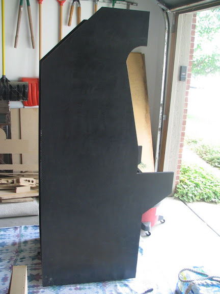

It is not always 'flat' as you will see here in this pic.  I hope that Timoe doesn't mind me posting this but it is one of his latest sticks.  Curly Maple dyed black.

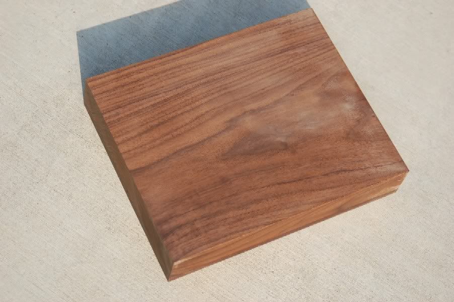

    • Rattlin' Trash
Re: Timoe's Mini Sticks - as featured on MTV's BEST STUFF EVER
« Reply #195 on: August 22, 2008, 07:52:41 am »
Hey,
I've been, kind of, out of it lately.  Work has been redonkulous.
I have a pretty decent table saw with an 80 tooth blade.  I just try to cut em straight.
More than anything, I think I am better at sanding than cutting.  I seem to be sanding all the freaking time.

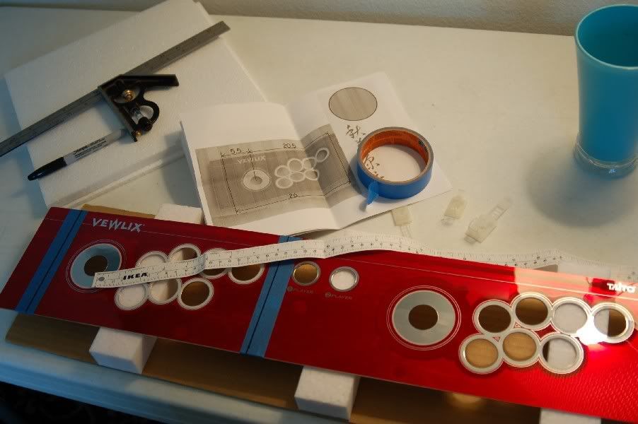

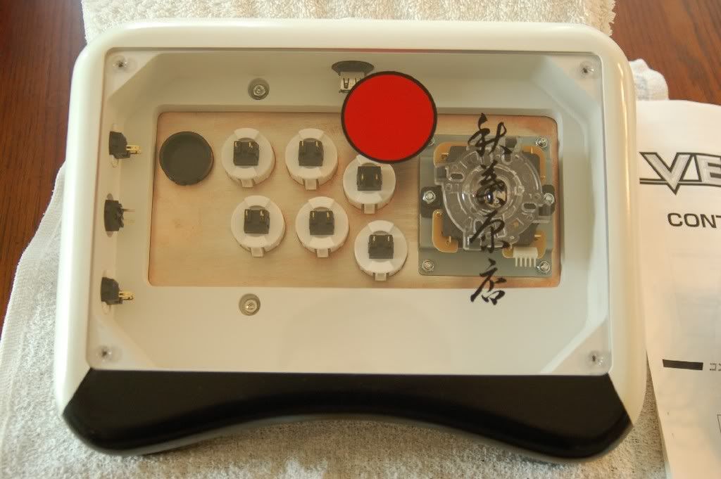

Here is a new one made from a solid block of walnut and the metal plate from a Taito Vewlix cabinet.
« Last Edit: August 22, 2008, 07:57:05 am by Timoe »
  • Posts: 7995
« Reply #196 on: August 22, 2008, 10:54:03 am »
Wow - that looks great as usual!  Why not use MDF instead of Walnut since it was painted?   :cheers:

We used walnut for the Vewlix case just to be Extra Premium, for the weight and to be really solid.  The stick will be for wireless PS3, I believe.
