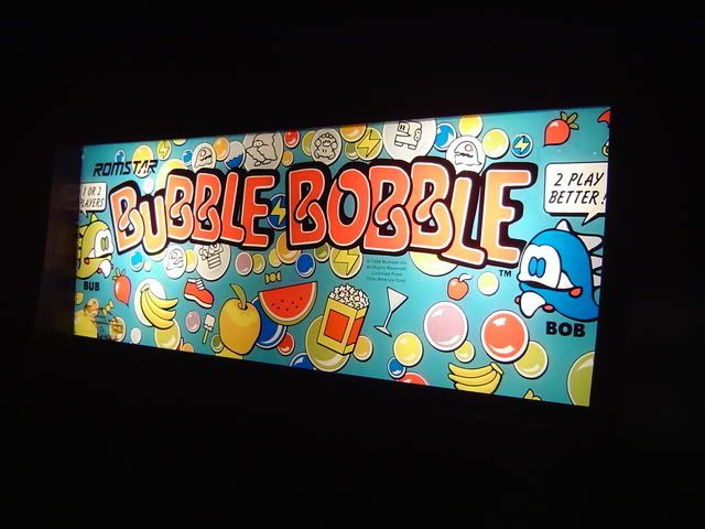

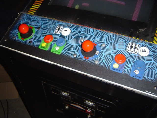

Ok guys, I was able to get this cab, with a working Bubble Bobble for $200. It's a pretty good deal since the monitor is in great shape. So, here's a few pics.
Here's the only damage I'll have to patch.
I'd like to convert this to a Ms. Pac-Man, but with this being a Pac-Man cab, it's actually a bit smaller, right? The structure of the cab is solid, it's just going to need a lot of work to get all pretty again and in its original form.

I can't remember, but I think the Pac-man marquee is a little bigger than the Ms. Pac marquee, so you may want to consider that also if you plan to use an original marquee.
If you're replacing the art, reproduction Ms. Pac art will be a very tight fit on the cab, as it's not only shorter by about 1 1/2", but it might be deeper by about the same.  Check out Jakobud's plans for both cabs (does he have plans for the original Pac on there?) and you'll be able to see if there are any size differences that would keep it from working like you want.
Congrats on getting the cab!

Judging by the picture of the side of the cabinet, I'd say it was originally a Rally-X.  You can see the outline of a round sticker on the side of the cab, and it matches the size and location of Rally-X sideart.
Pac-Fan
  • Posts: 134
  • Last login:February 05, 2014, 09:30:12 am
Yep I was going to say the exact same thing.  The RallyX cab is about 6" Shallower than a Pac-Man or Galaxian, but should share everything else in the profile/mounts.  I didnt' say that was an option in your other thread because it's VERY rare to see a RallyX cab, plus your first picture didn't show the side profile fully.
It was shallower since the monitor could be mounted horizontally instead of vertically, saving some space for where the tube would have popped out the back, plus the fact that they often used horizontal frame monitors instead of vertical, causing even more bump out if it had been a pacman mounted vertically.
In fact if you simply change the monitor frame in a Pac/Galaxian you can trim off about 4.5"-5" of depth on the cabinet before you run into the neckboard. Thats a lot of wasted space, but does help for stability.
