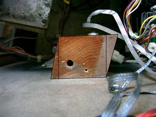

In case you want to build in the monitor bracket supports, I included the measurements for those as well.  Here are the overall dimensions:
It has an interesting shape, as you can see from above.  Sorry about the small font size on this one.  The measurements read left to right:  1/2", 2", 5/8":
Here is the proper positioning from the right inside wall:
Here is the support for the rear right:
And the proper positioning:

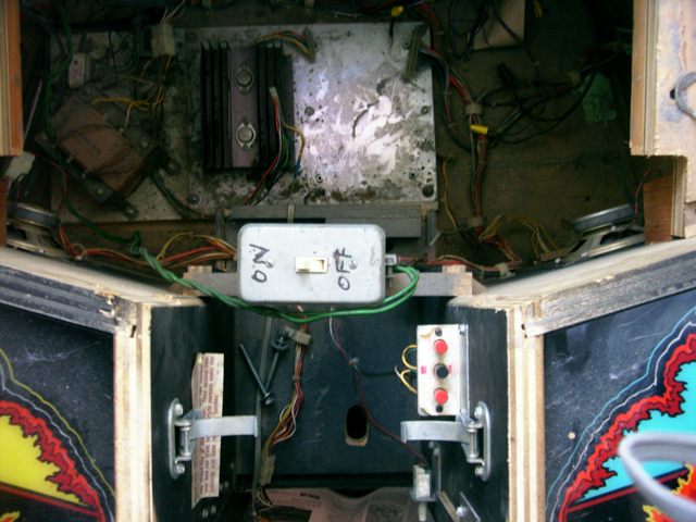

Could use one more pic, basically a repeat of this one but with the coin doors open. Need the dimension shown in the lower pic as well.

« Reply #112 on: March 25, 2007, 04:37:20 pm »
Thanks Swedish Chef......   ;D
ok.....here ya go....
Here's the pic with the front door open, along with some measurements on the shelf spacing:
And here is the detailed measurements on the upper shelf.  I know you just asked for the depth, but I've always been guilty of TMI so.....
Guess there has been one good thing for why it's taken me so long to get around to putting this thing back together....
