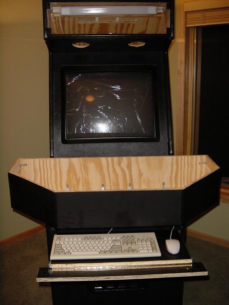

Just thought I'd toss out my CP layout and yes I do know that there aren't any 6+ button games for players 3 and 4.  I'm future proofing (and the like the uniformity of all the players looking the same.)  Anyway let me know what you think.  The only thing I'm trying to figure out is whether to go with 7 or 8 buttons.   ;D
Also I have to send out a thanks to JQ for supplying the character pics!
-Zinfari
« Last Edit: March 17, 2003, 11:17:54 pm by Zinfari »

I like it,Its pretty good looking  :) and very colorfull(I like colorfull stuff ;D)
1 thing bothering me though..that 4th button on the top row..thats for what?Neo geo?.
Other then that,GOOD JOB !  :)
And you should go with the second art,you know...play mortal kombat. ;)

Thanks Snaaake and yea it did take more than 5 minutes.   ;)
I'm leaning towards the 8 button... I also have another 7 button that has the MK layout.  The 8th button really serves 2 purposes.
1.  NeoGeo layout is easy
2.  If for some reason I ever decide to try to put a console in as well, as most of them have 8 button controllers.  (may not be practical, but hey this is about me right)  :P

Looks nice...  But you have to consider is that 4 player games didn't usually use more than 2-3 buttons (someone correct me if im wrong!)..  So the 3rd and 4th player setup would kind of be a waste..  Also, personally, if I did a 4 player cp, I would make more room for the 1 and 2 players since you will probably playing those types of games more..  Not unless you have to have everything evenly spaced  :)

Looks really nice. I think it'll work out fine. Reminds me of Gauntlet.

     I like the second one better, and if you do that you may not need the 4th button on the top row.  You could use the bottom row of 3 plus that "run" button for neogeo games.
     I'm guessing your planning on n64 emulation (super smash brothers!) or something in addition to mame.  If you're only running Mame though, it only needs a max of 4 buttons for players 3 and 4 plus additional start buttons for the Dungeons and Dragons games.  That will save you some space on the cp.
 You may want to scrap the labeling of players 1, 2, 3, and 4.  Some games like TMNT have it so Player 1 is always the furthest left, though I guess you chould change that by remapping the coin buttons within mame for that individual game.  The Simpsons is like that as well (another konami game).
     I like the color separation, but I have an additional idea/suggestion.  Perhaps in photoshop you could enlarge each players graphic (mario) and make it transparent, and saturated with that players color.  So for player1 there would be a large reddish transparent mario filling that section of the cp.  Just throwing that idea in for you.
  Looks good.  -Jay
Its for future console games..
Like you know,if you wanna play 3 players sfa3 then you CAN ! ;D.
Like how we used to play..me alone against my 2 brothers(dreamcast version of course).
Its really fun !I won most of the time even though I am fighting 2 people at once(yes I know I rule when it comes to any street fighter :o).

DJ good call on the 1-4 player thing... hadn't really thought about it.  I'll either pull the text or replace it with something else that isn't player specifig.  Also means that I need to replace my 1-4 player white buttons I had been planning on useing... hmmm....
I think I'm going to keep all 8 buttons at this point.  Mainly because I like them, I have room and hopefully it future proofs me a bit (at least that's what I"m hoping  :D)
As far as the large transparent images... I tried it out and it looks pretty good, but I just don't have high enough res pictures to pull it off.  I have to scale the images about 500% and they are just to grainy when scaled that far.  I'll post them later when I get a chance so you can see what they look like.

I have a hack on my site for mame that will "sense" pnumber of players and you can remap accordingly.

I just updated the pics up top to reflect some of the suggestions.  What do folks think of the Mario/MegaMan/Pacman/Frogger text?  Also how does it look if I go with 7 menu buttons instead of 5?  Less is better, but I don't want to get into a situation where I need more than I thought I did.
Anyway I'm headed to the printer probably tomorrow or Wednesday so if anyone has any other suggestions bring'em on!
Thanks all
-Zinfari
P.S. As promised here's Dr. J's request... it looks cool, but I just don't have hi enough res photos of the chars to pull it off.  Looks nice this size though... enjoy.
And I couldn't resist showing off my 4 player coin door... color coded to match!
And the latest picture... just waiting of the CP.....

Hope you don't mind rolling your own mame.
It's pretty easy to use.  Learn how to use ctrlr files.  Setup default so  the players are in this order:
3124
Then make a player3.ini and player4.ini file with mappings to make it
1234

Well... the CP is pretty much done.  Have a look.  I ended up having the resolution to do the big chars after all (a bit of a mix up on my part on what res I was working in.)

Any now my marquee... this is pass one.  Let me know what you think.  I'm still looking for a better font to use...
-Zinfari
« Last Edit: March 26, 2003, 06:36:46 pm by Zinfari »

The CP turned out a lot nicer than I thought!  Nice job.

Wow, the CP and the marquee are very sweet indeed, I like them a lot!

Just updated my Marquee drawing above.  Let me know what you all think.
Thanks,
-Zinfari
Right track, keep goin! Bolder Yet!
Thicker, wider. How about a font with a white border around it?

I'll give it a shot Brax, just having a hard time finding a font I like.  Might just have to go on a font search...

I would have your font take up 1/3 of the marquee. I would have it on top of the Space Invaders (since there's lots of them and you could still tell they're there) and your other characters could be in front of the title slightly. I don't think you'd have a problem reading it at all and it would be a nice effect (much like many magazines have pictures overlapping their title sometimes.)

More updates to my marquee....what do you think?
-Zinfari

This one is better then the other one if you ask me..the font made a difference.
You could just you know..make the glowing effect around the edges of the writing "Game on...".
You know...since all the marques are like that..other then that..everything looks nice.  :)

The size of the font and the characters slightly in front have made a world of difference.
Damn I'm good! ha!
Nice work.

yup, the latest one is definitely the best!

Extreme envy on my part.
And what a clean wiring job!
