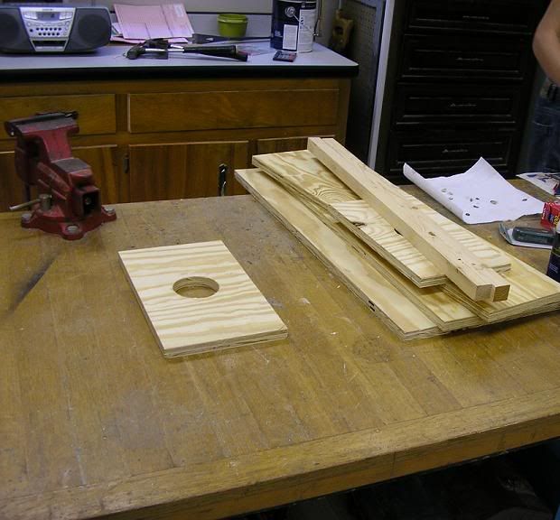

There are all the pieces, cut to size with all the necessary holes drilled. The large 3 and 1/8" holes are for the 80mm fans to keep airflow going. The slot (which you'll see better in the next pictures) is for the front panel mount. To cut those holes I got to use my friend's massive forstner bit.

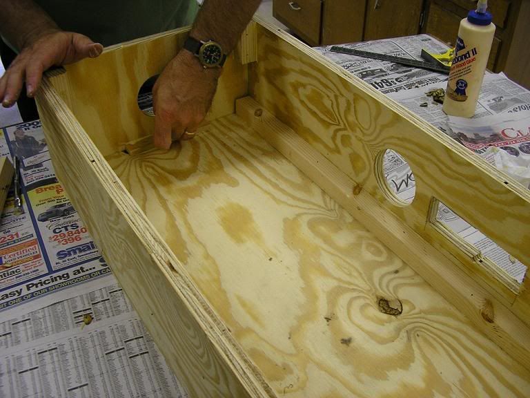

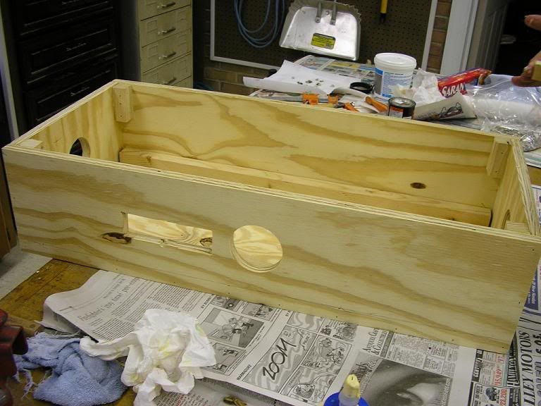

There is a picture of the assembled box. The hand is my friend's dad gluing in one of the supports for the base of the box.
And there she is, all glued up and ready to be laminated.
