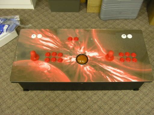

Okay...updates:
My brother came home over Thanksgiving and gave me the chance to use his router, and here are the results. Cutting the laminate, in all honesty, was the hardest part. Routing flush and gluing/placement was easy, I gave myself plenty of overhang. Just getting the stuff into the approximate size was a pain. I didn't have anything that'd work better than just scoring and snapping. I tried snips and they just made ugly cracks.
It turned out really well, the laminate makes it look nice and classy. One question though, what can I use to get some of the splotches of contact cement off the laminate? Acetone, lighter fluid?
Tell me what you think. The last picture shows how my front panel mount will fit in, it provides easy access to all the video/audio outs and some convenient usb ports.
Pictures on the next thread, photobucket is being a pain in the butt. By the way, I'm the hippie, the short haired one is my brother.

My brother basically just posing. The laminate was already placed, he's just pretending to do something.
Me adding a slight chamfer to the edges with a file, to reduce the chances of it peeling.

A few more.

Last few. Excuse the chipped paint on the top edges, those will be repainted. The router beat those edges up a bit, nothing a little paint won't fix. And the edges elsewhere aren't entirely cleaned up, I need to take a tad bit of contact cement off in certain areas.

« Reply #22 on: November 29, 2005, 09:32:28 pm »
Very good job, especially for a sixteen year old.

Updates:
My order arrived from PonyBoy and I got my artwork printed on vinyl. I plan on grabbing some plexi and the necessary bits to drill out all the holes for the buttons and the joysticks. I'll keep you updated. I still haven't found a router yet, though. I guess I'll keep looking, my local hardware stores don't rent them out.
Ignore the dark splotch on the vinyl, it's some phenomenon caused by my camera.
I had to beat them to death with their own shoes...

Johnny:
I really like your panel, but look at your vinyl print compared to your original artwork.  All the shadow detail is lost and the color is shifted really badly.
Some of that may be the camera, but if the print is really that off, then have them re-print it.

Like I said, it's a ton more vibrant in person, my camera makes it look like dirt. I had them reprint four times.
The image was low resolution to begin with, I may make custom artwork someday but for now this is what I am going with. It looks much better in person.
Thanks for your concern, though.

After comparing the printed cpo with a print of the original image, the colors are correct, it just lacks the glossiness...is there a way to make the vinyl glossy? I could laminate it...or possibly do some sort of poly? I don't know.

or slap a piece of 1/8" acrylic on top of the entire cp?

That'd work.  ;D
I planned on using plexi anyway, we'll see how it works out.

Update, I was working on the plexi today. I was on my last button and...I cracked it. Well, it was only 7 bucks, I'll try again tomorrow. How did everybody else go about drilling plexi? Well, what I did was I used my panel as the template and started the cut, I made a hole with the tip of the spade bit. Then I turned the panel over and cut the rest the way using the center mark to finish the hole. I tried my best to keep from widening the existing hole, I think I did well because there wasn't any saw dust (well....very little) and a lot of plexi dust. The problem hole was not perfectly round, making it very difficult for me to drill, and unfortunately cracked just enough to make me scrap the piece. I'll try again later tonite.

Try Lexan, its a bit more expensive.  But it shouldnt crack.

Is the acrylic clamped down on a flat surface, like scrap wood that you can drill through? The only times I have bad experiences with plastics (particularly thin stuff like 1/8") is if the piece moves at all while cutting. It's sad how unforgiving the material is, but if you always work with it with a little bit of paranoia the odds start to turn in your favor :)

I went and picked up another piece of plexi (I get it at work for 5 bucks!) and a few more clamps, to keep things nice and tight. I also ordered a dremel attachment, the router one. I got that for 20 bucks (I love employee discounts).

Make sure there is wood underneath the plexi when you drill into it and
GO SLOW

Re: My first project, a travel Control Panel arcade.
« Reply #91 on: April 24, 2006, 10:13:50 pm »
Yep, 3/4" for the t-molding.
Lots of cool updates tonite.
The hole for the power button was drilled in the back, along with a 1.5" hole for my power method. Well, I made a creative system to power this guy. We have single outlet surge protectors where I work and I took the casing off, drilled mounting holes the entire way through, and mounted the whole shebang onto my box. The male end sticks out through the hole so I can carry the extension cord seperate instead of it dangling out of the box, alongside with the surge protection.
I also added a barrel lock to keep the lid down and to keep my friends from messing with it. I took a picture to show you how I went about it. Basically, I took a normal barrel lock and bent the catch plate at a 90, and on the lid I  used a mending bracket and some washers to create an area  for the lip of the catch plate to...um...catch. It worked beautifully.
I also got some nice, dense foam rubber for the lid, to keep it from rattling and such.
Lastly, I installed the fans. I plan on removing all that after I mount my computer in order to touch up the fanholes with some black paint. Time for pictures!
What do you guys think? Not bad for a 17 year old hack.
« Reply #93 on: April 25, 2006, 10:39:22 pm »
She cleans up nicely.  :)

It's been pretty much set up for the past few days, I've been too busy playing it to show progress.
Two last things that need to be done.
1. Finish loading the software (which may never happen, I'll always find something to add).
2. Light the trackball (haven't had time, plan on doing that next week).
Here it is, plopped in front of my TV, running GameEx with the Galaxian theme.
Any comments/questions?

Looks like the instruction card covered that scratch pretty good.  That was a great idea!  Can you put up a shot of the card?  I'm kind of interested in how it's layed out.
