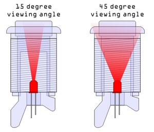

I would like to buy these leds:
https://www.amazon.com/dp/B08GRD9DCV?smid=A4796MTJVO3KW&ref_=chk_typ_imgToDp&th=1
One thing that concerns me about these is that the listing doesn't indicate if they are wide or narrow angle LEDs.  You might end up with a "hot spot" in the middle of the plunger.
If the LEDs are narrow angle, you might experiment with using 2 or 3 of them to side-light the button, either through some diffusion material like this guy did or design/3d print a bracket to hold the LEDs horizontally.  You might need to route a pocket for the diffusion material or bracket.
