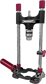

There are several ways you could do the 1/2" raised pink part.  This approach seems pretty good.
- Cut/shape the pink part from 1/2" MDF.
- Clamp it in position on the piece with the *already-done* yellow recesses.
- Drill some dowel holes through the yellow recess piece into the pink piece using a drill guide to control the depth and keep the holes perpindicular.
- Score some glue grooves on the back of the pink piece and on the face of the other piece under the area covered by the pink piece.
- Glue dowels into the pink piece and make sure they are not angled.
- Put some glue on the yellow recess piece grooves then put the pink piece on top.
- Add clamps and/or weights while the glue cures.
I assume you will be rounding the bends and corners of the yellow and pink areas so the router bit bearing will do the work and you don't have to chisel the inside angles, right?
