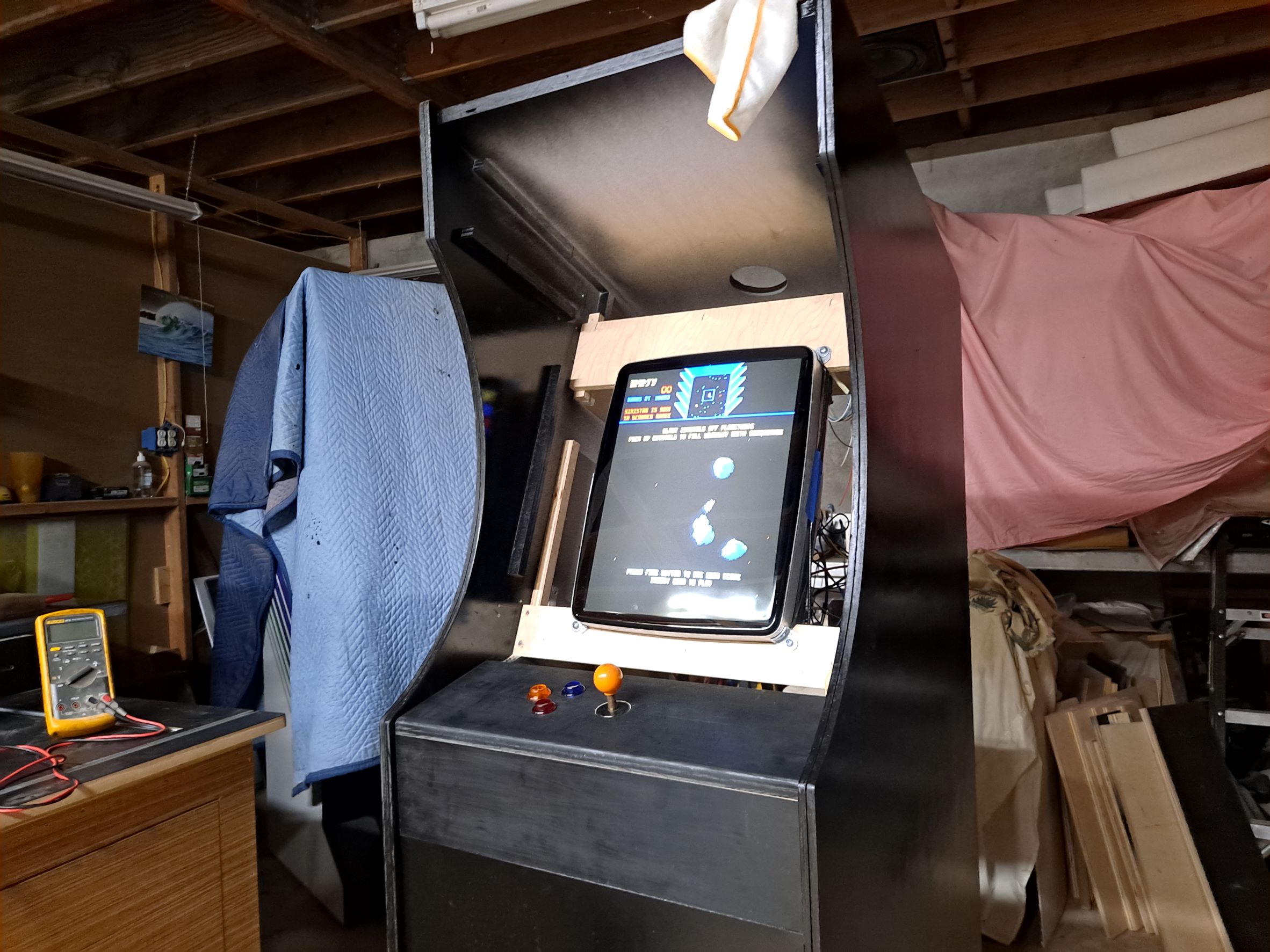

And finally...
Was beginning to think this wouldn't happen this weekend with all the other crap I have had going on.
On the plus side, the guest house (called an 'ohana' here) is finished- finally.
When the wife doesn't have it rented out it will be available for any housebroken community members who want to come visit for a few weeks and help me work on monitors!
Painting is getting a lot easier to deal with, but I think cleaning the gun properly/thoroughly afterwards will always be a PITA.
Maaaybe soon I can start experimenting with urethanes for something though!
Hopefully get some finish coats on this before the day is out.

I got a second coat of black on this after round one the other day hardened up pretty well and decided I could work on display mounting.
Lack of real screens being available here and my absolute refusal to put an LCD in one of these cabinets has previously made proper monitors nothing but frustrating and/or expensive.
I have been able to scrounge enough component in TVs to make this all tolerable- thanks to Andrew.
And so today we get to have Jrok DB15 jack out to GreenAntz board out to component in TV for the win!
Have people been figuring out how frackin' awesome your boards are for making this all just work...? (with no headaches either.)
Fun part of the Jrok as far as running Sinistar is that the 49 way stick doesn't control any menu navigation (which happens to be sideways when you are trying what I am up to) but it gave me use for this crappy joystick I have had sitting here for years!
I can't see myself really needing to cruise through the menu much once I have it all set up but this stick is useless other wise so I think I'll make a mounting bracket for it and screw it to the inside for when it is needed.
Apart from getting sync happening properly with the right signal coming out of the Jrok board too I can claim a win on guessing which way to tilt the tube to not have to play this standing on my head.
CCW from viewing position for those curious.
Time to make some harnesses and get this thing functional.

« Reply #14 on: March 04, 2022, 05:46:25 am »
Sorry if you know this already: If you get it wrong and can't be bothered physically turning the tube, or can't for some reason, you can always flip the 2-pin horizontal yoke connector around 180 degrees. This will also flip the image on the horz (long) axis. If your yoke connector has both horz and vertical stuck together (4 pins), like many are, then you would need to cut it in the middle (2 sets of 2 pins) to perform this trick. Obviously switch TV off before doing this. I've done it many times with no incident.
As always, my advice and suggestions are given freely, thoughtfully and with great care, but unfortunately no responsibility if it screws up   ;)
I was aware that these things can be played with (although I would be guessing about which to swap still) and I am afraid to even try!
At this point I have inadvertantly fried so many components on things trying to learn that I am taking a break for a bit on experimenting.
LoL @ mounting the tube the right way first time. I almost never get it right first time.
Like a coin toss- except somehow I won this time!
And that's ok, because when I mounted the joystick in this thing tonight I got that 180 degrees wrong the first shot, so... yeah.   :lol
Since I had gotten so far anyway somehow this week I figured why not stay up too late again and work on this some more.
Getting the control panel stuff sorted at first seemed pretty daunting as I have never dealt with mounting real leaf switch buttons before and this is also a first with a 49-way stick.
To make things more interesting, the place I actually found a legit assortment of proper color Sinistar leaf switch buttons happened to be out of pal nuts.
My local Ace Hardware had some coarse thread jam nuts that turned out to be the right fit (and costing $1 more each than a regular pal nut I'm sure) but what the hell.
And this is all more what the hell will I do because the only buttons I could find the proper translucent blue, orange, and red happen to be the short shank ones.
So as I am working with wood here it required some treatment with the router to get a cavity that I can get away with mounting these and making them functional.
Also entertainingly, the Williams 49-way has this donut on the top of the mounting plate that is 1-3/4" diameter.
Not only does that let you stuff the joystick assembly into a panel without having to remove the ball/shaft first but the donut also happens to be 3/4" tall and so sits flush with a plywood panel when mounted.
Had no idea.
I sat for a while with my eyes starting to cross while building a harness that could go from 49-way joystick to Jrok header (using parts of other harnesses I had around since I am too impatient to wait for the rest of the new molex bits I ordered to come) but wound up with what looked like it would work.
That is of course as long as I hadn't flipped the wiring over the wrong way (because the diagrams I could find of the two ends were shown opposite directions just for added fun-)
So after drilling, routing, crimping, heat shrinking, zip tying, etc. to see if I could get a test panel of something close to original arrangement and see if the whole mess actually works, we get...
And holy crap it actually plays.
And I am reminded decades later now just how much I SUCK at Sinistar.
But it's still fun.
And there is SO much unnecessary wire in a full prebuilt jamma harness for this machine that I can't stand the idea of all this crap in here, so I will be building a harness from a blank I got to sort this mess out and tidy up.
See how long that takes.

I got my buddy's board done and the lady is out with the girls for a B-day fiasco for one of them so I got free time
 >:D
I am still surprised at how simple these builds can get when you are dealing with jamma boards.
Not sure I had squared this away yet previously but I stil need to add one more set of jumpers to power another light bar that is just zip tied in to see if it does what I want.
Fused power inlet, line filter, distribution block, power converter...  so easy.
Add a GreenAntz with cables and a Trinitron, Jrok board and jamma harness with the right wires, and off you go.
I love how simple these are getting.  In addition to the wonders of MAME I am now also a huge fan of fpga too.
Once again love me some GameOnGrafix here.
I have bezel art coming also (which I think is at the PO waiting for me now actually) so if I can find the T-molding I got for it a while back it will be nearly done next week maybe even.
Always thought that it was a waste to have such cool buttons on the original here and have them NOT be lit.
I'm correcting that deficiency on mine.
And if I didn't suck so bad at this game it would all make sense!

Thanks Andrew!
Yeah, the game quickly becomes imoossible for me after blowing up Sinistar just once.
Love how easy it is to get the GreenAntz integrated.  Glad I remebered how to solder decently finally.
Doesn't look right without a coin door, does it?!
I need to do something, but...
1. Jrok board makes it functionally moot.
2. Getting one shipped to me literally doubles the cost!
Maybe a fakie one is in order here, but I'm not confident one of those doesn't just look REALLY fake- which is possibly worse than nothing.
That kick panel is actually attached with screws so I can pull it out and alter it easily.
bobbyb13
  • Posts: 2024
Re: Now I may have done it- Sinistar cabaret
« Reply #26 on: March 28, 2022, 02:49:32 pm »
WOW Bobby - this thing looks awesome.  Really really nice job.  The artwork really brings it all together and I really like the buttons lit up like that.  If you get a chance, can you explain your setup in more detail for idiots like me who have only ever used a PC and MAME?   :cheers:
Thank you sir!
Easiest of all of my builds so far.
A MAME box is actually harder to set up.
Components in order of build/flow are:
Fused power inlet and AC line filter
Distribution block and power supply converter/ switching power supply.
Jrok Multi-Williams board
JAMMA harness
VGA cable
GreenAntz video board
Component (rgb) RCA cable set
Sony Trinitron with component in
Joystick
Buttons
Two led light strips- one for marquee, one for button illumination.
The Jrok board only needs ground and +5V from the power supply.
It has a jumper to output vga or cga signal, depending on your screen requirements.
GreenAntz board needs the same power.
A normal joystick and buttons setup via jamma is easy. The 49 way here requires a seperate harness and also needs ground and +5V.
My MultiWilliams and BitKit cabinets were just as easy!
Are you going to build something similar soon?
 >:D
Happy to help/enable in whatever way I can!
 :lol
