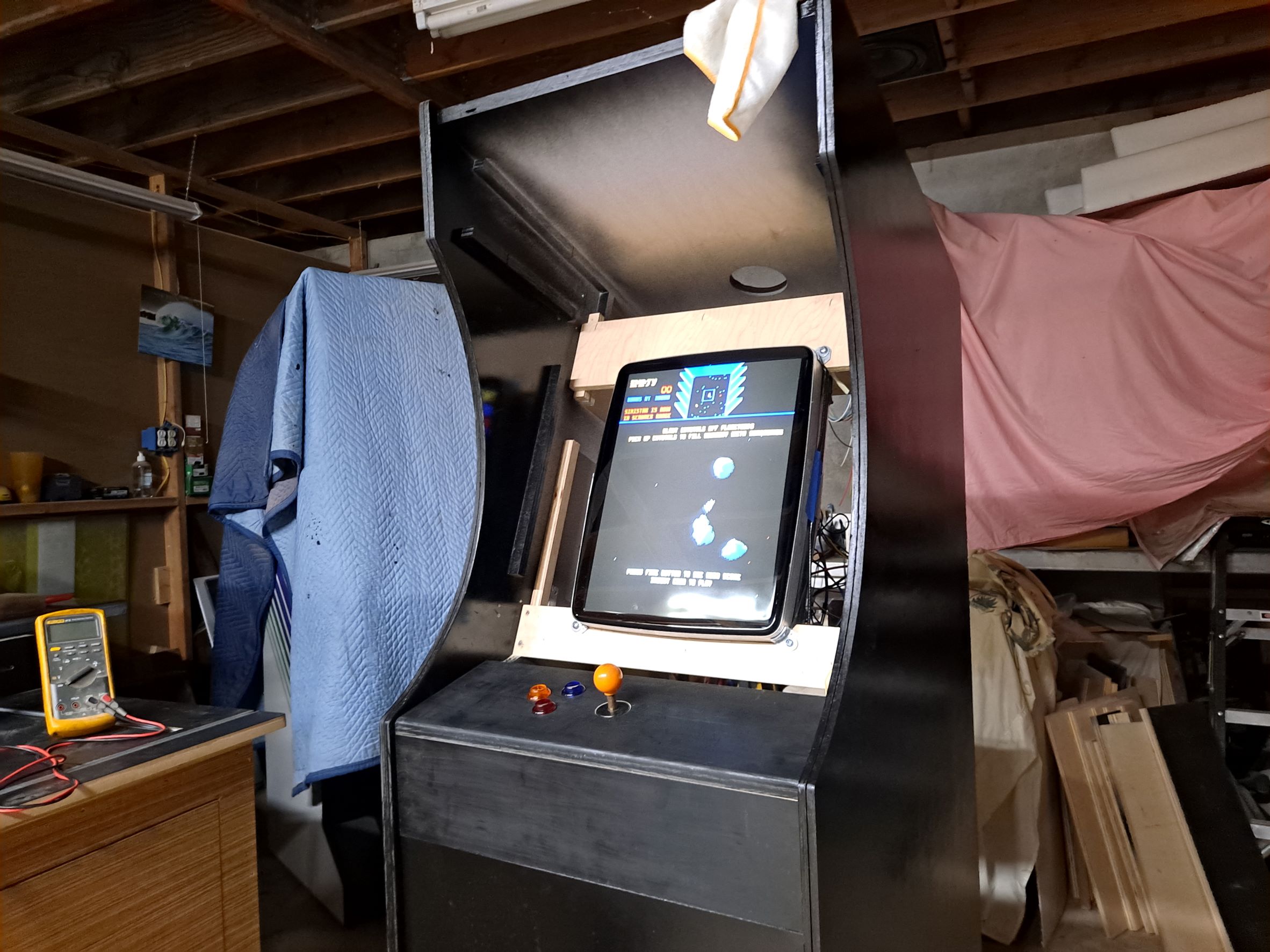

Side panel template designing is coming along much faster and easier at this point.
I found the profile I was looking to start with over at classicarcadecabinets (again) so tweaking it a little for my purposes was not so hard.
The reason I suppose I haven't made a cabaret style cab prior to this was that the screen angle is not good for me- at all.
Staring down like that for too long is really bad for me.
After I decided that I would look at what a steeper screen angle and different depth afforded (along with a little difference in the height of the back edge of the cabinet I came up with this.
With this layout the screen angle should wind up about 105 degrees from floor plane- which is surprisingly fine (damn close to the Paperboy in fact- and that is quite comfy for me.)
After it is sitting on casters the back corner will be at about 64" which will actually not be horrible with the knee wall and 45 degree angle of the gable roof (ceiling!) in The Loft.
The leading edge of the control panel will be at 38" and the bottom edge of the marquee will wind up at 65" and so won't obstruct view except maybe for someone a few inches taller than me (so over 6' tall.)
Like most everything else I have been building this is NOT an exact replica of course, but it certainly has the proper vibe and accomodates my desires for ergonomics.
Now to get some  black primer and a few other bits to keep going when I can get some more time.
I BARELY snuck in the cutting and cleaning up of this one this afternoon after a pretty random workday.
I'm going to be really busy with a few remodels here for a few weeks so it will make me nuts to not be able to work on it much.

I have been trying to build a cabaret/Tully/something not full size for a while now just because it makes so much more sense for the space the home arcade is being built into at this point.
It took until this one to sort out a profile that would fit a legitimate 19" tube at an angle I can live with and still maintain a control panel height and angle I like also.
Searching for a while for a Sinistar cabaret was fruitless but Williams did make some of the other contemporaneous titles in that form factor so I figured what the hell.
Then a search for Williams cabaret brought up the Stargate version which is the inspiration for this one.
The only scale picture I found of the thing made it look like it was a height that one could rest their giblets on the control panel and I thought no way.
Smacks of A1Up at that size.
At the dimensions I decided on it seemed like it might not make a purist immediately vomit, and I really liked the concept myself.

A little more progress!
I'm actually most excited about this one because I have stumbled onto what are great proportions for a traditional style single player cabinet that is as small as possible and still fits me comfortably.
Cabinet bases henceforth will only be this:
Ply bottom deck
2x4s for side panel supports.
Four 2" wheel casters- straight ones in back and pivots in front.
I am picking up the front panel just enough to get your hand under to engage/disengage the brakes on the front casters.
The back panel where I'm putting the power inlet sits on top of the plywood base panel.
Done.
Seems like getting the casters set on the ply, the 2x4s set on that and then resting the side panels on a piece of ply scrap (so they wind up 3/4" off the floor) just makes it all so easy.
Pilot for screws to hold the side panels in place and glue and screw them on.
I've been looking for a simple solution that adds a strongback to the simplest of modular tube holding brackets and here it is.
I have been making all of these cabinets with wood control panels and using various methods of blocking to support the weight.
It occurred to me here that blocking long enough can:
-Support the control panel
-Act as the bottom support for bezel, bezel art, and plexiglass (without needing any bottom C- channel of other piece)
-Also be the bottom support for the tube mounting bracket.
After I had thought through exactly where the front face of the screen needed to be so that the neckboard would still clear the back door it was easier to pick the angle that the bezel support would exist at and to make this all come together at once.
Once I knew where the tube would wind up it was easy to pick the location for the chassis shelf and to drop the upper tube support into the right spot to mark for mounting holes.
The other thing this all did was show me how long the speaker panel would wind up- which was longer than the first piece I had cut for it- but made it easier to sort out the angle for that and where to put the blocking to carry it also.
I have the control panel (which is an 'L' like an original Sinistar- albeit wood) pieces cut and beveled also but I will wait to assemble that until I have the overlay and know exactly where the buttons and stick go.
Either way, it is ready for paint!
I'm hoping to get it primed before I have to head out for a few jobs tomorrow.

I got a second coat of black on this after round one the other day hardened up pretty well and decided I could work on display mounting.
Lack of real screens being available here and my absolute refusal to put an LCD in one of these cabinets has previously made proper monitors nothing but frustrating and/or expensive.
I have been able to scrounge enough component in TVs to make this all tolerable- thanks to Andrew.
And so today we get to have Jrok DB15 jack out to GreenAntz board out to component in TV for the win!
Have people been figuring out how frackin' awesome your boards are for making this all just work...? (with no headaches either.)
Fun part of the Jrok as far as running Sinistar is that the 49 way stick doesn't control any menu navigation (which happens to be sideways when you are trying what I am up to) but it gave me use for this crappy joystick I have had sitting here for years!
I can't see myself really needing to cruise through the menu much once I have it all set up but this stick is useless other wise so I think I'll make a mounting bracket for it and screw it to the inside for when it is needed.
Apart from getting sync happening properly with the right signal coming out of the Jrok board too I can claim a win on guessing which way to tilt the tube to not have to play this standing on my head.
CCW from viewing position for those curious.
Time to make some harnesses and get this thing functional.

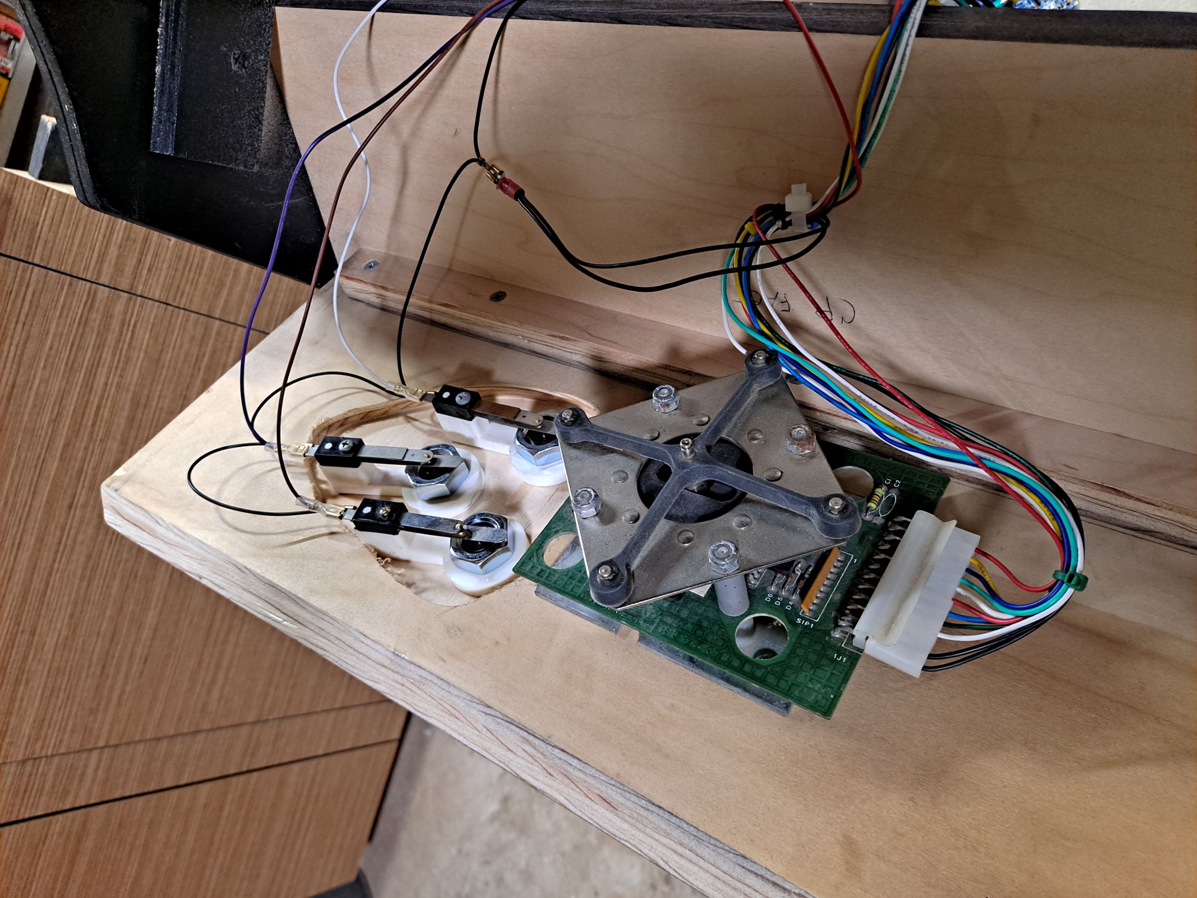

And that's ok, because when I mounted the joystick in this thing tonight I got that 180 degrees wrong the first shot, so... yeah.   :lol
Since I had gotten so far anyway somehow this week I figured why not stay up too late again and work on this some more.
Getting the control panel stuff sorted at first seemed pretty daunting as I have never dealt with mounting real leaf switch buttons before and this is also a first with a 49-way stick.
To make things more interesting, the place I actually found a legit assortment of proper color Sinistar leaf switch buttons happened to be out of pal nuts.
My local Ace Hardware had some coarse thread jam nuts that turned out to be the right fit (and costing $1 more each than a regular pal nut I'm sure) but what the hell.
And this is all more what the hell will I do because the only buttons I could find the proper translucent blue, orange, and red happen to be the short shank ones.
So as I am working with wood here it required some treatment with the router to get a cavity that I can get away with mounting these and making them functional.
Also entertainingly, the Williams 49-way has this donut on the top of the mounting plate that is 1-3/4" diameter.
Not only does that let you stuff the joystick assembly into a panel without having to remove the ball/shaft first but the donut also happens to be 3/4" tall and so sits flush with a plywood panel when mounted.
Had no idea.
I sat for a while with my eyes starting to cross while building a harness that could go from 49-way joystick to Jrok header (using parts of other harnesses I had around since I am too impatient to wait for the rest of the new molex bits I ordered to come) but wound up with what looked like it would work.
That is of course as long as I hadn't flipped the wiring over the wrong way (because the diagrams I could find of the two ends were shown opposite directions just for added fun-)
So after drilling, routing, crimping, heat shrinking, zip tying, etc. to see if I could get a test panel of something close to original arrangement and see if the whole mess actually works, we get...
And holy crap it actually plays.
And I am reminded decades later now just how much I SUCK at Sinistar.
But it's still fun.
And there is SO much unnecessary wire in a full prebuilt jamma harness for this machine that I can't stand the idea of all this crap in here, so I will be building a harness from a blank I got to sort this mess out and tidy up.

And so, I was irritated about how much wire is left cluttering up the cabinet using a fully populated jamma harness for this particular build and rather than just chop off or zip tie up what wasn't needed (probably 75% of it actually) I thought, why not make my own...?
Can't say that I will be rushing to do this again probably, but it was a great exercise in sorting through some soldering and by the end of it, the whole process was not bad- just time consuming.
Not the most beautiful thing I have ever made, but I had gone through the trouble also to find that 22g wire is the largest that is easy to manage for signal wires and then ordered what turned out to be quite nice quality stuff from WireBarn.
Overkill for this hobby maybe (as it appears to be really nice engine bay wire actually) but it won't fail!
Anyone care to share what they have found as a definitive source for wire?
I found also that for the main ground and 5v and 12v lines you can even manage to use 16g if you tin it so that you can flatten it to get it through the eyelets on the connector.
Took longer than I would have thought, but the result looks so much nicer that it was worth it.
And best yet, the machine still worked when I swapped that into the cabinet and reconnected everything.

22 or 24 AWG is what I usually use, or whatever I have available that works.
Thread your rolls of different coloured wire onto a offcut piece of PVC pipe and put an 90 degree elbow on the end to hold it on. Then you can easily grab your wire, move it where you are working, and just pull off whatever lengths you need.

My marquee and CP art came in so I cheated a bit more time to work on this too.
Test CP was off with button arrangement of course, but I have another piece of wood ready to go to make the real one.
The one handed Milwaukee router and the vac unit makes for a really nice setup for this sort of stuff.
I had forgotten that this CP blank was originally going to be the one that went on the Multi-Williams and I had punched for drilling buttons and sticks- so those little pings needed filler.
Good excuse for my favorite blending concoction.
Once that had gelled I figured it was time to assemble the whole thing so that I could put filler on the inevitable gap between the top and front panels.
I think this corner block will work because I glued and screwed the crap out of it.
I don't remember what the bevel angle was but I matched it all so it would look right and be strong.
Once I get the filler I addded to the front corner sanded out I'll be able to get the overlay on it and button that part up.
Still have to decide if I will use regular panel clamps or just screw it in place from the backside.
I don't see this control panel coming out much.
