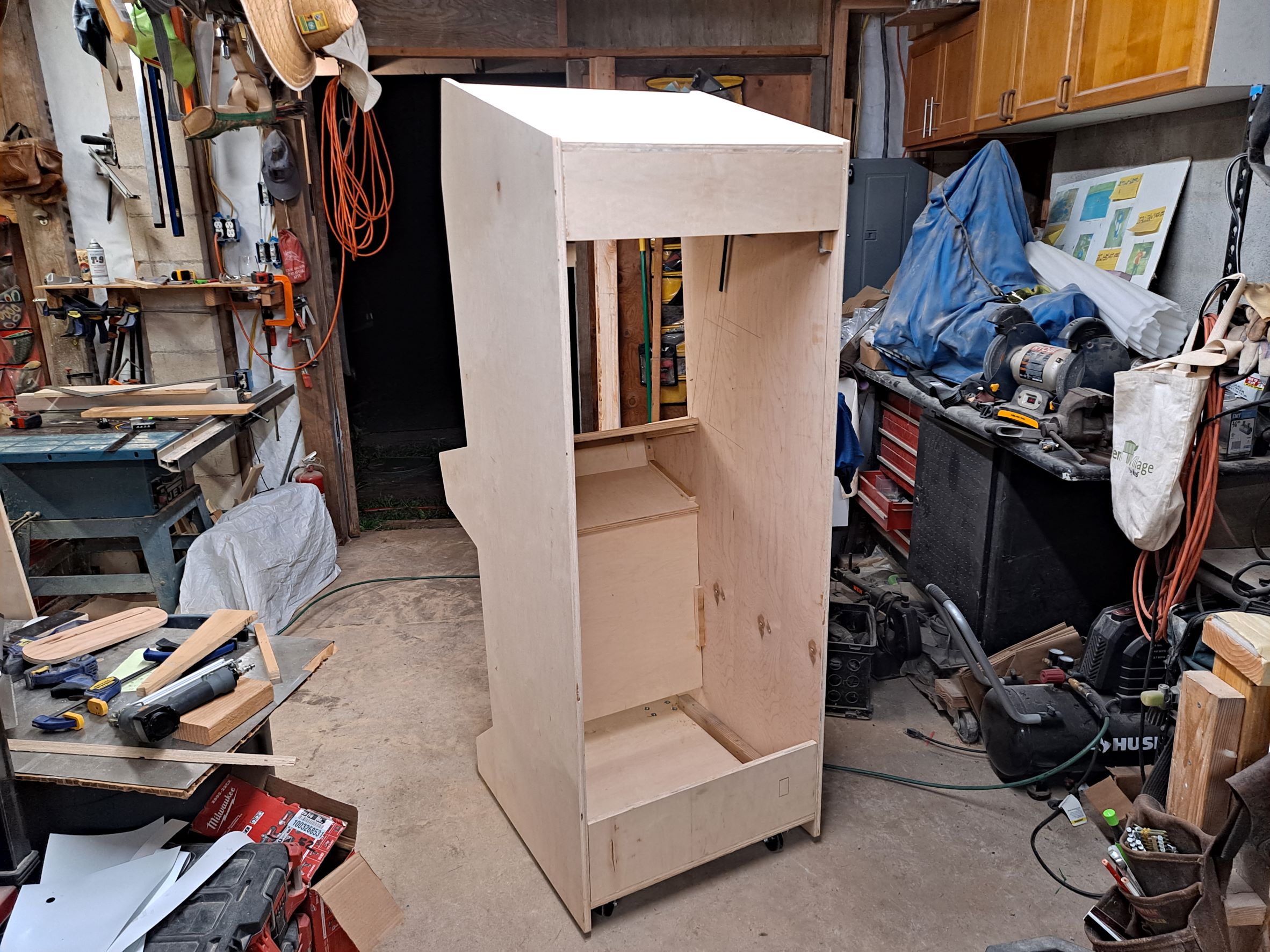

I spent the standard hour plus with straight edges and tape measure and profile tracings to calculate what was as authentic as possible for a cabinet body.
I had entertained the idea of checking in with a local cabinet business that I know has a few CNC tables and seeing how those files from classicarcadecabinets would go, and then thought... screw it!
CNC my eye... Give me a few clamps and a SkilSaw!
Use the jigsaw to finish the circular saw cuts without overcutting, clean up the edges with a random orbital, run the router with a slot cutter, and voila!
I'm going to make the cab an inch wider than original in case for some reason it winds up with a larger screen in it at some point.
Just thinking ahead.
I got a bit of the blocking on both sides after that pic and also build the base compete with casters so the next hour I have to spend on this it will be a standing box already.
Ironic that the BitKit and Multi-Williams are only waiting for artwork to be done (which I still haven't made a final call on yet) and this one I am beginning with it.
Go figure.
 :dunno

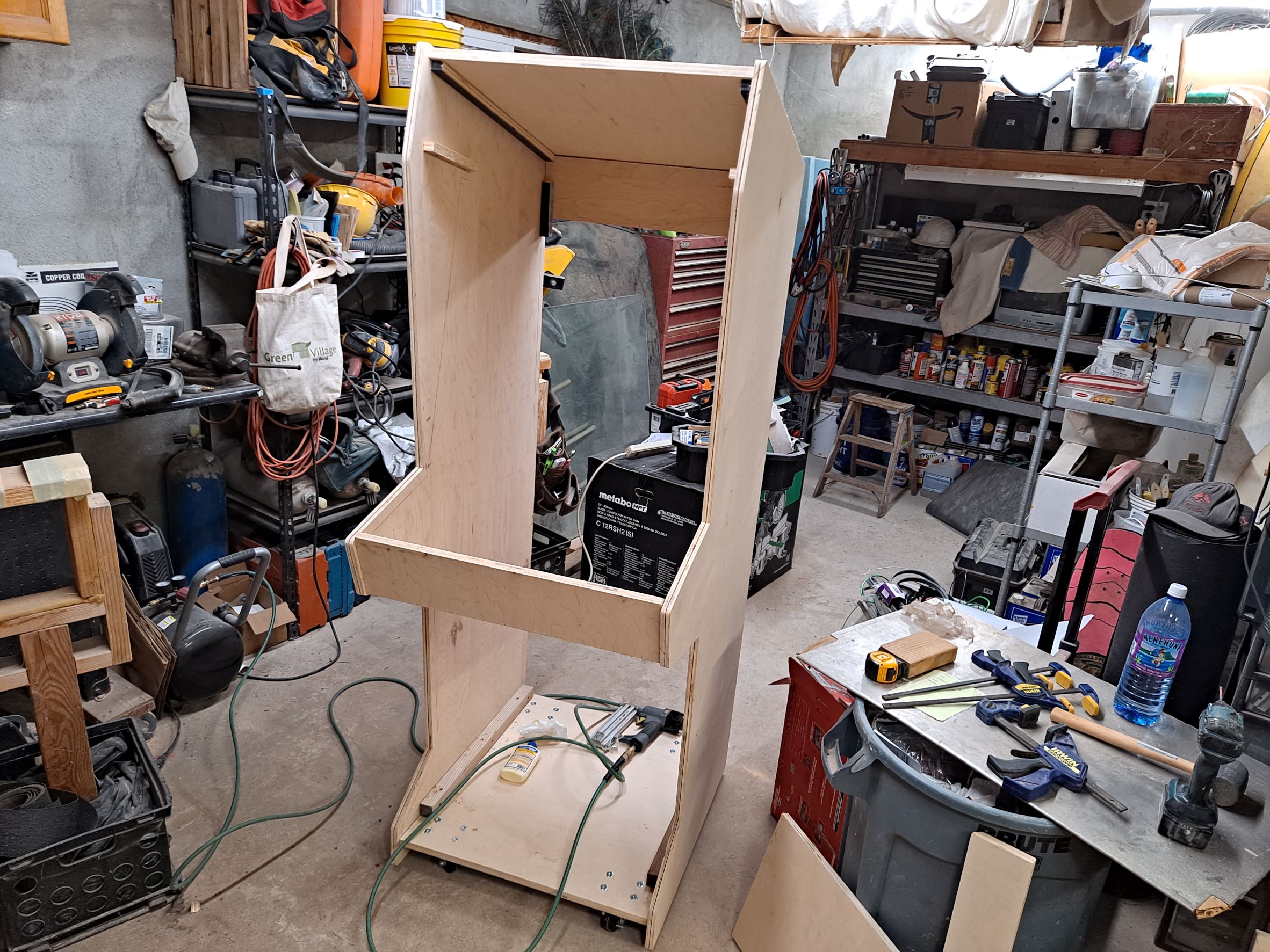

I had (made!) a few hours to work on it after dinner today so made some progress again.
Having a good table saw and a bevel square makes a remarkable difference in construction speed.
I'm still trying to figure out if I will be covering the sides with white vinyl or formica before the artwork gets put on but I couldn't wait any more to keep building.
Stitched the sides to the base and added the top-most panel so that I could get it standing.
Another consequence of designing as I go is that I will need to trim the base sheet by 3/4" on the front edge to accomodate the toe kick-panel.
Maybe next cabinet I can get the base right the first time?!  :banghead:
I decided that I will build the coin door/pedal box into the cabinet rather than cut the back portion of the kick panel around it.
Seemed like it would be more stable that way (although the sides of it wind up this kind of quadralateral/ trapezoidal kinda thing that will be interesting to get cut properly.)
There are so many little panels for this cabinet that it is nuts.
Since this thing is never going to live in an arcade where I need to worry about people thrashing it I can leave out some of the detail of the original really.
The dimensions are such that if for some reason I wind up with a proper Paperboy boardset I could install it all, but I won't be holding my breath for that.
The other thing is that I can't see the metal control panel of the original really being necessary either.
I beefed up where the CP will sit enough that it shouldn't be moving at all and I will add a strongback along the rear edge once I see how the controller and monitor fill the space.
If for some reason I need to rout out a spot and drop a metal plate in I can do it.
I have glued and braced the front part of the control panel to the top also so that I can round off the edge like the authentic metal panel and have an assembly that won't move around during play.
It will be screwed into the blocking so that I can remove it also, in case it needs to be worked on (or even redesigned because I missed something) and the screws should keep it in place easily.
It is getting two 4" speakers that will not be behind one of the original style grills that are as wide as the cabinet.
Again, no need to sweat the abuse that thing was built to stand.
After building a decent number of these things now I can see how you really don't need much to make them solid and functional.
Still haven't decided what system will be running the game.
I believe I have another PC that I could use but this is only going to play Paperboy at this point (maybe also Road Blasters in the future with a panel swap?) so maybe a RPi build would be in order.
Still haven't built one of those up yet so no clue how the Paperboy emulation is there and how integrating the potentiometers would work.
Any wisdom on the details of an R-Pi build vs, PC for this case would be appreciated!

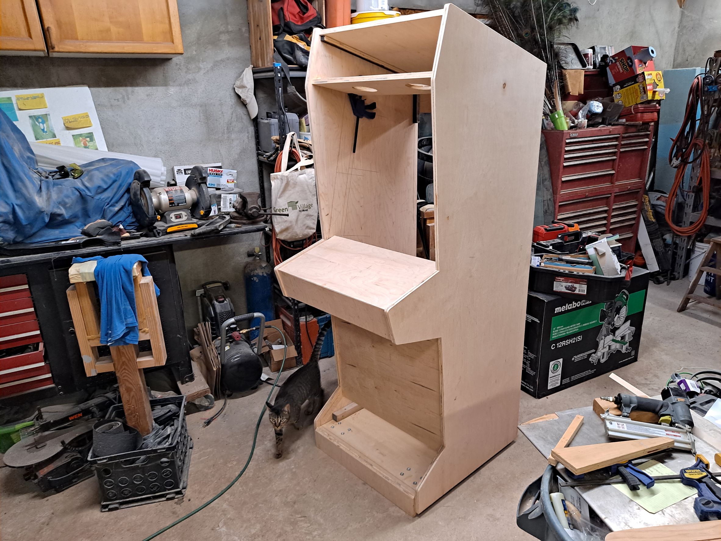

I forced some more time to work on this again today (too hot to cut the ocean of grass, too humid for my drywall mud to fully kick.)
I was dreading dealing with the coin box because it was going to be so weird, but I was just being a sissy.
It DID however require some fun with ridiculous angles.
For all those making this ---steaming pile of meadow muffin--- up as they go along (like me!) you NEED to own these things.
Bevel square and sharp pencil a necessity of course, but this True Angle thing is awesome in case you actually want to know what angles you are actually playing with.
The side of the coin box (because of how I built it) has 3 weird angles so I checked those against my side length measurements a few times before I made a cut.
I still nearly messed it up.
I figured I should anticipate having a legit coin door and cash box stack in this, so I used the one I have in the Rush cab to measure for a porthole.
Then I figured if I was REALLY good then I could use the cut out as a door panel while I wait to spend the $$ on a real door.
So, careful plunge cuts first
Then finishing out the corner radii with a jig saw.

Got the Trinitron pulled apart and the screen hung.
My favorite way to hang a tube now.
Minimal
Modular
Adjustable (if a tube swap needs to happen)
A template saved from when I got a shape that is pretty universal makes this really quick now.
Only need to center that curve on the appropriate width panels and cut them out with the jigsaw.
The other element is putting a set of 4"x4" ply pieces on the sides of the cab which have a 3/4" notch in them to accept the lower cross pieces and everything sits quite nicely.
Nearly all the weight sits on the bottom pieces of course so a smaller cross piece for the top is plenty.
I don't notch that one as it is easy to rest the tube on the bottom one (already screwed in place) and then slide the top piece behind the mouting ears and just screw it down when it is in the right spot.
Since the bottom is leaning back into the notch by virtue of the angle and its own weight it doesn't move around before you can get it squared up with the cab and the ears screwed down.
I do spend a bunch of effort making sure the screen winds up where I want it in terms of vertical placement and angle of the face but not a big deal any longer.
Using 1/4" machine screws and t-nuts makes it easy to adjust and secure.
It's been fun to really pare the process down to the minimum required components and effort to make a solid cabinet.
Only took me a half dozen of them to start getting a clue.
 :lol
