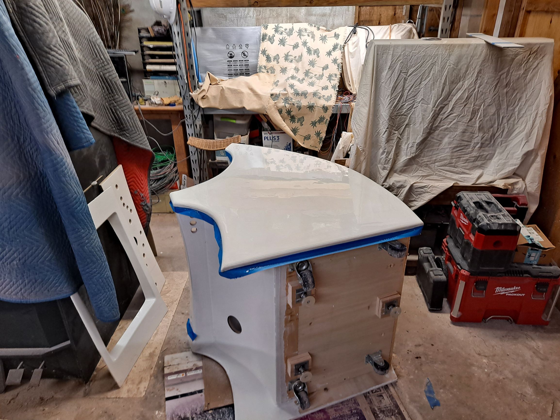

I had to add yet another layer of white onto one side of the cabinet because the latest round that I put on it just ---fouled up beyond all recognition--- up.
For added fun, I have no idea why either!
100% humidity for a lot of the last 3 weeks has made it all a bit dicey anyway, but I did something I shouldn't have with that last batch apparently and once it is done- it's done.
One of the joys of resin work is that unless you are working in a very tightly controlled environment, every time you do it is like it is own little science experiment.
 :dizzy:
Legit progress.
The LAST lamination necessary for this cabinet.
The whole thing is just so overkill in terms of structural integrity that this is kinda ludicrous EXCEPT that I sorted out that the front panel under the controls is where the speakers will go- so the panel they sit in needs a little mass to it so that the whole cabinet doesn't just become a tinny, buzzing, irritating box.
And this panel will be the part one would (accidentally!!!) smack their knees into or kick- for whatever reason someone would risk inciting my ire in doing so.
 >:D
Since it is only actually attached to the bottom of the control panel with a rabbet and then tacked/glued to the base panel of the cabinet (no side anchoring at all- due to the ridiculous curve of it) I figured it would require some fiberglass rope as a fillet.
For anyone who built surfboards prior to 1995 or so, this stuff was the only way to add the lateral reinforcement that would keep a fin on a surfboard.
Nowadays, only crotchety old guys like me use it- and usually only for old school longboards for grumpy ---daisies--- like myself  :lol
It will add strength to this weird panel joint (especially when reinforced with another chunk of 6oz cloth.
Which reminds me,  I need to go trim this stuff while it is still a bit gooey (and you can actually cut it with a razorblade) rather than wait until tomorrow when I have to grind the whole thing out with 60 grit instead!

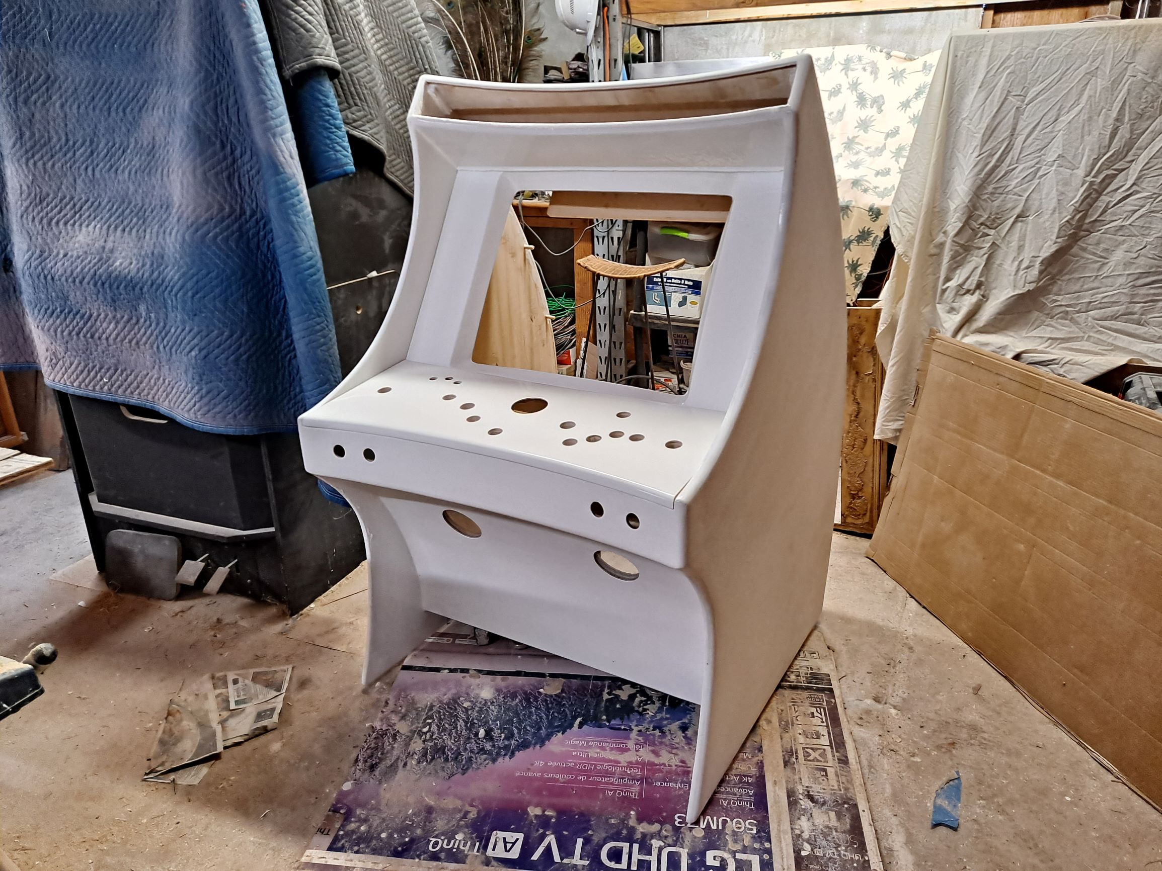

I discovered yesterday that the last 2 rounds of "final resin fill coat!" were NOT fully curing.  :cry:
And so, I had to recoat half the machine- again.
Lovely 100% humidity, old resin and probably not enough wax.  :dunno
When I checked on it this morning it appears that I finally got the whole thing to go off.
Phew.
Now I can finally get to proper finish sanding.

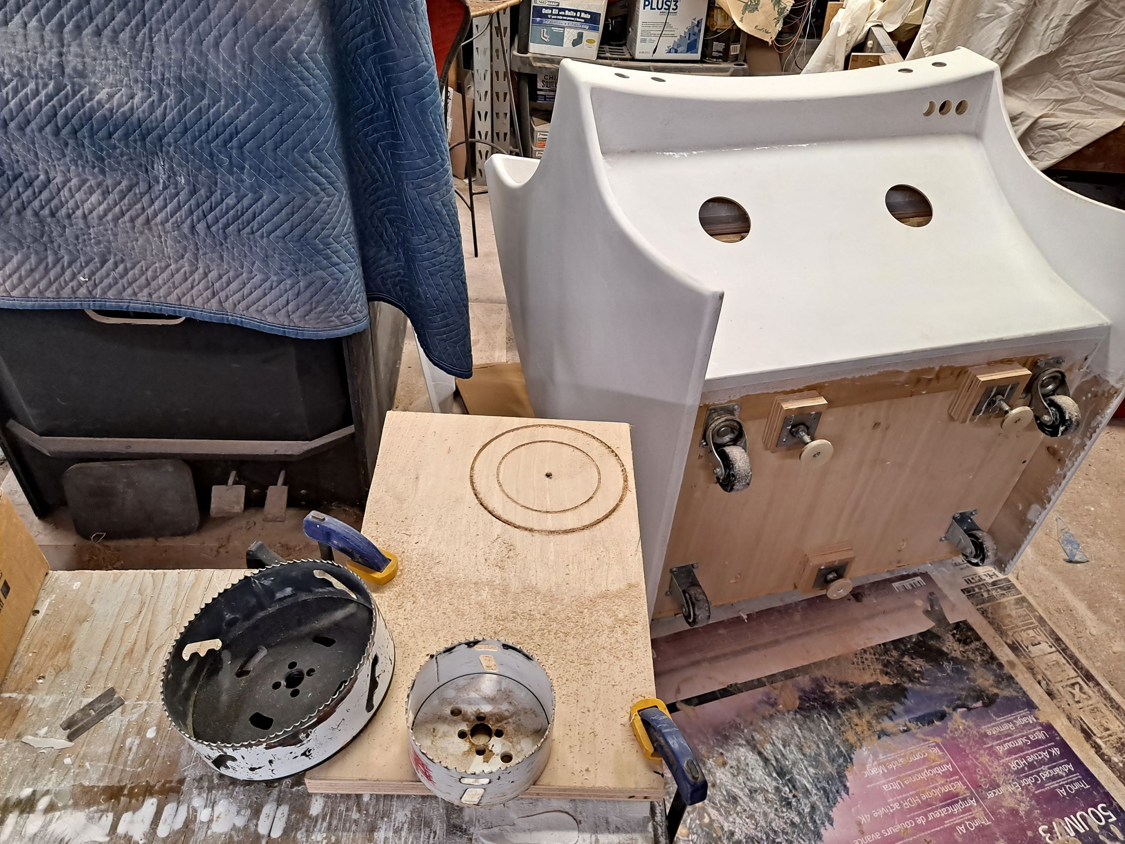

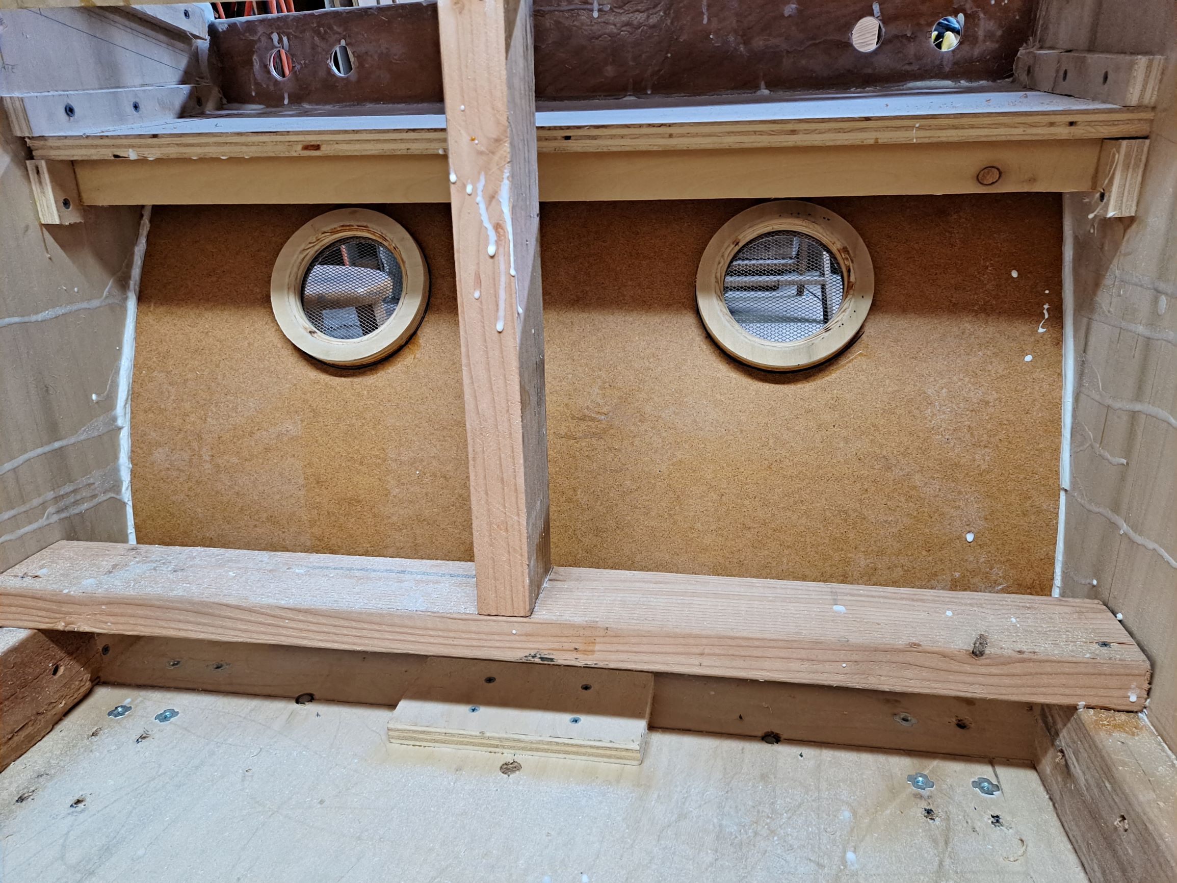

not sure WHY anyone else would ever have the need to sweat mounting speakers to a convex surface in any reasonable build, but I archive the mess here anyway.
For added fun, the panel the speakers are going on also happens to be only about 3/16" thick (so I could actually bend it the way I wanted it to go.)
I thought a while about what material to use and instead of shaping some foam and gluing that in, I thought why not just make a plywood ring.
6" hole saw for outer cut, 4 1/2" saw for inner.
Make a half depth cut with the 6" to have a pilot hole to maintain concentric ring and scoring of outer cut also.
Switch to 4 1/2" and make full cut to knock out center, switch back to 6", finish outer cut and remove ring!
I also ran the router around both sides of the inside ring, to make extra space for the speaker cone (just in case) on one side and on the other side to accommodate the screen.
I just used some KwikMesh that I had left over from doing the bird block on the eaves of the workshop and the house.
I also had to shape in some concave to the rings so they would sit squarely on the inside of the panel and actually hold the screen down while the glue was setting.
Tip the machine onto its nose, add a few lead shot bag dive weights to hold the rings and screen in place and voila!
Both sides are getting a gloss coat again to get a flatter surface after another sanding.
Finally getting really close to being able to put some electronics in this thing.
oh ygtbfkm, I just realised your cab now has portholes! :laugh: but don't worry about me, it actually looks great! :D

It may not look so "anchors away"-ish once the speakers are in it!
I hope
I hope
Yeah look I was just having fun with you, am only kidding. It doesn't look nautical unless you put a double ++ across the front of the holes or hang some anchors and ropes on the side lol.
I can really imagine your cab down at the beachside fish n' chip shop!

I knew it was meant in fun.
And holy crap now I look again I see that picture from the inside in a whole new light!
 :lol
