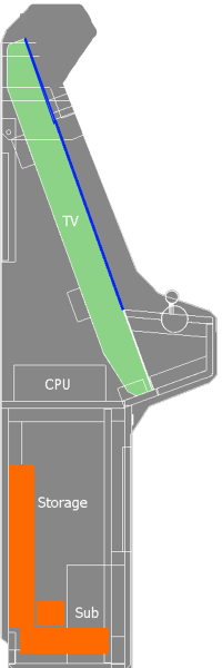

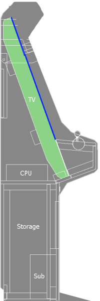

If you actually want a cab, consider mounting the 43" TV vertically, like the attached image shows.  The blue line is the visible screen area.  I'm building one of these right now and it's going to turn out great!
  • Posts: 19438
  • Last login:Yesterday at 06:44:21 pm
So how are you going to keep that from tipping over, because as is it's going to want to take a dive anytime someone gets too excited and pulls down on the joystick a little too hard.
P-chan
  • Posts: 167
  • Last login:April 13, 2022, 12:39:40 am
Who are you replying to?  If you're referring to the diagram I posted, all the weight is in the bottom, the TV weighs like 20 lbs, maybe?  The wood and PC are going to be maybe 100lbs.  I don't think I'll have any issues.  There will be no weight in the top at all.  Also I haven't started building yet but I think I am going to make it a little deeper.
schmerzkaufen
  • Posts: 792
  • Last login:April 16, 2025, 09:46:43 am
  • Multiple Electronic Machine Emulator
You can always think about leaving enough room for putting some dead weight at the bottom.
Once I was trying a mock build of a similar design the lack of weight was indeed a problem, so I've simply shoved a heavy stone a the bottom, problem mostly solved (~20kg maybe?)
A more clean solution would be to make a custom-shaped one in concrete, it's also easier to optimize weight distribution this way.
  • Posts: 5911
  • Last login:Yesterday at 06:09:12 pm
If you are putting rocks and concrete in the bottom of your cab then the greater issue is that it is a bad design.

bperkins01
  • Posts: 895
MikeA is correct.  That skinny base cabinet will fall over pretty easily
Or.  Make sure you screw
It to the wall.  Adding weight is not going to help much at all.
The majority of its weight is at the CP and up.  It’s already top heavy on a small base

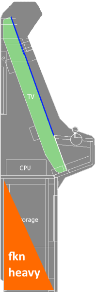

schmerzkaufen
  • Posts: 792
I thought the free space below the cp on a variety of cab designs was meant for more comfortable bar stool sitting? if stool's the plan, well...
Unless one plans to use all the space stuffing a ton of hardware inside that slim cab, I see no problem with shoving something heavy at the bottom of it.
It can be anything really, a bag of dirt or a dead animal, whatever, it's not like everyone's going to see it.
EDIT: Yes it's not an ideal solution, for effectiveness it need to be very heavy. The 20kg stone made things better but twice that would have been much better. Sure; the heavier the more room it takes...
When you try and create slim and compact designs though, why not go all the way and try to create the thing you're really dreaming about even if that means being inventive and making difficult compromises, tweaks/hacks?
Kinda like when building a custom SFF PC.
Custom shape also means custom weight distribution;
(ok it doesn't have to be that big, but you get the idea)

  • Posts: 5911
There is some middle ground there to accommodate seated play. You can extend the base enough to support the CP and still fit your legs underneath. Then you don't need to stuff patio blocks in your cab like a goof.

bperkins01
  • Posts: 895
Or screw it to the wall.  It’s a big cantilever.  The base is small.
It really needs to be wider than what is shown.
2 screws at the top will be a lot better than weight at the bottom
bperkins01
  • Posts: 895
If you extend the base out to the line up with the front edge of the monitor behind the cp.  you will be fine and won’t need to add any weight.  It’s just a little and you will have plenty of room to sit
