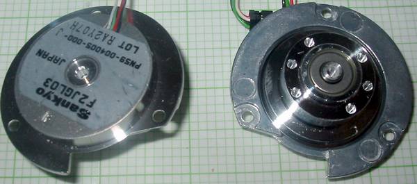

I am poor and do not have money to buy a cool nifty spinner from GGG.  I have about 10 IDE hard drives from old Xboxes that are taking up space.
I want to make a spinner out of a hard drive spindle and having successfully destroyed one that was ticking like an alarm clock when plugged in.  I took a look at the WIKI on hard drive spinner hacks (somebody needs to go in and fix the links) and my hard drive spindle typically doesn't have any hole in the bottom to stick a ball mouse encoder wheel in.  What I do have is a flat circular part that I can cut out some cardboard or plastic and stick it on the bottom of the spindle and place a old optical Microsoft mouse (tiny one) and have it read the card/plastic whatever to make the cursor move.  I will stick some big washers on it to make the inertia better.  So why not go and do it, instead of posting this you might wonder?
Well I have a problem of attaching the hard drive spindle to the control panel.  I have a 1Up vertical cab and I want to either place the spinner knob through one of the speaker holes or mount in where a button once resided.  I want the speaker option as I need the button.  How do I do it?  The screws that held the platter plastic part is super tiny and I cannot find screws long enough to fit.  The hard drive motor spindle thingy is just missing the buttons and it free spins and I can position the optical mouse using the same holes that the speaker used.  I am using an old stereo knob to operate the spinner.
I am kind of stuck on how to mount the spindle.
Similar but without the wires.

The cheapest spinner you can get is made by an optical encoder and an arduino clone board. It asks for some work on your side, but that's for free :)

Pretty sure that baritonomarchetto is talking about this type of rotary encoder.
- They come in a variety of resolutions from 100 to 1000 P/R. (pulses per rotation)
- I've worked with a 600 P/R encoder like this.
-  It's plenty sensitive for an arcade spinner and friction is not an issue, unless you're trying to keep it going for two minutes on one hard spin.   :dizzy:   :lol
- Make sure you get the wire colors/connections right.  Applying 5v to an output data line will fry the encoder.
It's pretty easy to make a parametric 3d printable wood panel mount in OpenSCAD.
- LMK if anyone needs help with the code.
- The M3 screw holes are 120 degrees apart with one set of three 14mm from the center of the shaft and the other set at 15mm.

I was not referring to this particular encoder (not supercheap I think), but there are plenty of models you can use with the same principle of operation. The smaller may have some friction, but no more than a genuine taito spinner from the 80's. I can see only pros with respect to a hacked mouse

Well I am still working on getting the hard drive motor attached to the control panel via one of the speaker holes.
Home Depot yielded some washers and rubber grommets that didn't fit without breaking a finger, so I looked online and stared at another possibility.
Using the above rotary encoder could I not attach the wires to the scroll wheel of a mouse?  Amazon sells the unit for $20 for the encoder (could get it cheaper) and $6 for the Pot.
