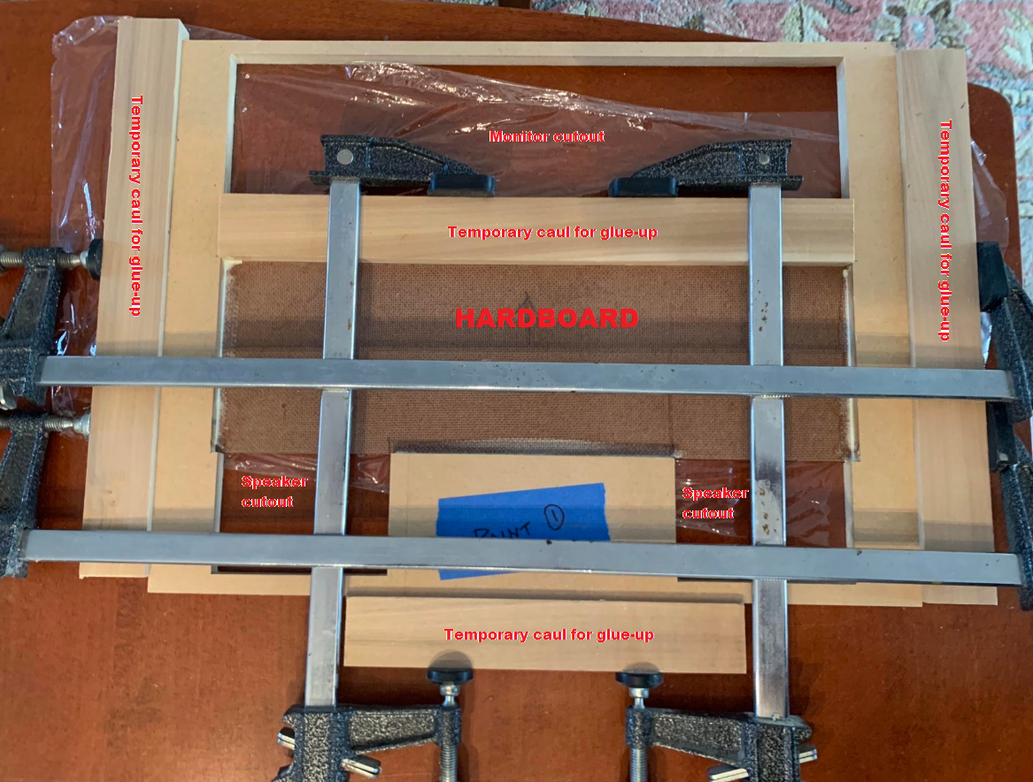

Now that I decided on the proportions, it was time to cut out the panel.  This was very difficult (for me at least).  First, I used a drill in the corners of the areas I wanted to cut out to make pilot holes for my jigsaw blade.  Next, I rough cut everything with the jigsaw.  The last step was cleaning up all of the cuts with a router and straight edge.  Easier said than done because of all the weird clamping I had to do for each cutout in order to set up the router so it had a flat surface to run along but still cut away the material.
This is how it looked after the router step.  In order to get the monitor to fit, I used a flush cut hand saw on the corners to remove the material that the router could not reach.
Perfect fit for the monitor!  I decased it as you can see from the picture.
The last bit of woodworking I had to do on this panel was cut out the 2 holes for the speakers.  I repeated the drill/jigsaw/router process and when I was done the speaker grills fit perfectly.
If you look close, you can see the round area behind the speaker grills - the actual speakers just screw in place in the 4 holes.  The only thing I need to work out is how to get everything to stay in place.  I could build some supports from behind but honestly I think some hot glue around the edge of the speaker grill where you won't see it from the front will do the trick.
One concern I have is that I removed a lot of material from the MDF panel... hopefully not too much.  The laminate on the front side and the monitor mount should add some rigidity to the entire thing but I won't know until I actually finish...  I came up with a few ideas on how to solve this problem and Arroyo gave me some advice and the light bulb went off.  I'll post that process next.

« Reply #63 on: February 27, 2020, 02:57:54 pm »
That turned out real nice.  Everything looks like it fits in real tight.
That was my first thought when I saw the pictures.  Looking forward to seeing how you solved it.

« Reply #66 on: February 28, 2020, 09:18:03 am »
Thanks - everything is nice and snug.  I decided to mount the monitor this way for purely (minor?) aesthetic reasons and of course it turns into a giant headache.  Getting the monitor as close to the face of the panel was most important to me.  If I had just cut a hole the size of the marquee and mounted the monitor behind the panel, I am not sure I was going to like the end result.  I didn't want there to be a 1/2" or more space to fill, I didn't want to treat those inside edges and I was afraid of casting shadows on the marquee, etc.
I think I worked it out...

OK... time to get back to it.  Even though I took the day off of work yesterday and couldn't feel my finger, I couldn't let an entire "free" day go by without doing something... so I finished cutting out some material with the bloody utility knife that I had meant to get done before the injury.  Better than nothing.
So next up was figuring out how to get the monitor as close to the laminate as possible.  I decided that I just couldn't live with a 1/2"+ gap between the front panel and the front of the monitor.  So what I decided to do was try and add a 1/8" piece of hardboard to the monitor cutout area for stability in the area in front of the monitor that will not be seen and mount the monitor behind that.  The top part will have a piece of 1/8" plexiglas to protect the monitor screen and match up with the hardboard.
I don't think I can explain this as well as the pictures so here goes:
I didn't take any pictures of cutting the hardboard but all I did was cut a rectangle to the exact size BELOW the opening for the marquee and glue it in place.  I tried to make it as flush with the rest of the front panel as possible so that I can eventually laminate over the entire thing.
As you can see from the pictures above, the glue-up was pretty complicated.  I had to get as much even pressure as I could along the thin 1/8" thickness of the hardboard panel.
It worked!
This is what it looked like after letting the glue dry overnight and removing the clamps.  I'll have to scrap off some of the glue squeeze out but I should be able to easily laminate over top of this now and not worry so much about structural integrity due to the thin laminate.
The next thing I did was laminate the panel and everything was going according to plan until I cut out the holes for the marquee and speakers...
