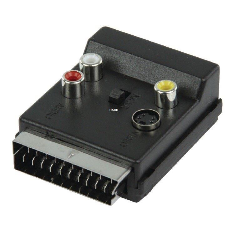

How is the gun supposed to be connected? I've seen that it has a yellow rca connector.
My vga to scart cable has a 1k resistor on h+v lines, i connected a female rca socket to pin 20 and 17.
This worked for me. I know it was common back in the day to build a circuit that converts the sync to csync, but this was unnecessary for me.

josete2k
  • Posts: 62
  • Last login:February 07, 2025, 08:39:53 pm
Re: Guncon2 on latest Groovymame?
« Reply #27 on: February 27, 2019, 10:34:07 am »
I have an scart like this:
It's working.
