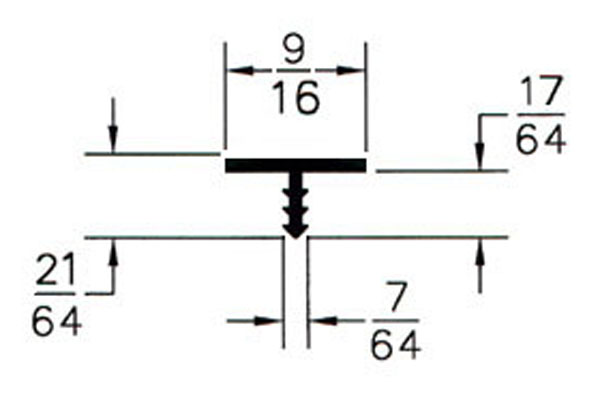

Hi all,
I am thinking of buying some of the 9/16 true flat Nintendo moulding from America. I am in the UK and the nearest plywood or MDF available is 15mm (5/8).
My question is, has anyone done this before and what were the results like? I'd need to buy a lot of the moulding from t moulding com to make it worthwhile and I don't want it to be too small. I could really do with a sample if anyone in the UK has some. I'll gladly pay for a bit to be sure it'll fit right. My fear is that the mm or so difference will be obvious when fitted.
My other option is the more readily available 15mm trim I can get which is in fact slightly wider than side panels. I'd then trim it so it looks more like the original trim.
Any suggestions?

Are you looking at the 9/16" Nintendo flat T-molding from t-molding.com or true flat, true flat for control panel or true offset from Chomping Quarters?
Diagram from t-molding.com.
9/16" = 13.78125mm
You could get pretty close to that using 12mm plywood with a layer of 0.7mm vertical grade laminate on on each side.
