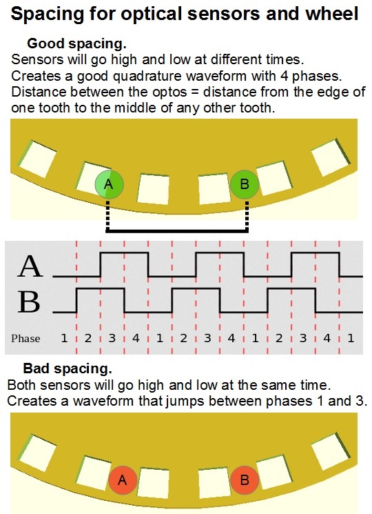

I want to create a "button click" when the spinner is in the 12 o'clock position. You mentioned an optical gate. Can you point me in the direction of what this is, or where to get it, or how it would emulate a button click when the plastic passes through the optical gate.
A basic optical gate/optical circuit a.k.a. an "opto" has an LED and a photo transistor.
A spinner or trackball will have two optos per axis.
- The good spacing image shows the encoder wheel at the left edge of Phase 1.
- Data line A is transitioning from HIGH (not blocked) to LOW (blocked) and data line B is in the middle of being blocked.
- As you rotate the encoder wheel clockwise, the blocking and un-blocking of the optos will produce the quadrature waveforms shown.
For the centering "button press" on 720, you should only need one opto/data line since you don't need to determine the direction of rotation, but rather when the spinner is at the 12 o'clock position.
- The encoder wheel would only need one tab for blocking the opto.
- This design can jam/break if the encoder wheel tab and opto get out of mechanical alignment.
- To avoid this problem, you must design the sensor holder so it is adjustable and partly overlaps the body of the encoder wheel.
If I wanted to build an updated 720 controller, I would probably use the Adafruit 2167 beam break sensor mentioned in my previous post along with a custom 3d printed mount for the LED and sensor modules.  If you don't go that route, you could use a Happ "Red Board" with a custom mount.
To translate the data line signal from the opto into a button press, here are some options you could try:
- Use an "active low" gamepad encoder -- data line is HIGH until the tab blocks the LED so the phototransistor can't see it which sends the data line LOW which triggers the input to output a button press.
- Use an "active high" gamepad encoder and add a 74LS04 Hex Inverter or similar circuit to invert the logic level between the opto and the encoder.
- Make an Arduino "active low" gamepad encoder firmware and connect the data line to an interrupt pin for the fastest response.
Figuring out the correct combination of sensor/LED spacing, 3d printed mount design, encoder wheel diameter, tab width, encoder, and MAME settings is more work than I'm willing to invest.

Thanks for the explanation, I am an extreme novice at this. The spinner I have is like the second one where there is a shaft and an encoder. The guy I got the 720 stick from said X-Arcade uses GRS spinners and it's an 8mm bore. Is there some kind of part I can attach to the bottom of the shaft that would hold the optic sensor and disc? I'm guessing the disc would only need one hole, correct?
If you can replace the screw on the end with a longer one, it should be easy to attach a 3d printed encoder wheel for orientation -- you shouldn't even need the flange shaft coupler.
The more difficult part of the mod will be to make a mount for the LED and sensor that attaches to the clip-on spinner opto assembly.
- Maybe attach the mount using the two screws that connect the spinner opto assembly PCB to the black plastic clip-on assembly.  You might need slightly longer screws for this.
It should be easy to remix the 3D printable mount available here on Thingiverse.
- That mount was designed for using Adafruit 2167 3mm beam break sensors in skee-ball machines.
Almost right.  You need an encoder wheel with one tooth.
When the spinner is pointed at 12 o'clock, the opto is blocked so the data line is at logic LOW.
- With an "active low" encoder, that LOW is seen as a button being pressed -- same as pressing a button connects ground to the encoder input.
When the spinner is not pointed at 12 o'clock, the opto isn't blocked so the data line is at logic HIGH.
- With an "active low" encoder, that HIGH is seen as a button not being pressed.

All done, everything works great. I'll make a new post explaining how to do everything. In the meantime, Here are two videos showing the optic sensor and 3d printed disc in action, and a second video of the spinner auto-centering the skater when the joystick is in the 12 o'clock position (12 second mark) in game.
Optic sensor and disc:
https://www.youtube.com/shorts/YE8QXEGD5IM
Skater auto-centering by joystick position:
https://www.youtube.com/shorts/dnp8_6hsMTQ
If anyone is interested here are the MAME settings, they are specifically for GRS or Tankstick Max spinners:
